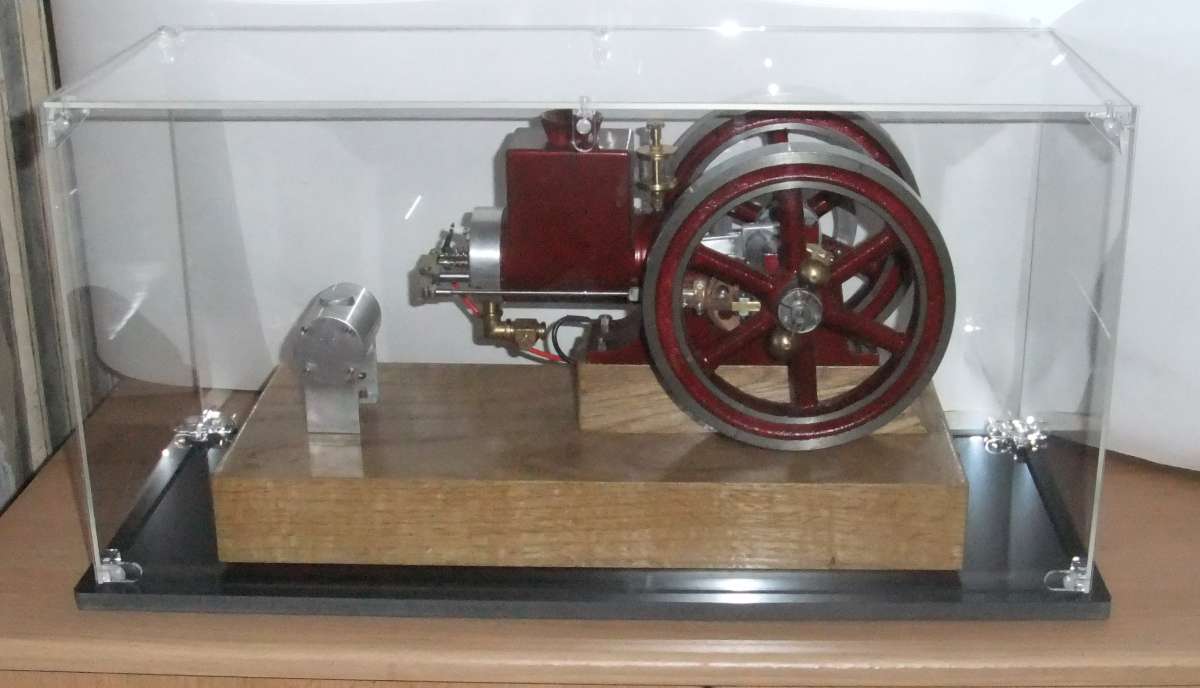

                  It is a shame that the man on e bay that use to sell the correct sized flywheels no longer shows them. I must have been lucky when I got mine for my Farm Boy.
                  I would go for a good cast iron blank and make your own.
                  A picture of mine for reference
                  During machining
                  DSCF3917
                  And final fitting
                  in case 10

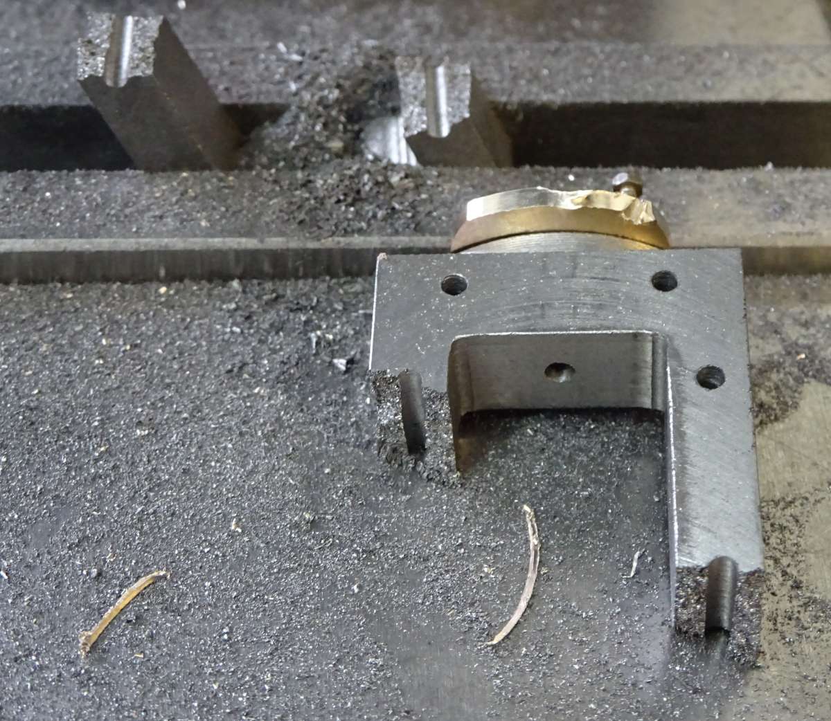

                                  I’ve experimented with weights earlier this year and gave up in the end. I used an angle grinder to remove the lettering on two different makes and didn’t even get to the point of machining them. One had bubbles under the lettering that meant you could still make out what it said when they were ground flush. The other broke chunks away when the cutter got close to an edge. In the end I didn’t want to waste any more time on them. There may be much better examples, but my ‘Middle Aisle’ weights were very poor.

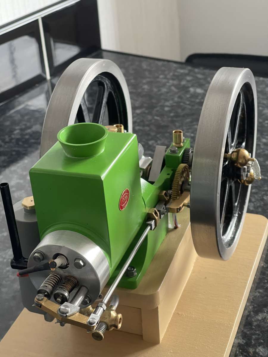

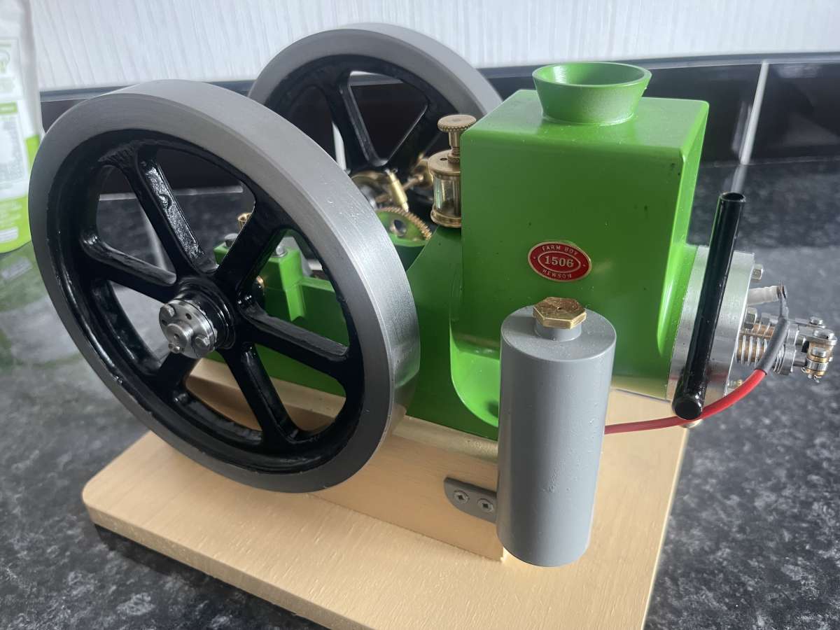

                                                  Hi
                                                  I used the Tina flywheel casting from Kennions for my farmboy.
                                                  IanIMG_0627IMG_0630

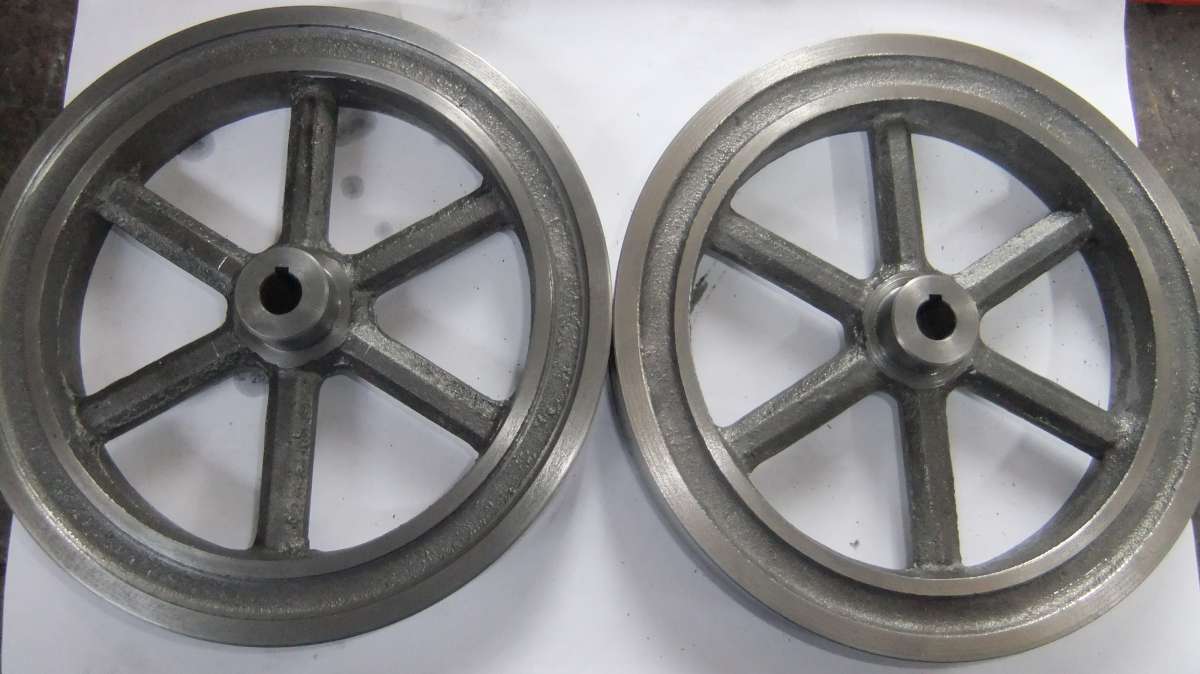

                                                    An update, JasonB  suggested this supplier:-
                                                    https://www.ts-modelldampfmaschinen.de/schwungraeder/?page=2
                                                    This is a German based supplier from where I ordered a couple of 140mm diameter flywheels.  I have machined the first one and was surprised to find that they are cast steel. Fortunately they do machine easily and not so messy as traditional cast iron.
                                                    Price wise, a little expensive at 36 euros each.
                                                    Bob
