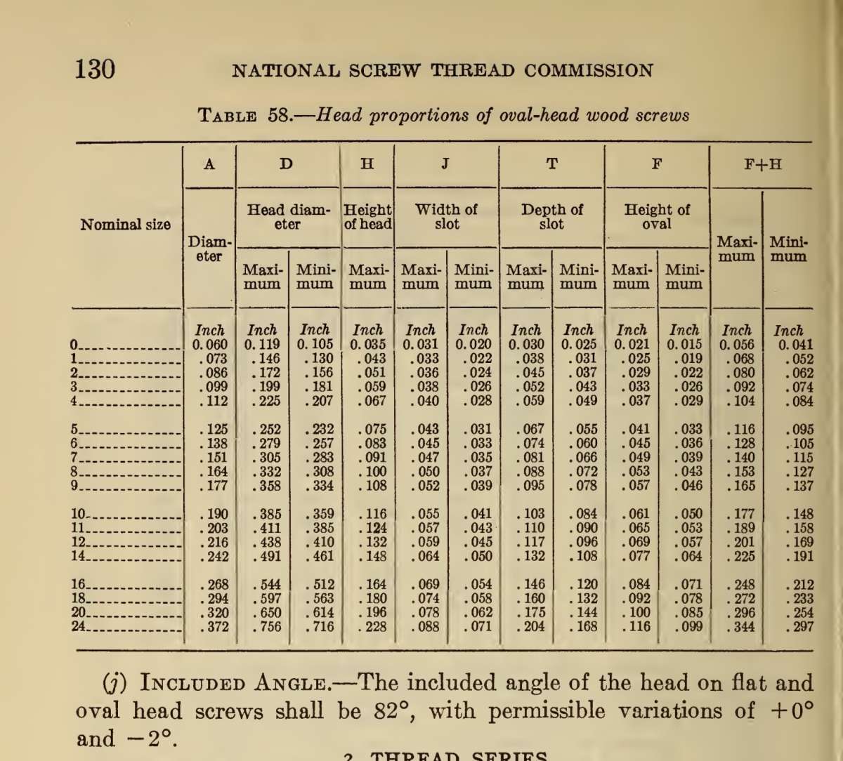

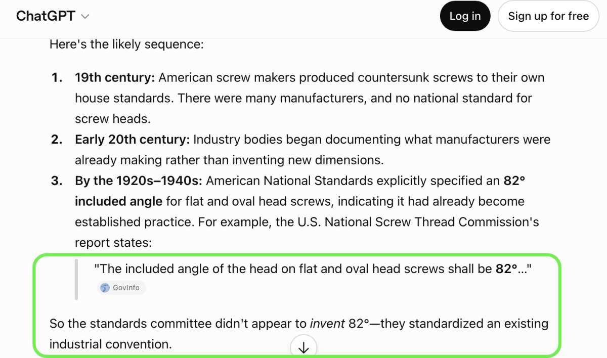

              #855363
                On ChrisLH Said:
                I am still curious as to why 82 degrees was chosen by the Americans but perhaps this is considered excessive subject drift.
                Me too, Chris …so I asked ChatGPT for the history:
                IMG_1814
                #855367
                  #855370
                    IMG_1816
