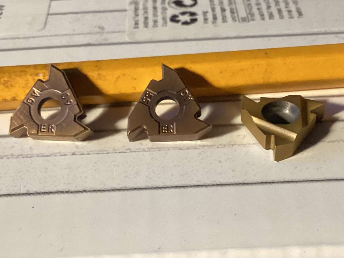

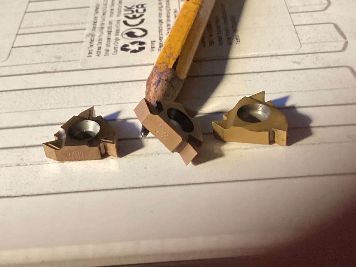

      I was sent five randomly selected external threading inserts a while ago when I bought an indexable threading tool from a well known ebay seller of lathe tooling.
      The seller didn’t tell me what inserts were in the package. That didn’t matter for two of the inserts, because their markings identify them, but the markings on the other three aren’t quite enough of a help.
      I gather from the appearance and markings that are there that all three are partial profile inserts and two of them are 60 and one 55 degrees. The 55 degree one has Q788 on it, one of the 60s has M412 on it, and the other 60 degree one has no markings on it at all.
      Ed. Sorry, I’ve somewhat booboed here, haven’t I? These are partial profile inserts, not full form, therefore the pitch isn’t fixed.But how do I know what the biggest pitch they can do is?
      IMG_2100IMG_2099

        Hi Bill, looking at the radius of the tip of the tool I would suggest that the minimum pitch would be more the question as they all seem to have quite a large tip radius. The maximum pitch would be governed by the depth that it would cut.
        Alternatively perhaps you could contact the supplier to see if they can provide more information.
        Andy.

          AG55 and AG60 are, as you realised, partial profile ‘general purpose’ inserts. assume .5 to 3mm pitch or 48 to 8 tpi. US and ISO threads for the AG60. BSW and BSF for the AG55
          Being old before my time (less less the case as the years progress!), a bit of a pedant, and having a preference for Whitworth and BA threads, I’d say that the AG inserts are OK for stuff that really doesn’t matter or in an emergency.
          Full form inserts produce a far nicer thread form especially if you are interested in root and crest geometry.

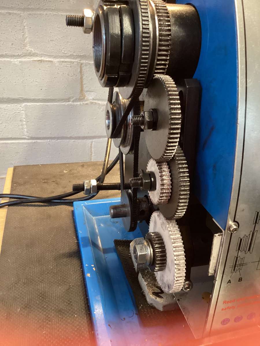

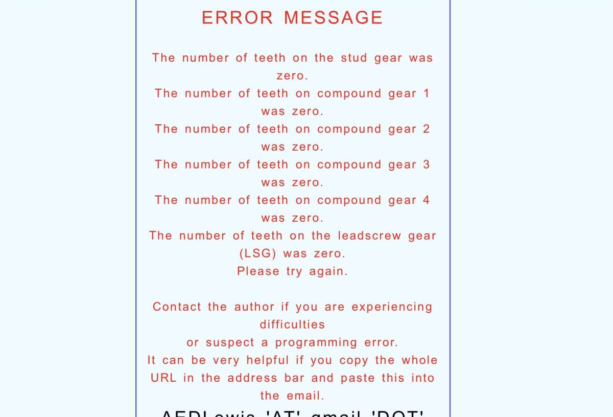

                    The only snags are I didn’t actually find any ebay or Amazon offerings that had the raised integral key-wayed spacer like my gears have (some pointers on where to buy would be appreciated), and trying to get an answer from Ride the Gear Train on what gear or gears I need for 8 tpi in addition to my current line-up (20, 30,40, 40, 50, 50, 60, 60, 70, 72, 80, 80) is proving difficult. Every time I click “find a new gear” after completing boxes 1-5A and skipping number 6 as instructed I just get the error message shown in the screenshot. So, again, some help with where I’m going wrong would be appreciated, for both now and in the future.

                      Looking at that older thread I think you actually have a 3mm leadscrew as the gear train assuming a fixe d40T on the spindle for 1mm pitch is 0.333 and that for 1.5mm is 0.5.
                      So try this.
                      40T spindle
                      Any gear as an idler on the first stud
                      35T being driven by the idler and a 60T driver on the second stud
                      65T on the leadscrew being driven by the 60T of the pair above.
                      maths is
                      40/35 = 1.143
                      60/65 = 0.923
                      1.143 x 0.923 = 1.056
                      Therefore 1.056 turns of the 3mm leadscrew per turn of the work = 3.167mm pitch not far off 3.175 (8tpi)
                      Just needs a 35T gear, you will  have to come up with  away to cut a keyway or you could just pin the new gear to an existing 40T

                        The tooth count on the fixed spindle gear on my 38mm bore lathe is 60 (though I think it may be 40 on the 20mm bore version) and the leadscrew is definitely 2mm pitch.
                        #853616
                          Same combination will give the same result.
                          60/35 = 1.714
                          60/65 = 0.923
                          1.714 x 0.923 = 1.582
                          1.582 x 2 leadscrew = 3.164pitch

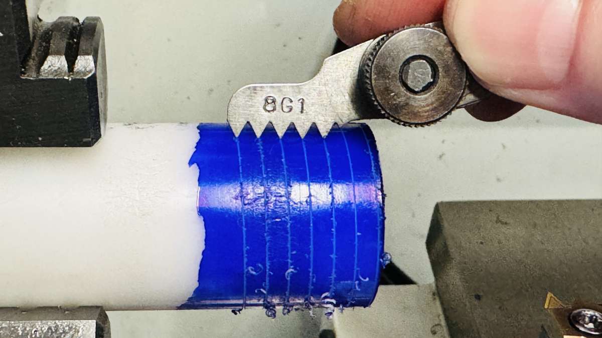

                            35T and 65T gears 3D-printed for me in PLA and installed.
                            Looks like it’s going to work just fine.
                            Thanks to everyone for your help and guidance.
