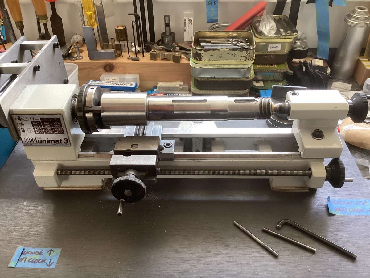

                  IMG_0453
                  (Note – although this is an R8 spindle it is 30mm in both bearing positions. The central keyway doesn’t serve any purpose).

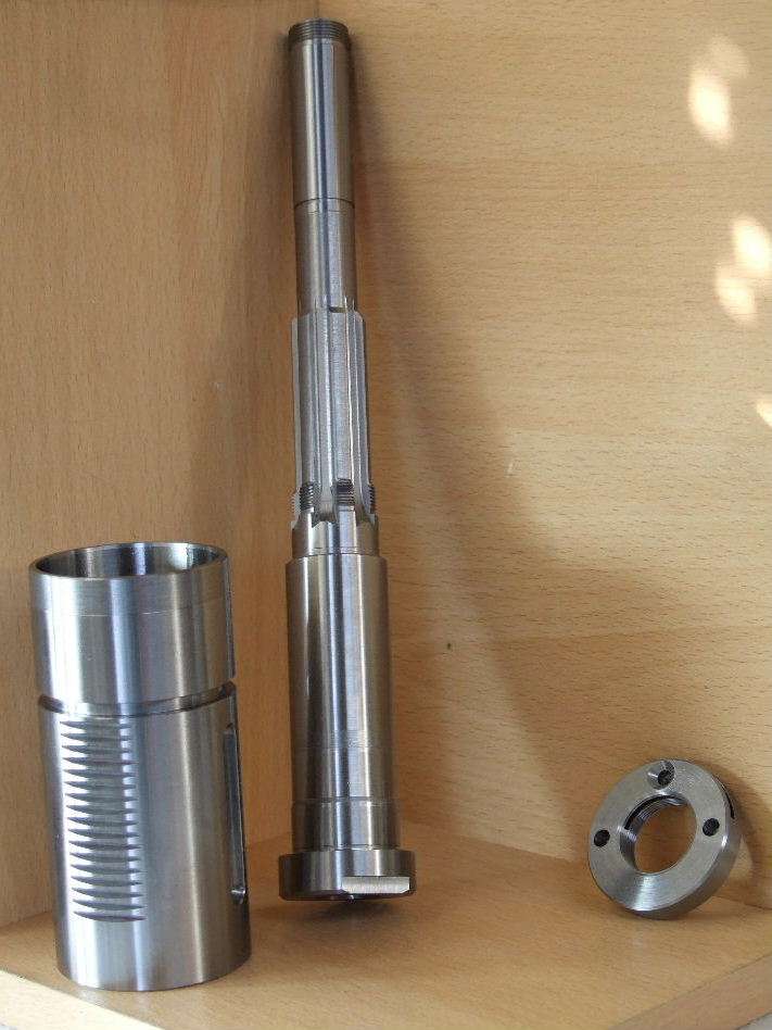

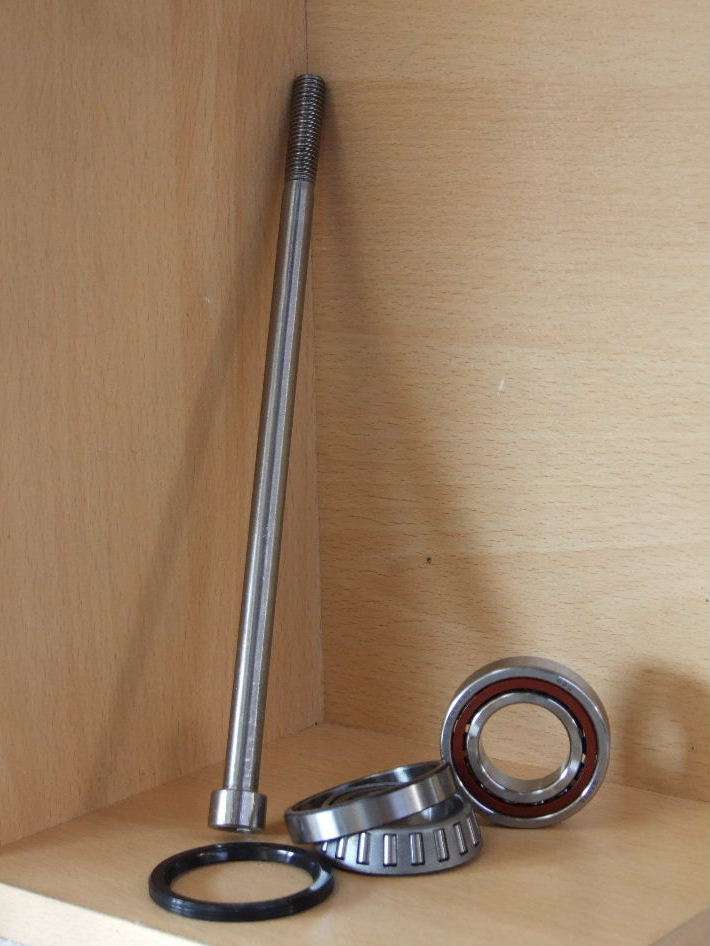

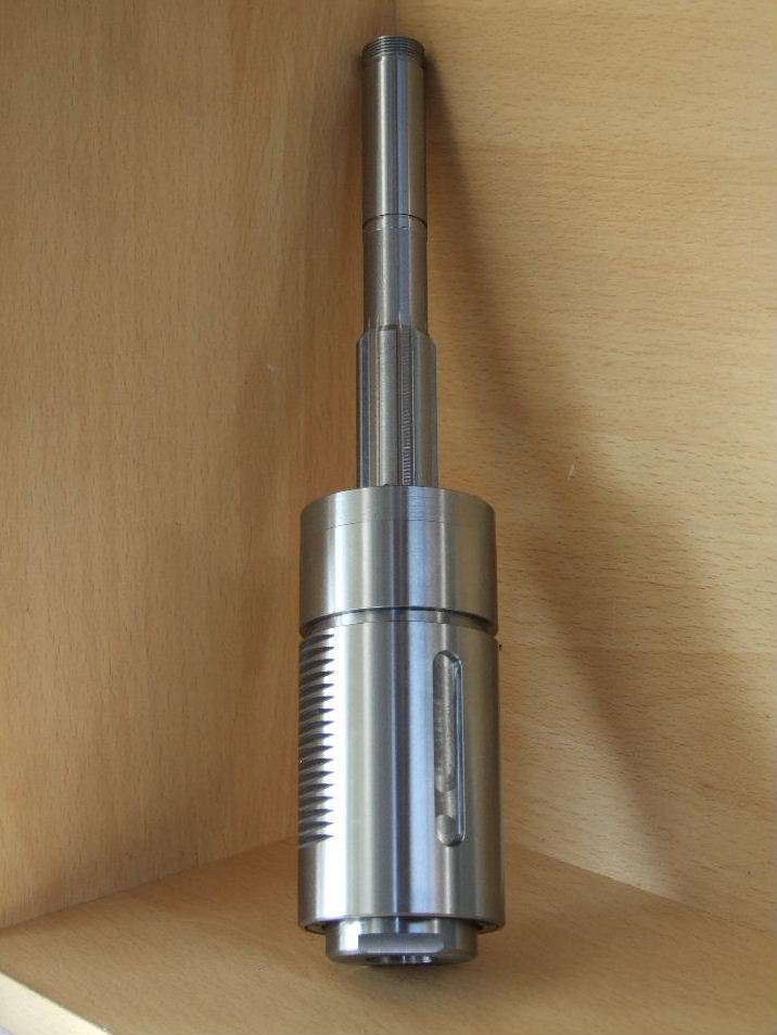

                              Given the loadings these machines are likely to experience Taper roller bearings are in my opinion an overkill. There seems to be an obsession with replacing the manufacturers bearings with something “Superior”.
                              The Emco FB 2 uses a Needle roller bearing for the bearing nearest the cutter. Deckel also used this type of bearing on their Die Sinking mills.
                              There were many in these pages who criticised the Emco arrangement and reckoned Taper or Angular Contact bearings would be “Superior”. Just out of curiosity I made a new spindle and quill assembly for one of my FB 2 Mills. Using a Taper Roller bearing as the Main spindle bearing and an Angular Contact bearing to take out the play.
                              New parts for redesigned FB2 QuillFinished 8mm longer Emco FB2 quill assembly
                              Bought in items for revised FB2 Quill
                              I can report there was no significant improvement in the spindle during usage. The pre-load had to be carefully monitored or the Motor could not start on top RPM. Due to the over-gearing and any excessive preload. It would seem the Emco arrangement could not be bettered.

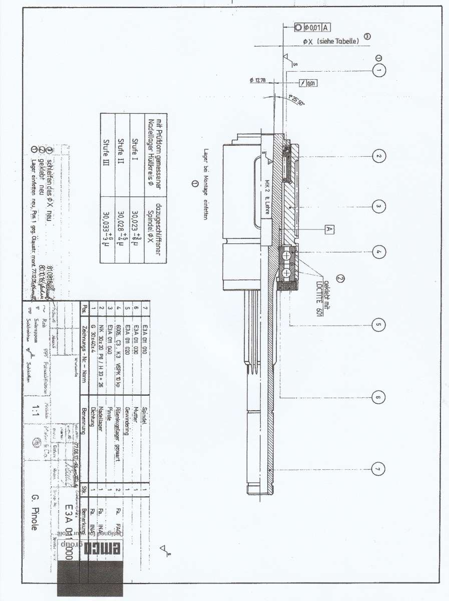

                                                    There seemed to be some doubt, possibly even sarcasm, as to whether Emco used selective assembly on the FB 2 Quill assembly. The enclosed works drawing will dispel any doubts I think.
                                                    Please note the tolerances on the “Spindel” diameter X, (+ & – 0.000*. mm, 0.00000* inches)
                                                    FB2 Spindle assembly.

                                                      looking at the Emco drawing, my first thought was “why use two bearings when three will do?”.   (For the avoidance of doubt, I am being sarcastic).
                                                      I can see plenty of scope for improvement, its not a good example of quill design.  Again, a discussion for another time.
                                                      One thing about the tolerancing on that drawing that, to me, stands out like a sore thumb.  The geometrical tolerancing, 0.01mm (~0.0004″), that’s quite poor.   Also, what taper is that?
