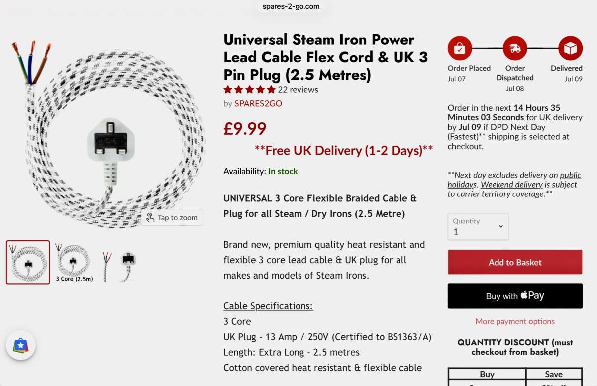

      My wife’s iron, at the tender age of only about 45 years, needs a new mains flex. It’s the traditional nice and flexible, rubber-insulated, braided cotton-covered stuff sported by every iron I remember seeing. The iron is rated at 1200W at 240V, so 5A conductors plus earth. Such flex is conspicuous by its absence on the shelves here in New Zealand, and even electrical wholesalers and appliance repairers look puzzled when asked for the stuff. Heat-resisting silicone-covered flex also seems unknown here.
      It seems that braided flex is available through some home decor-related channels, intended for ‘retro’ lighting applications, but you can’t find out anything useful about the rating or insulation or braiding material, even at the enormous price the aesthetically conscious are expected to pay, and I suspect it’s produced, in many colours, to look pretty rather than to be robust and heat-resisting.
      Does anyone know a source of this flex? One UK electrical supplier lists it on its web site, but it’s out of stock. My daughter will be passing through UK in a few weeks, and could bring a few metres of this apparently vanishing species back with her.

        Last iron cord I got was from B&Q.Light flex is the wrong gauge, you need 13A.
        #855313
        Vic
          @vic
          Replacement cables are available.
          IMG_2125
          10A rated cable also sold by the metre by several vendors on eBay.

            As above several ebay.co.uk suppliers, so maybe get some delivered to a friend.
            e.g. https://www.ebay.co.uk/itm/205048480170
            See also; closer to home.
            Heat-Resistant Cables – Cloth-Covered Power Set of 3

              A place to look in your own country might be commercial laundry suppliers/repairers.
              See above, from peak4 – thinking around the subject, and searching for the characteristics the cable requires (heat resistance) rather than specifically for a domestic iron cable might produce a useful lead (pun intended).
              Most of the full replacement cables sold in the UK have a moulded on UK plug attached, so you are paying for something you would cut off.
              Tell your daughter to wander the streets a bit with a set of side cutters – around here people leave broken irons out in the street for the scrap collectors.
              https://www.stevensonplumbing.co.uk/iron-flex-1mm-3-core-cable.html
              https://www.worldwidemusic.co.uk/steam-dry-iron-replacement-braided-3-core-iron-flex-cable—sold-by-the-metre-3945-p.asp
