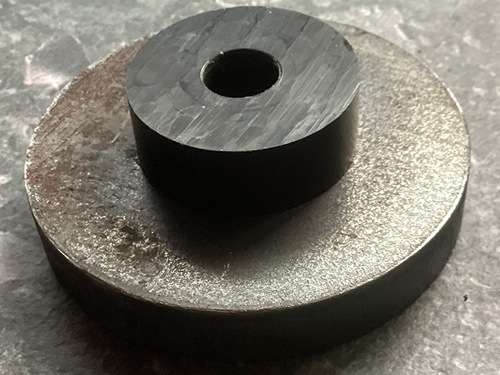

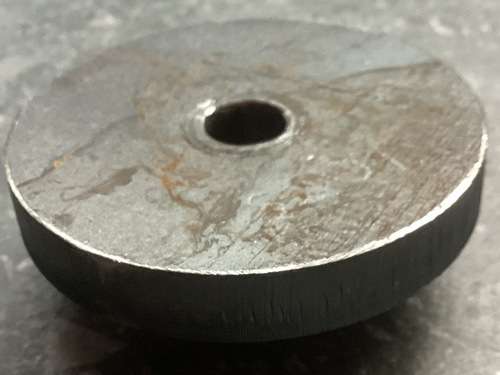

                                  Thanks all, OP here again! It does tickle me how threads develop a life of their own (and even have children, it would seem!).
                                  Anyway, an update on progress. The new bearings went in the freezer (-18C apparently) for 24hrs, and the housing went on a radiator to warm up. The bearings pulled in easily, with only a minimum amount of persuasion required. Taking on board Neil Wyatt’s comment that his bearings maybe didn’t seat down fully initially (he used angle iron) I used a steel 60mm disc, with a 30mm (ish) nylon disc stuck on with double sided tape to keep everything aligned. Worked a treat.
                                  IMG_0486_cr
                                  IMG_0487_cr
                                  The spindle also went in the freezer, and was easy to get through the bearings.
                                  The metal spacer went on (mental note – a nasty fit, to be sorted). On my (later) mill this tube has small protrusions for speed monitoring (I’m not sure if these are magnets or merely reflective). Pulley, then the top ring nut.
                                  With gentle and slow adjustment of the nut I could feel the free spin of the spindle reduce slightly – then I realised I had the nut upside down! Doh…
                                  Then with the nut on the right way (and the mill re-assembled) I ran out of thread on top ring nut. This due I think to the ‘depressing nature’ (ha ha) of the angular contact bearings. There is simply more movement than in the original bearings.
                                  I could make an additional simple washer type spacer but I was always going to make new pulleys for poly-v belts, so maybe I’ll plough on with that. And when I disassemble the spindle, I’ll face the ends of the steel spacer. I’m not convinced that anything is particularly accurate!
                                  So, ongoing. BTW the bearings I’m using are SKF 7206 BE-2RZP – low friction seals. I only want to do the job once, and they should give years of good service.

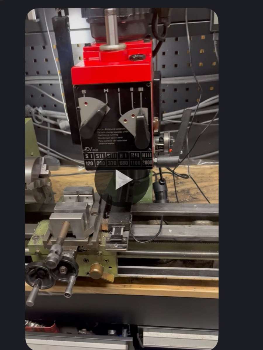

                                          Hi Chaps,
                                          I too have an Emco fb2 style milling head, Back story is it replaced a noisy 4 speed mentor style head….
                                          It was Nos
                                          I noticed it didn’t give a great surface finish when pushed even a little! After reading on here I measured tolerances and found :
                                          Radial play at the bottom 0.04 total
                                          End float a whopping 0.125 mm
                                          my question to the experience here is : Should I spend time on removing the end play ? Basically will that error removal yield significant radial play also ??
                                          Thanks in advance 😁

                                            You say that you have an Emco FB2 style milling head.
                                            Is it of Far Eastern origin and does it have a threaded spindle nose similar to the Myford 7 Series lathes?
                                            Have you had this machine from New?
                                            Has it been dismantled to your knowledge?
                                            The reason I ask is that a lot of people think the Needle roller bearing used in the Emco machines is a standard Needle Roller bearing and replace the more expensive higher precision bearing with a standard commercial one. Which has a lot more clearance.
                                            Also the two Ball bearings used to take the thrust loads and minimise end float. These are specially selected by SKF and FAG. These must be fitted according to the markings on the side of the bearing. Otherwise there will be a lot of end-float. Especially if these bearing have again been replaced with standard commercial bearings.
                                            If it is an Emco, then in the 40 years that I owned FB2 mills I have never had that sort of Run-out or End-float, which should be Zero for end-float.
                                            A photograph of the mill would be good.

                                              Hi Gray,
                                              it’s the real deal Emco , Red in coulor…
                                              it came from a UK dealer Emco indirectly via an eBay seller, my guess on the timeline of the head is one of warranty/repairs due… I don’t think it was ever dealt with so not repaired by the dealer just set aside!
                                              a fair few assumptions there but evidenced by the pristine paint, no column included , clamps not fitted or cable retainer , they were in sealed bags …
                                              So I guess it’s a fresh repair needed ! I think from memory fly cutting was a disaster but I blamed the new cutter I brought, By disaster I saw the column starting to occilate so turned everything off!
                                              I think I’m right in saying some of the late Emco equipment was produced over seas which could lean towards quality control issues 😁 my old career was catching quality control problems

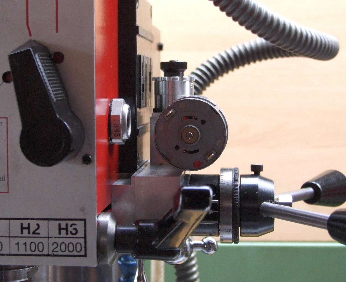

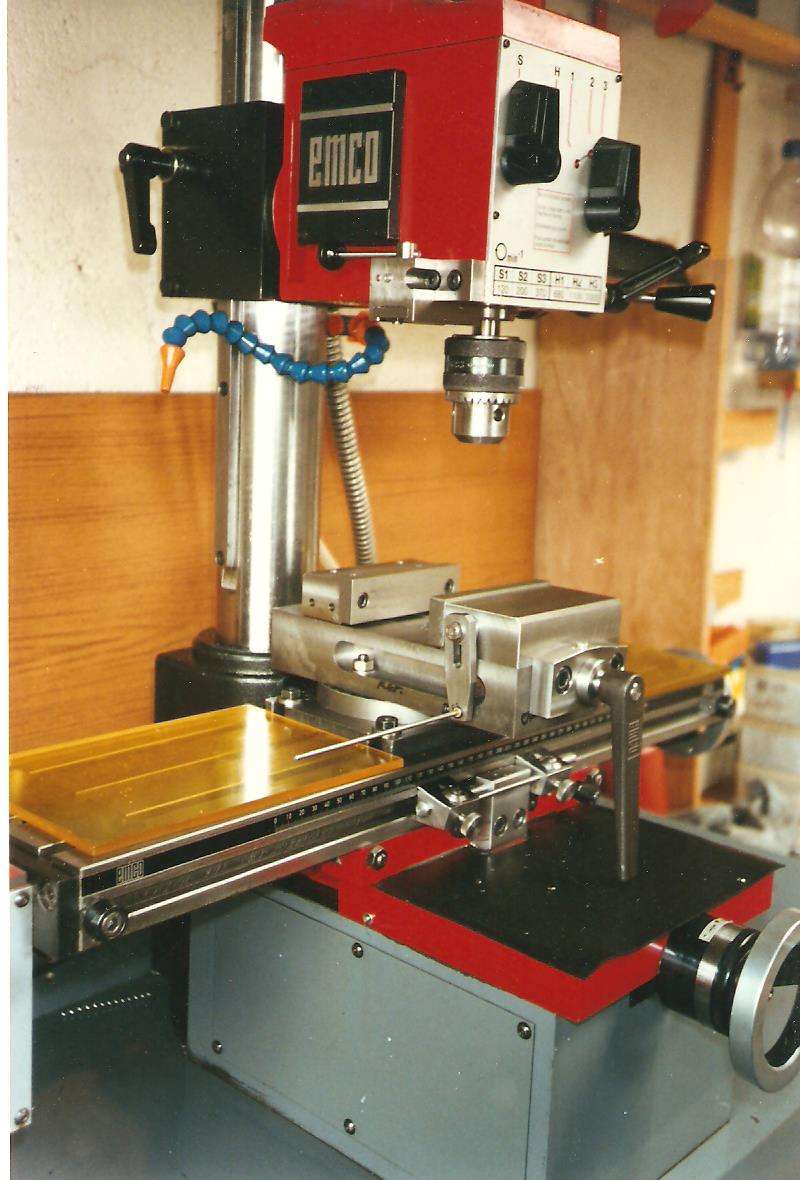

                                                Graham Meek
                                                  @grahammeek88282
                                                  I regret to say I think your machine is a copy.
                                                  Below is my last machine, which was sold about 5 years ago. At the time of purchase it was reputedly according to the Emco agent the last one to be produced in Austria.
                                                  New Emco vice 2
                                                  When Emco went over to the Red, Black and Silver Grey livery the Speed advice plate changed from the old two-piece Black design to a Silver one-piece design.
                                                  You will also notice the Speed change levers are rounded at the pointer end, and not as shown in the photograph below.
                                                  Fig 9a Front view of fine feed attachment
                                                  The style of Oil Filler and Oil Level sight glass are also wrong.
                                                  I do know that the Needle roller bearings in this unit are a standard commercial unit, so the play is about right. This could be improved by fitting a Japanese needle roller bearing which has an extra needle roller in, provided the hardened spindle is not damaged. The end float can be improved by fitting two angular contact bearings in place of the standard ball bearings.

                                                    Graham Meek
                                                      @grahammeek88282
                                                      The left-hand lock nut should lock the bearings up solid. There is no adjustment. It is either done up tight or loose.
                                                      To get to the Quill you will need to remove the motor. Be careful as there is a plastic extension on the motor shaft which pumps the oil up to the top of the milling head. Good old Archimedes.
                                                      You will then need to remove the top cover. Rap insulation tape around the screw thread on the spindle to protect the oil seal in the top cover. This will need to be removed to get the Circlip off that retains the return spring.
                                                      (There should be a Cap-Nut fitted here for extracting tooling)
                                                      Remove the down feed pinion assembly. The Guide bolt on the side of the head which stops the Quill housing rotating. Release the Spindle clamp and you should be able to push the Quill assembly out. There will be some resistance due to the O-ring on the Quill.
                                                      Re-assembly is just the reverse, but remember to install the insulation tape on the read after fitting the Circlip. Make sure the Circlip does not damage the Spindle as this is where the Oli seal runs.
                                                      Where abouts are you? I think I may have a pair of Angular contact bearings which should fit.
                                                      You will find a similar head to yours here, as well as other details on the FB2 which I have added over the years, you will need to read through I think I also added the dimensions for the Cover Gasket.
                                                      Emco FB2 Quirks and Additions
