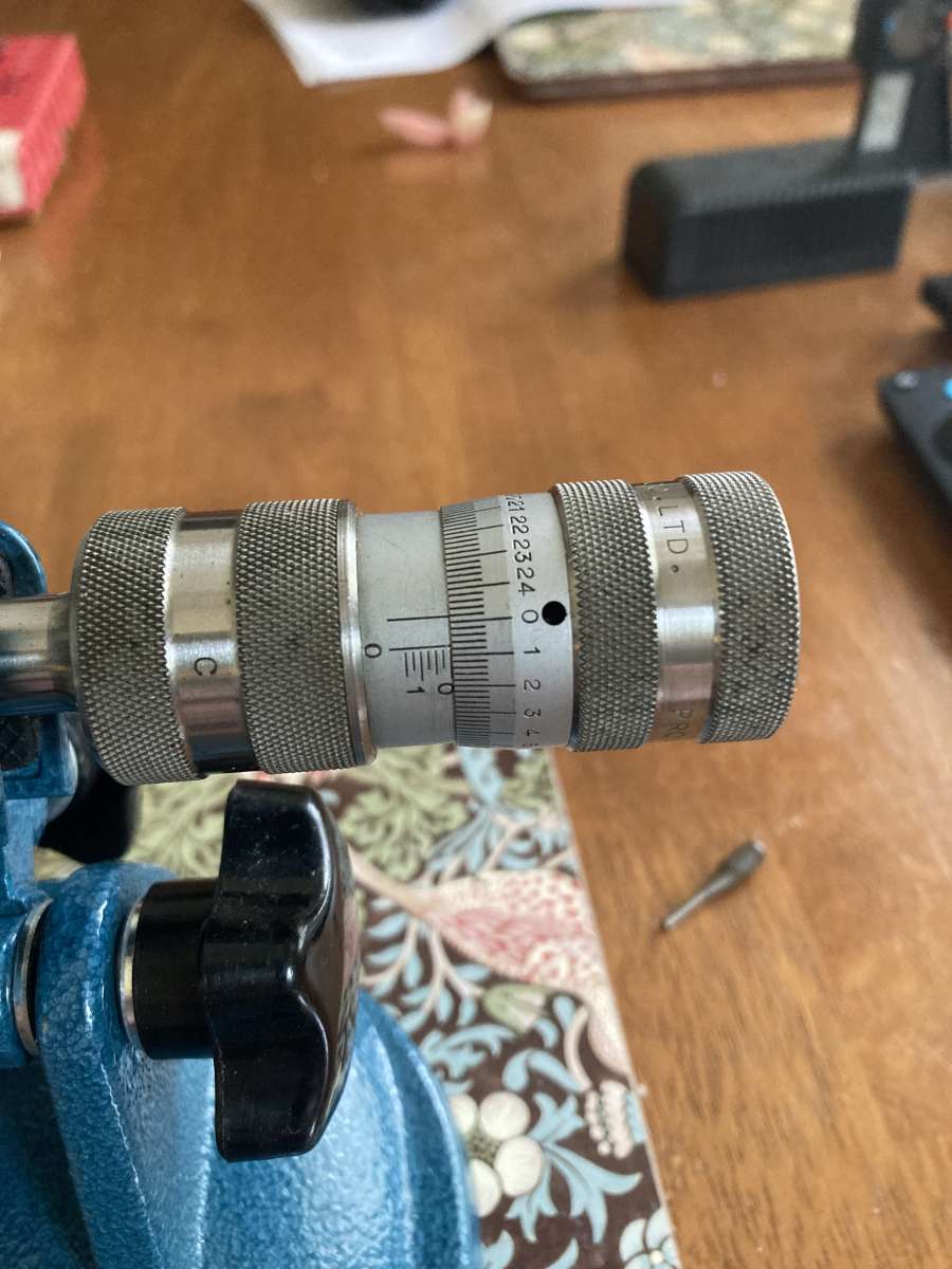

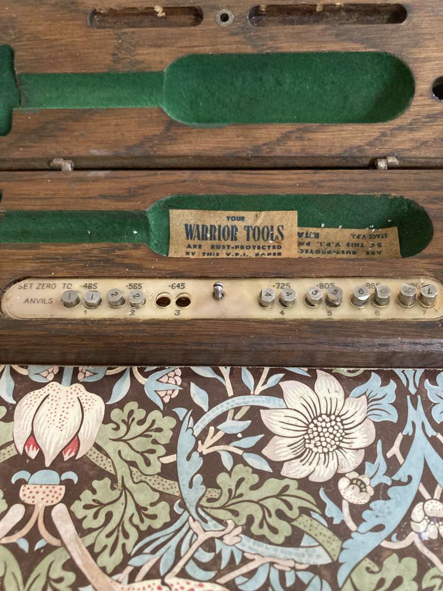

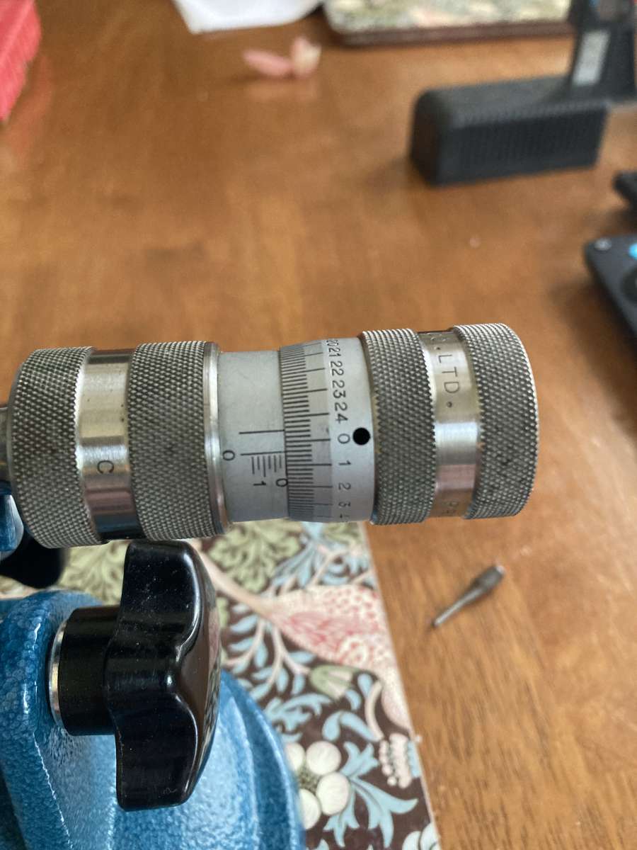

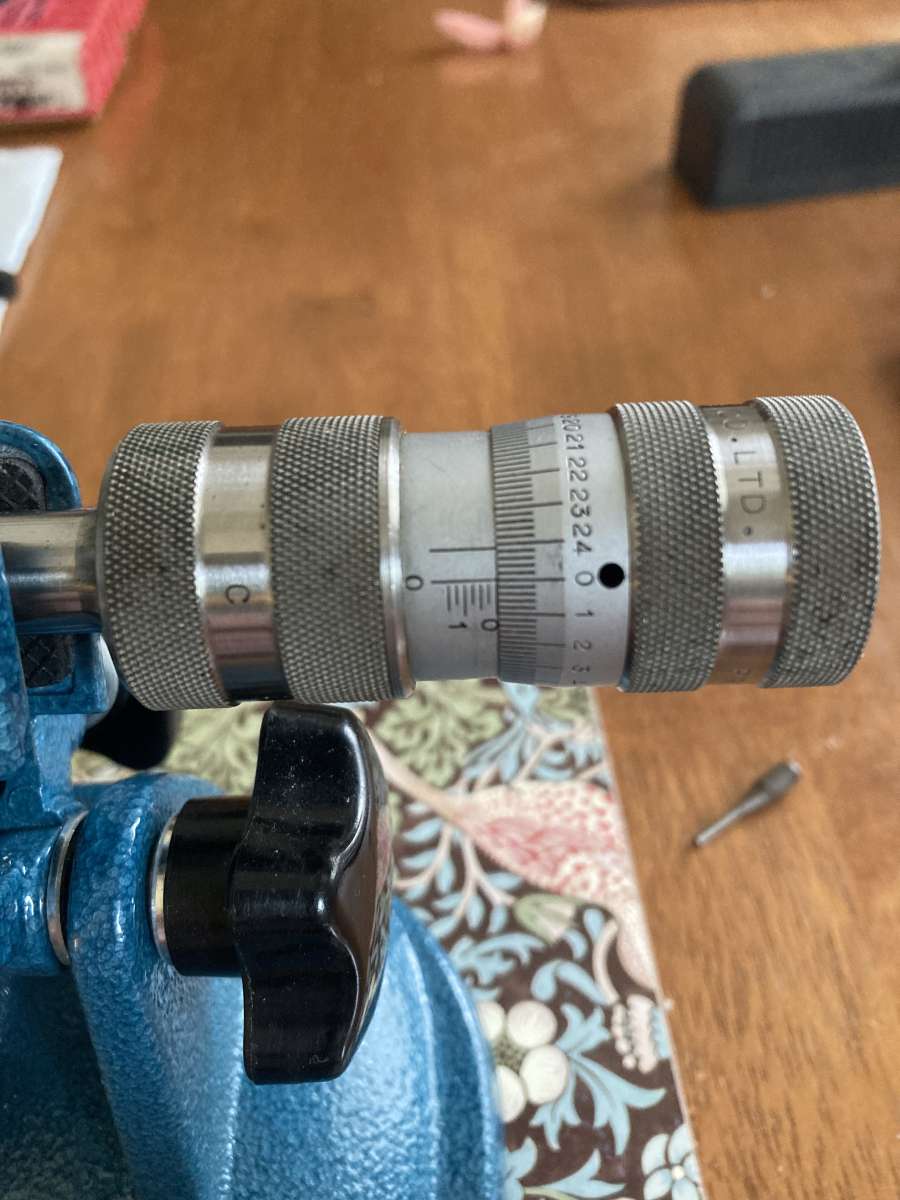

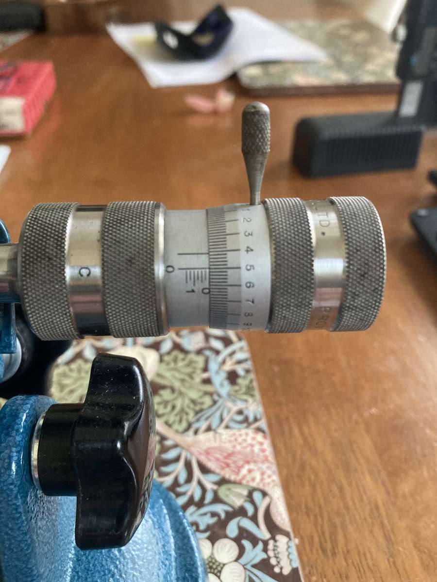

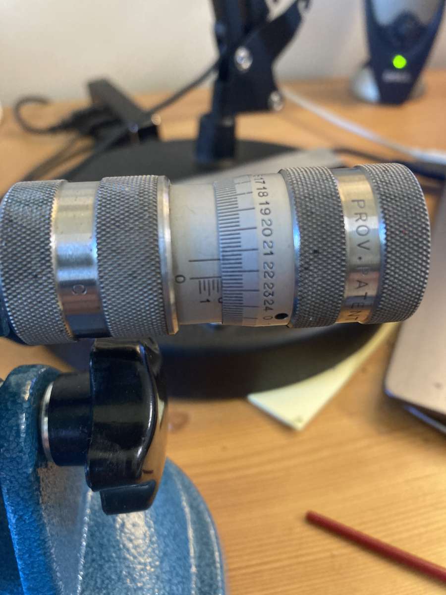

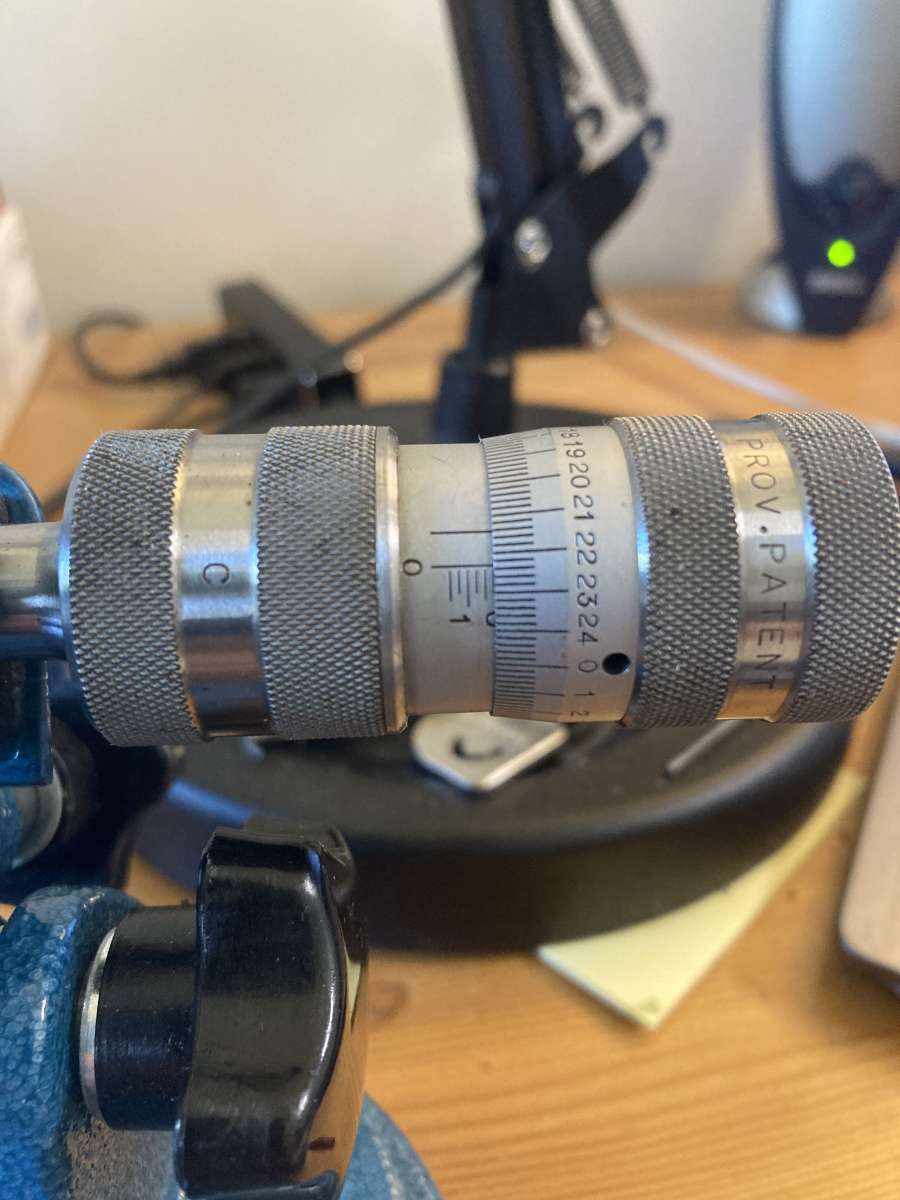

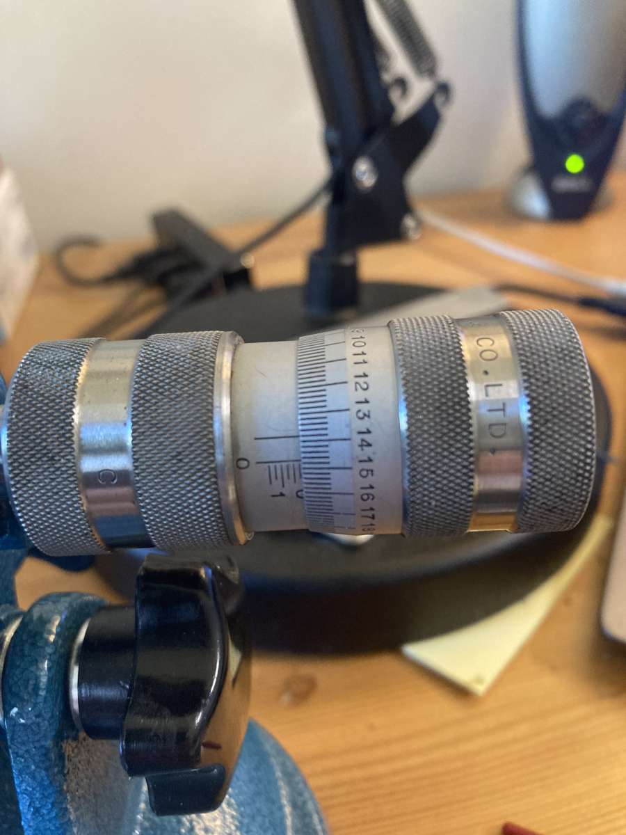

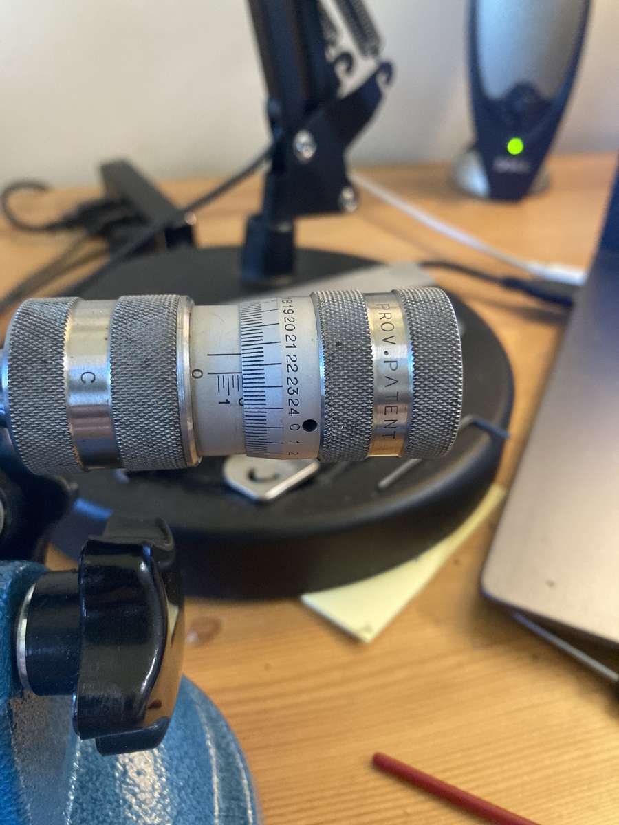

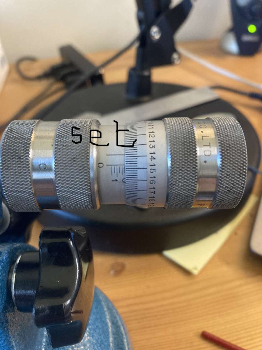

      Hi All, here’s an Offen, UK made, extremely well made bore gauge. Complete set, including a pin to engage/disengage the friction thimble. Measuring between 0.485/0.965, 0.080 between changes of anvils. There is a line above the datum zero which corresponds to 9/10ths, as a vernier would do. Photos show different settings but I can’t see the correlation between datum and vernier to read 1/10th. Each thou is divided for 2/10ths. I can see 1/2 a small division but that’s a guess, where is a true reading? Thanks, Graeme.IMG_4085IMG_4086IMG_4083IMG_4084IMG_4082

                Thanks for finding the threads Bill. Yes, I started these threads, one about the shardlow mic but the Offen one didn’t continue to tenths. Michael G sent the copywrite docs, but these don’t explain tenths either.  One of my photos with datum at 5 is slightly out of parallax. Strangely, having both cataracts done, I can see that the tool must be rotated to see the exact position of the top line even though they’re only 3/16″ apart. The upper line is there for some reason and on datum zero, it reads 9. Maybe the tool only reads to 2 tenths, but why the line? Going to 9 strongly suggests a vernier scale but there’s no scale at the line!! Move the thimble anywhere and nothing correlates to a vernier number. I’m mystified but enjoying trying to fathom this out. Graeme.

                  My thought is a vernier effect but to “half-tenths”, i.e. 0.0005″, only.
                  You could experiment if you have another bore-measuring instrument by comparing results of measuring various accurately-made items like bearings.

                    Unless I am not understanding what Graeme is saying I see no problem in reading the bore gauge ? The vernier is there only to split the 0.0002″ marks to 0.0001″ and to me the readings in the photo’s are: –
                    1 = 0.005″  [less a tad ! probably a photo parallax error ?]
                    3 = 0.0004″
                    4 = 0.0007″
                    5 = 0.0000″
                    The reading on the barrel would of course be added to those on the thimble — photo 5 shows zero

                      It is your one-tenth line. The reading on the main fiducial line is to the nearest 2/10ths, as each thimble graduation  is 2/10ths.
                      But if the thimble graduation goes past the main fiducial line far enough for that second short fiducial mark to line up with a thimble line, you add one tenth to the main reading, ie half a thimble graduation.
                      Hard to explain but much simpler to use in practice than the traditional 10 on 9 set of lines. It’s basically half of a 10 on 9 vernier scale with all the lines except the fifth erased.

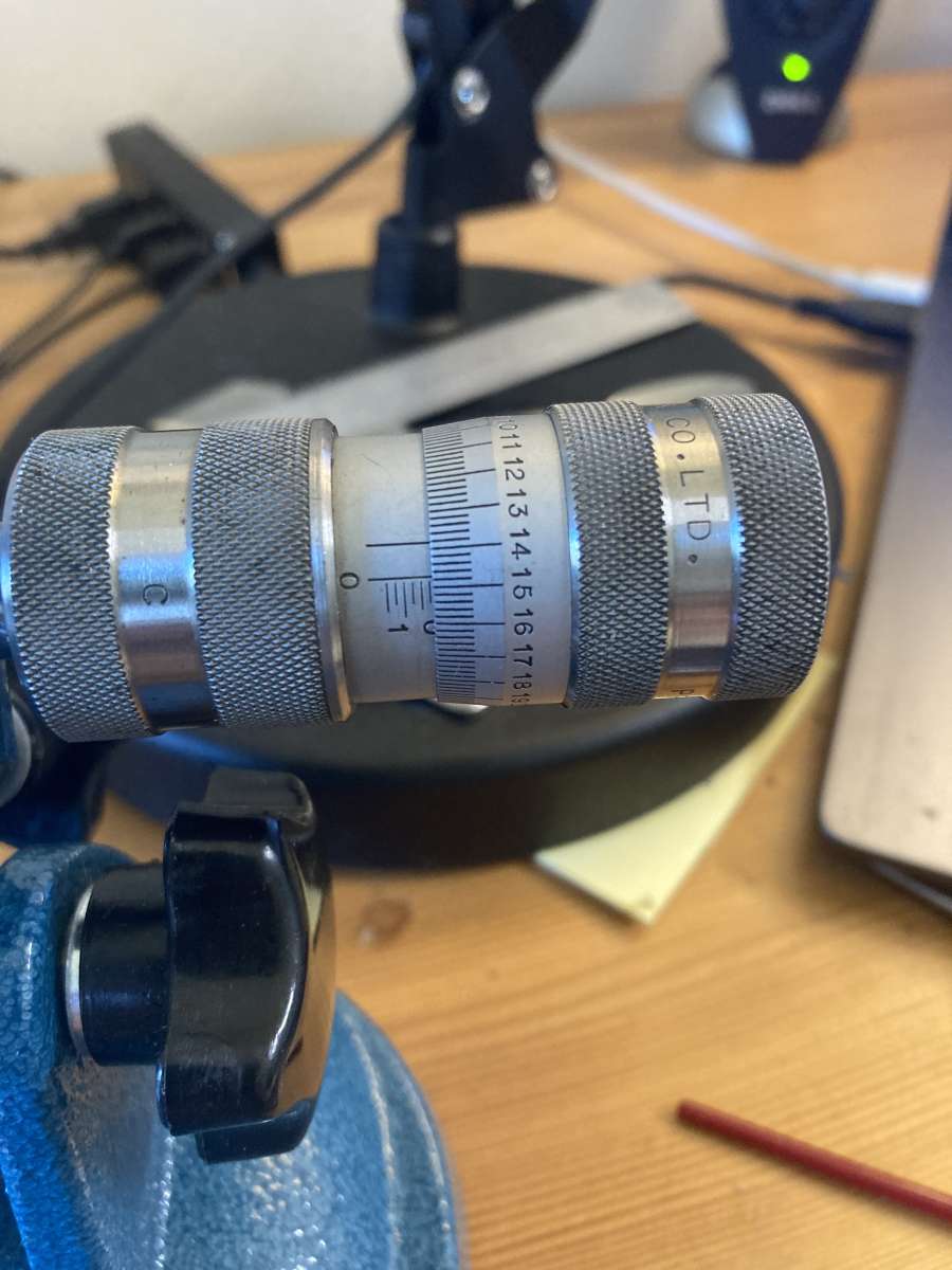

                        Hi All, many thanks for all of your contributions. Alecs and John F are almost spot on. You’re so right about the vernier line. Here’s my EURIKA moment and a few photos. Alecs mentions ADDING where my assumption is SUBTRACTION.
                        Here I go —— set any thou number to the datum, the vernier will always read 9 [subtracted 1 ]
                        Set the mic anywhere to the datum. In this case, between 14 and 15. Look at the numbered thou line IMMEDIATELY ABOVE THE VERNIER LINE, 13 , in this case. Count down the divisions from 13 > 14 to the vernier line = 4 = 8 tenths.   Now the vernier width size of 9/10 of a thou comes into action. SUBTRACT 1 from 8 tenths = 7 tenths. Read the datum = 7 TENTHS . This  method works every time.
                        Parallax view is most important,  the thou readings are obvious, the tenths are found by going to the immediate  numbered thou above the vernier line, counting divisions down to the line [ including  1/2 divisions ] and subtracting 1 to achieve the correct datum size.
                        Another example included. Graeme.
                        1 set to any size.
                        2 count back from 13 to 14 and minus 1
                        3 read result = 7
                        excuse  edit on photo, I don’t know how to write on a photo, please ignore.

                            1  Read the barrel in this case its 0.0000″  [it could be 0.025 or 0.050 or 0.075 etc where you would add this to the thimble reading instead of zero]
                            2  Read the thimble number before the barrel fiducial line 0.014
                            3  Read the whole tenths on the thimble 0.0006  then because the line does not coincide with the barrel fiducial —
                            4  Read the vernier –the number it lines up with on the thimble is of no consequence it just confirms that it is one tenth extra thus the reading is 0.0147″
                            Only simple mental arithmetic needed to make the reading and no different to using a standard micrometer with one thou readings on the thimble and one tenth vernier around the barrel.
