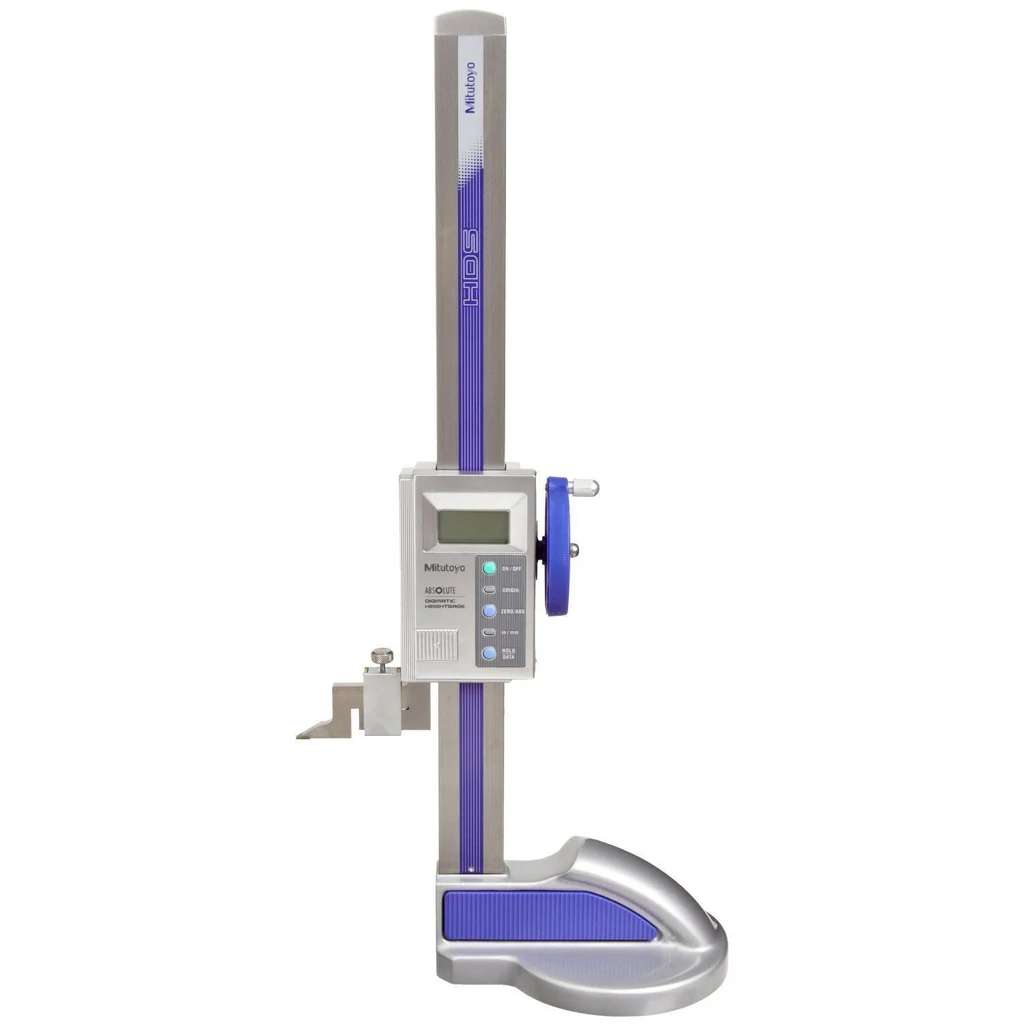

          • occasionally I need ±0.04mm, done with a digital caliper.  I use my milling machine’s table as the flat surface, usually with a square edge to ensure the measurement isn’t tilted.  When the milling table is too small, or the head gets in the way, I clear the bench and lay my glass-plate on top.  The glass-plate is much flatter than the worktop, but note that a digital caliper isn’t good-enough to get better than about ±0.03mm accuracy.
          • once in a Blue Moon, I need ±0.01mm accuracy.  For that a Height Gauge and precision blocks are needed.  For my unpretentious purposes ground parallels make good enough precision blocks.  A more serious player would buy new, not secondhand gauge blocks, and the real McCoy would demand they be calibrated.

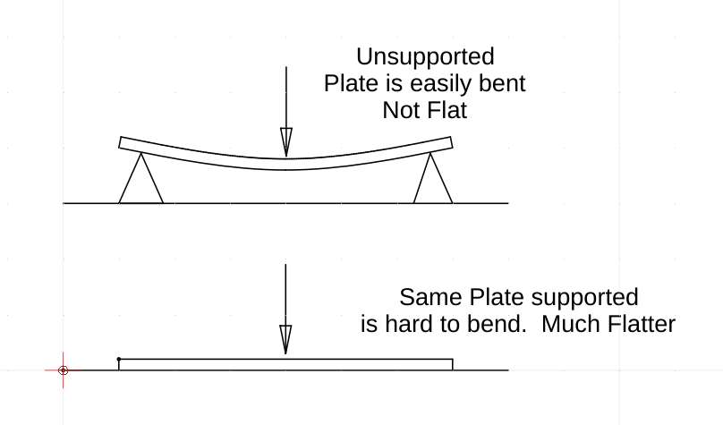

          Get rid of the feet!  Problem is the granite board bends under the weight of the workpiece and is no longer flat.  Put a DTI on the middle and press hard with a forefinger to see how much a granite chopping board dishes.  Easily fixed, remove the feet!

                Thoughts on the flexing of the surface under load:
                The amount of deflection under a given load is inversely proportional to the Youngs Modulus of the material.  Glass and granite have similar values of the modulus so there will be negligible difference between them.  The deflection of a sheet of the material is however inversely proportional to the cube of the thickness, so it is important to make your surface plate as thick as possible.   A granite chopping board is usually about 1 cm thick.  If you can get hold of an offcut of granite worktop about 5 cm thick it will be 125 times more resistant to deflection.
                Putting it on a wooden worktop, however flat will not improve the strength of a 1 cm thick glass or stone plate noticeably.

                      All true, except laying the glass sheet on a flat surface isn’t done to improve it’s strength.   The purpose is to minimise bending by taking the load force straight to ground:
                      Screenshot From 2025-12-03 08-40-36
                      In other words, if a cutting board has feet, take them off and support it underneath.

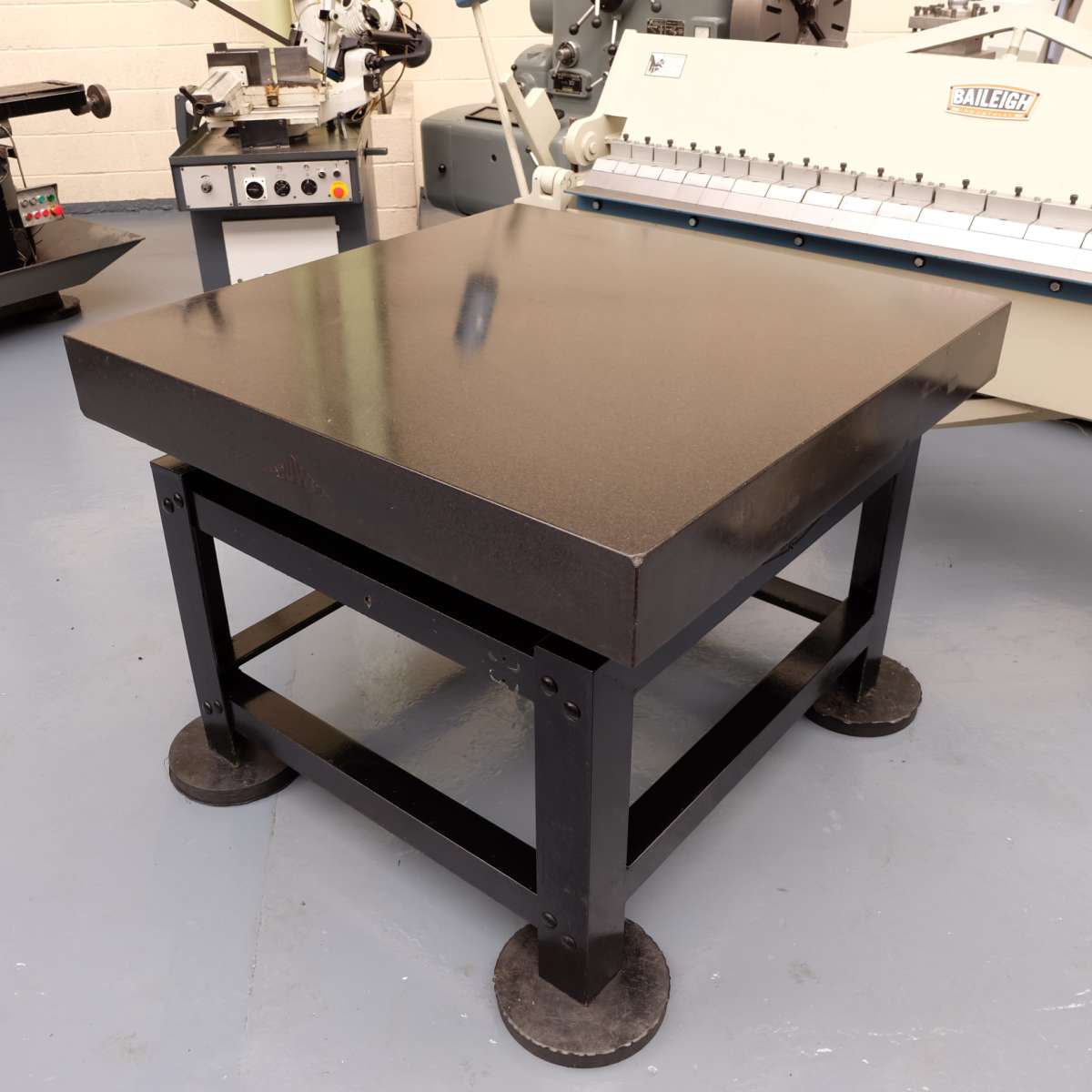

                      Russell’s point applies to this form of surface table:
                      graniteTable
                      Note the thick granite plate, the very sturdy table the plate sits on, and the load-spreading feet.  There are beefy levellers hidden under the plate too.  This is the real McCoy, not only flat to a specification, but designed to take a heavy load without bending.  Accurately measuring an engine block is a far cry from using a sheet of float glass to do some unmeasured lapping.
                      A sheet of float glass does all I need, and I look askance at chaps buying battered second-hand cast-iron surface-plates, perhaps bent after being leant against a wall.   To my mind they are neither fish nor fowl!  Overkill when ordinary methods are good enough, and insufficient when accuracy matters.   I wonder how many of us happily believe we’re working to tenths when we’re not? The acid test isn’t what our micrometer says, it’s other people measuring our work and getting the same result!  Much harder to do correctly and rarely tested.   Fortunately, accurate precise measurements aren’t required for most hobby purposes:  little need for Model Engineers to apply the American System of Manufacture.

                                                  …most of us don’t need 600 x 400, or 800 x 600 sized surface plates…
                                                  Best not to make assumptions; my Crown Windley surface plate is 36″ x 24″ and is definitely not too large.
                                                  Surface plates are like milling machine tables. Just because a mill table has X millimetres of travel it doesn’t mean you can mill a workpiece X millimetres long.
                                                  Julie

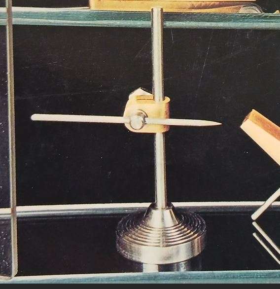

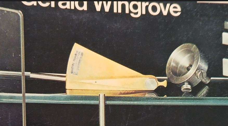

                                                    but we’re not woodworkers,
                                                    And there was me last week adjusting the CAM so the CNC would take an extra 0.05mm off two sides of a WOODEN part. When you are trying to fit 68 of them around a circle the add on effect of 67 being too large means there is no way the last will fit.
                                                    As for a 10ths dti I originally managed with a home made one of these, still don’t have a 10ths dti but just 80 odd engines that run. The first built (10V) will still run if I blow into it yet at the other end of the scale is hapy at 1000rpm generating.
                                                    indicator
                                                    My height gauge was from the same book, set from a steel rule. Point was a bit of freehand ground piano wire. Can’t remember what I used as a surface, probably the formica covered blockboard bench I was working on.
                                                    height

                                                    southernchap
                                                      @southernchap
                                                      On Julie Ann Said:
                                                      Julie
                                                      Might I draw your attention to an important word in my post?
                                                      That it was you in particular who posted such a correction made me chuckle! When I wrote that part of my post, you popped into my mind as definitely a member of the set that my above quote wouldn’t apply to, thus the use of the word “most”
                                                      No assumptions made or implied. 😉
