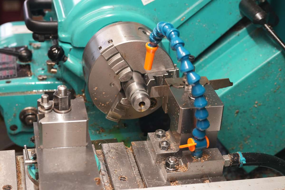

      So I’ve got a Boxford pump for my CUD and now I’d like to plumb it in.
      Whats the best current bet for the coolant applicator / tap? Theres a bewildering selection of nozzles and applicators on amazon and the like, misters, magentic bases, multiple heads….what do I need for simple DIY machining operations, mostly aluminium?
      Thanks Neil

            You do not say what volume (flow rate) of coolant you require nor how often you wil use it.
            To use a standard centrifugal pump needs a reservoir. The pump must then fill its cavity and delivery pipework before anything emerges from the squirter. Then the coolant has to cover every available surface of the lathe before finding its way back to the reservoir.
            Coolant not in circulation goes bad – modern synthetics are much better than older potions, but come with a premium price tag.
            Hence, if you are only using it once a week, for 20 minutes, a flood coolant system using the pump you have may not be a good idea. A much smaller arranement, a total loss system, (the ex-washer bottle above) might suit you better.
            Long and short a coolant system needs management.. It is not like a DRO, fit and forget.

                DSC01172
                Oil fed from a conventional centrifugal pump arrangement and recirculated to tank. I only use CORA B neat cutting oil.
                JA
                CORA B does not go bad and this is a fit and forget system. To be honest the actual cutting oil also contains the lubricating oil and cleaning white spirit from the lathe.
