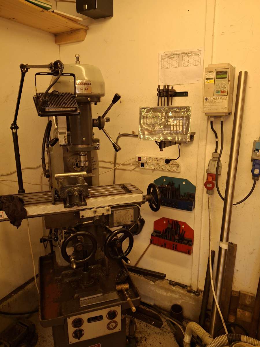

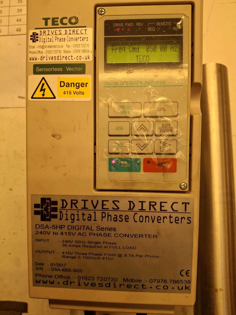

              I have used this converter that came with my Omnimill, it works just fine. No drop-outs. I replaced the  .75hp motor with a 1hp motor on the vertical drive.
              Regards
              Wade

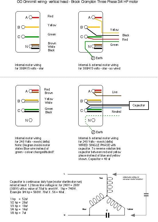

                  This is how the main motor was rewired on my Omnimill if it’s of interest. I didn’t bother with anything else as a house move meant I only had the machine for about a year and sold it on. Good luck with the conversion, they are a fantastic machine for home use. I did a lot of good work on the machine for the time I had it and had no issues with the motor at all running on 240V single phase.

                      I still have to break into the star point to replicate your wiring diagrams.  I am not yet committed to inverter drives on both spindles – it depends a bit on what inerters are around at what price but Mr Steinmetz is always an option.  However, on the basis of the pump the starting torque is clearly an issue.  I agree the Omnimill looks to be a great tool and can’t wait to cut metal and find out.

                        Martin, it may not be the best solution but I was on a very tight budget when I bought the machine so £12 for a large capacitor was a no brainer. I did some good work on it and sold it for what I paid for it when I moved house. For such a small foot print it’s an incredibly versatile machine. I’m sure you’ll really enjoy using the machine once it’s set up the way you want it!

                                  I thought when I saw Wade’s picture last month that the not uncommon corner position for a mill made the horizontal drive belt changes impossible. However with a variable speed drive that becomes mostly unnecessary making the investment in a VFD pay back in saved workshop space. Tightening the horizontal drawbar must be a little tricky.

                                    I use the horizontal drive very seldom, yes it is a bit tricky. but quickly done.

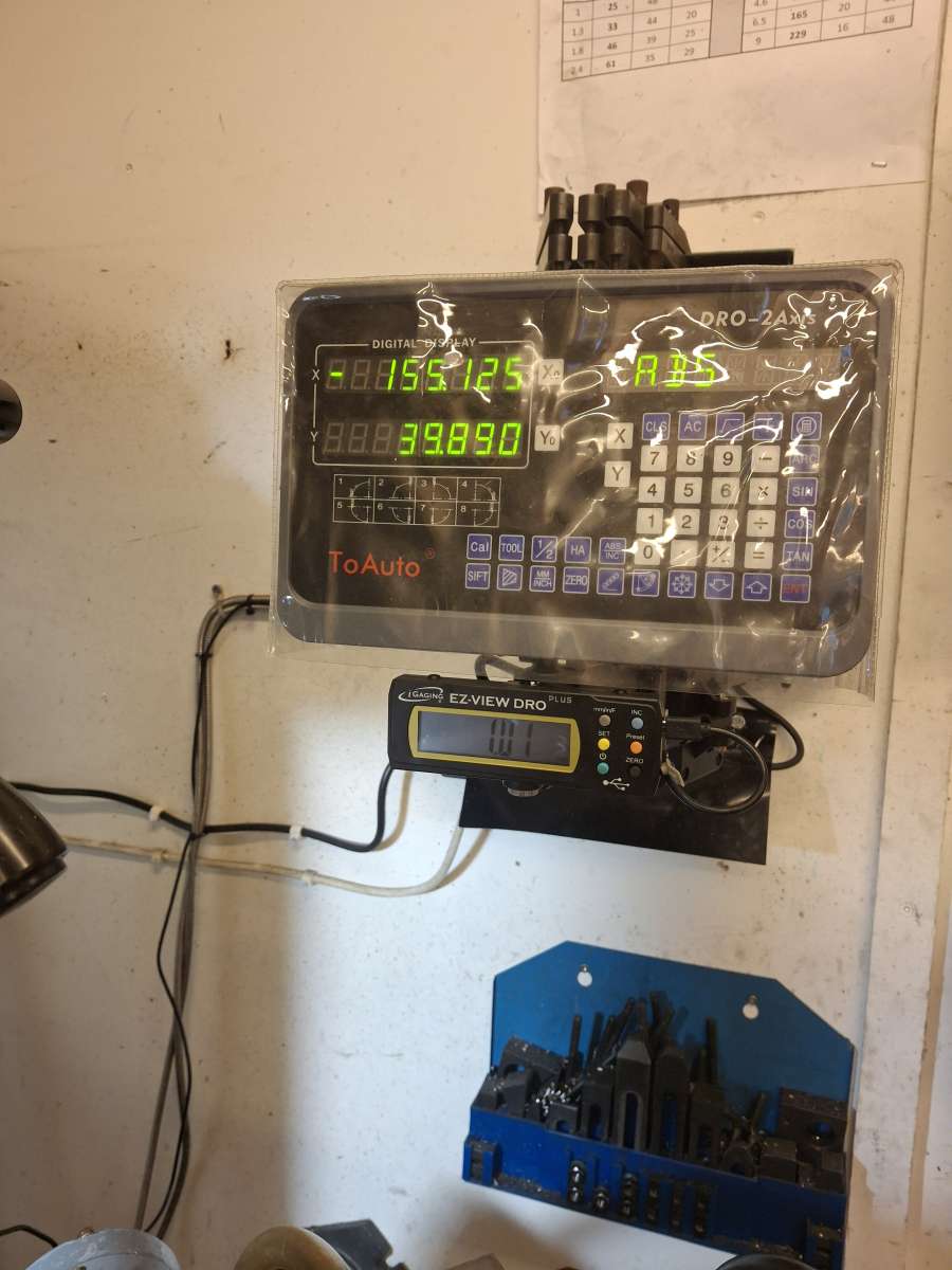

                                        No the DRO prevents the X axis stops from being installed. It came thst way and I have considered moving it behind the table but have not done anything about it.

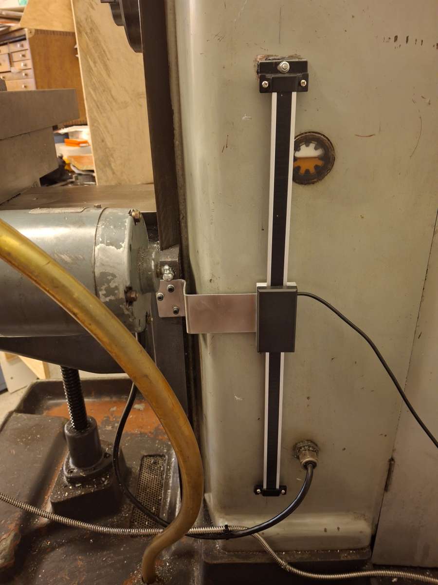

                                        I just purchased a linear DRO for the Z axis and am very much looking forward to using it. I will send photos on how I fix it to the mill column. I have been away most of the summer so the honey do list has to be tackled prior to workshop time.

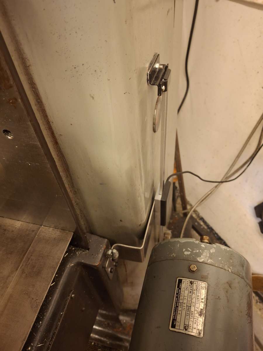

                                            Last weekend I fit the DRO to the Z axis on my Elliott 00. There are not many locations for this, I had to be a bit creative. The bottom of the scale is fastened with a drilled and tapped hole for a 4mm bolt, the top is at the oil resevoir height so no drilling there. I cleared the paint from the column and epoxied a thin aluminium piece with a flathead bolt to the column to secure it. I bent a piece of stainless as a bracket back to the knee secured with 3 short 4mm bolts. Pictures attached, works very well. The photos make it look out of vertical but it is not, just the camera close in.
