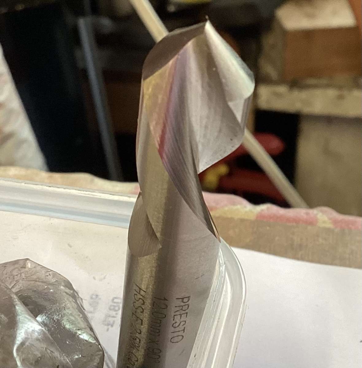

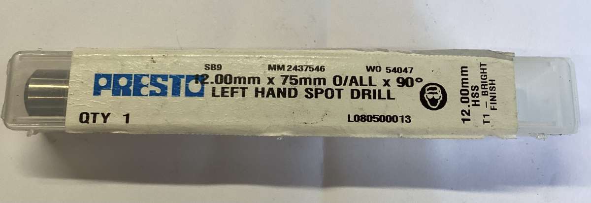

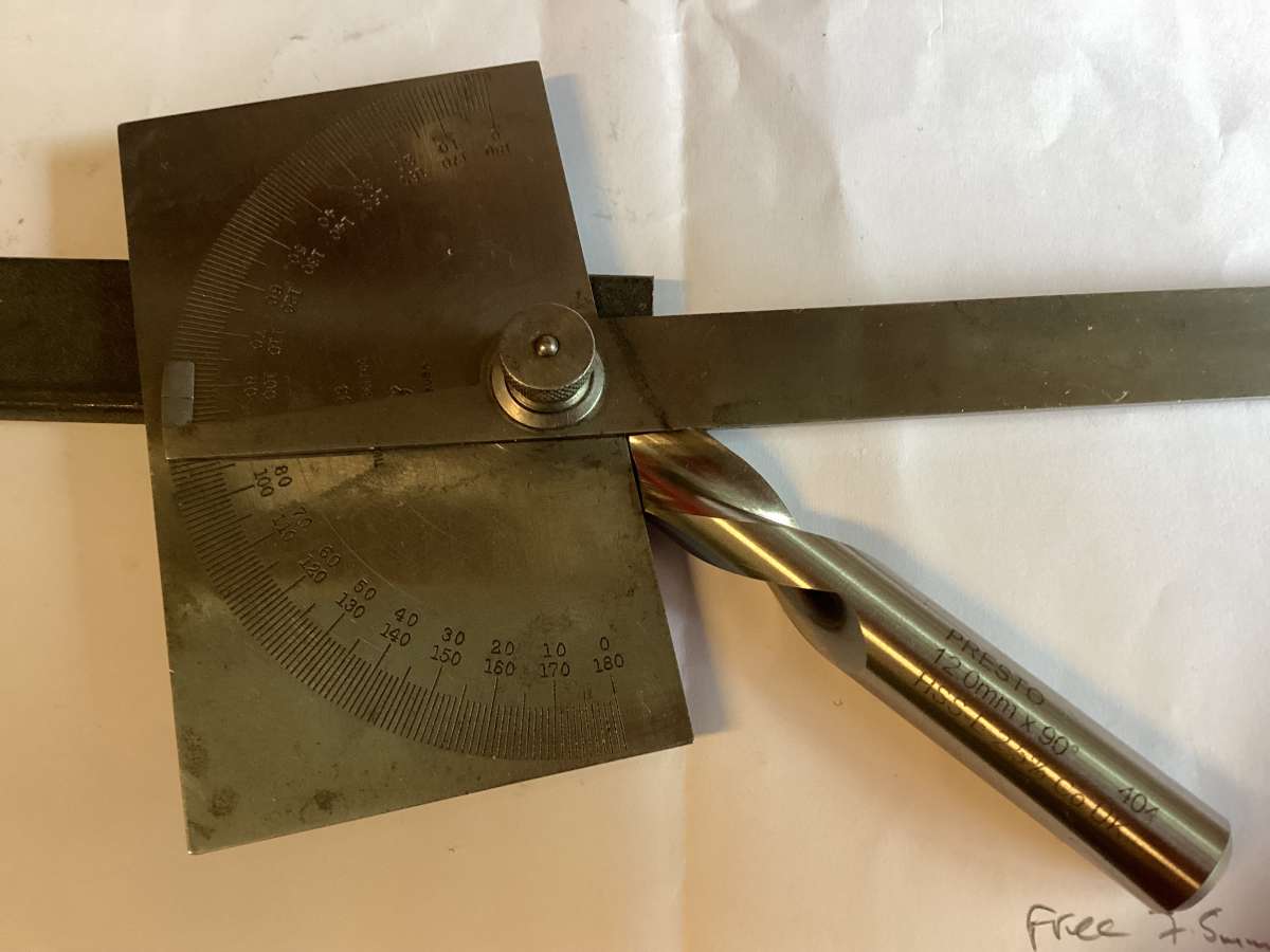

      I recently bought a new spot drill (pictured) off ebay.
      Can anyone explain the lack of correspondence between the marked tip angle and the actual one?IMG_21412IMG_2140

        Used, reground, put back in it’s packet, and sold? ..the box looks a bit ‘handled’..

          I think that’s unlikely, Diogenes, though I understand your cynicism; the drill is its full 75mm in length, the tip grind looks factory-like for its evenness and smoothness, there are no signs of use on the shank or the lands, and the seller tells me all the stock of these drills he has have visibly the same tip angle.
          82 degree spotting drills do exist (presumably in both LH and RH), but I’d expect them to be marked as such, not marked 90 degrees. I can only assume this was a batch that got marked 90 but was ground to 82 degrees.
          It can be used for screw extraction and to countersink for UNC/UNF screws if nothing else.
          Now I just want some 140 degree spot drills, which seem to be rare as hen’s teeth in HSS, and ludicrously expensive in carbide.

              Presto only seem to list 90deg so less likely to be marked wrongly, have you contacted them and asked why?

                  Apart from several spotting drills in HSS and carbide which are a pretty good 90 degrees, I have a 5 or 6mm carbide with the 140 degree end. It rarely gets used as the shallow angle makes it more of a blind spot drill.

                                              It’s a bit worse than that, Chris  … look at the markings on the shank

                                                And the point angle of my “VG” 6.0 x 90 HSS Co spot drill measures 90 degrees as near as I can tell.

                                                  I’d missed the shank engraving Michael. So I guess it was either mixed up during manufacture or it has been reground.

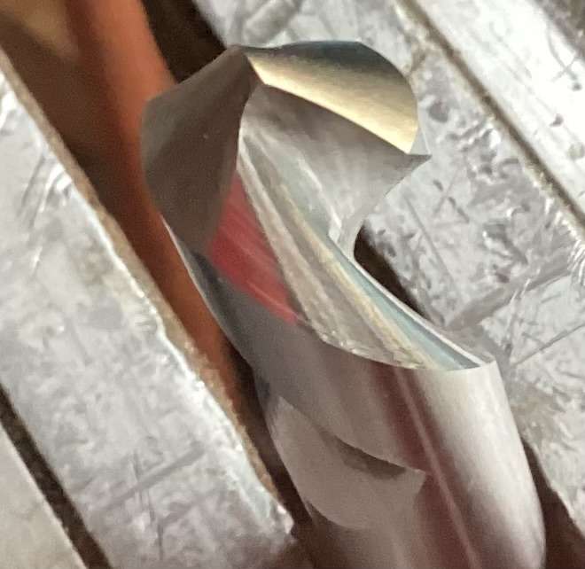

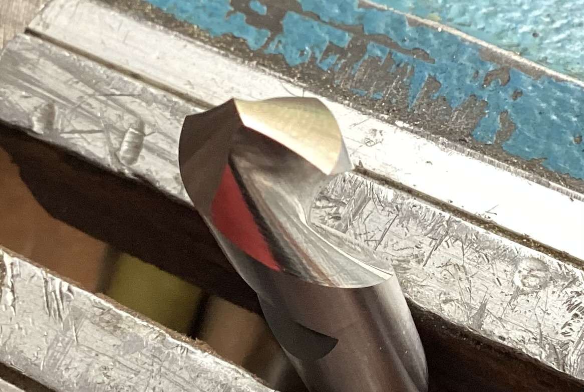

                                                    Below are a few photos of the tip. If you can detect faceting anywhere on the drill point, there is none; it is a trick of the light. Also, there was not a trace of dirt or swarf anywhere in the box or on the drill. I’ve seen plenty of meddled with drills being passed off as new; this isn’t one of them.
