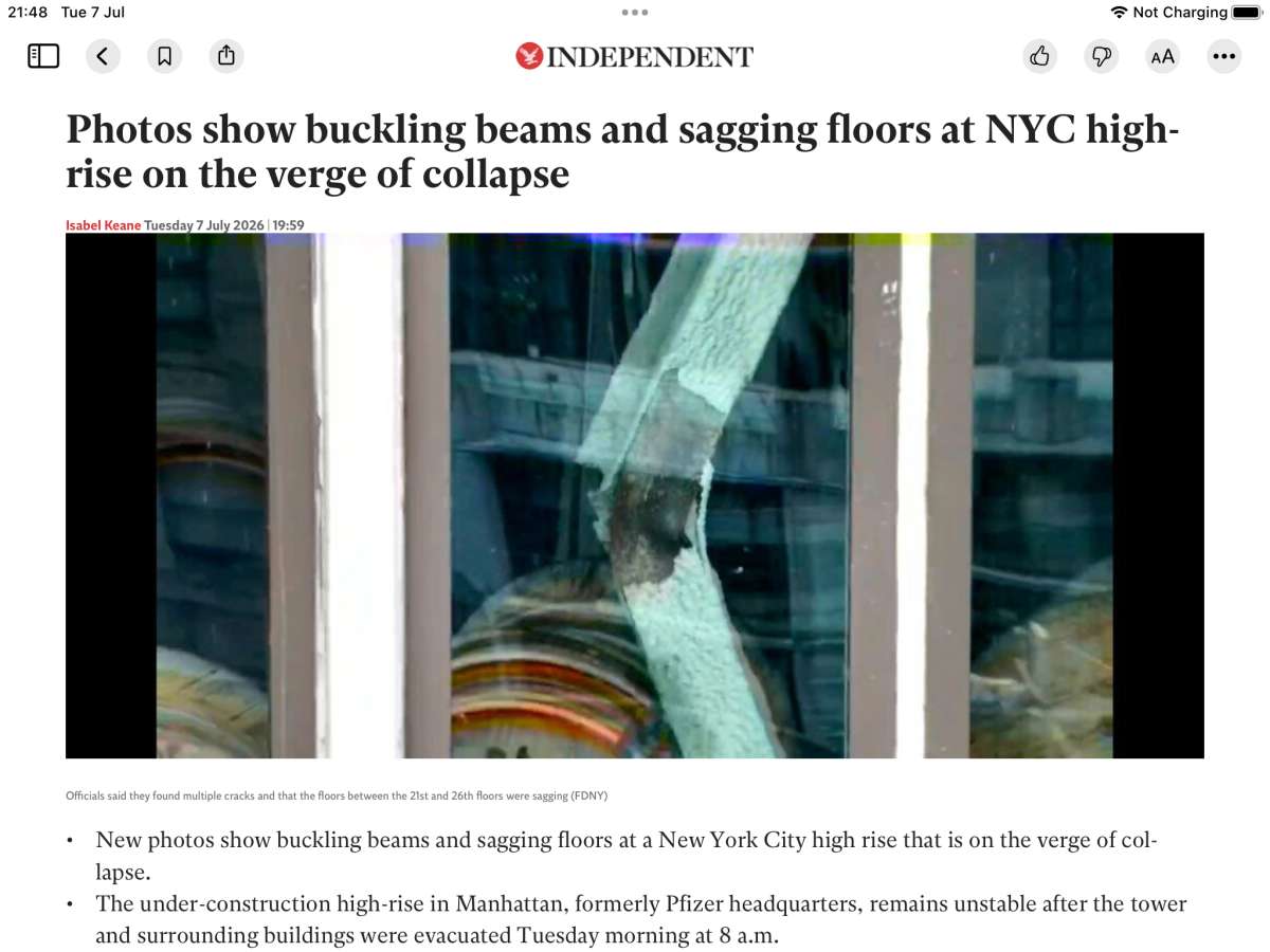

      Shocking image in today’s News

        A building still under construction… not an old one that has deteriorated over many years, then.
        Ye Gods.
        #855325
          Actually an existing office building that is in the process of being converted into Apartments.
          The potential scenarios are terrifying … at least they’ve spotted it early.

              Hopefully a UC rather than a beam but it looks to have corroded rather than just buckled under load as there is a big bit of the flange missing. Hard to think this would not have been visible unless the column was concrete clad or boxed in and the concrete/cladding was removed as part of the conversion or possibly to inspect for possible signs of corrosion. Must have been something leaking on it for an internal steel to rust through. Or is the light grey some coating (fireproofing) on the steel that has spalled off with the deflection?
              Just hope they were not intending to put a swimming pool on the roof!

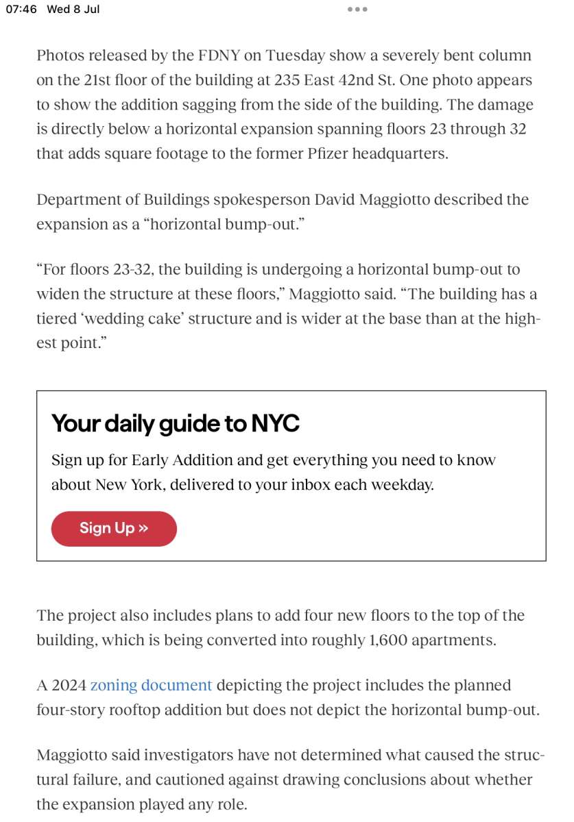

                A bit more than a swimming pool, Jason !
                here’s a clipping from The Gothamist

                      Yes Universal Column, more stable in all directions than a UB (you can work that out) when used vertically.
                      I did see the other floors going on to from Howard’s link, just thought a pool would top it off nicely.
                      I suppose it is possible that the top column of the existing structure had a lower bearing capacity than the ones below it as it would have originally only needed to support roof loads not floors. That is assuming it is an original column and they have not had to run new all the way down to new foundations.
