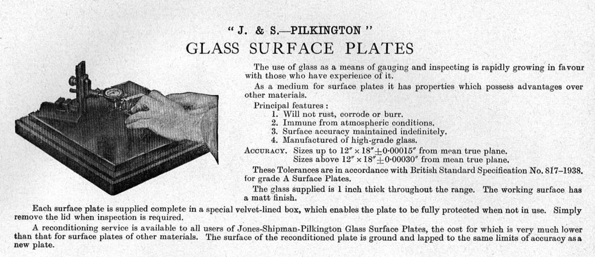

                                                Nicholas Farr
                                                  @nicholasfarr14254
                                                  Hi, Maybe something like this would be ideal.
                                                  Scan_20251126
                                                  This is in a 1963 catalogue,
                                                  Regards Nick.
                                                  #826530
                                                  Bill Phinn
                                                    @billphinn90025
                                                    I think they’re probably even harder to source than good condition lithostones, Nick.
