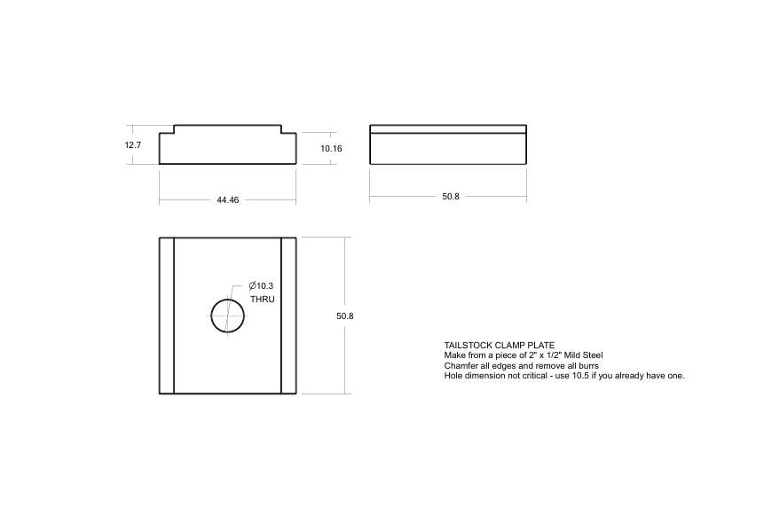

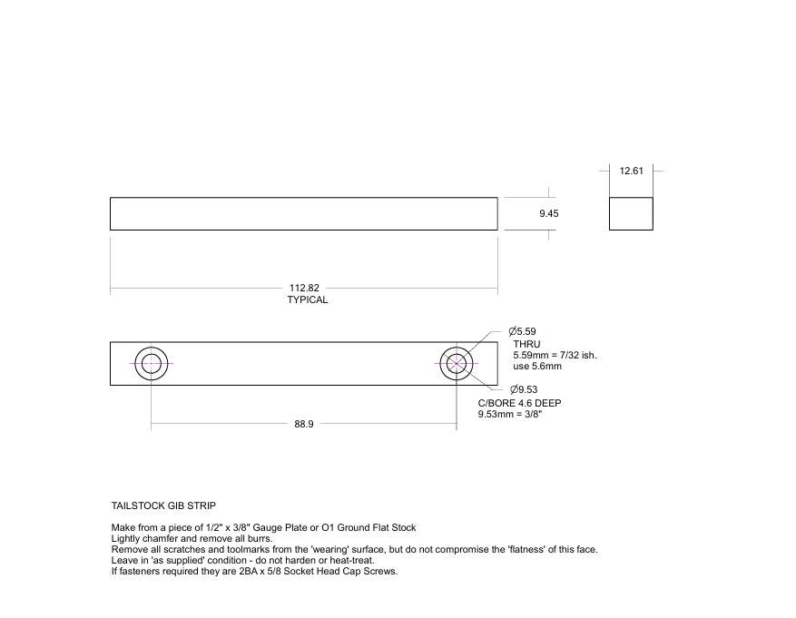

                  Hi. Would the drawings for the ml7 tailstock clamping plate and Gibs plate be available?  I inherited an ml7 but they are missing. Many thanks.
                            I think this 3-year-old thread was resurrected by smav with his request, above;
                            The parts you describe are, I think
                            Clamp Plate – P/no. 70/1514
                            Gib Strip – P/no. A2136
                            The gib is available from Myford for £12;
                            https://www.myford.co.uk/product/m27-gib-strip-a2136-2/
                            or from their Ebay store – can’t remember what it’s made of, or whether it’s ‘hard’/ground.. anyone?
                            The Clamp plate is a simple rectangle of steel with a threaded hole and rebates on the top edges – unless anyone beats me to it in the meantime, I will go and measure-up (both parts) this evening after work..

                                    It’s such a pain working in mixed measurement systems 🙂 Try these
                                    ML7 TAILSTOCK CLAMP PLATEML7 TAILSTOCK GIB STRIP
