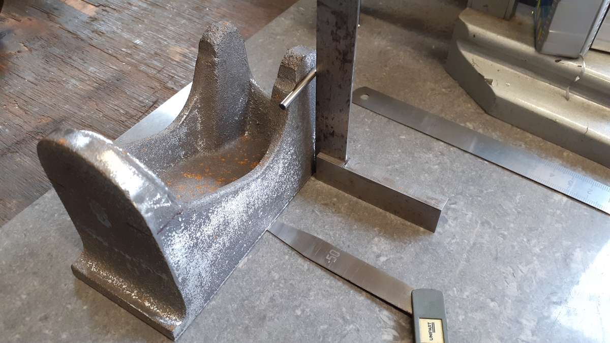

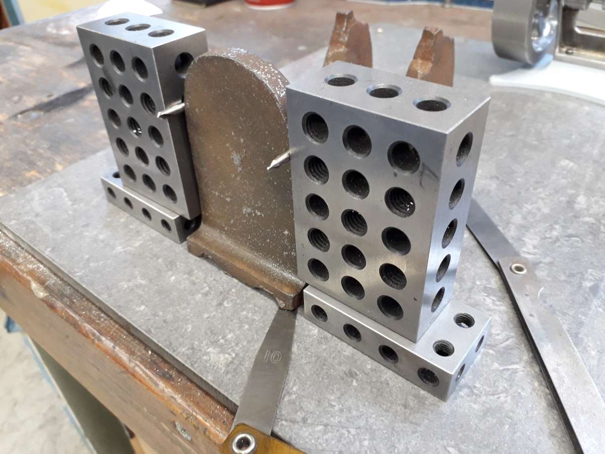

                    There are a couple of other considerations when it comes to what to use as a surface. Those with a small workshop may not have the room to have a large piece of cast iron or granite taking up bench space that would be better used for machines or just good old bench top. Quite easy to slip a piece of glass or tile out the way when not needed which is something I do fairly regualrly.
                    Also as many of us get older having to move 30plus Kg of granite out the way becomes more difficult, so the 10-12mm thick glass or tile is a lot easier to move about.

                                                      I can’t say how you successfully hit those tolerances, if you were relying on a piece of float glass as your reference surface.  Maybe you did an awful lot of fitting and fettling, maybe you didn’t use the float glass for a reference surface.  I don’t know, to be honest with you, whilst it would be interesting to read about, at another time, what I care about is people who are unfamiliar with metrology being given a less than ideal perspective on the facts about what is available to them.
                                                      Have a read of the thread again, many times I mention that i use a porcelain tile as my “flat surface”. Starting with the 4th post in this thread not a piece of glass.
                                                      Not sure if I said it in this thread but I do say quite often that I don’t do a lot of marking out. Mostly I will locate edges or ctr of a workpiece on the mill and use the DRO to set the position of various features. Generally more accurate than marking lines, punching their intersection and then picking up that punch mark.
                                                      As said here I will then take measurements of the work if needed and determine how much more to come off. I very rarely mill to a line that has been marked out on a flat surface.
                                                      Generally I do very little fitting to flat surfaces, again as mentioned they are straight off the machine to my usually calliper measurements for length and thickness, etc Most I may do is lay a bit of wet & dry on my “flat surface” and rub a port face and valve on it to get a finer finish than that straight off the machine not to flatten or correct a wonky surface.
                                                      I rarely use a flat surface to measure anything with a DTI and even then I only have ones that read to 0.0005″ not tenths.
                                                      What I may do when initially starting on a casting is sit it on my flat surface so that I can shim it up to get a “best position” just using a height gauge as a comparitor, squares against the sides etc. Then I transfer to the flat mill table and set the part up with those same shims and start cutting to establish datum faces on the work. I might scribe the odd line onto the casting to get an idea where holes and other features may end up but this is all rough work, they will have their actual position located from the part once a flat surface or two has been machined on it.
                                                      So although it is worth understanding tolerances and metallurgy and what is available, it is also worth knowing when and to what degree they need to be applied if at all. That can come with experience.
                                                      Hard to quantify what finish I get so I can only go by the fact my engines work, I have got medals and commendations when they have been entered in competition and people also want to pay me to make models for them
