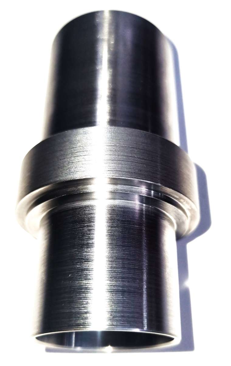

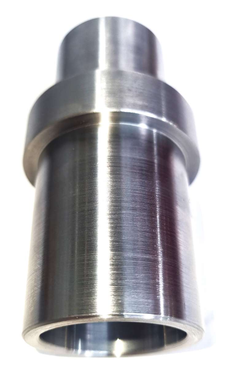

      Here we have the cylinder blank machined from solid 2 1/4″ bar stock 4140 steel.
      20260511_14020720260511_140216
      Next mission is to machine in the ports, then we’ll be onto the honing and final lapping of this monster.
      Until next time
      Dean

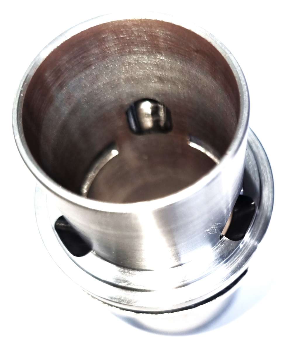

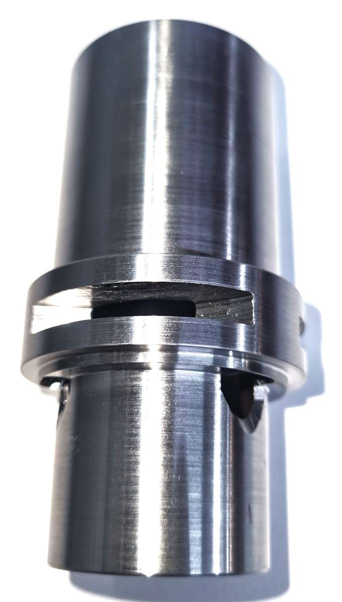

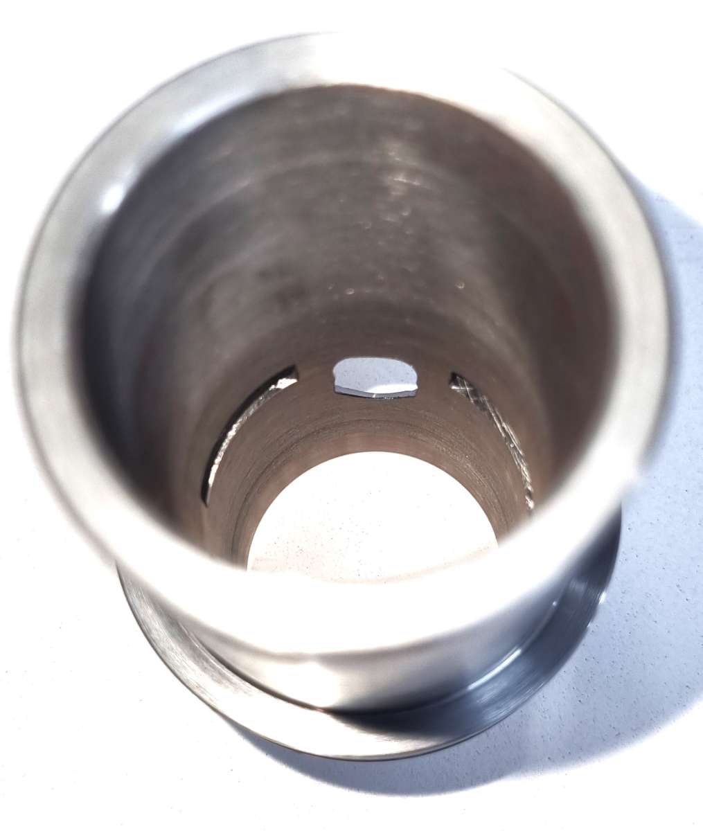

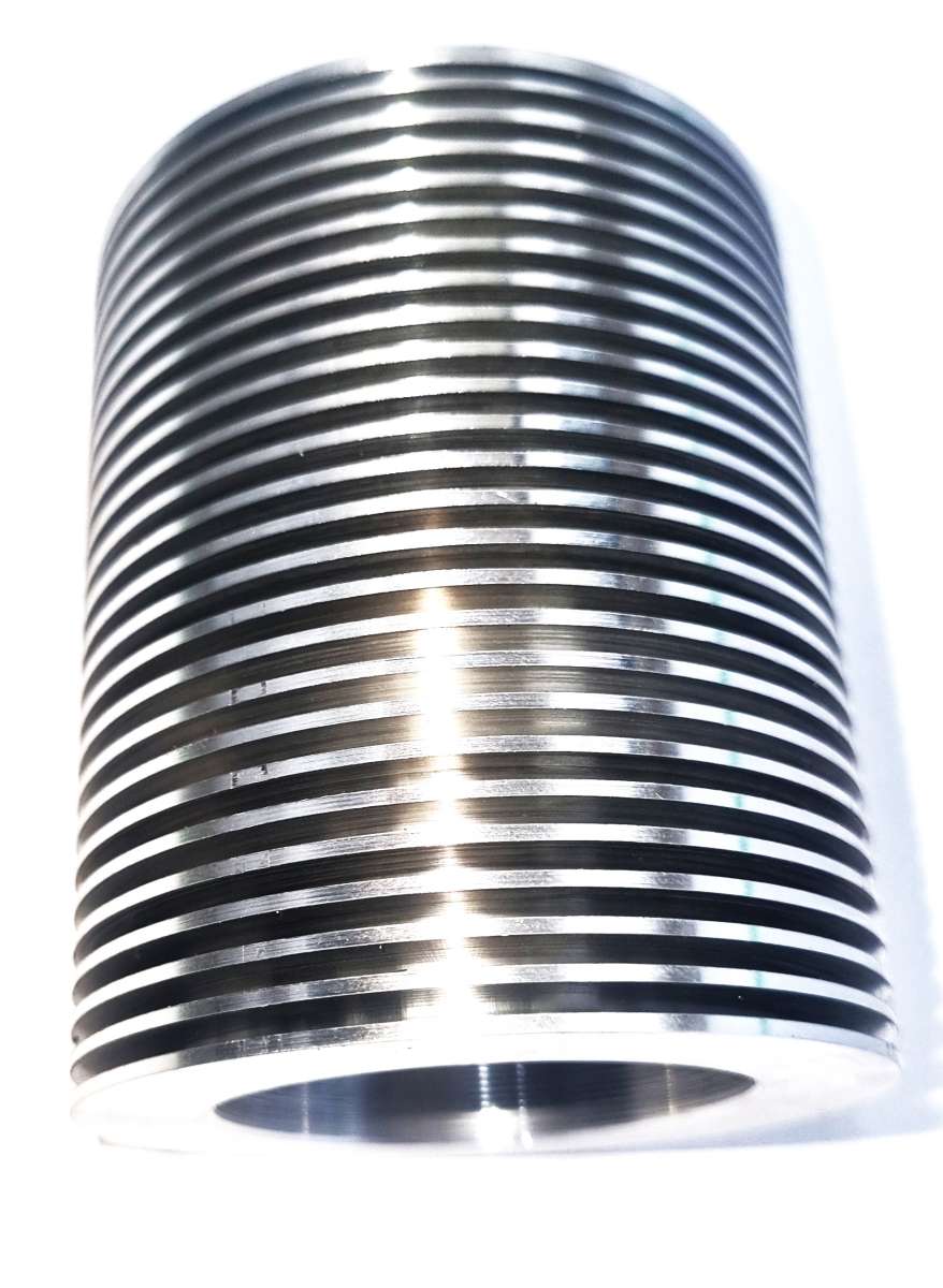

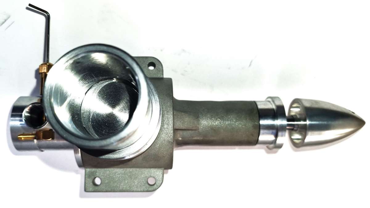

            OK so finally been able to machine the ports into this giant cylinder liner, so here’s the latest update.
            20260604_155115
            20260604_15510520260604_155124
            next step is to finish lap the cylinder and make it ready to take a piston and contra. At 32mm bore that’s going to be an interesting task.

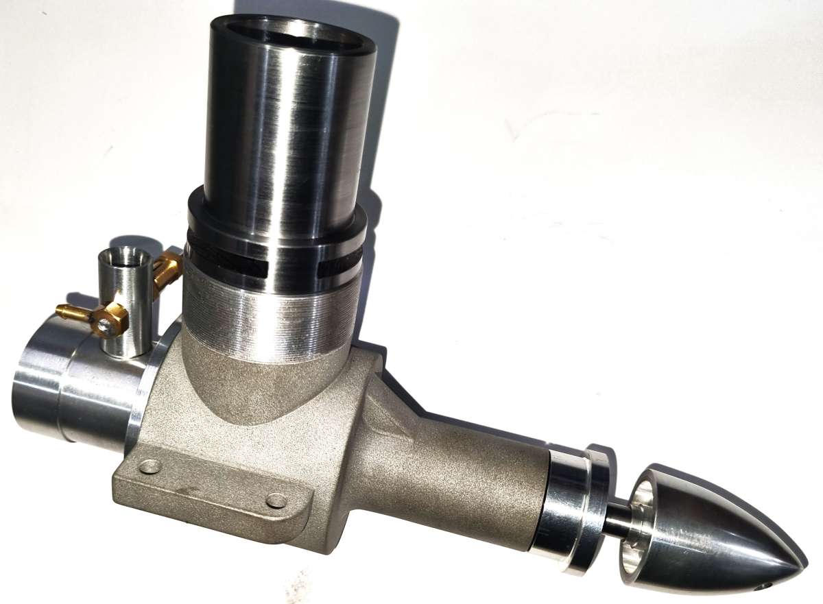

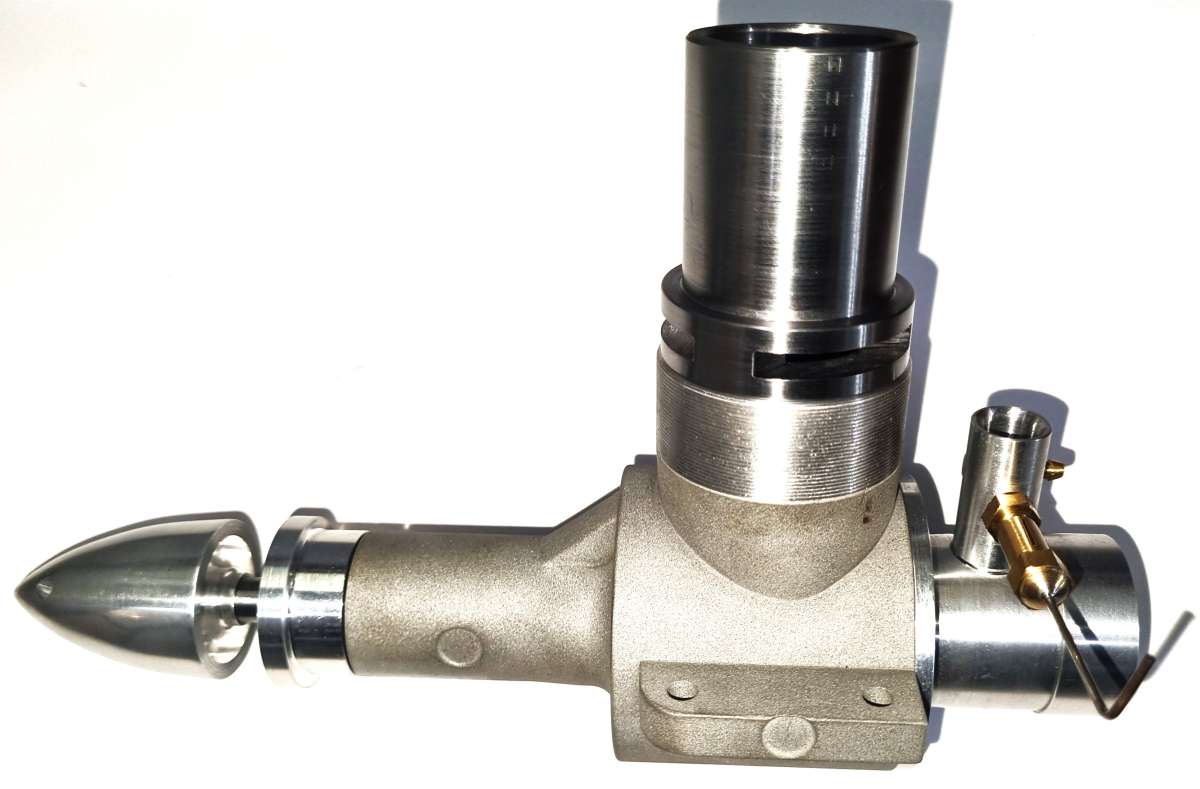

            Here’s a quick look at the cylinder test fitted into the rest of the crankcase assembly.
            20260604_15545920260604_155515
            After lapping the cylinder I’ll start on machining up the components for the compound piston assembly.
            Until next time,
            Dean Clarke

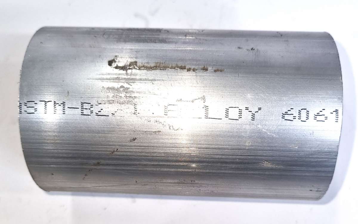

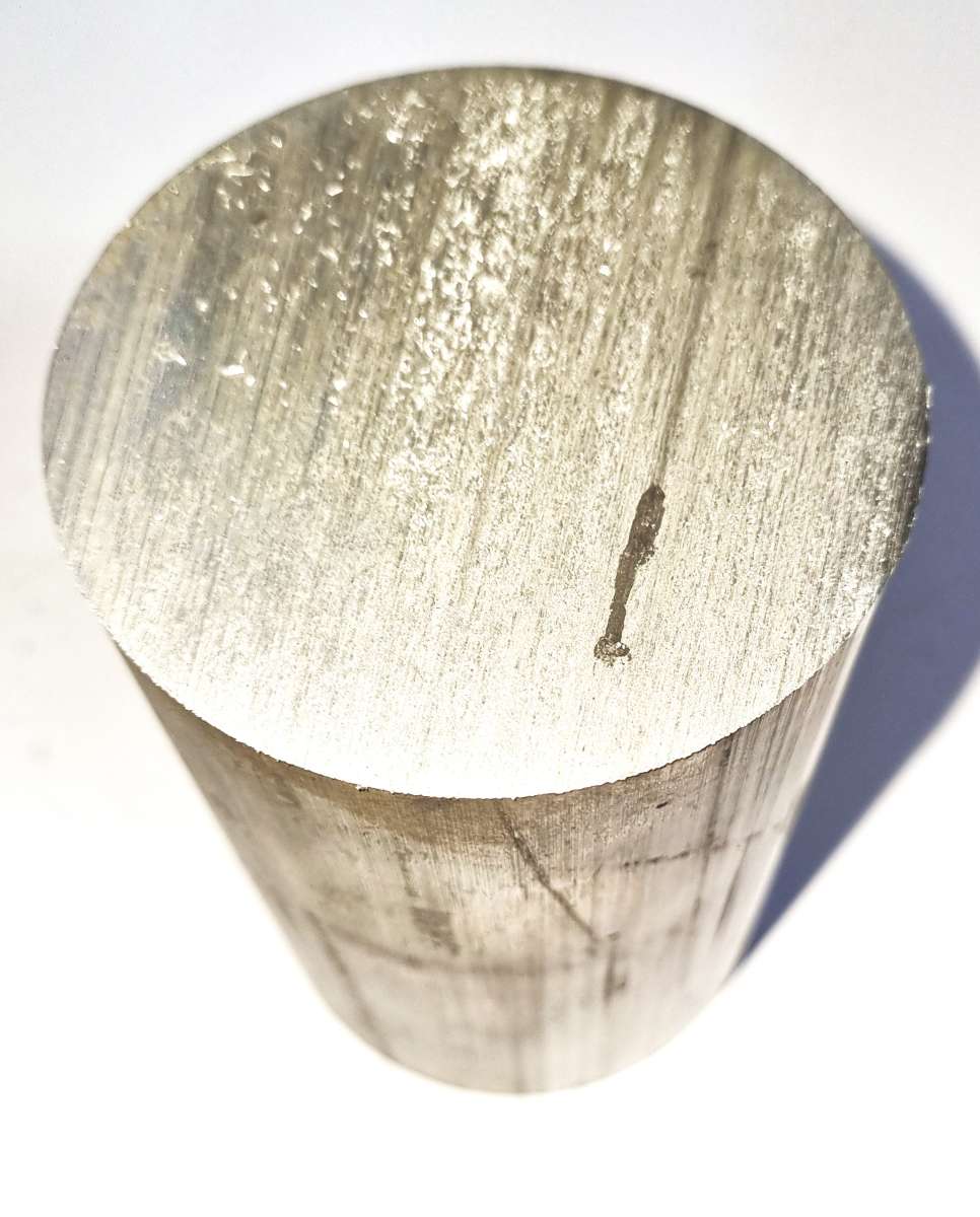

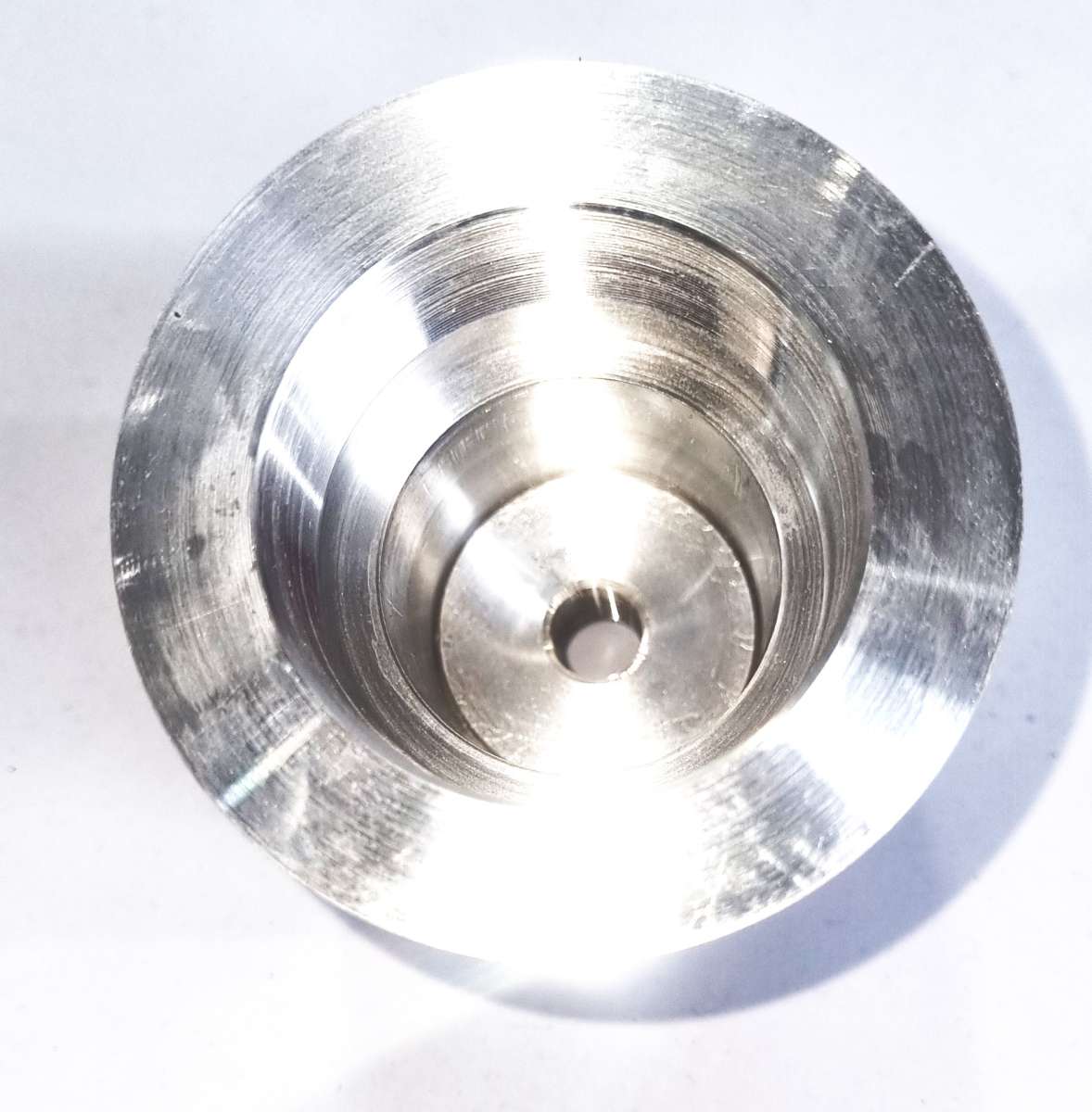

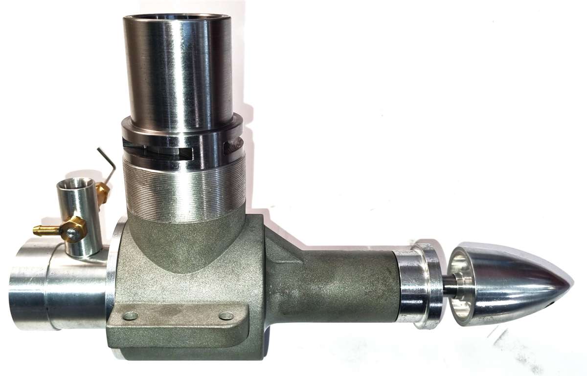

                  Well now that the cylinder liner is all lapped and ready for the piston and contra to be fitted up I’ll take a small break and start on the cylinder head. Head is machined from a piece of solid 3″ 6061 T6 ally bar.
                  Here’s how it starts………..
                  20260623_12051220260623_120456
                  This should be interesting, lol
                  Dean

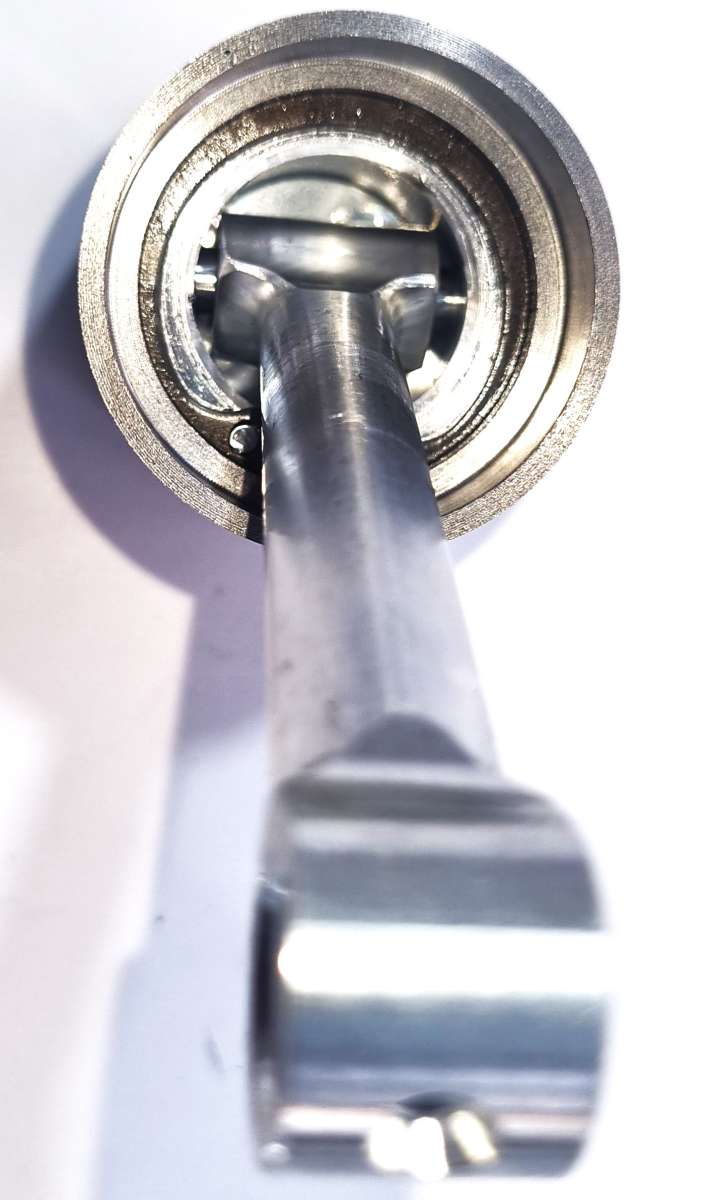

                  dean clarke 2
                    @deanclarke2

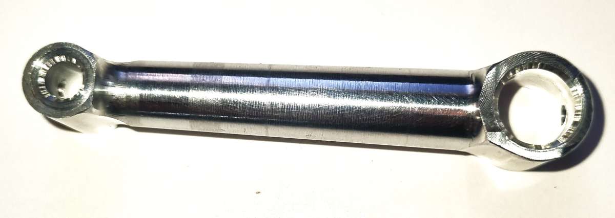

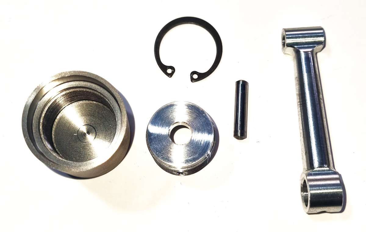

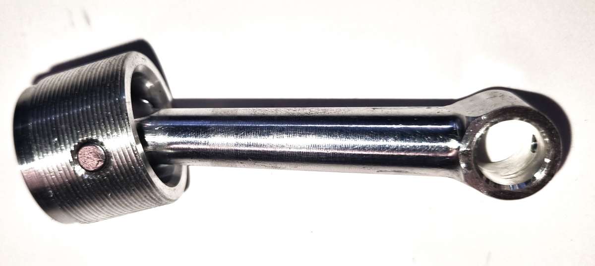

                    In the meantime, I had to make some con rods for another project so I decided that it would be a good time to make the rod for the big boy while I was at it.
                    20260703_094113
                    Now lets get some work done on the piston assembly.
                    Dean
                    #854881
                    dean clarke 2
                      @deanclarke2

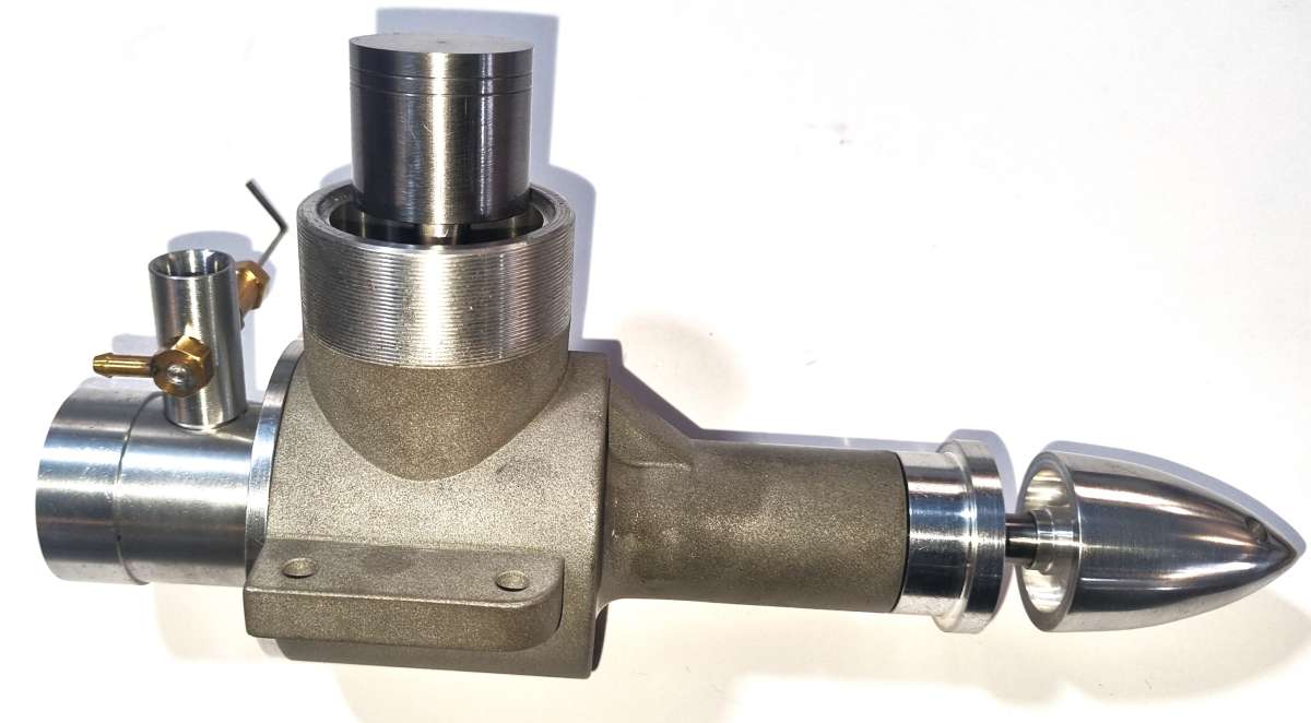

                      Well, here’s the progress to date. compound piston assembly is all finished and assembled, and then fitted up to the rest of the engine.
                      20260706_12095420260706_080642
                      20260706_121150
                      20260706_160851
                      20260706_161135
                      20260706_161207
                      Now i’ll make the compound contra piston assembly and then go back to the cylinder head.
                      Not far from finished now……..
                      Dean

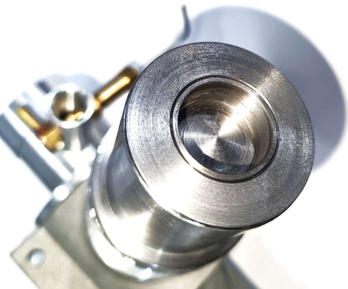

                          Compound contra piston assembly all made and fitted to the cylinder liner.
                          20260708_164221
                          Now we just need the cylinder head finished and the compression screw.
                          Dean
                          #855345
                          Diogenes
                            @diogenes
                            What’s the contra compounded from?
                            #855350
                            dean clarke 2
                              @deanclarke2
                              Contra piston components are made from cast iron, compound meaning not 1 piece but an insert plug with a the movable compression adjuster inside. both parts are lapped and fitted to each other and the cylinder for a gas tight seal.
                              Dean
                              #855386
                              KEITH BEAUMONT
                                @keithbeaumont45476
                                Hi Dean,  Brilliant work. I would be interested to know why the contra is in several parts,compared to the normal one piece?
                                Keith.
                                #855452
                                dean clarke 2
                                  @deanclarke2
                                  Hi Keith, the contra piston assembly in this engine is made in 2 parts because at 32mm bore a single contra would prove a bit awkward to make and fit(which is of course possible) but more importantly the compression adjustment is too severe. using the 2 piece setup give a much better running adjustment with finer compression adjustment, much like the setup on the Jeffe ETA 15 team race engine.
                                  Dean

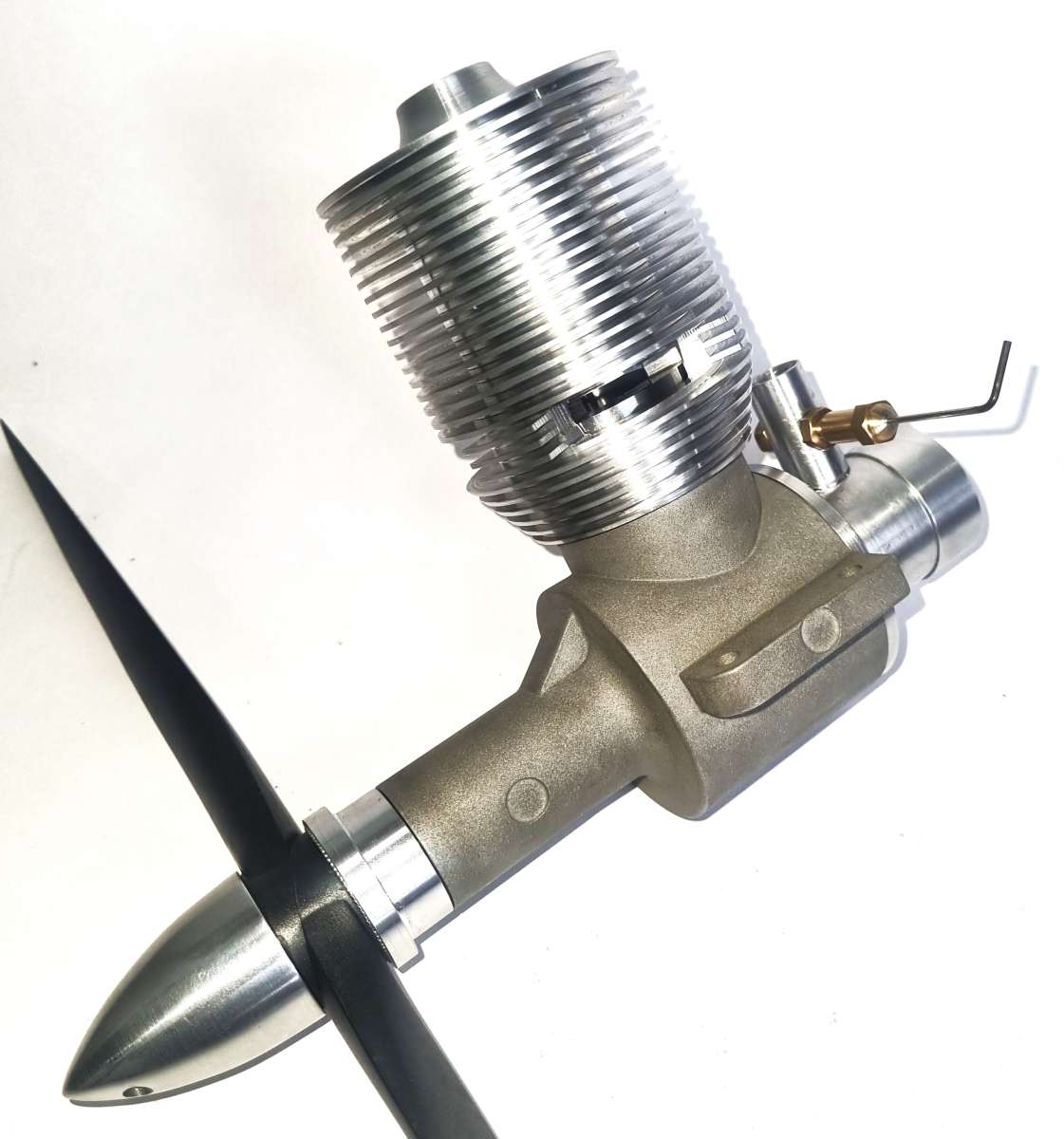

                                    #856893
                                    dean clarke 2
                                      @deanclarke2

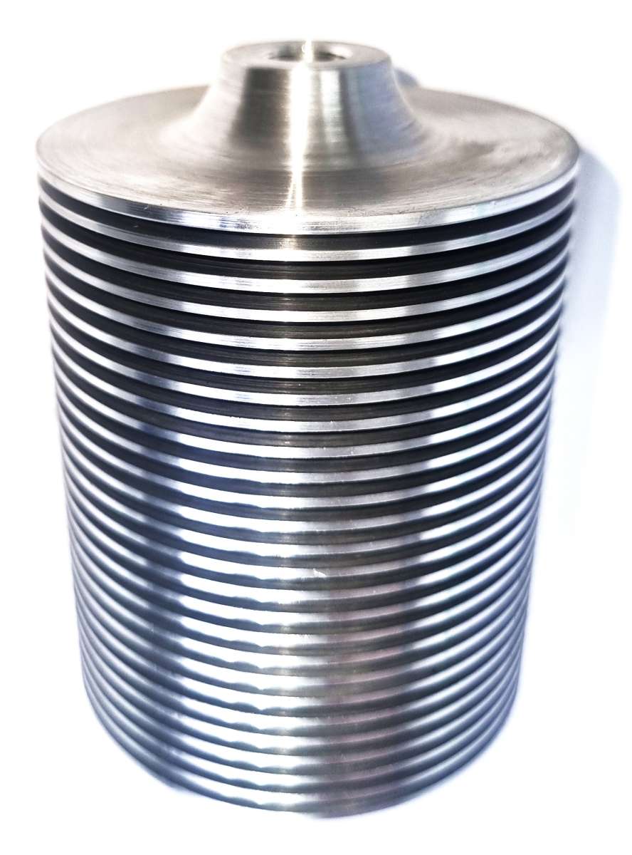

                                      Here’s the next update on the machining of this big boy diesel engine.
                                      Start of the cylinder head, a lump of 3″ round 6061 t6 aluminium bar stock.
                                      After the first stages of machine work……..
                                      20260720_145120
                                      And the outside done……..
                                      20260720_14514520260720_145139
                                      Next step is to machine the profile into the fins and then the exhaust slots.
                                      Dean

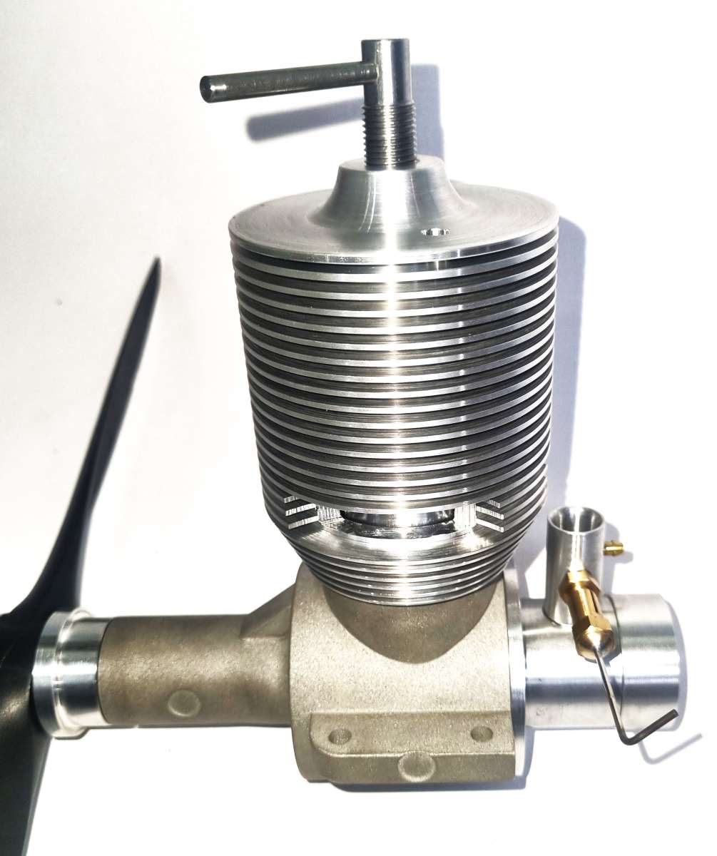

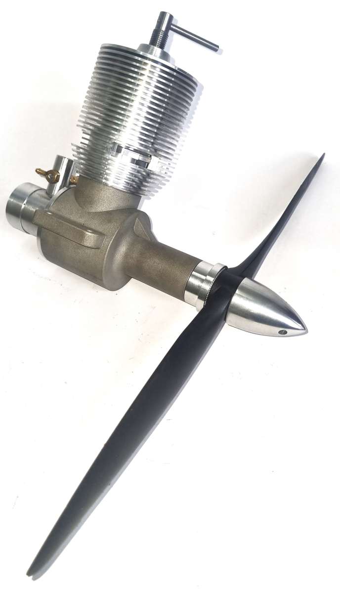

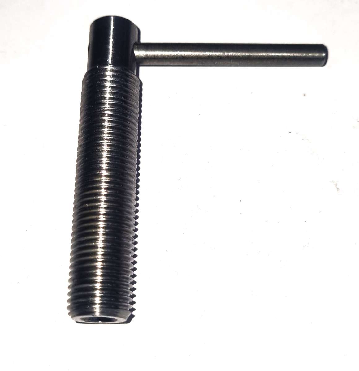

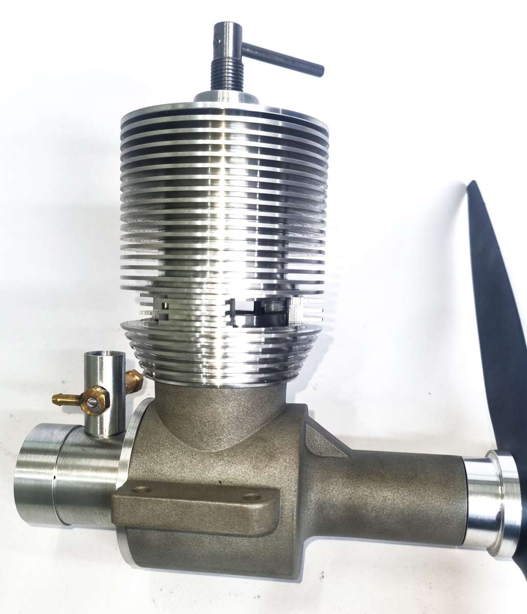

                                      dean clarke 2
                                        @deanclarke2

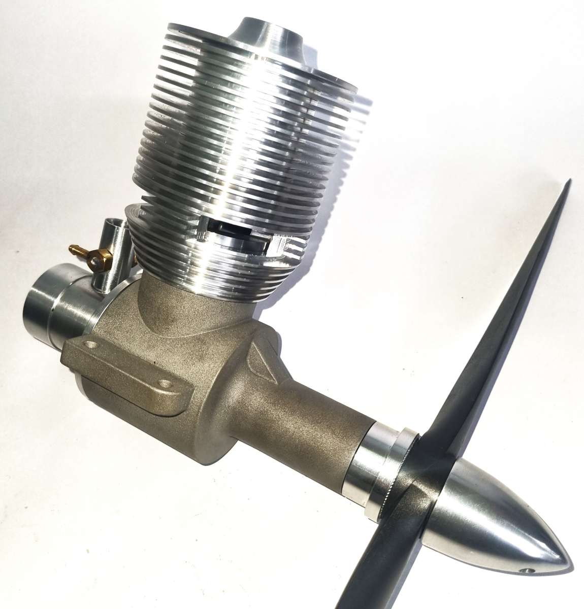

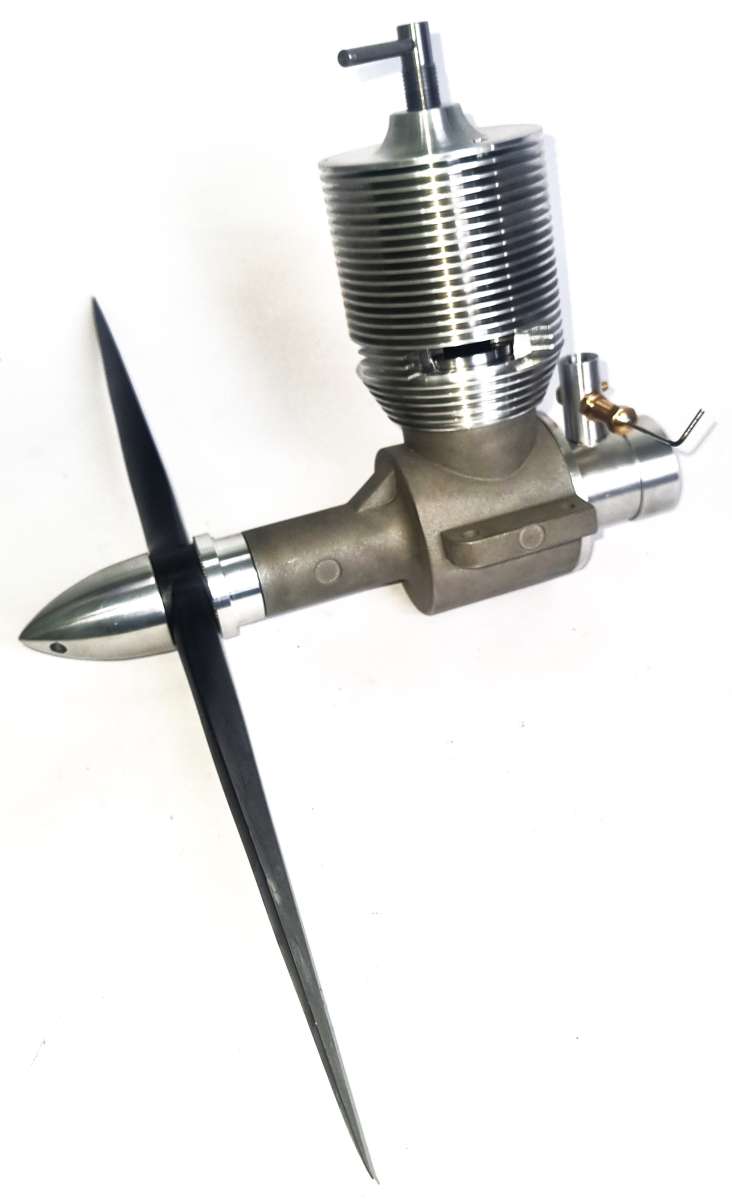

                                        OK so I’ve finally managed to find some time to finish off the cylinder head and compression screw for this engine.
                                        20260724_11345620260724_113444
                                        Compression screw…….
                                        20260724_115644
                                        And all assembled ready for the test stand…….
                                        20260724_11582520260724_11575320260724_11583320260724_115846
                                        Now all we need is the fuel bottle..
                                        Dean

                                          #857576
                                          KEITH BEAUMONT
                                            @keithbeaumont45476
                                            And the “Chicken Stick”!  What level of compression pressure has your lapping method  achieved Dene?
                                            Keith.
                                            #857580
                                            KEITH BEAUMONT
                                              @keithbeaumont45476
                                              Evey time I see this Crankcase,I marvel at your carving skills. Absolutely Brilliant!!
                                              Keith.
                                              #860102
                                              dean clarke 2
                                                @deanclarke2
                                                Hi Keith, no chicken stick mate just quick hands, lol I hope.
                                                Compression is variable so the compression ratio is also very “adjustable”. The piston has been lapped with lead in on the crown and skirt taper to allow for good oiling of the piston to liner faces. I have also machined in 2 small oil retention grooves in the compression band of the piston to help alleviate seizing under operating temperatures which can be a very serious problem for large lap seal piston/liner assemblies.
                                                Next mission is to build a suitably solid test stand to run him up on.
                                                Until next time
                                                Dean
