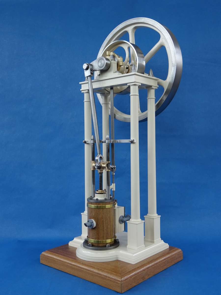

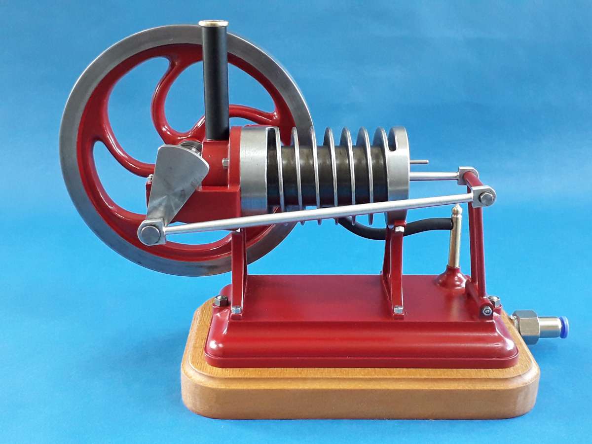

              #857064
                I agree with nigel that most typical configurations of stationary steam engines have already been done so a “new” design would tend to have similar features to existing kits. However there are still plenty of subjects out there that could be produced as kits and be regarded as “New”

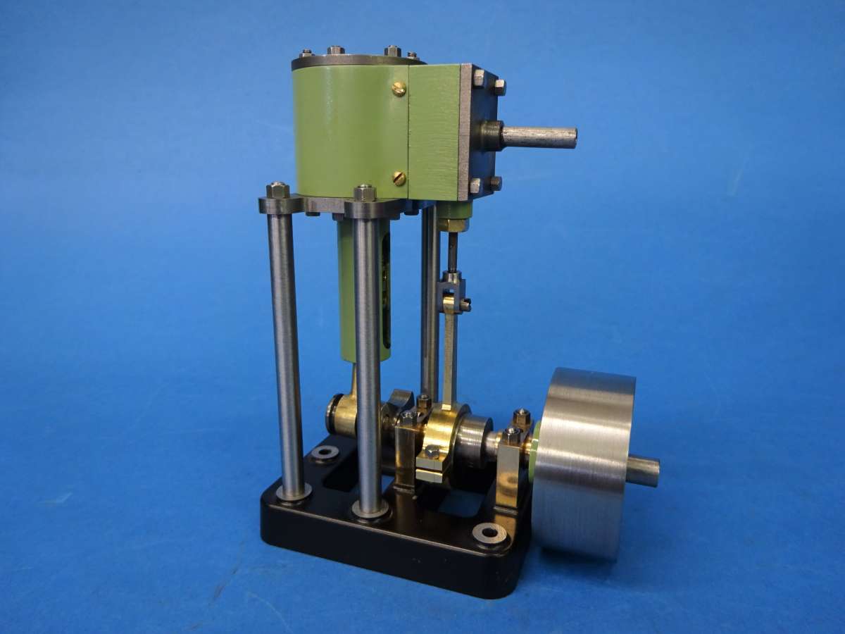

                Lets take this oscillating engine that I based on an old engine I saw at an exhibition. Nothing too complicated for a beginner if the bed, cylinder and flywheel were provided as castings, yet nothing out there available as a kit.
                DSC02437
                Another wobbler which would make quite a nice kit,  just four castings – Base, standard, flywheel and cylinder, maybe scale it down a bit so it would fit on smaller machines as the flywheel is just over mini-lathe size
                DSC03896.
                One more, don’t recall seeing any kits with the Allen Linkage so that would be a “new” one. Just a few castings again – base cylinder, head and flywheel. Maybe do the legs as laser cut parts
                20190609_083221
                Again another mechanisum that has not been offered as a kit so a New one to the market

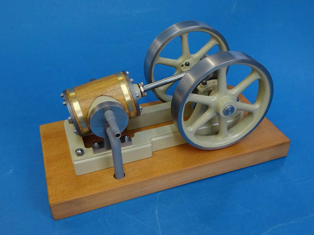

                #857084
                  paul, my above post assumes you ar ethinking of traditional looking engines. Is that so or are you thinking of something less traditional?
                  Examples might be what Nick Rowland produces like the type B, although a loyal cycle (similar to 2-stroke) something like that with teh addition of poppet or piston valves could easily become an air/steam engine. Just 4 castings, two if you don’t include the silencer halves.
                  DSC03902
                  Or his Type D, again very much a fanasy design with just 3 castings, similar could be done for air/steam
                  type d

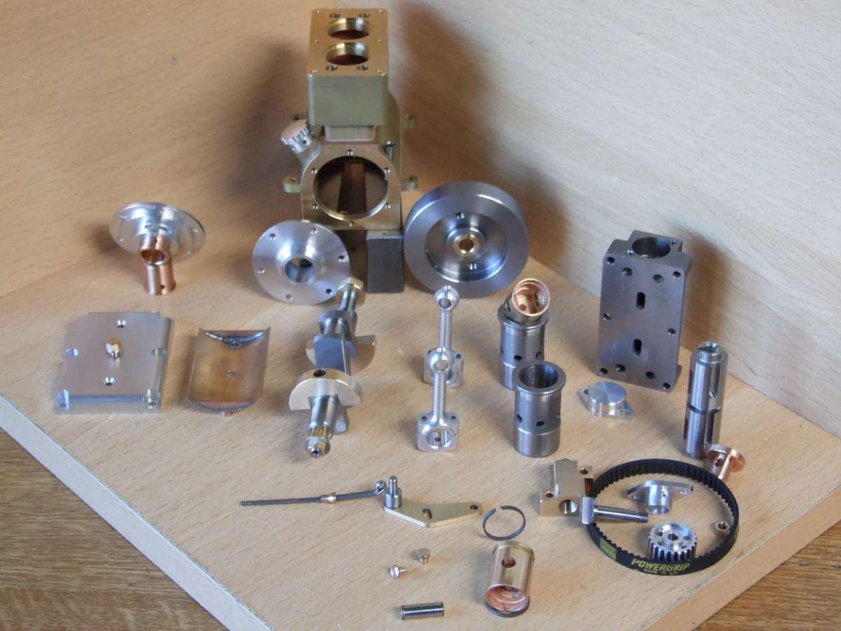

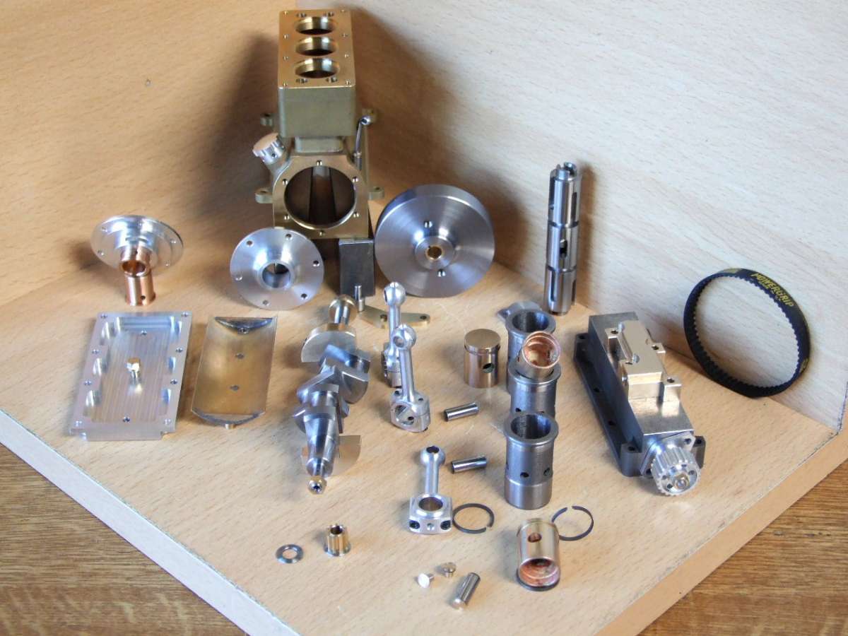

                  Graham Meek
                    @grahammeek88282

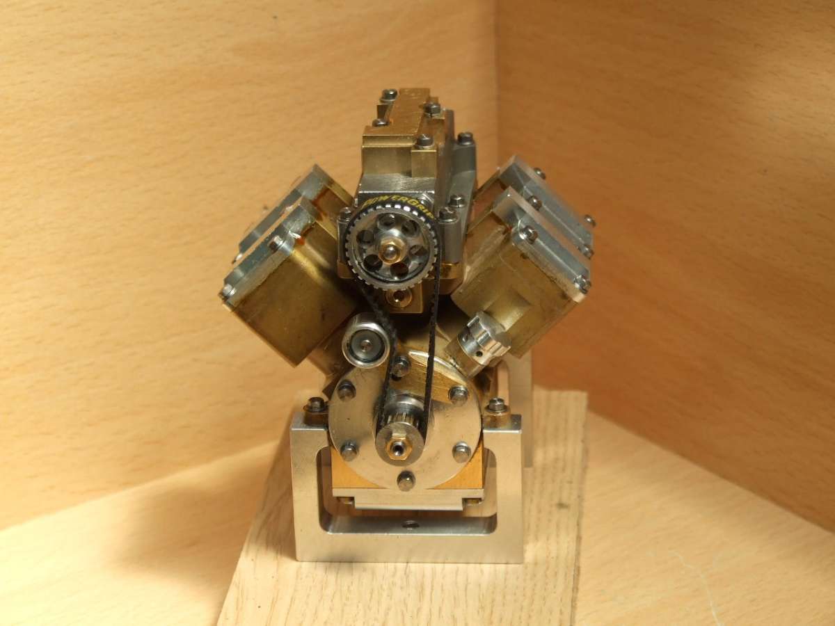

                    Back in the early 70’s Edgar T Westbury introduced the Gemini High Speed Engine. At that time I thought this was a refreshing design which resembled modern day automobile engines.
                    Alas I have only seen one or two examples of this design. Probably the all enclosed design did not appeal to the traditionalists.
                    At that time some small timing belts came into my possession and I built a version out of bar stock. Sadly that engine disappeared long ago.
                    However as a little aside to my more usual workshop equipment accessories I had a further visit to ETW’s design. There never was a 3 cylinder version, but I could not resist the temptation. A V4 design was also published as an aside but no details. All are prefabricated from brass sections and make an interesting silver soldering exercise.
                    Fig 1 A Brace of Engines
                    Fig 11  Both the engines with Oil pumps and pipework fitted
                    Fig 13 The V4 engine assembled (front view)
                    Fig 14 The V4 engine from the rear
                    These engines are all scaled down from the original but they run beautifully on air or steam. A lot of the parts are common to all 3 engines.
                    Regards

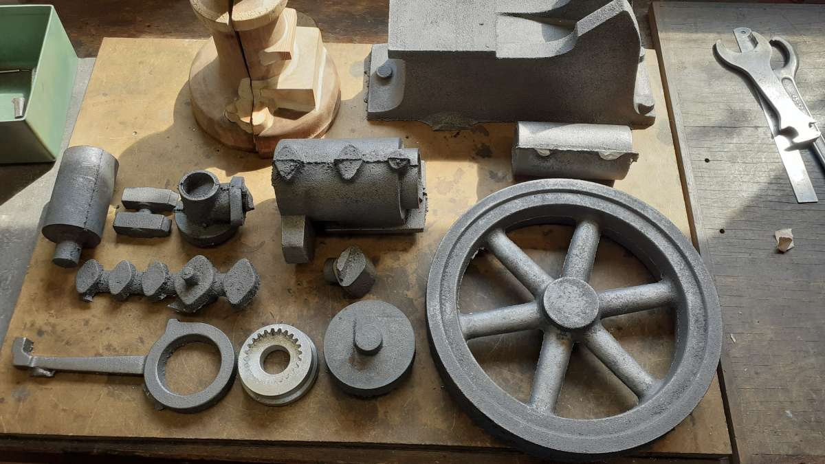

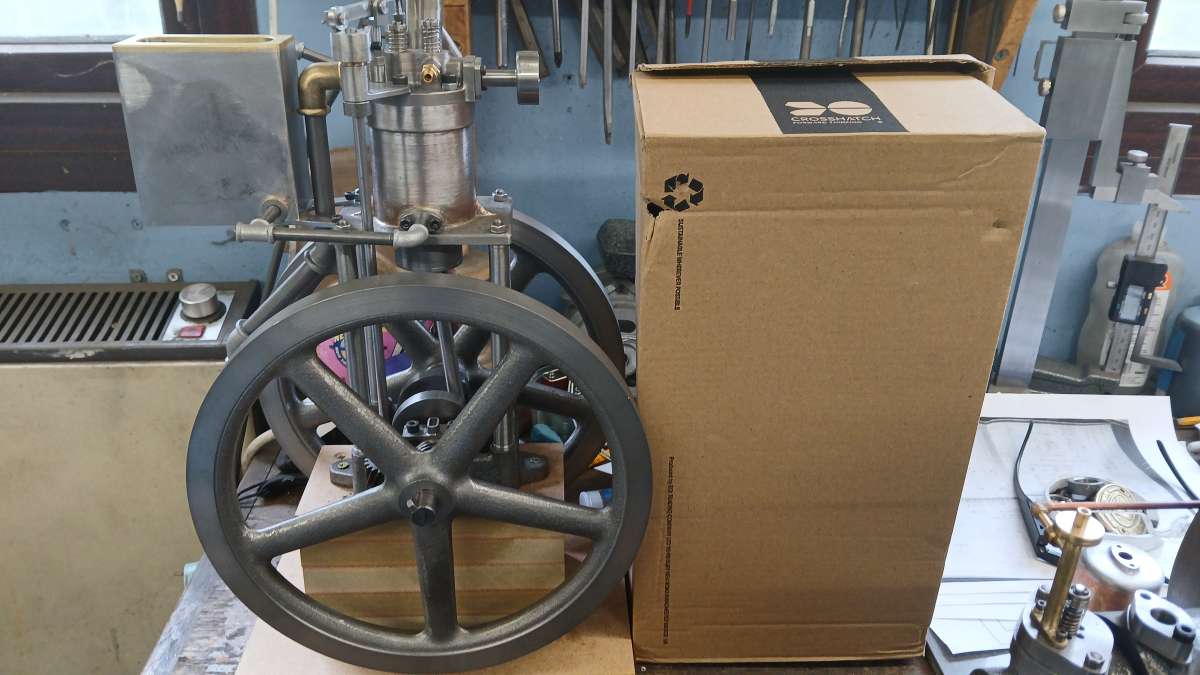

                                On paulmichael1084 Said:
                                Good questions
                                As for the type of model, I was thinking of starting with something small (IE shoe boxed size),……………..
                                I don’t have a target price in mind but I’m thinking sub £500.
                                I just so happene dto have  ashow box and thought I would illustrate my point about size and costs both of which I feel are too high for a beginners model.
                                Case No 1. Just the two flywheels and the bed casting for this engine cost me £330 inc postage. No doubt could have got them a little cheaper if done on match plates and a small batch. If that engine were to be marketed as a kit it would need at least a casting for the head so cost at least £400. I know it is not a beginners model but it is about shoebox size. If you were to add in the material costs I would say you would be touching the £600 mark more if you included gears, fixings, burner and the pipe elbws that I had 3D printed. So what would the retail price be for a shobox size engine to cover all the costs I have mentioned in previous posts I would be wanting at least £1000 for the basic castings & materials and another £250 plus for the full package. Hard to get more than a few experienced modellers to pay that sort of money let alone a beginner. This is one of my own designs.
                                20260721_115645
                                Case No 2
                                Again an IC engine I’m affraid but it is shoebox sized. This one I did some CAD work and CNC cut some of the patterns. I got 21kg of cast iron for my efforts😉 and a lot more of them😉 though some were rubbish and went in th escrap.😥
                                I know these castings came from a different foundry to the one I used for the engine above and they were very reasonably priced but the quality has gone right down. Again I would say the castings cost about £400, and there is going to be another £200 or so in other materials and if epicyclic gears and fixings included thats another £200. So again would be looking for the same minimum retail amount. New foundry add another few hundread onto those figures
                                20260721_115702
                                20220815_145708
