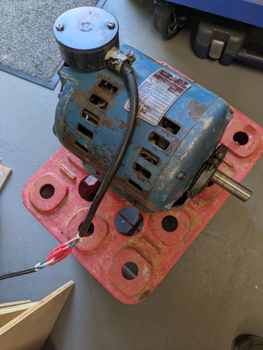

      Hello guys.
      A friend of mine is wanting to sell his lathe but it needs a new motor. Can anyone point me in the right direction for an affordable (£100ish?) motor to suit a Myford Super 7. Either single phase or three phase is fine. It just needs to be an easy fit.
      Any motor and website recommendations are much appreciated.

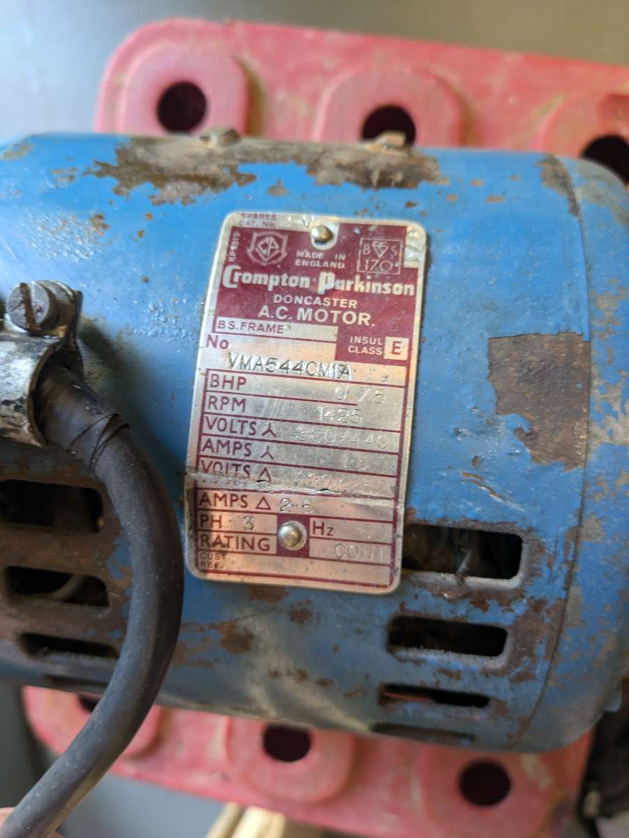

                            #857981
                            Hollowpoint
                              @hollowpoint
                              Thanks for the help guys, I appreciate it. 👍

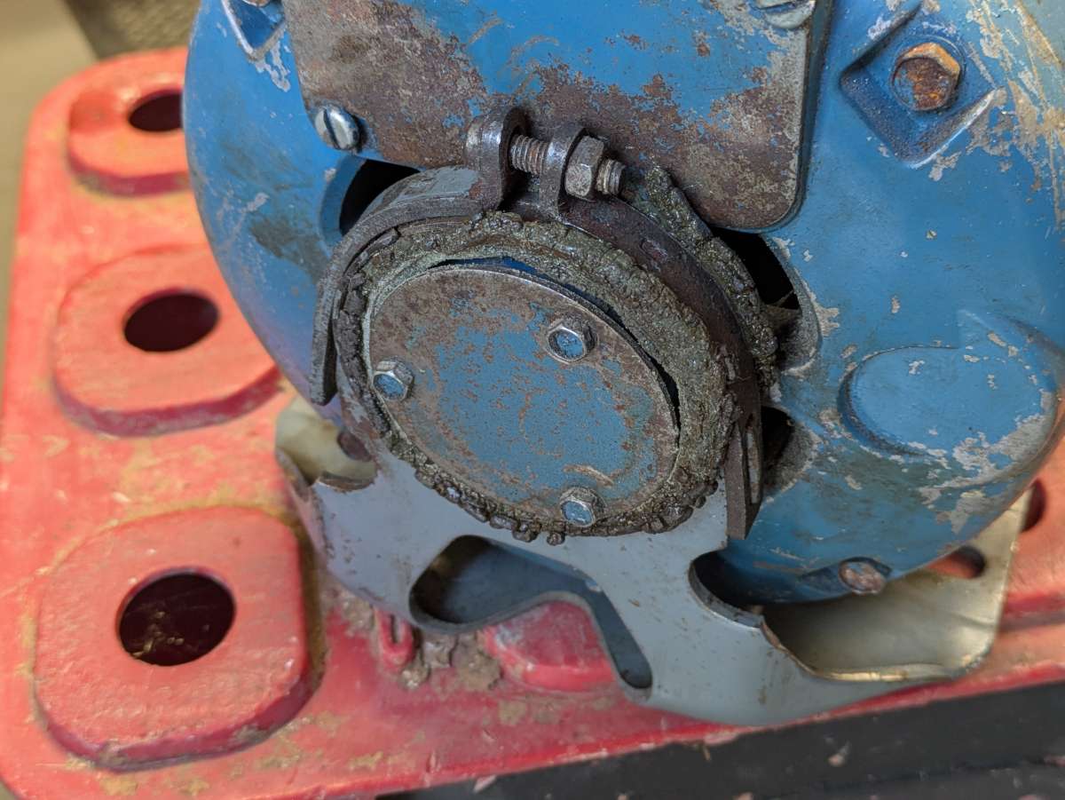

                              So I had time this morning to have a better look at the motor and assess the problem/s. The problems were a break in the cable and a dodgy switch. The motor (3 phase btw) now runs as sweet as a nut!
                              Unfortunately that’s not the end of the problems though. The rubber “resilient mounts” have completely perished making the whole thing rock and move in its mount.
                              PXL_20260727_141024721PXL_20260727_141007722PXL_20260727_141003348
                              So my new question is, where can I obtain new rubber “resilient mounts”?
                              #857988
                              bernard towers
                                @bernardtowers37738
                                As its a 3ph motor it runs much smoother than s/ph so why cant you dissemble the mount and fit two pieces of large rubber hose or large size wiring grommets?

                                  If you have access to a 3D printer, there’s at least one version on Thingiverse
                                  https://www.thingiverse.com/thing:6140635

                                    If you visit car component/parts dealers they have some sort of large O rings which are almost identical the ones you show in your picture. A friend of mine fitted a pair two three years ago as his went soft. Not expensive either.  John

                                      Bumping this thread because I still need help with the resilient mounts!
                                      I tried to find rubber grommets without success.
                                      After reading about a similar problem someone else had, we tried casting the mounts with polyurethane rubber. That was a total disaster! The vendor who supplied the casting kit was totally useless as well.
                                      I then tried contacting “Mouldcraft” who where even more useless! Ignoring my messages for over 2 weeks.
                                      I contacted Brooke Crompton who where great, but didn’t have the parts. They told me to try Massey Colbeck as they took over part of the motor business. Which I did. Unfortunately they only had newer types.
                                      I am at the end of my tether with this thing! 😟

                                        I would be inclined to try to find sheet rubber. Cut a strip to wind round to make the rubber bush. It could be two or even three turns at a pinch to fill the space, and get the clamps to close.

                                          Hi I will look at a motor I have and see what’s what but a section of reinforced blue silicon hose may well work and I can send you a section of that OR the miracle product CT1 is a bit like silicon but much stronger and is an adhesive so after careful cleaning a new mount may be moulded.  Noel.

                                            I had an ancient General Electric motor with the same type of mount. I would have thought a car top or bottom hose could provide the material though it would cost nearly half the price of a 1/2hp new motor.

                                              What was wrong with the polyurethane casting attempt? That would have been what I would have tried. For the spiders in some little ‘dog and spider’ shaft coupling I found a 70 Shore compound much too soft, but a 95 was just right. I bought these:
                                              https://www.mbfg.co.uk/pt-flex-70-rubber.html
                                              https://www.mbfg.co.uk/duroflex-95.html

                                                I ran a ML7 with a rigid mounted single phase motor, it was fine. 3 phase would be better.
                                                As you’re selling it why not make some steel non resilient bushes, just tell the potential purchaser what you’ve done

                                                  The ML7 I mentioned the other day fitted with the Machine Mart motor (single phase) has it solidly mounted, doesn’t seem to cause any issues.

                                                      How about finding two rubber O rings of suitable section?
                                                      Cut to length, and fit.
                                                      That should provide a resilient mounting.
