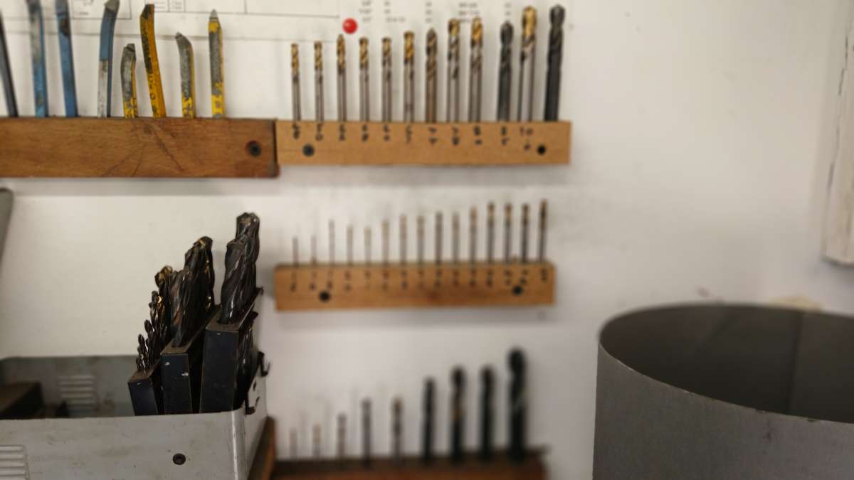

                                          I only bought what I commonly use in stub length, anything else can be spotted and drilled with a jobber. My jobber 1/16th to 1/2, 1-5.9 and 6-10 sets in 0.1mm increments started out a cheaper sets but over time I have replaced when needed with Dormers.
                                          20260724_133223

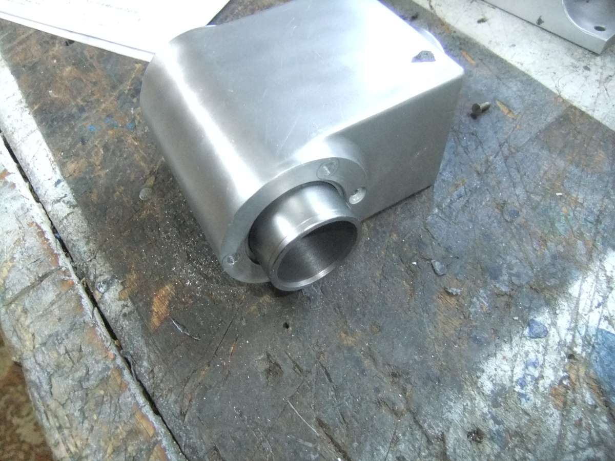

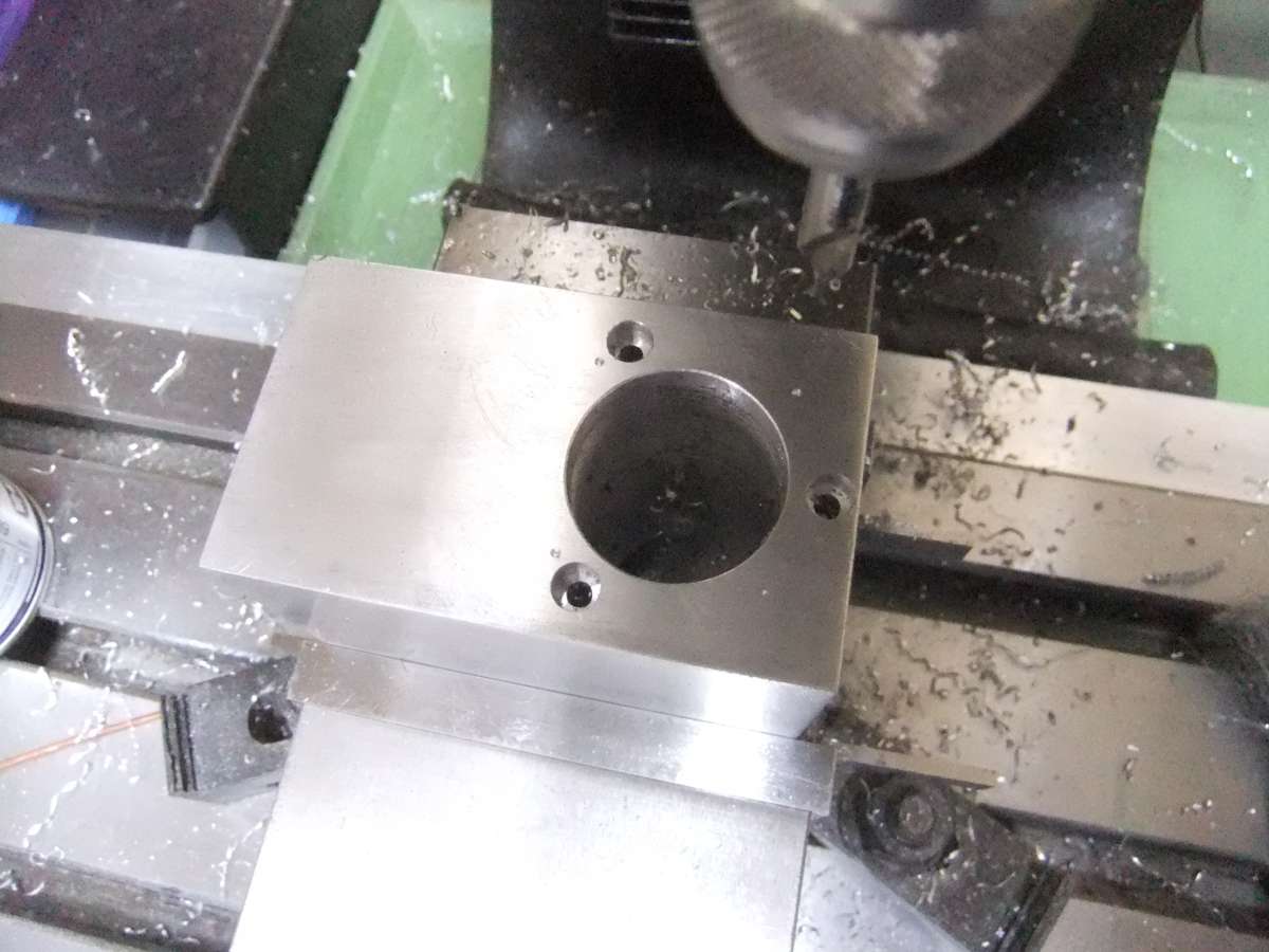

                                                      When I did mine I drilled from both ends after drilling and boring the main cylinder bore but before shaping the outside. I just started with a block the correct size for the part.
                                                      It worked for me any slight deviation was easily sorted by running the drill bit from both ends, so no step was left in the middle. I used the pecking method to help prevent the bit from wandering too far off course.
                                                      Drilling and counter sinking for the heads
                                                      drilling the water hopper (6)
                                                      The outside shaped
                                                      Cylinder liner turned (5)
