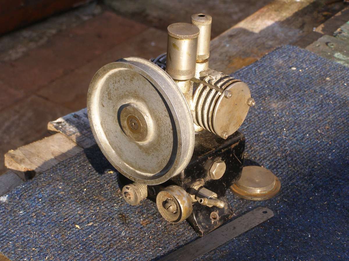

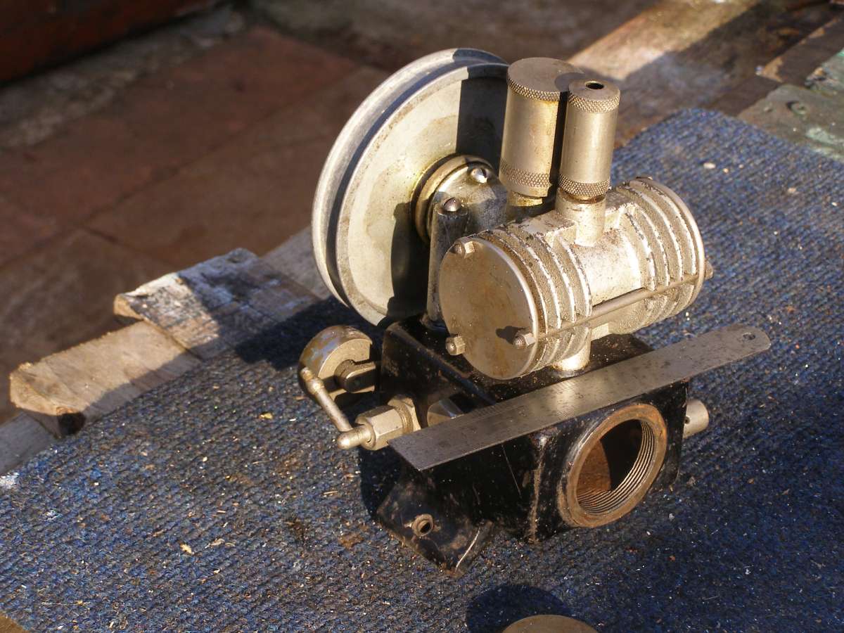

      … as we know it. Or more accurately, can identify it.
      I will try to add a photo in the usual way of chat-sites (simple file transfers) but ever since the site owners destroyed our own albums, doing so seems a black art. The “Galley” appears no more than a totally random mixture of users’ engineering photos and odd ones the server adds for the hell of it.
      So I’ll type the Words and hope the Pictures will appear too. Otherwise we won’t get far.
      The machine is a very small, very neat twin-cylinder pump, opposed horizontal pattern, with a flat-belt pulley c. 4″ diameter. The pulley is accompanied by a sprung-arm tensioner / clutch.
      This assembly is screwed to a small cast-iron box, about 4″ square X 3″ deep, with a large screwed-in “inspection hatch” shown open below, and four threaded outlets, apparently for flexibility in application. Two are plugged; one holds a simple, user-adjustable safety-valve; the other carries a 1/4″ hose spout which could be a previous owner’s custom fitting.
      The box has two curved “feet” suggesting tank mounting, but with just two 3/16″ dia screw-holes.
      The cylindrical fittings on the compressor itself, which is also of cast-iron, are a large Stauffer-type grease-pot and a neat inlet air-filter.
      I have now wondered if it could also function as a vacuum-pump for testing miniature-railway brakes without having to steam a loco.
      Does anyone recognise this and know its origin (make, etc.)? I can’t recall when and where I obtained my specimen, possibly a workshop clearance within the club. I may have thought it could feed a basic air-brush I bought years ago and have never used.
      There are no makers’ name, trade-mark (not even “Broad Arrow”!), model name / number, component-numbers, specification label, NATO item-number, …, of any sort anywhere on the machine. Nor did it come to me with reservoir and motor which may have carried labels.
      So does anyone recognise the make, type and intended purpose, etc,.?

            Definitely an unusual item. Are we sure it is a two cylinder opposed ‘boxer’ arrangement?
            The cylinder heads look to be flat plates with no valves or porting and there looks to be precious little room for a crank and connecting rods (and how would they be assembled I wonder)
            Can you feel any suction or pressure when you rotate it by hand?

                    #857160
                    Nigel Graham 2
                      @nigelgraham2
                      The drive to whatever’s in the cylinders could be as simple as an eccentric acting as a cam.
                      The location and flow direction of the safety-valve identified the pump as a compressor, even if of very modest volume and pressure. You’d not want much pressure in a cast-iron, cuboidal reservoir; and it might simply have acted as a flow-smoother for whatever the pump was for.
                      We don’t know if the “reservoir” fittings and inlet filter are original or by some owner’s custom arrangement.
                      My guess is that the big screwed-in plug closes a core-print aperture, but also gives structural access.
                      Rotating the thing by hand does not reveal much. There is little cyclical resistance, no sound of ball-valves opening and closing, no popping or hissing (though that might be thanks to very slow rotation); not even much suction on a finger placed over the inlet.
                      That the inlet and outlet are opposite each other at the centre of the cylinders, and the lack of obvious valve accesses, suggests possibly a form of “uniflow” or 2-stroke porting.
                      So let’s be brave and take those covers off…,
                      [Pauses to do just that, on the dining-room table.]
                      Felt-tip pen marked the covers for end and orientation.
                      The nuts are 4BA. That’s narrowed things down a bit: British-made,  or at least British-designed.
                      The released covers offered no resistance beyond slight gasket stick. (“Came orf in me ‘ands, guv”)
                      The covers have a tiny register and a very shallow annular groove that held a ring-gasket of paper-like material, but are otherwise flat. Replacing those gaskets will be fun as the grooves are probably too shallow for an O-ring, if I could find any that fit.
                      Two pistons moving oppositely with no end-float or lost motion. Pushing them by fingers rotates the pulley. So the two pistons are likely a single piece of metal moved by a cam in a central aperture.
                      Bore 1.25″, Stroke 0.5″.
                      So ~1.2 cubic inches of air per revolution.
                      Look onto the flat piston face. There’s more…
                      No nuts, screws, pin-spanner holes, screwdriver slots or other assembly / disassembly aids.
                      No ports visible in the cylinder wall.
                      Two rectangular ports in the piston, open to the periphery, like key-ways, at about 12 and 5 o’clock.
                      As the piston reciprocates it oscillates angularly, by perhaps 20º.
                      So clearly the piston at each end is also its own sleeve-valve. One “keyway” the inlet, the other the outlet, passage. Gently roating the pulley by a finger while watching the ports reveals the correct direction, as they come in and out of alignment with their appropriate external features on the body.
                      Just what does drive it? It is guarding its secrets jealously.
                      The body is a one-piece casting, a Tee-piece with added bosses and support columns.
                      Removing the reservoir’s “core plug” reveals only a nut that secures the support-column / outlet tube to the reservoir. Two smaller columns, also parts of the casting, hold long round-headed screws for the same purpose.
                      The second photo shows a round-head screw between the pulley and grease-pot. Removing that did not appear to release anything, but I was reluctant to be heavy-handed.
                      At barely quarter-inch long that screw may only be an oiling-point. If so, perhaps to lubricate the pulley end journal, while the grease-pot supplies the eccentric or cam or … ; and the cylinder is oiled via the vertical inlet filter.
                      No other apertures in the body: just the inlet, outlet and two lubrication points.
                      So the connection between shaft and pistons is still hidden.
                      The “reservoir” may act as a rather crude oil-separator. No doubt the Owner’s Manual would have told us very firmly what lubricants by which firm to use where.
                      It’s really a rather lovely little machine with an ingenious valve function that could have been partly for near-silent running as well as simplicity and low maintenance; was quite possibly for a very specific application, perhaps in medical or laboratory equipment, or to run air-brushes.
                      It’s no good… I’ll have to find some way to drive it, with a pressure-gauge fitted, with due respect for that cast-iron box. No big “bar.litres” here…
                      I have great respect for its designer – whoever he was.
                      Oh to know who manufactured it, where, when and for what!

                                      Nigel’s latest description includes the following..
                                      If the double ended piston is one piece of metal (aluminium?) then the only way it will come out of the bore/s is from one end or the other. To do that the crank pin or whatever will have to be extracted first by taking out the shaft. Maybe the shaft is retained by some feature sitting in a groove in the shaft, the pulley looks to be pressed on as there no keyway visible.
                                      What is visible is a radiused edged flange between the pulley and the pump body, I say flange as it may be part of the bush that the shaft runs in, my guess it that the bush is a push fit in the body and retained by the round headed screw.
                                      To get a 0.5″ stroke needs a crankpin throw of 0.5″ so it cannot be just a pin in the end of what looks to be a shaft of about 1/2″ diameter. I think the inner end of the shaft must have a disk (just a bit smaller than the bore of the mid leg of then tee) carrying the crankpin.
                                      It will be interesting to see the porting whan Nigel gets inside.

                                              Nigel Graham 2
                                                @nigelgraham2
                                                Duncan, Peak –
                                                I tried Google ‘Lens’ as you suggested but that can’t be loaded in the normal way on a PC. Its website asks you to scan a QR code.
                                                I think it’s intended for “smart”-phones, and likely thge high-price ones too.
                                                God knows what Google thinks “you might like” if you give it those photos to search for!
                                                I’ve not tried those other search tools.
                                                Mark –
                                                Dental equipment… You could be onto something there.
                                                At work, making experimental piezoelectric transducers, we had a small grit-blaster with a gun about the size of a pen. We used it for preparing surfaces for adhesives; but it was in fact a dentures-manufacturing tool.
                                                Though that was a modern version with the motor and compressor tucked away neatly in the unit’s compact case, it’s quite possible this machine of mine was an early version of the same.
                                                So…
                                                The arch of the base of my compressor, its alignment and small screw holes, show it was more likely screwed to a motor than an air-tank, with pulley and flat-belt drive. As Mark describes.
                                                The grease-cup and inlet filter are knurled and unscrew easily by hand. Sensible for medical equipment: you don’t want to clean and re-charge them in the sterile rooms.
                                                The parts I tentatively named “reservoir” and “core-plug” were those to a point, at least a flow-smoothing capacitor; but the box would have held absorbent material to trap oil and moisture from the pumped air. Hence large, easily-removed plug. (Though its two peg-spanner holes have been bruised by a drift.)
                                                The small size of the outlet spout may be original, suiting a dental-technician’s grit-blast pencil.
                                                Now to the internals.
                                                I am reluctant to be too gung-ho with dissection. I don’t want to ruin the thing.
                                                I think I can guess how the piston is both reciprocated and oscillated about its axis, and it is really quite simple. As is the porting.
                                                Removing the “oil screw” reveals nothing, and it does not seem to lock anything in place. I was unable to start anything moving axially with the screw out. The second photo shows a brass ring between the “oil screw” and the pulley. This is the feature Ian suggests is a journal, but it rotates with the pulley even with the screw fully home.
                                                Removing the pulley might reveal the secret of further dismantling.
                                                Grease-cup removed: a view of generously-sized steel shaft, but that’s all.
                                                Inlet filter out: the hole is blind downwards but two small holes lead off along those rectangular bosses shown in the pictures. I tried shining a strong lamp down the inlet while turning the pulley, but could not see any light along the piston port.
                                                I surmise:
                                                The double-ended piston is reciprocated by an eccentric, cam or crank-pin formed in the shaft itself, working in a suitable aperture in its centre.
                                                Its rotary motion is given by a pin, boss or similar acting in a short helical groove in the piston’s central section. Close lamp and spy-glass inspection revealed perhaps a tiny grub-screw in the floor of the filter’s recess, right above the convergence of the unit’s axes; but I think it’s simply a casting or machining artefact.
                                                So – is the rotation-drive pin a spigot on the end of the “crankshaft”, concentric with the shaft, extending past the crank section and engaging a slot in the piston?  That would be a very elegant approach: a two-cylinder air-compressor with only two moving parts!
                                                Quite how the air passages were drilled is a puzzle as they don’t seem aligned accessibly. I doubt they were cast in, not at that size. They might have been drilled from their cylinder ends, perhaps using a specially-shaped drill or slot-drill, or a jig, to penetrate a cylinder wall at a steep angle.
                                                However, I think the porting is straightforwards.
                                                As the piston rotates, the “keyway” channel uncovers its respective port in the cylinder wall. The channel is sized for  “100% cut-off”, or nearly so, when the piston rotates back to close it.
                                                As the channels and ports are on the opposite “side” of the piston to the crankshaft, there is plenty of room for the mechanism.
                                                If I am right, this pump entailed rather involved geometry to design, and a bit of a challenge for the foundry; but mechanically, beautifully simple in the metal, by a designer with the flair to look beyond the obvious and well-tried!
                                                There is a thread elsewhere on this site about a locomotive’s cylinder-lubricator. I wonder if something rather like this compressor in principle would work for that application; each side feeding its own valve-chest.
