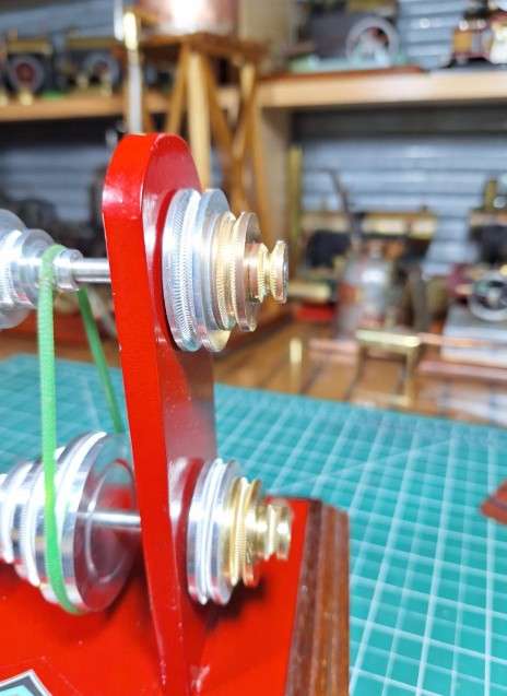

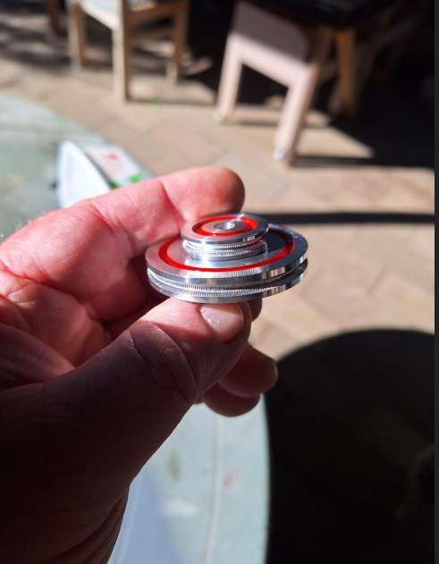

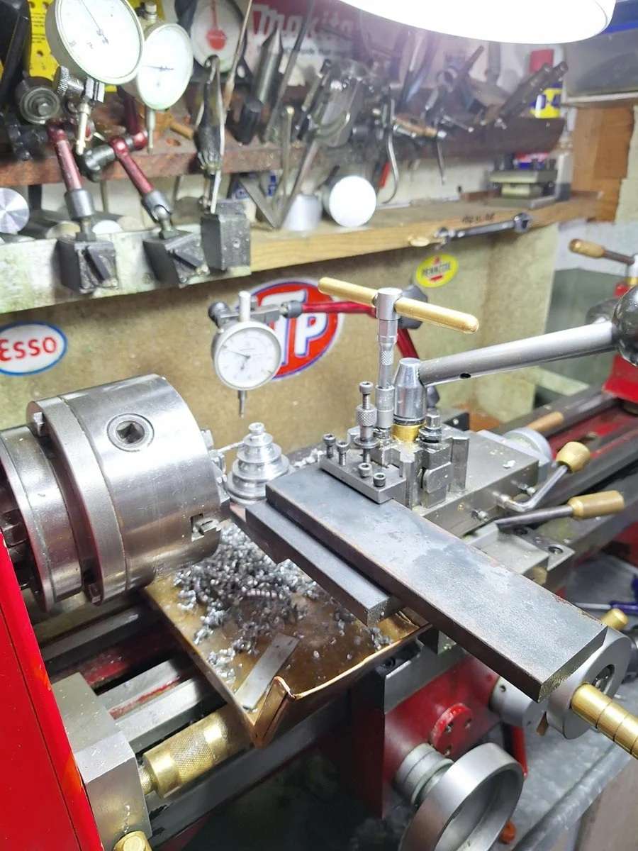

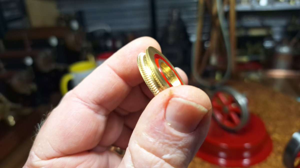

      I’ve posted up photos before of hobbed pulley drives. It’s a process that works very well and gives a professional result (very similar to what Wilesco does on their drive pulleys). I’ve done well over a hundred brass and aluminium drive pulleys now.
      Here’s a vid I did a few years ago of the process –

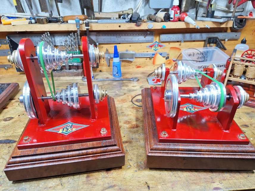

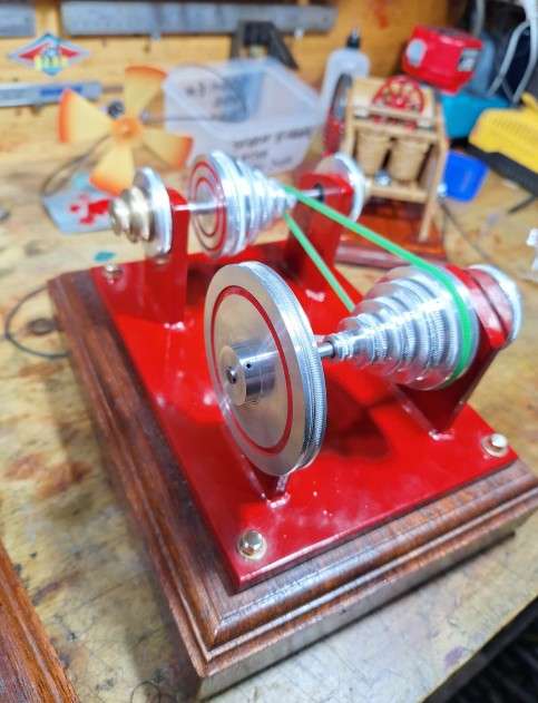

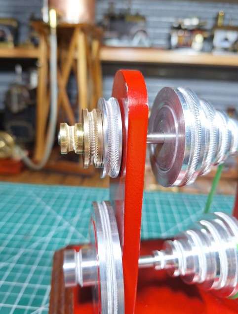

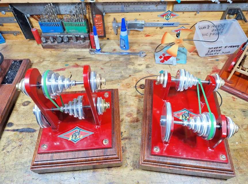

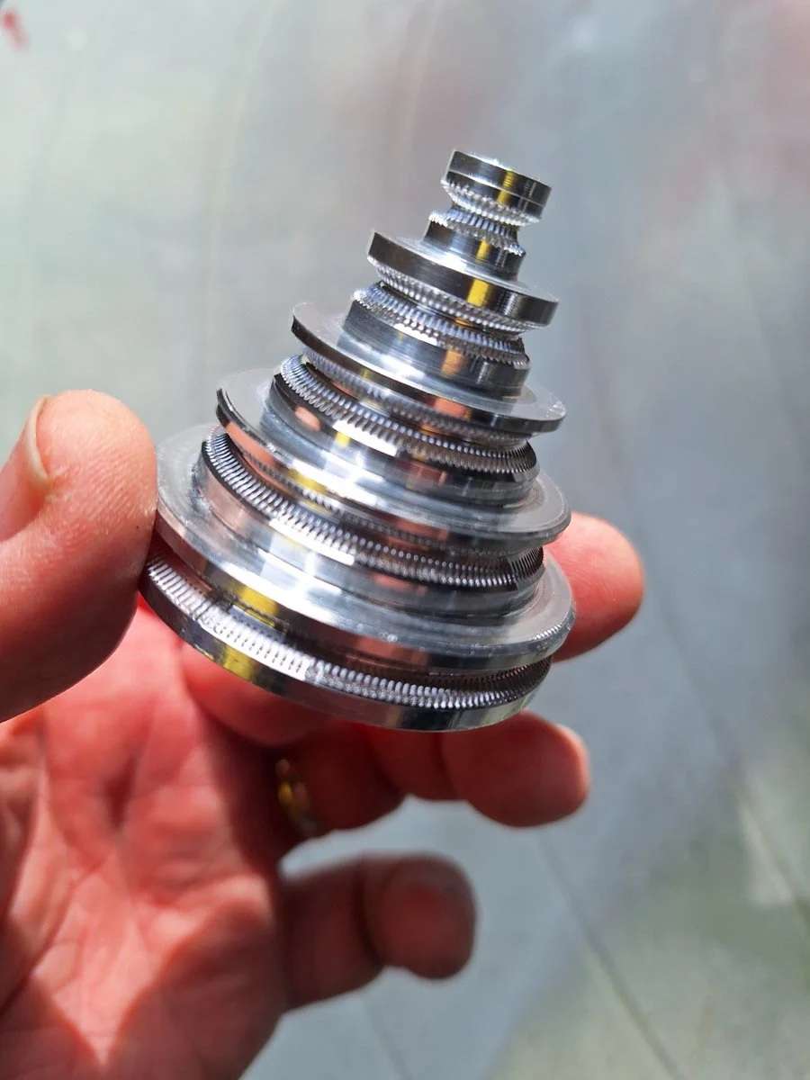

                          Here’s some pics of pulleys that I have hobbed –
                          4y5u2645y21y46y52uy234r`645u2u
                          #857904

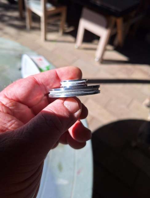

                          Blue Heeler
                            @blueheeler
                            2
                            Screenshot 2026-07-26 091459Screenshot 2026-07-26 091426Screenshot 2026-07-26 091520Screenshot 2026-07-26 091538trywujw
                            #857905

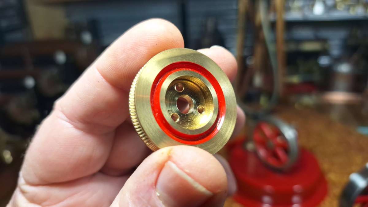

                            Blue Heeler
                              @blueheeler
                              3
                              724164259_2168838107296885_6649425981857798175_n724340868_2168838207296875_3554533885492450752_n725016112_2168838137296882_7786635255697752982_n

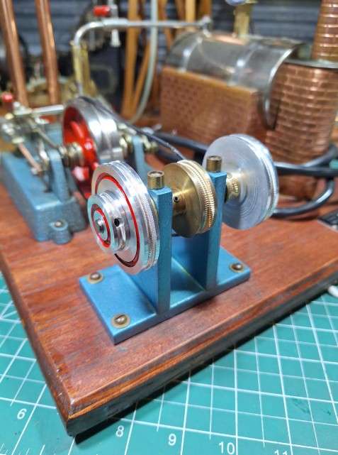

                              #857907

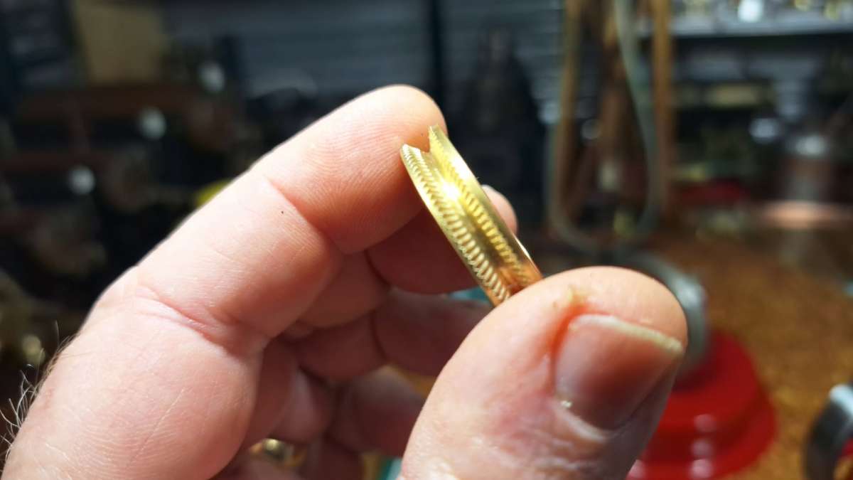

                              Blue Heeler
                                @blueheeler
                                4
                                213

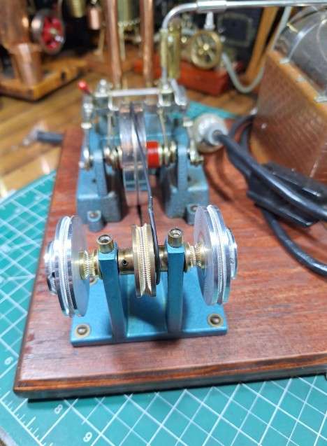

                                Blue Heeler
                                  @blueheeler
                                  5
                                  Screenshot 2026-07-26 091538trywujwywrtjwj
