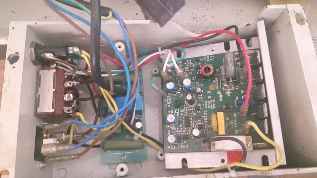

      Hi all, I was hoping to get some help dealing with the consequences of a ‘schoolboy error’. I took out the faulty motherboard from my 6 yr old conquest mini lathe without photographing the lead connections… so now I have no idea how to connect the new one. Does anyone have a picture to guide me? Have contacted Chester who have tried to help but I can’t understand the manual and the pics they sent are of a different machine. Any help very gratefully received. Inigo

          There are a number of wiring  diagrams for various mini lathes/mills here : https://littlemachineshop.com/info/business_resources.php?ID=1876291636&CAT=1
          Post up the board model number if it has one or a photograph of the board…..I'm sure we can help get you wired up again..

                Ian, can you post a photo of the board please? I think it may be a KB clone board..,
                To get you ' in the mood' you should have, as a minimum:
                3 wires from the speed pot
                Four wires from the Forward/Reverse switch.
                Two wires from the mains filter, they may be Brown and Blue…
                Post back when you have located them all…

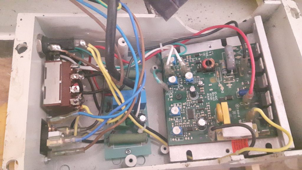

                        20180728_143417.jpgHi there, pictures hopefully attached. NB this wiring is incorrect so far as I can tell. Inigo20180728_143413.jpg

                          I have found this link that seems to show the same board, There should be two wires from the reversing switch that connect to the motor via the reversing switch. Verify you have the correct ones with resistance measurments. These will connect to A+ and A- on the board. I You connect them the wrong way round the motor directions will be reversed. If this is the case just swap them over. The live from the mains fuse (Yellow ?) will connect to L1 The neutral from the on/off switch will connect to L2. The slider on the potentiometer connects to P2 The wire from the clockwise end of the potentiometer connect to P1 The wire from the anticlockwise end of the potentiometer connects to P3 I suspect that you will have one wire over. I suspect that this will go to the the connector near trimmer R3. I don't know what that connection is. ( On your picture it looks like a green wire goes to it.) You will have to trace where the extar wire goes to to work out what it does.

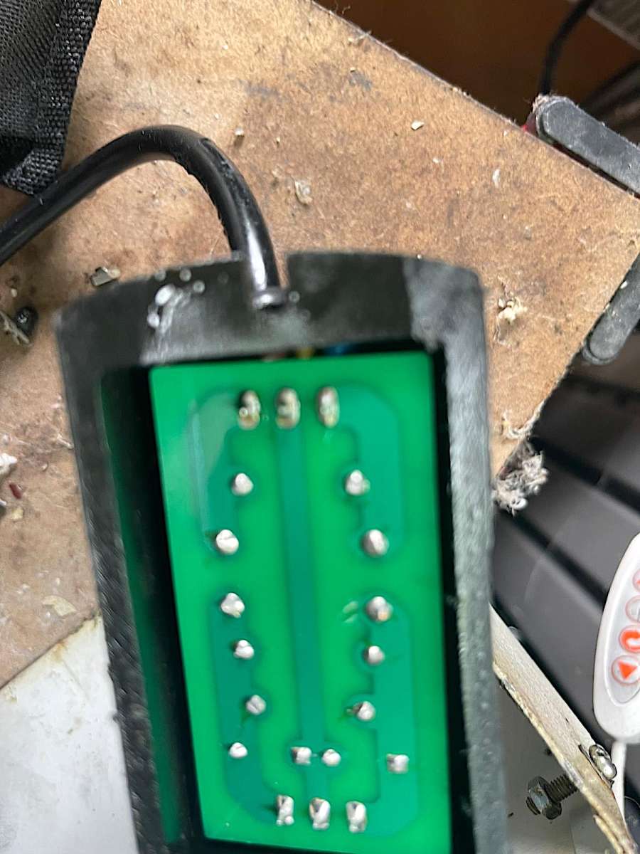

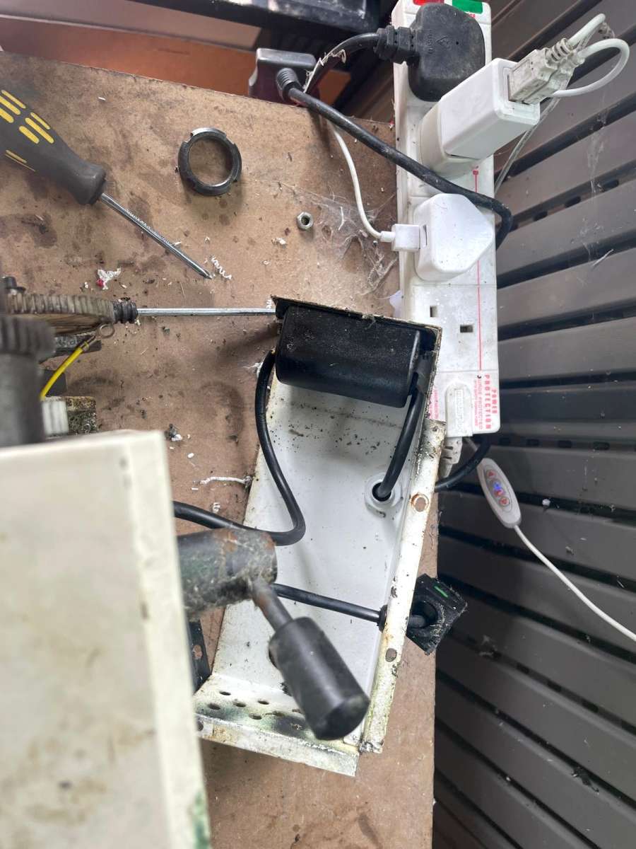

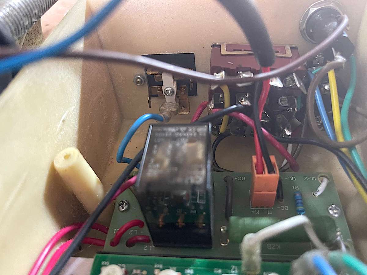

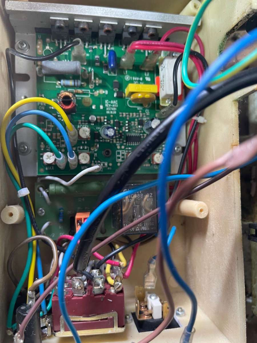

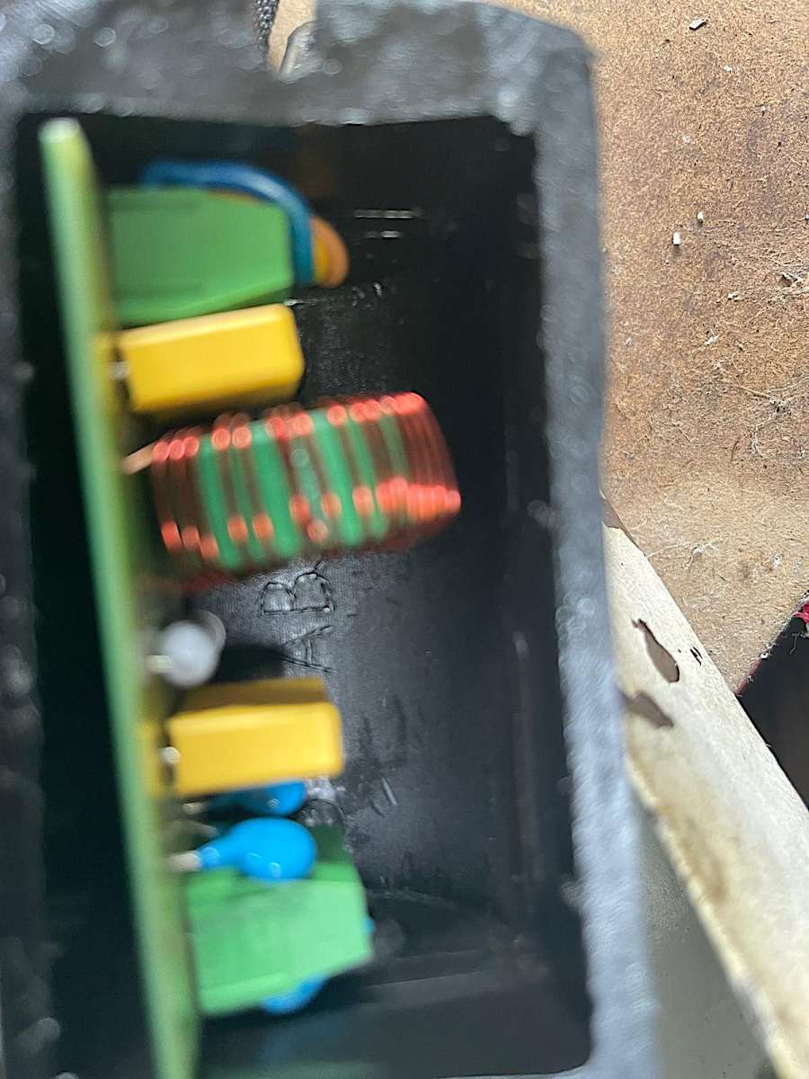

                              I have the same problem, the motor blew and I disconected all the wires from the circuit board and didn’t take a photo of where they were. Now I have a new motor installed but don’t know where to connect all the spade lugs etc. The 240v mains goes into a box at the back onto a PCB and leaves the pcb with live (brown) neutral (Blue) and Earth (Green/yellow) I know for sure that the brown goes to the fuse as it’s the only wire I cut, the others were spade lugs. I’ve resoldered the live (brown wire) and reconnected the output to the motor as that was an Orange plug. M- and M+ by the relay..
                              Please help me I know I’m a dodering old fool who should have taken note..I reside on FarceBook as Basil Henriques you’ll find me there and on What’sApp also.
                              I live in Bude EX23 8TD and. 07800-646-645 gets me.
                              All the circuit diagrams I’ve found do not have the  separate Primary mains thingy that looks like a choke and smoothing. I haven’t checked the Voltage out, but going in it’s 240v. WhatsApp Image 2026-07-25 at 17.58.1WhatsApp Image 2026-07-25 at 17.58.66WhatsApp Image 2026-07-25 at 17.58.65WhatsApp Image 2026-07-25 at 17.58.60WhatsApp Image 2026-07-25 at 17.58.69

                                There is 240v coming out of the box with the choke. I will PAY for the correct advice as to where the spade lugs connect. It’s worth fifty quid to the person who can tell me where.
