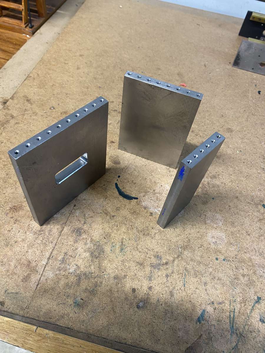

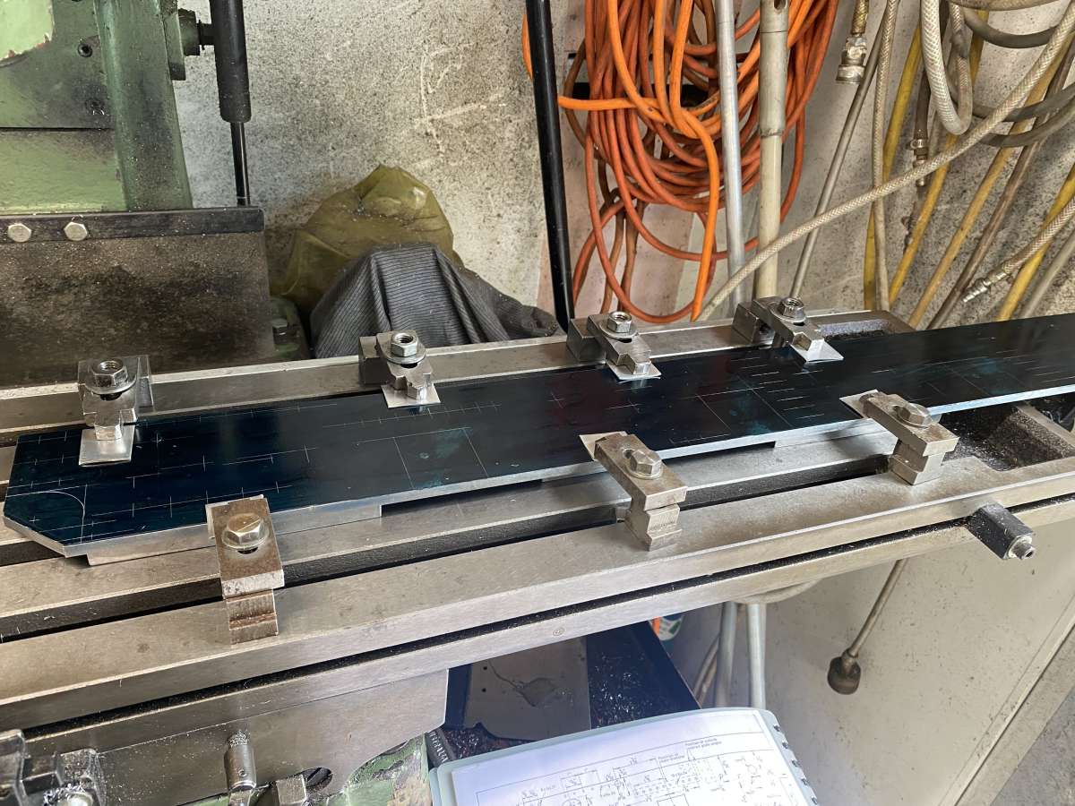

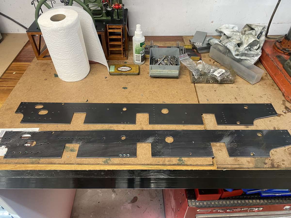

      This is my first attempt at a locomotive and was chosen as there is plenty of information available and lots have builders have already identified issues in the original drawings.  Hopefully the photos and posts will be of interest.

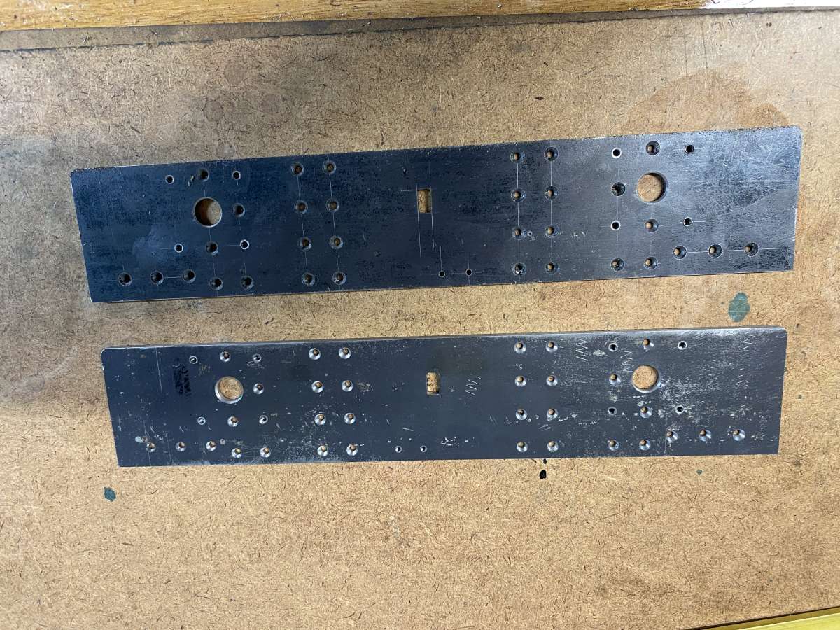

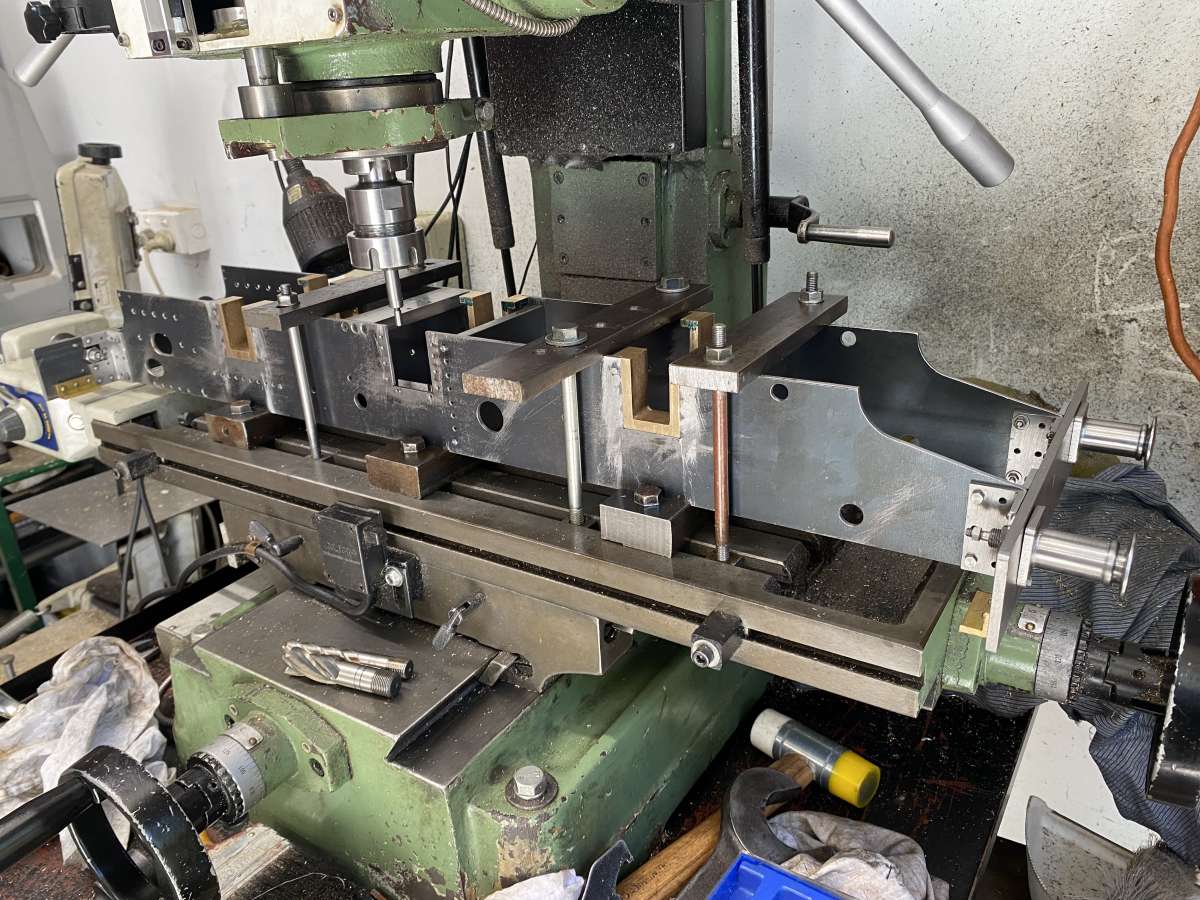

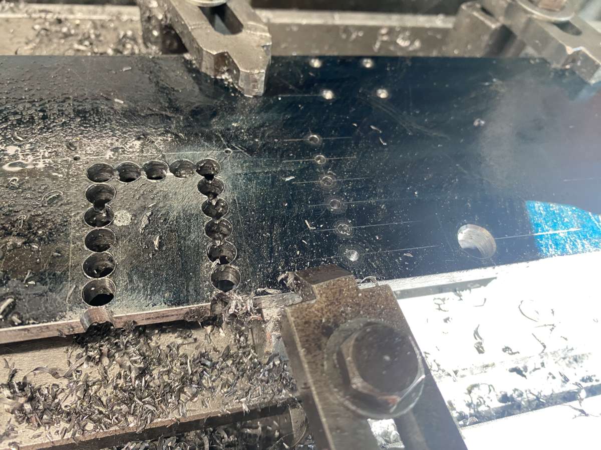

      A start was initially made on the frames.  Two blanks were plasma cut from 3mm  plate by a local fabricator, however when the edges were machined to size the frames warped quite a bit. A second set was purchased and this time the heat affected edge was cut away on the band saw prior to machining and frames were perfectly straight.  It was surprising how much stress was introduced into the steel from the cutting.  Here are some pictures of the frames.IMG_2261IMG_2262IMG_2266IMG_2267
      #842479

        Next step was to make the buffer beams, brackets and frame spreaders.
        The buffer beams were initially made from the scraped frames. The drawings were consulted and it clearly shows they need to be 3/16 not 1/8.  So these were re made in 5mm plate.
        IMG_2240
        The brackets were machined down from some angle iron
        IMG_2242
        and the frame spreaders were machined from 10mm x 125mm bar an later surface ground down to 3/8 thickness
        IMG_2260

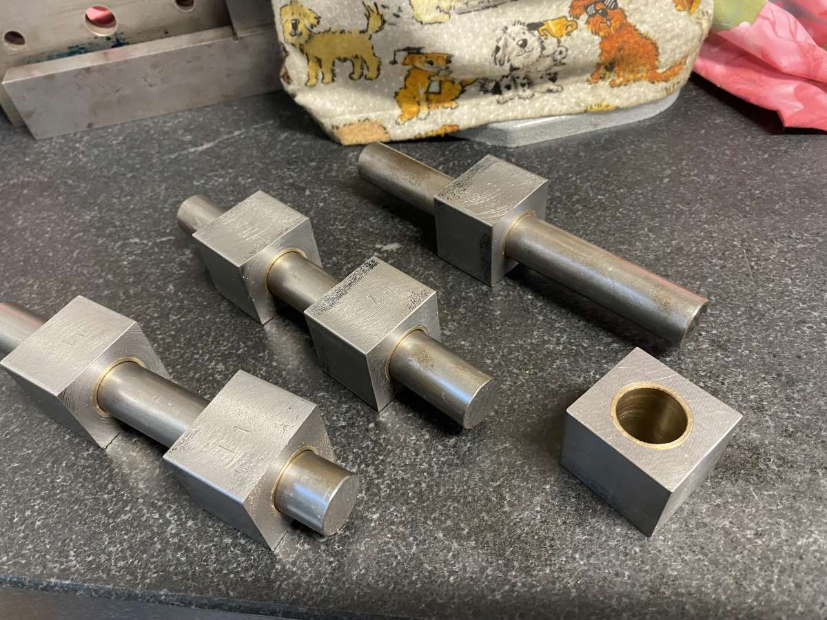

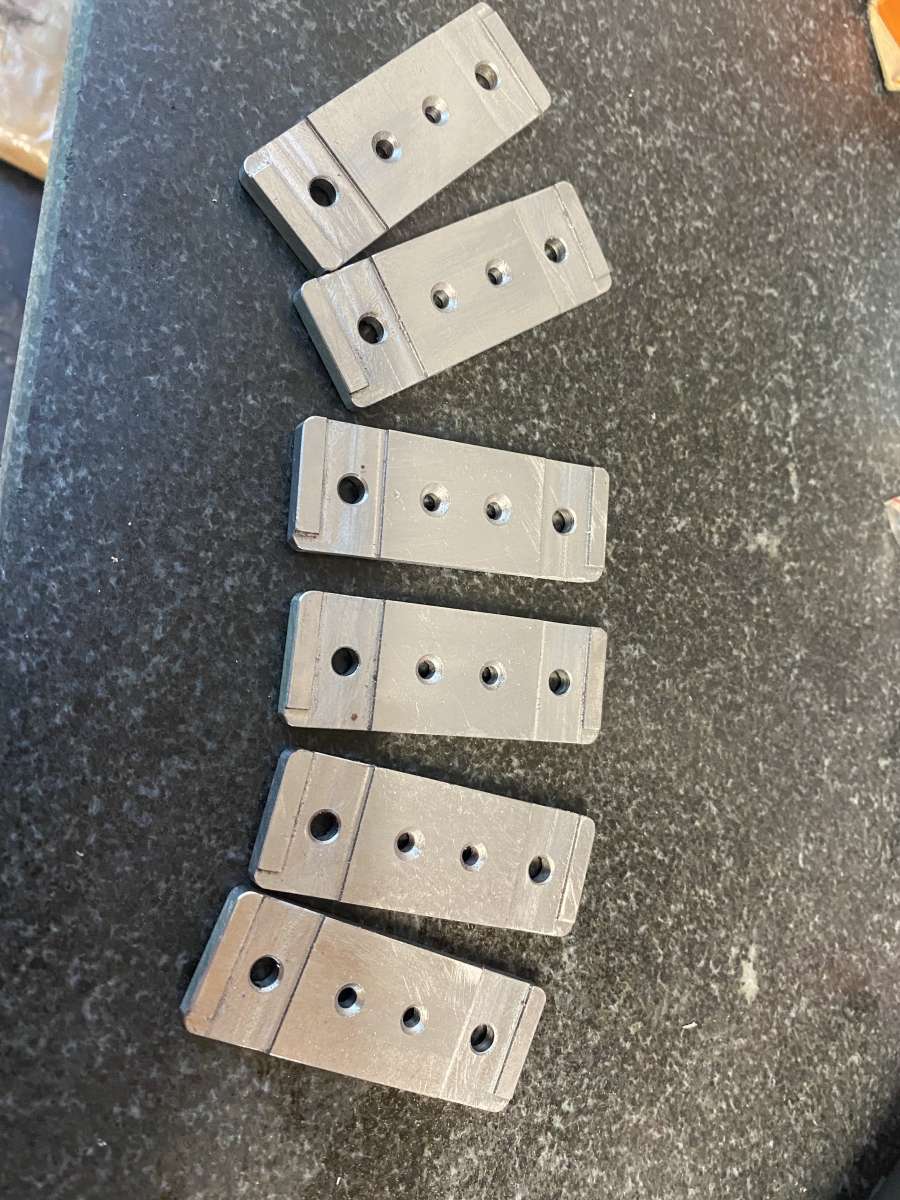

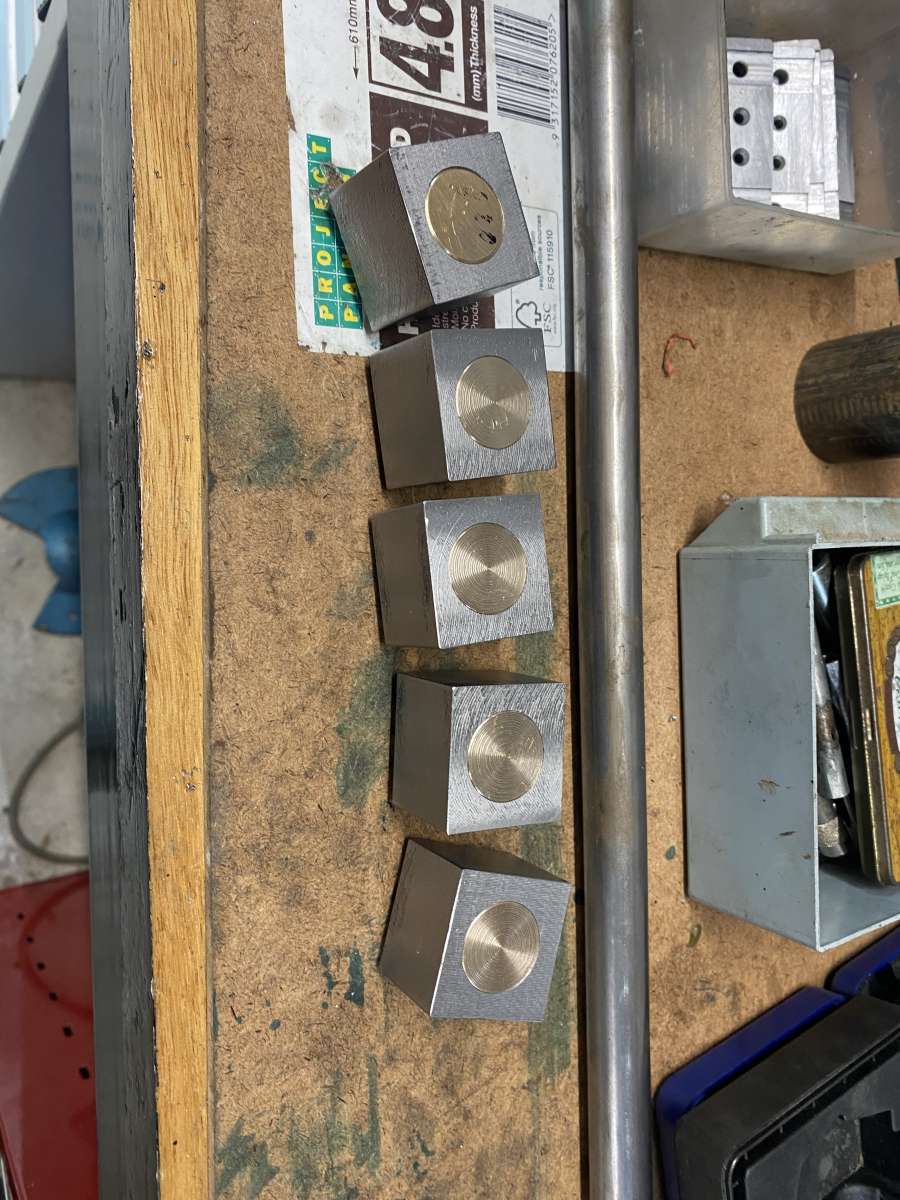

          Made a start on the axle boxes.  They were made from steel with Gunmetal liners to reduce the amount of gun metal requires.  The ME drawing of the keeps are not quite correct and need to have a small section machined from the outside edges to make sure they fit into the frames correctly.  I also had a go at making the springs.  The spring pins were made from 1/8 steel as per drawing but I noticed in the description Martin suggests some users may use 3/16.  So I hope the 1/8 pins should be sufficient.
          IMG_2271IMG_2270IMG_2273IMG_2272IMG_2277IMG_2278

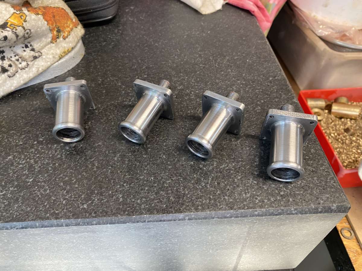

              Made the buffers this week.  Although as I found out talking to the guys at the club they are only decorative as a solid beam is required for connecting carriages.  They said buffers can be quite dangerous on small gauge locomotives as the carriages can push the locomotive off the rails if they make contact with the buffers.  The front profile on the buffers were machined on the lathe using the radius function on the DRO and finished with a file and emery. I need to get some 15g and 16g spring wire to finish the springs not sure where?  IMG_2286IMG_2285

                I had a go at doing some gun metal casting.  Started on the water pup as the casting was easy to make out a couple of blocks of timber.  I built the Martin Evan’s improved pump published in ME issue 3628.  Not sure if this is the best option yet as the pump Martin designed for the Super simplex came out after this article. Here are some pictures of the raw casting.IMG_2293IMG_2287

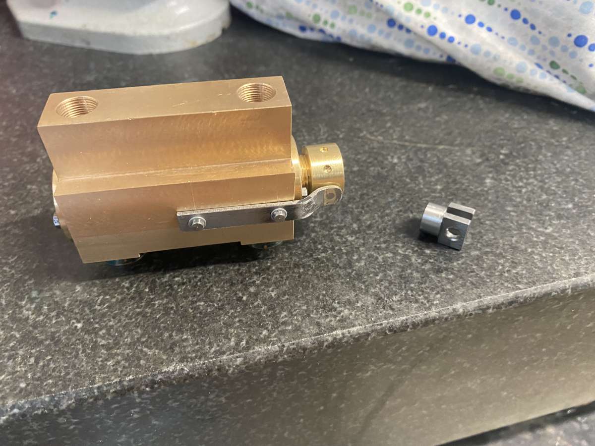

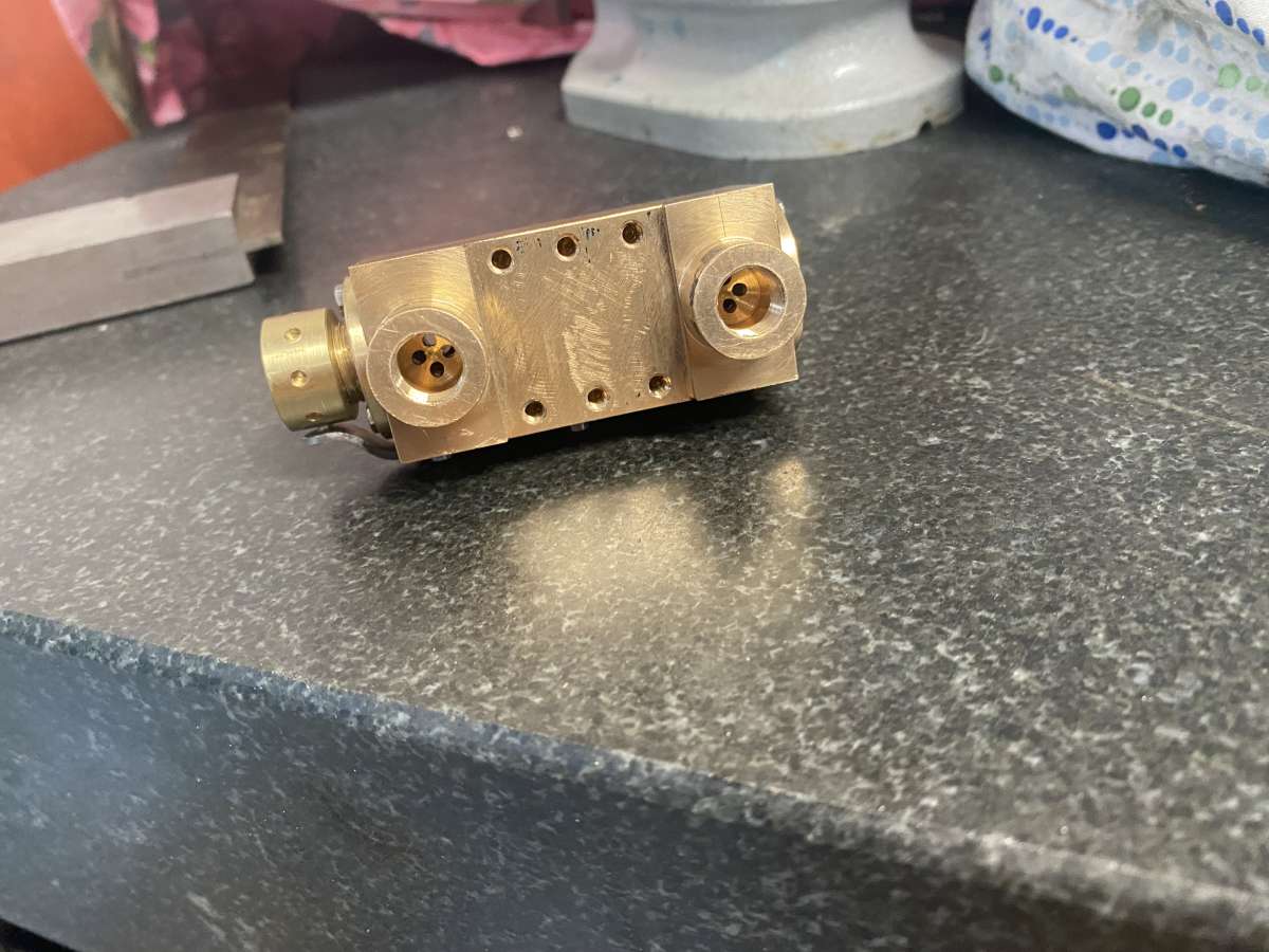

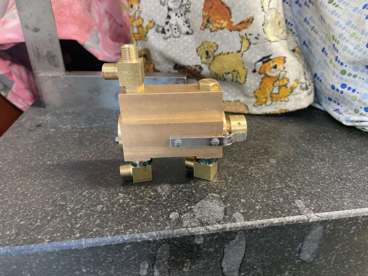

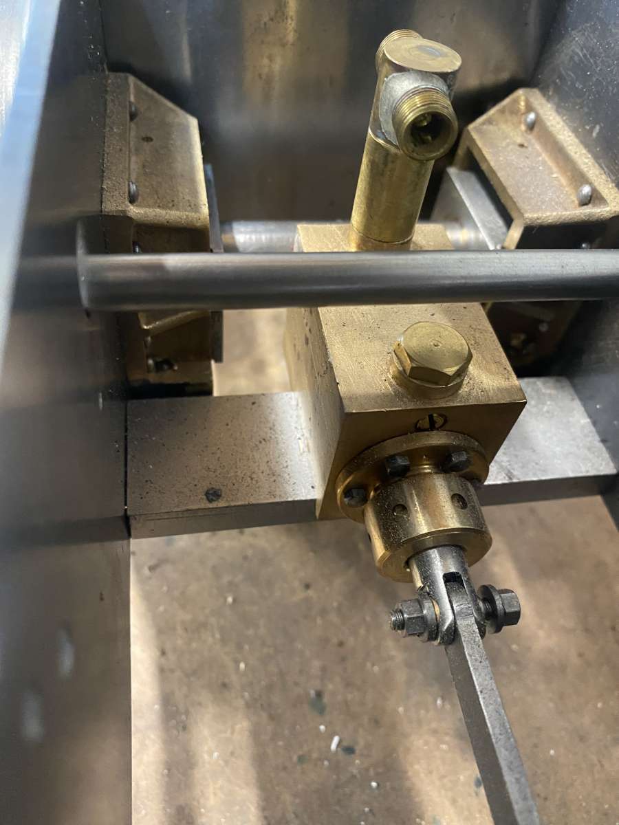

                  Machined up one of the castings for the axle pump.  This is Martin Evan’s improved design for the Simplex published in ME March 1980.  I think I will end up using this for the hand pump. I drilled the four No 46 holes for the pump suction first before drilling and tapping the 3/8 x 40 hole.  The valve lifts were all checked by measuring from the top of each of the suction and outlet bosses to the top the ball.  And the measuring the lengths of each of the fittings.
                  IMG_2305IMG_2304IMG_2306
                  #846811
                  Weary
                    @weary
                    Very nice work on that pump, and indeed on all the fittings, Peter.
                    I am curious as to why you are using it as the hand-pump though as it is a double-acting pump specifically designed to smooth-out the cyclical resistance of a ‘standard’ single-stroke axle-pump.  Though I vaguely recall that Mr Evans’ first design was not in-fact double-acting ….. hence the ‘improved’ design!
                    Very-much enjoying your build.
                    Phil

                      That casting came out well. All the rest looks pretty good, interesting comment about the buffers.  Noel.

                        #848710
                        Peter Hoerlein
                          @peterhoerlein37724
                          Phil,
                          Martin published a new design for the Super Simplex and I will make that one for the main pump just to follow his design. I did not want to waste this pump and looking at the hand pump published for the Super Simplex ME 7 July 1989 page 36. It looks very much the same
                          Regards
                          Peter

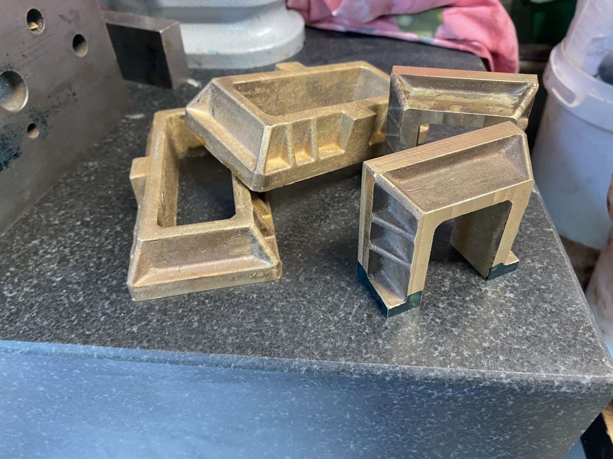

                            Peter Hoerlein
                              @peterhoerlein37724

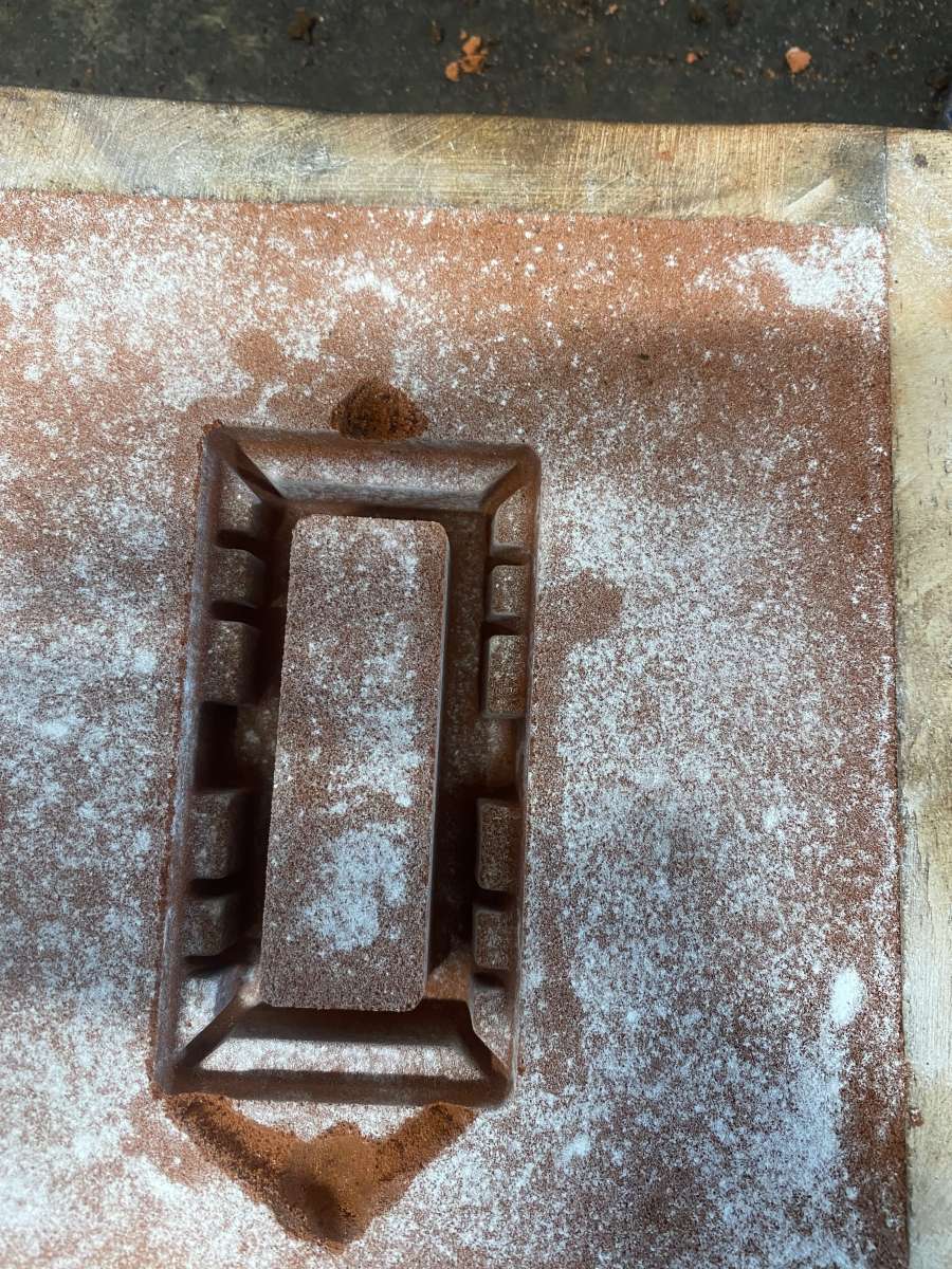

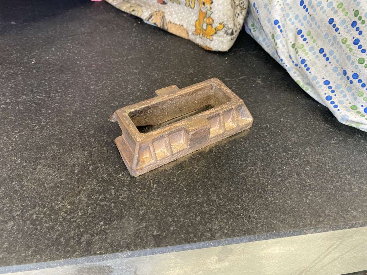

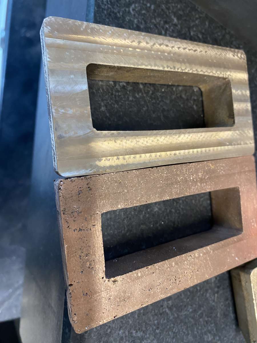

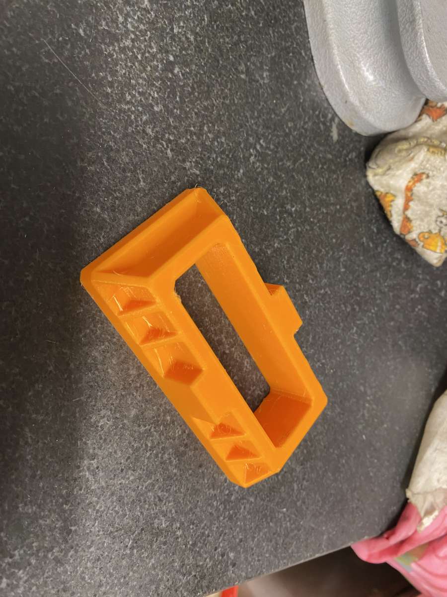

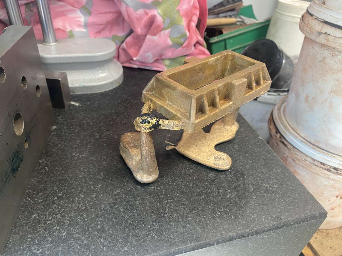

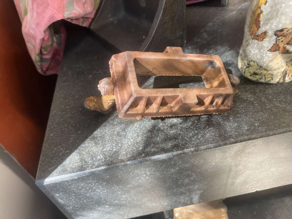

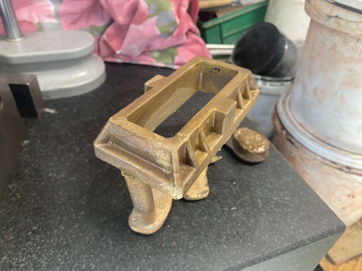

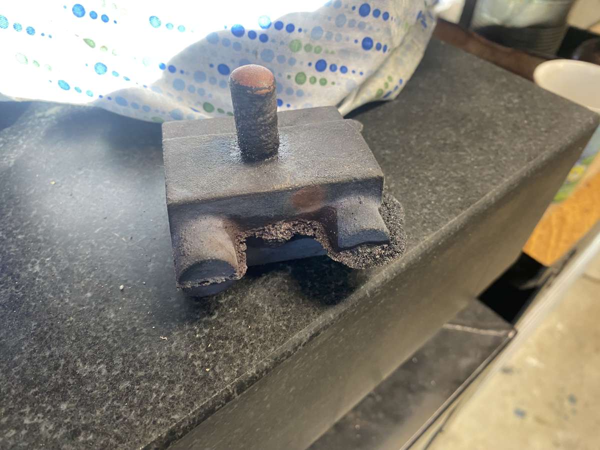

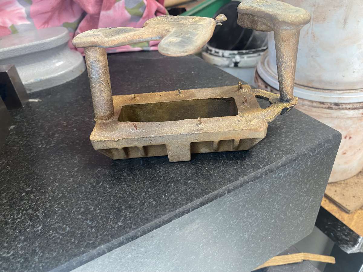

                              I had a go at casting the horn blocks.  My son has a 3D printer and printed out the pattern for me.  Due to the size of my furnace and crucible I can only cast one at a time and I had some mixed results and a few short pours.  I eventually got three sets but found that I had not left enough machining allowance:( I installed one set in the frames and as I was machining the last 10 thou the cutter caught and ripped the casting out of the frame as the side wall was too thin.  So it was back to the drawing board.  I got my son to print another pattern with better matching allowances.  I also had to weld all the holes I had put in the frames as the new horn block holes did not line up.  I reused all the old castings but that did not go well as when I started machining there were porous holes everywhere.  I spoke to a local guy who supplies casting material and he provided me with a billet of casting bronze. This worked much better. Up until now I was just using bar stock and after a few re-melts it is no longer bronze and looks not reddish in colour. Finally finished with a good set of castingsIMG_2386IMG_2399IMG_2284IMG_2430
                              Here is my final castings. A big learning experience.
                              IMG_2426IMG_2425IMG_2429IMG_2427
                              #848776
                              SteveP
                                @stevepye68246
                                They look really good castings,  very clean.
                                You’ve a skill I wished I possessed.
                                Steve
                                #848824
                                Nigel Graham 2
                                  @nigelgraham2
                                  I am impressed by those castings!
                                  I must admit I’ve fought shy of trying casting even aluminium, but I note plenty of runner and riser volume I take is to ensure complete filling.
                                  Stepping back up-thread a bit: Derek, you shouldn’t need lubricate axle-boxes (or any open bearings) by “squirt over the top”, avoiding that by pipes from suitable oil-cups screwed to the frame tops or some prototypical location right for the design.
                                  Nevertheless, the problem of grit from the ash-pan is real, especially on miniature locomotives with very basic grates and ashpans as many have. I think the ash contamination is much less from the running, than when dropping the fire by pulling a pin out and letting the entire caboodle unceremoniously fall out of the firebox. Especially outdoors on breezy days. (Similarly perhaps with traction-engines’ exposed steering-chain windlass and worm-gear just above the damper.)
                                  #849272
                                  Peter Hoerlein
                                    @peterhoerlein37724
                                    Thanks Steve.  Just practice and having a go.
                                    Nigel

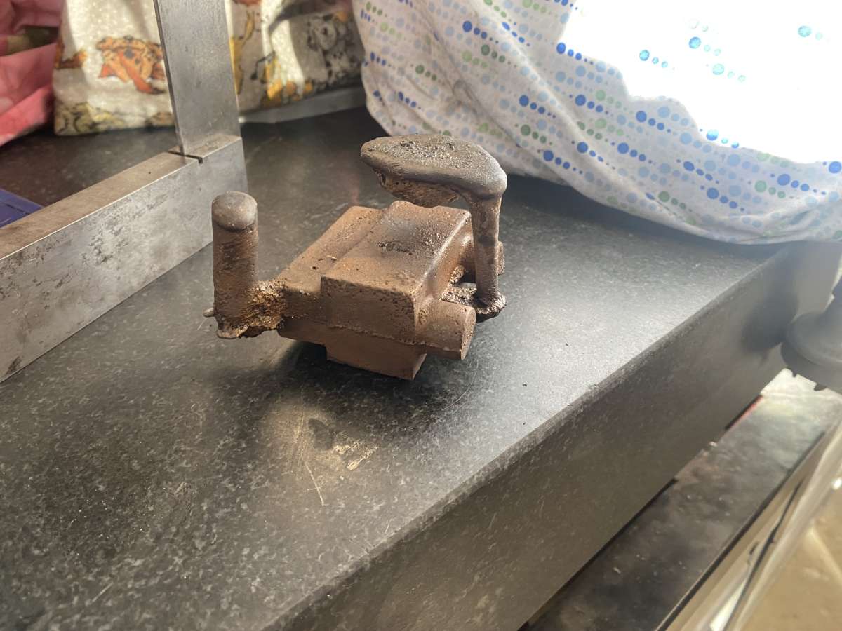

                                    I was using a small tapered sprue to start with and yes it was freezing before I could complete the pour.  There is such a small volume of metal in my crucible and it looses heat very quickly.  I have increased the size on the sprue to prevent this. It is surprising how much shrinkage you get especially like the central section of the pump casting.  Putting a riser above this section reduces the shrinkage  I found when casting aluminium it is best to use a large (3/4”) straight spruce to get a lot of aluminium into the mould as quick as possible to keep the aluminium all liquid as it is filling.  I use petrobond for the moulds as it leaves a nice finish. It is probably cheaper to just buy the castings if they are available but I like to have a go at it myself.
                                    Regards
                                    Peter
                                    Here is couple of pictures of the mould before closing up and the pouring basin spruce and riser.IMG_2398IMG_2400

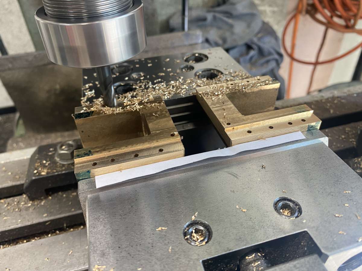

                                    #850409
                                    Peter Hoerlein
                                      @peterhoerlein37724

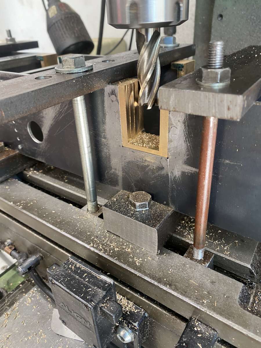

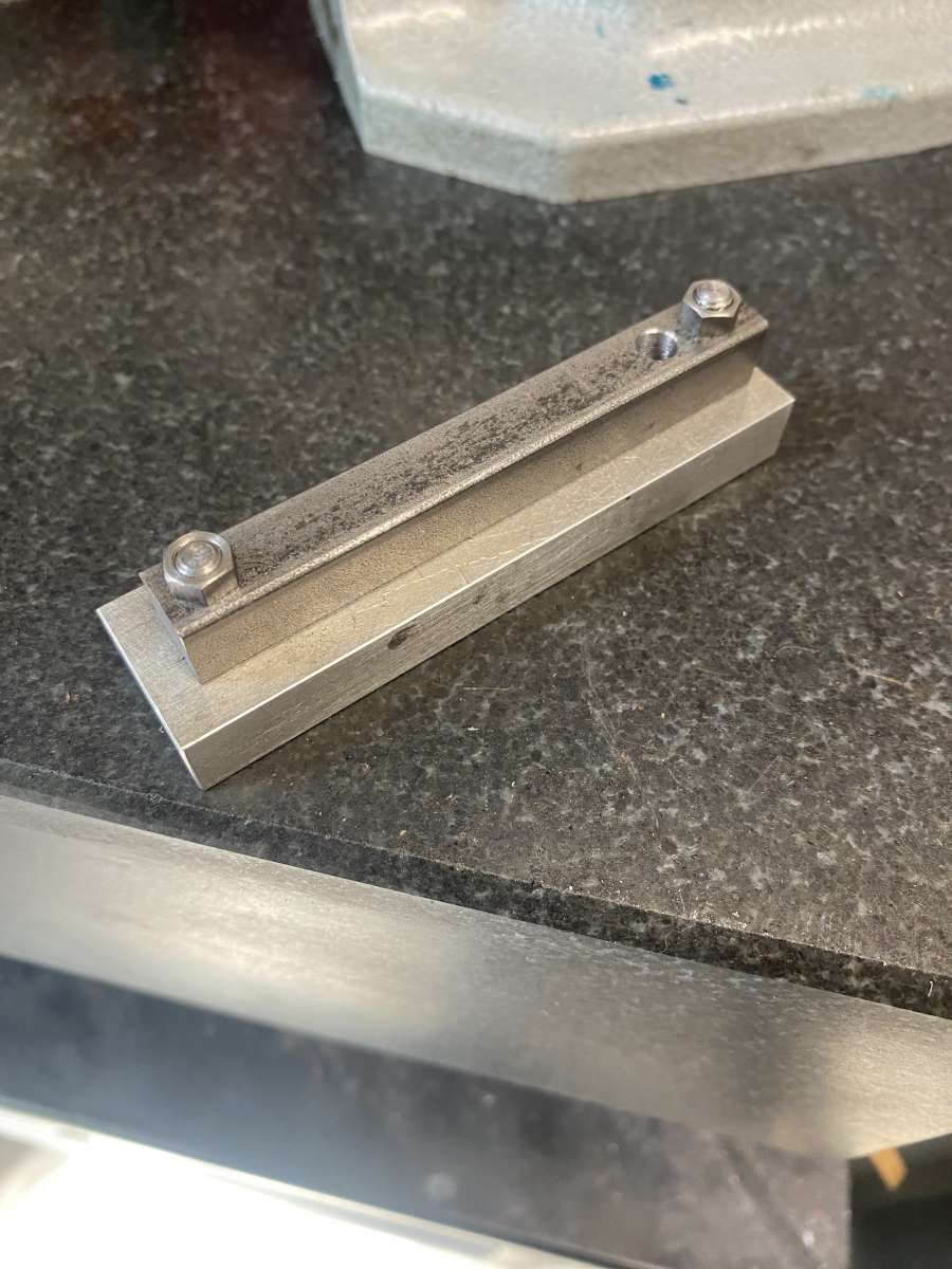

                                      The second attempt at machining the horn blocks worked a lot better with the new castings as there was about a 1/16” more material all round. The front and rear part of the horn blocks were all machined in pairs to dimension and then riveted to the frames before machining the centres using a long mill cutter.  The travel on my mill was not big enough to machine the horn blocks in a single set up.  So I used one of the centre frame cut outs as a reference between setups. There is a number of ways to machine the horn blocks to ensure correct alignment and spacing but this is the method I chose.  Six lengths of scrap bar stock were first bolted to the mill table and 3mm slots about 1/8” deep were cut out at the required frame spacing.  Three of these bars were removed and the frames were fitted into these slots and bolted down between the bars.  The setup was rigid enough as long as small cuts were used. One horn block was left out of centre cutout and the DRO was zeroed at its centre. The rear two and the one centre horn blocks were machined to dimension first.  The frames were then removed leaving the bottom fixed bars in place.  The last centre horn block was riveted in place and the frames were repositioned on the mill table to allow the remaining blocks to be machined.  The DRO was re-zeroed to the previously machine centre horn block and the remaining horn blocks were machines to dimension.  The slot widths were checked using gauge blocks and test fits of the associated axle block. The slot depths were checked using a depth micrometer.  Here are some photos of the setup.IMG_2435IMG_2436IMG_2433

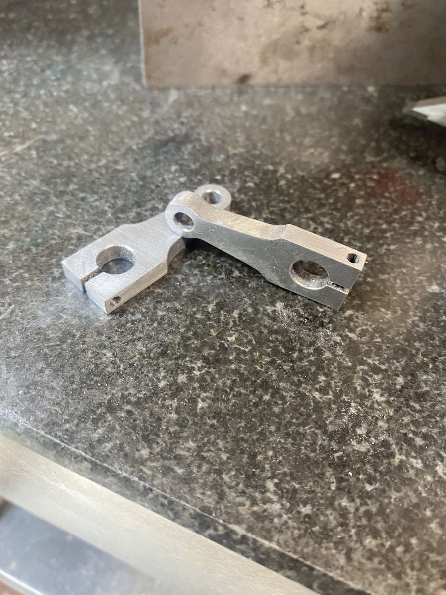

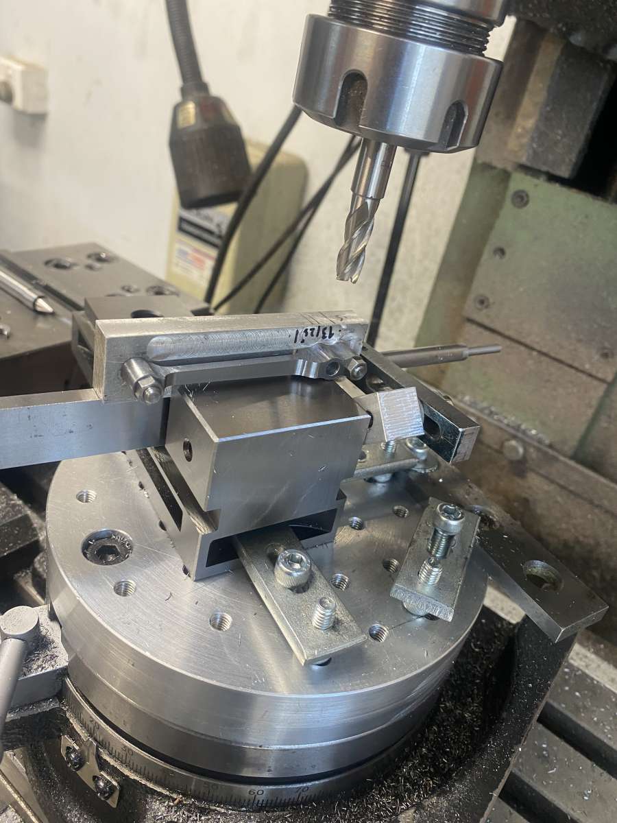

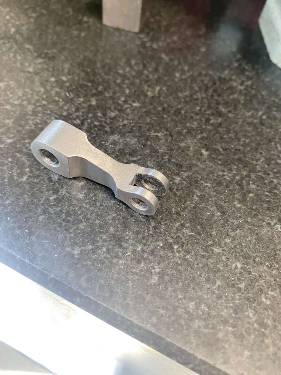

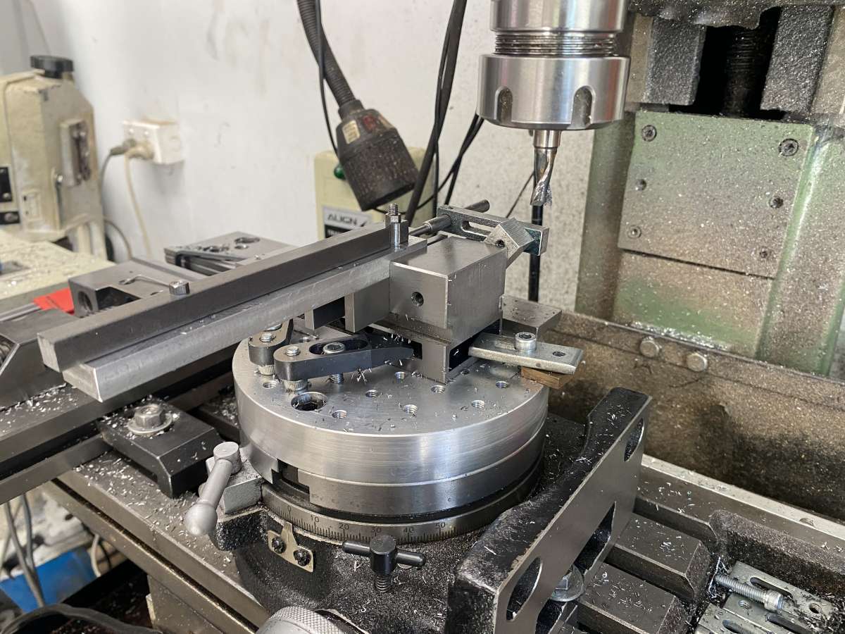

                                        Made a start on the valve gear linkages.  First off was the combination lever.  Three holes were drilled and reamed to 3/16” in a 3/8” square steel bar.  Identical holes were drilled and reamed in a sacrificial piece of aluminium.  The aluminium was machined exactly 20mm wide and the top hole was centred and offset 10mm from the top edge.  I have metric gauge blocks so it is easier to set up using the metric dimensions. Two 3/16” silver steel rods were screwed 2BA on one end and the other end was glued into the aluminium and the 3/8” bar was bolted to the aluminium.  IMG_2404
                                        The rotary table was set up true to the mill spindle and a machine vice was mounted onto the table so that when the aluminium support was secured the top hole was true to the spindle.  The combination lever was then machined using the Joe Pie method. I was able to get some accurate parts doing it this way.
                                        IMG_2406IMG_2405IMG_2407IMG_2408
                                        The combination levers were hand finished with needle files and emery.  The lifting arms, return cranks and reversing arm were machined using the same method.
                                        IMG_2420IMG_2415IMG_2411

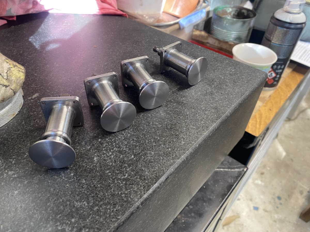

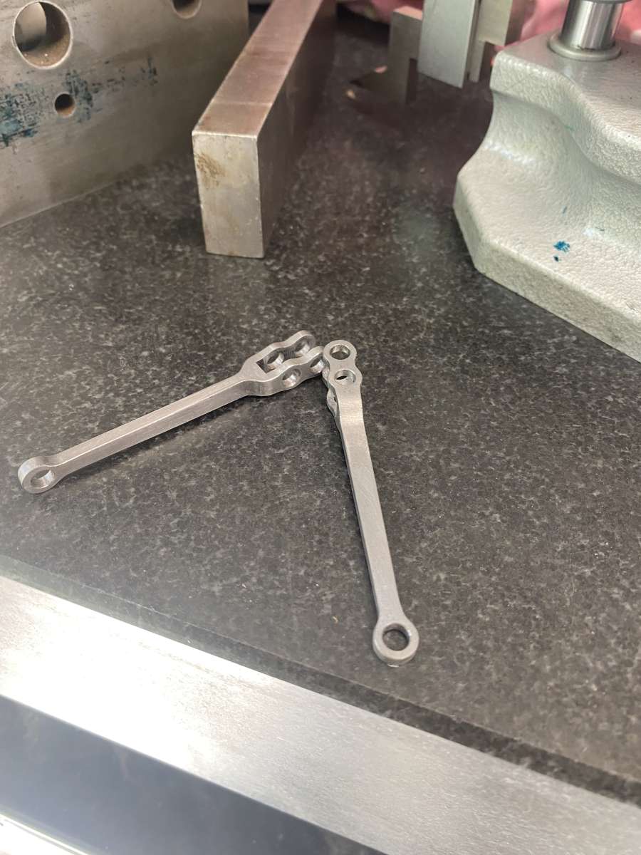

                                        #857913
                                        Peter Hoerlein
                                          @peterhoerlein37724

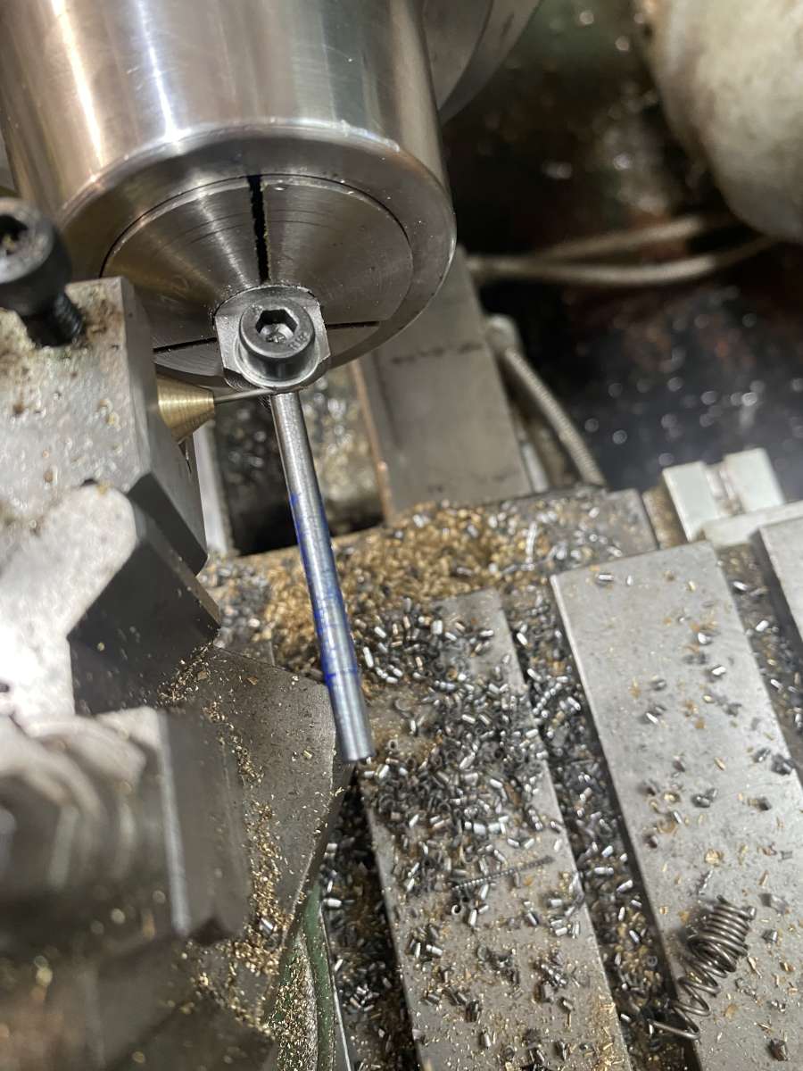

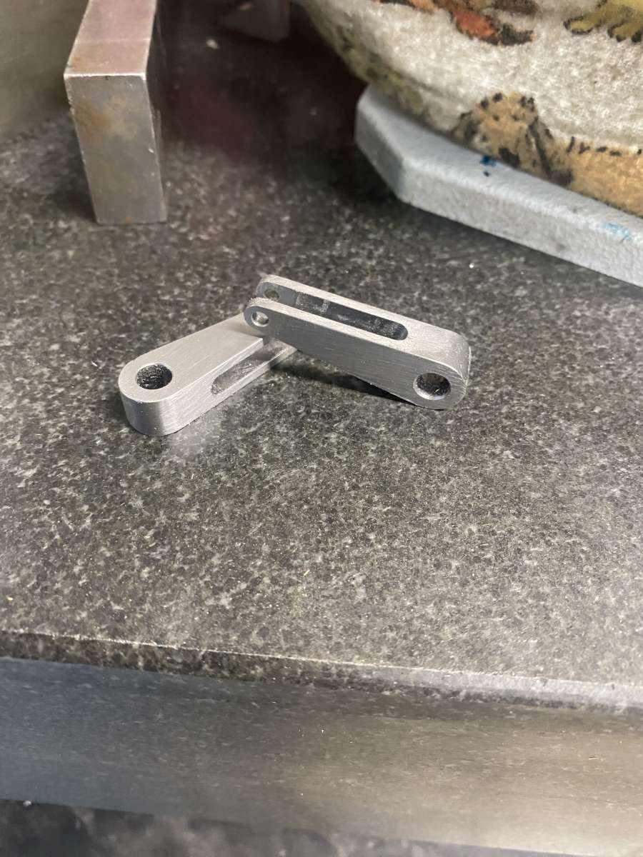

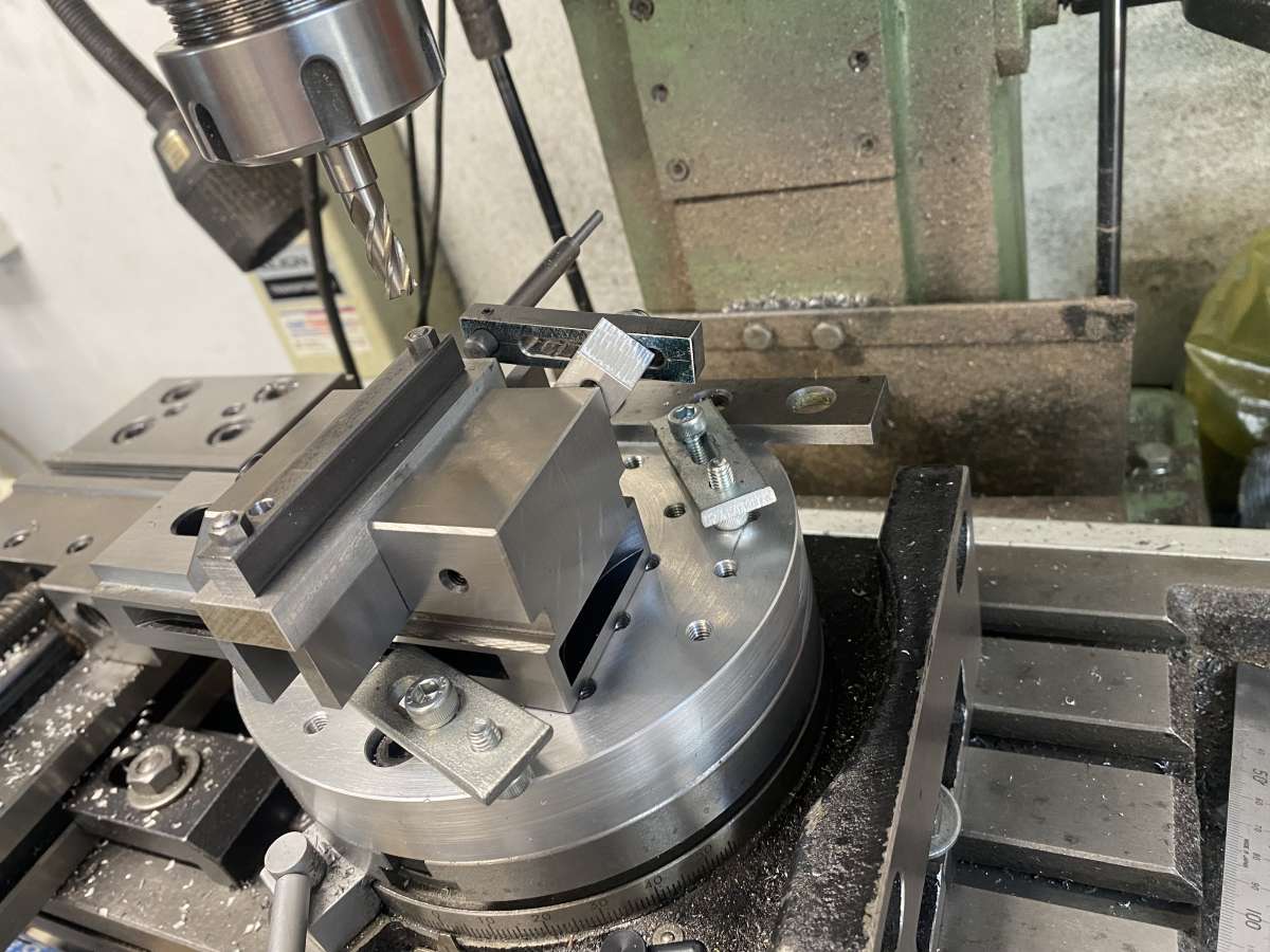

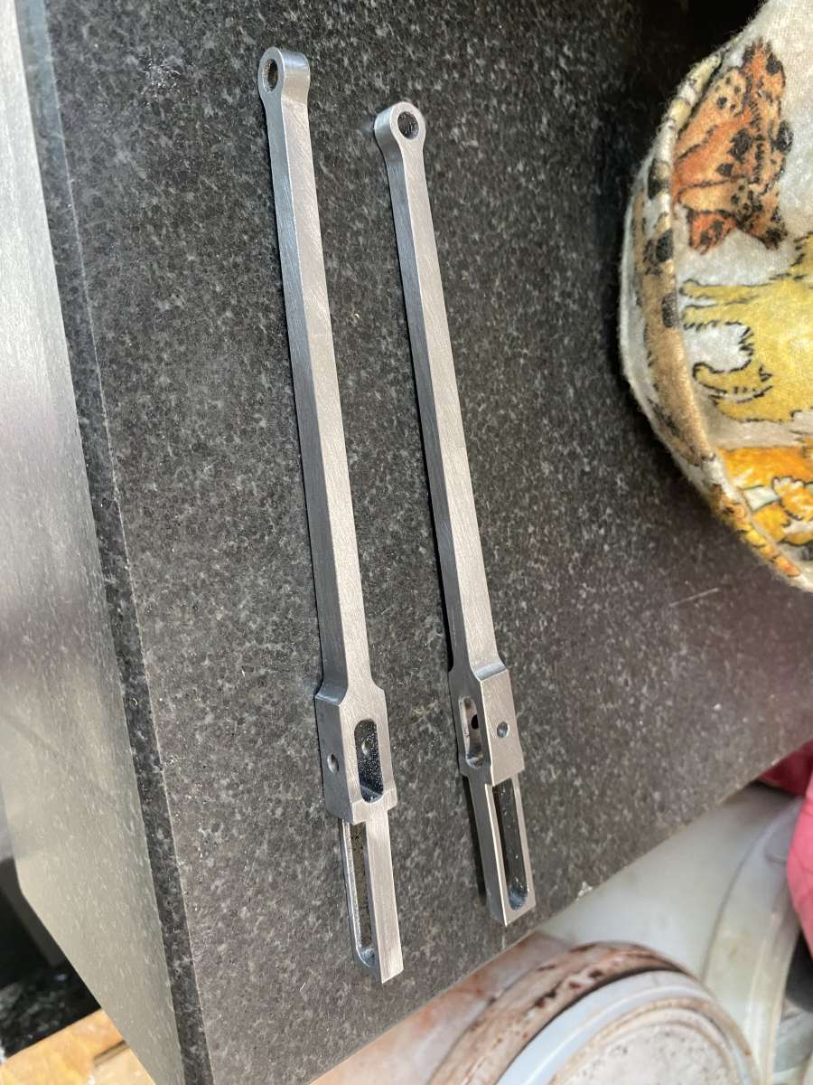

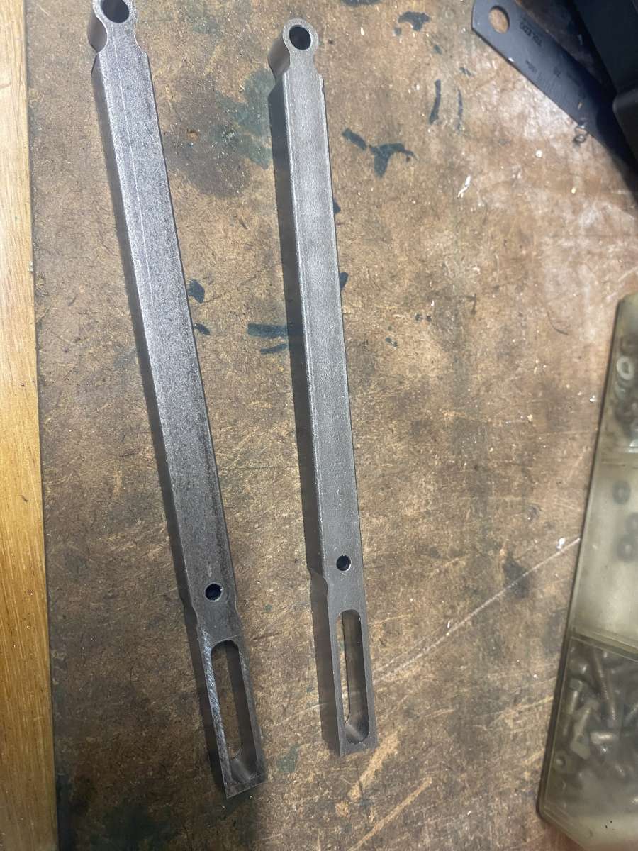

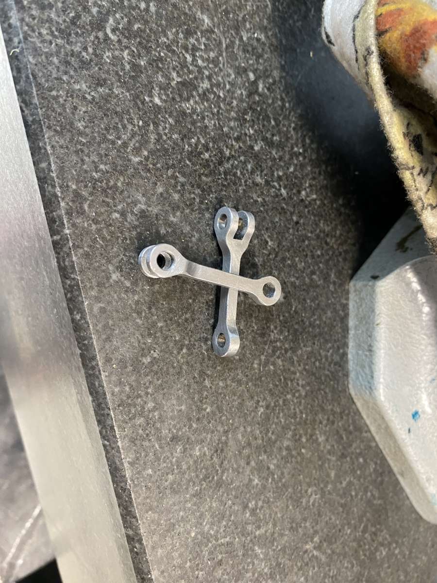

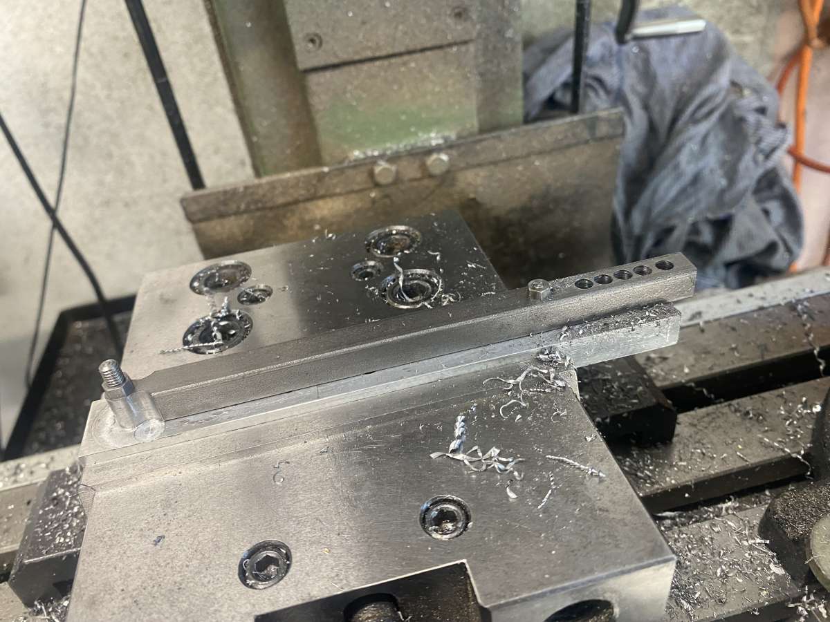

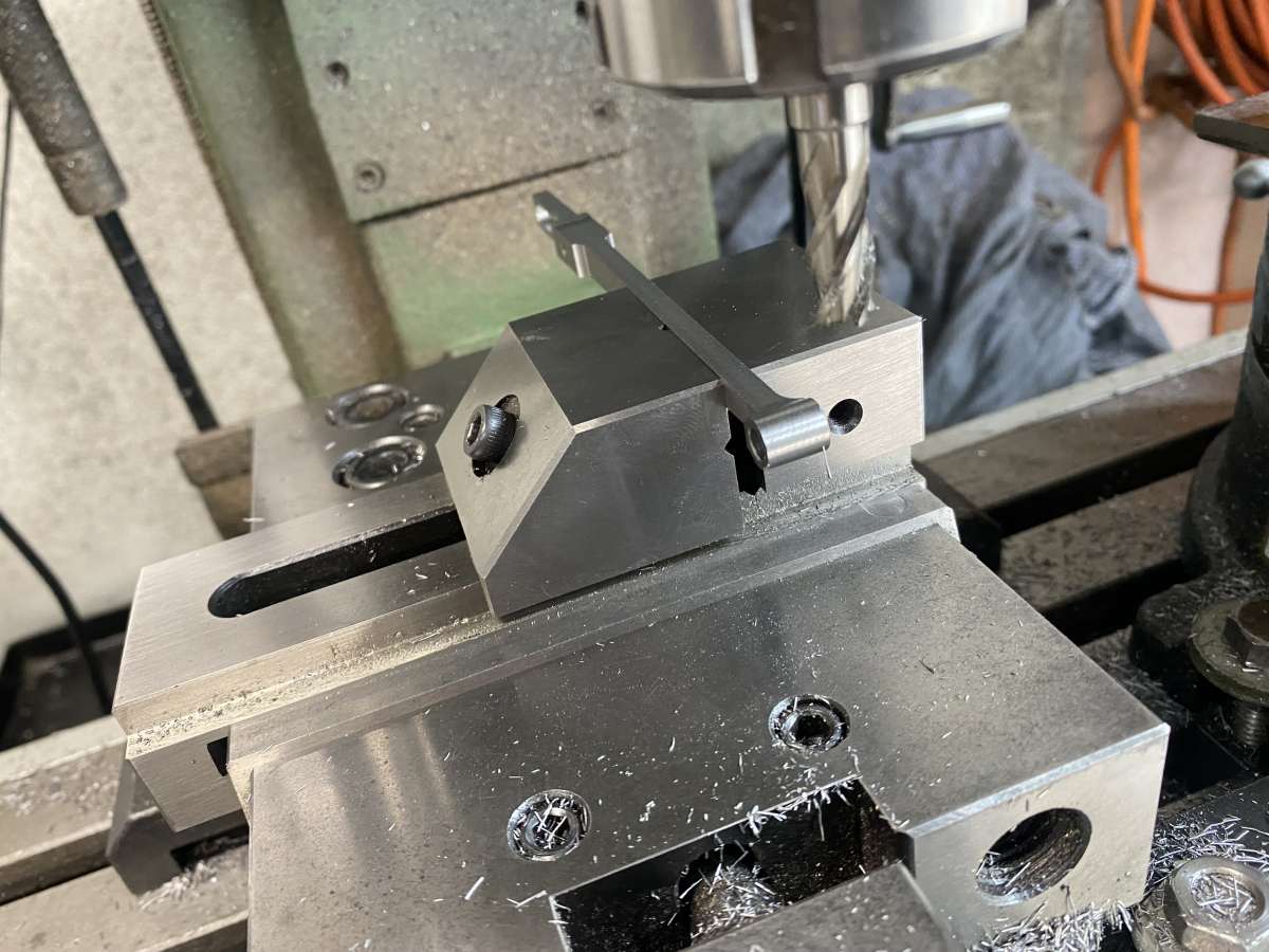

                                          Continuing with the valve gear. The radius rods were machines from 3/8” BMS square bar. The holes for the combination lever and expansion link were drilled and reamed and the bar was mounted onto an aluminium fixture.  The rotary table was set up to machine the radius on the combination lever end.  Then it was back to the vice to chain drill and machine the slot for the lifting lever.
                                          IMG_2449IMG_2448IMG_2450
                                          The rod has a slight taper and the rotary table was set up to machine the angles on both sides.
                                          IMG_2453
                                          The lifting lever end was machined down to dimension and then the rod was side milled to thickness.
                                          IMG_2455IMG_2454
                                          The final machining operation was to side mil the combination lever end to dimension and then finish with a file and emery.
                                          IMG_2457IMG_2456
                                          The anchor links were also completed
                                          IMG_2458
                                          Hopefully I have all the terminology correct.

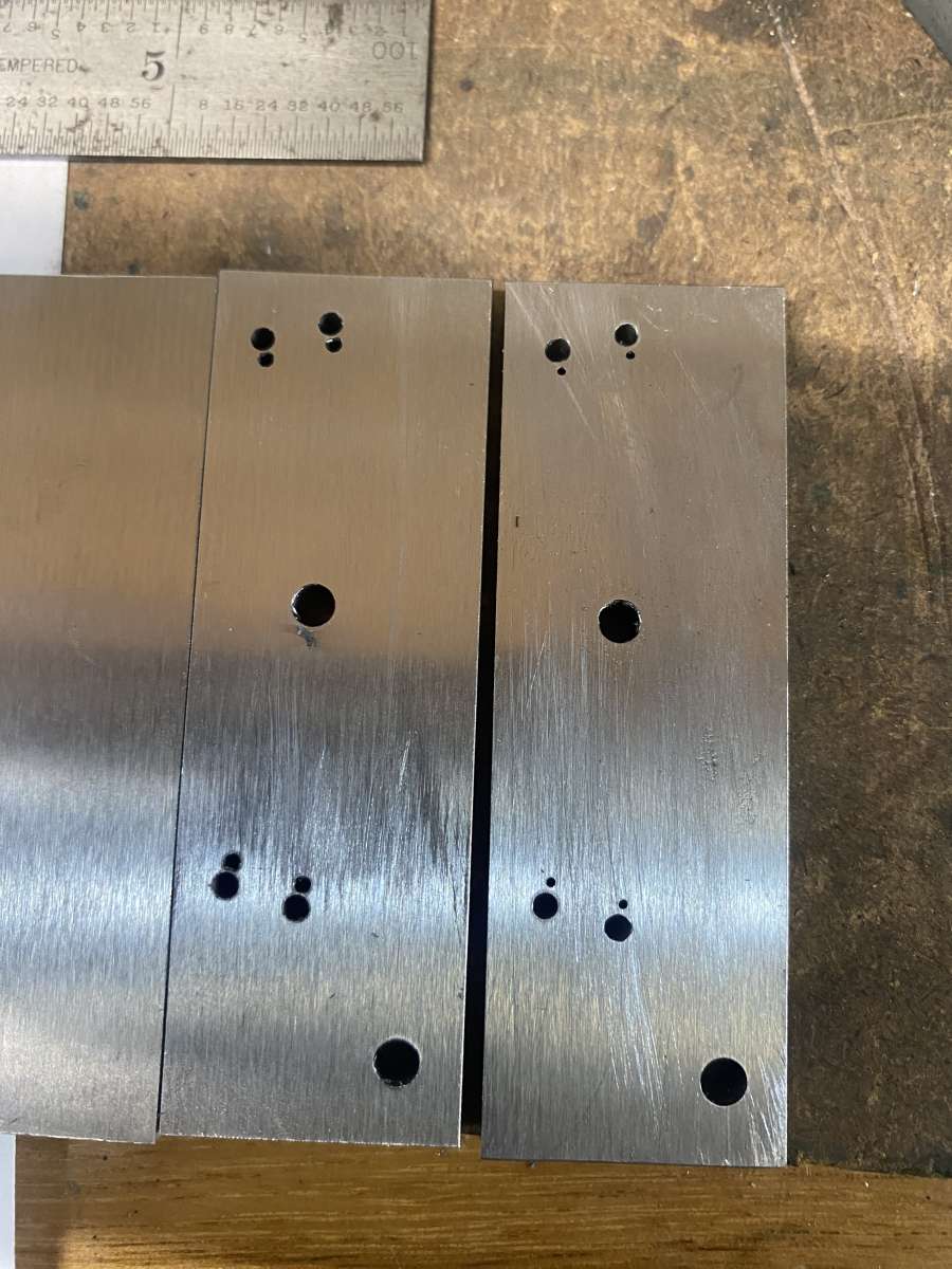

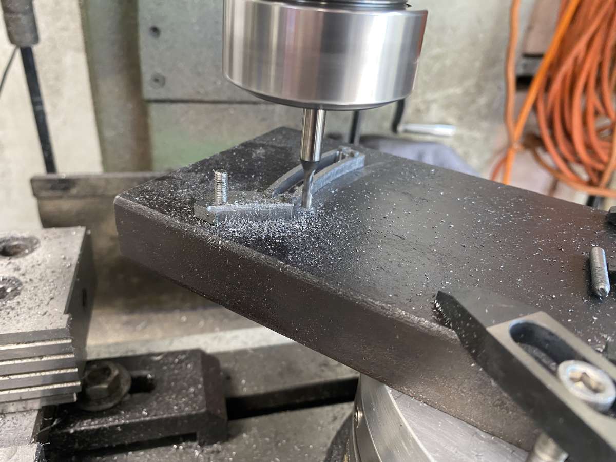

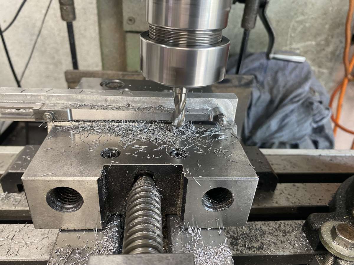

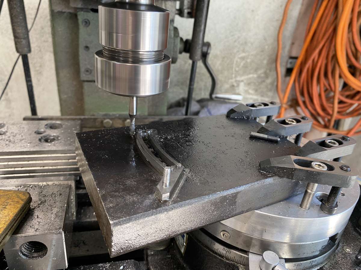

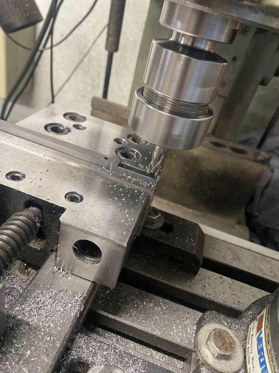

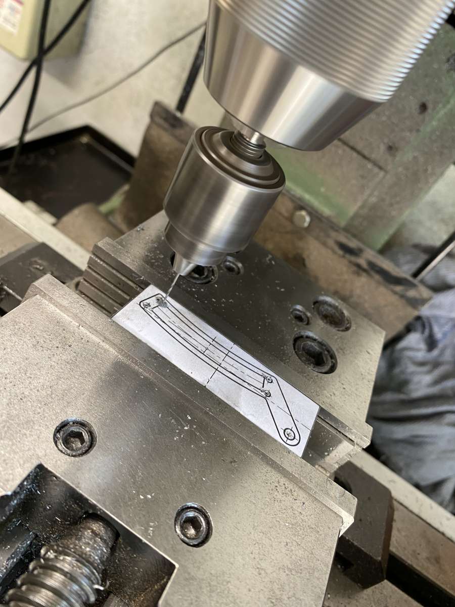

                                          #862071
                                          Peter Hoerlein
                                            @peterhoerlein37724

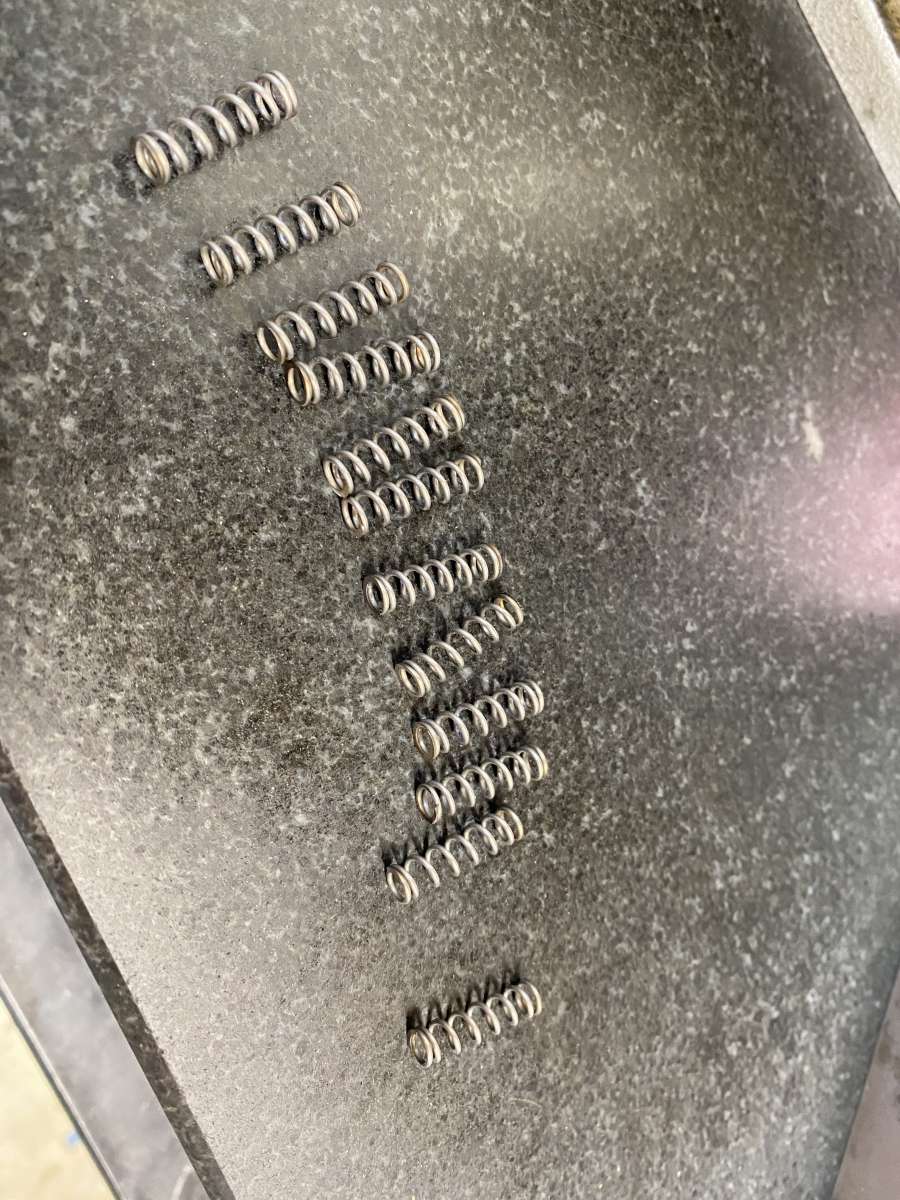

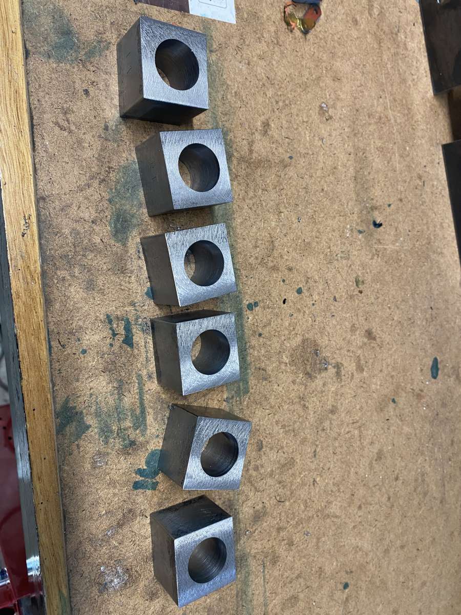

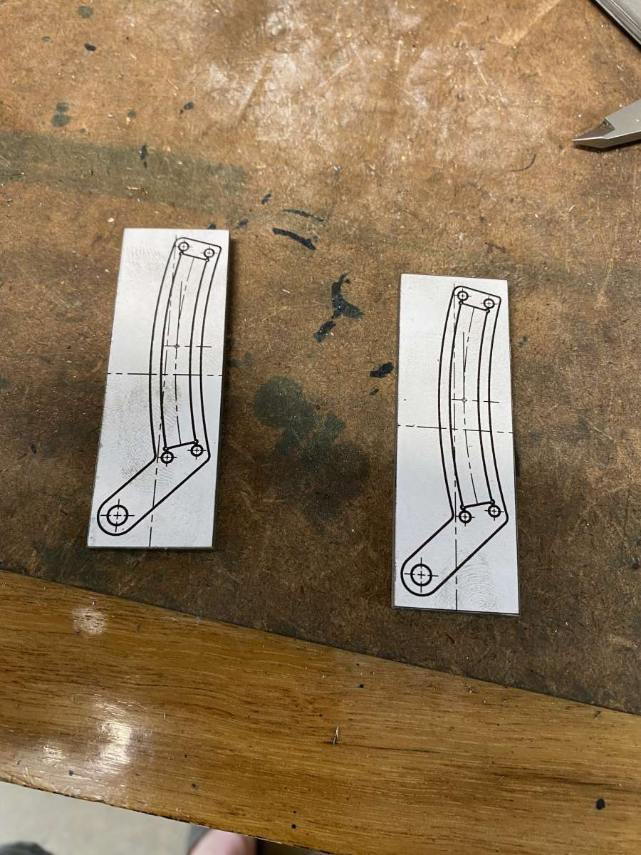

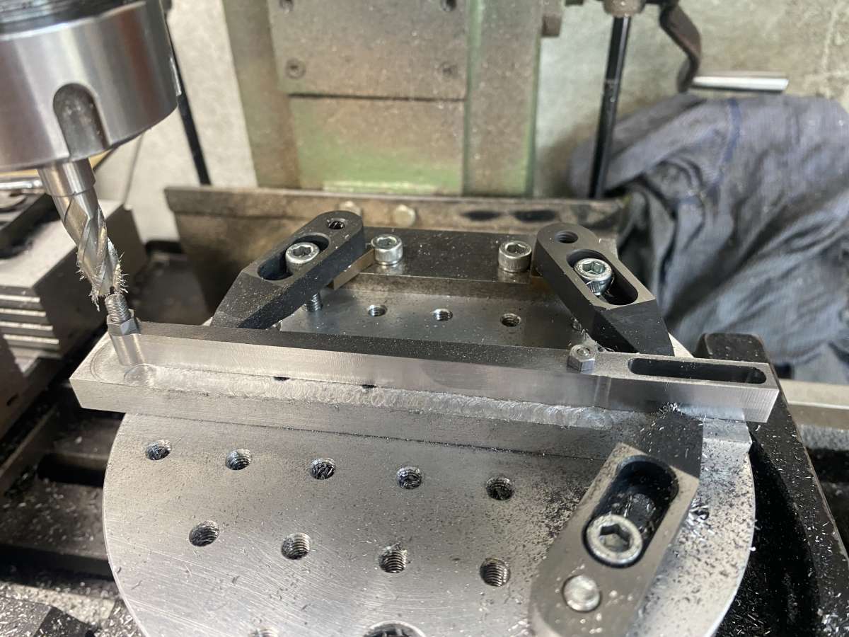

                                            Next step was the expansion link and some 1” x 3/16” ground O1 tool steel was used to make these.  All the holes were drilled including some relief holes in each of the corners of the radius.  Initially I tried 1/16” holes for these but they were too big so I then went to a number 60 drill.
                                            IMG_2460IMG_2459IMG_2462
                                            The links were mounted on some 1/2 steel plate to extend the radius of the rotary table.  The centre section was chain drilled and milled and the outer profiles were also milled in the same setup
                                            IMG_2464IMG_2463IMG_2465IMG_2466

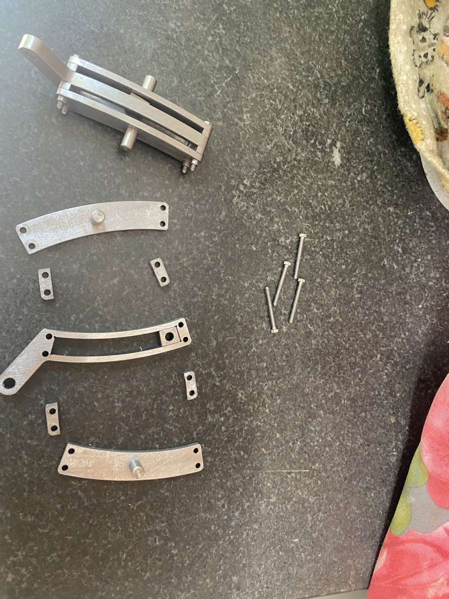

                                            The die blocked were machined together in the same fixture and then hardened.
                                            IMG_2473IMG_2472
                                            Once all the components were completed it was screwed together with some shop made 8ba stainless steel screws
                                            IMG_2477
                                            #862228

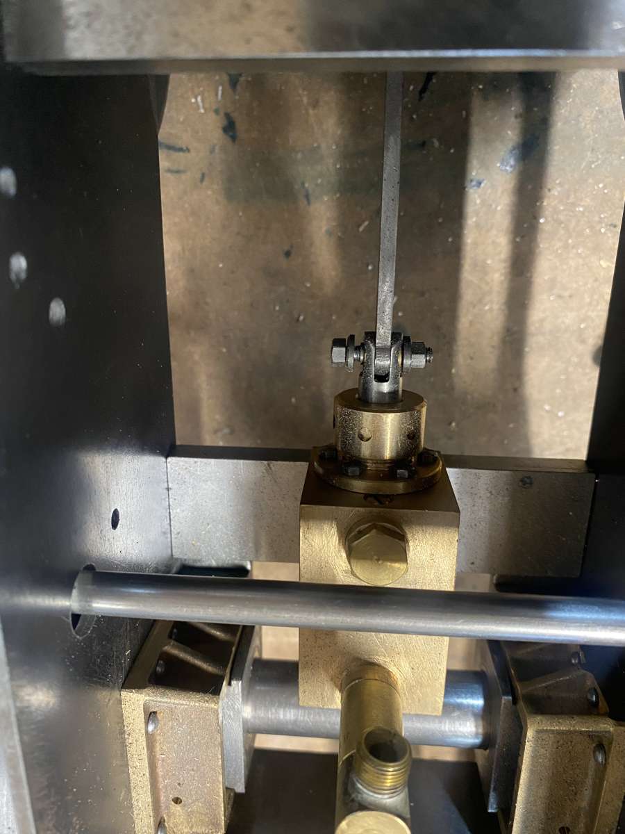

                                            Derek Drover
                                              @derekdrover32802
                                              Not so sure about the Super Simplex, but certainly on the ordinary Simplex, you need to machine out a slot on the top of the axle pump so that there’s sufficient clearance from the weighshaft, the “notch” allows you to tilt the pump over and take it out.
                                              This is detailed on the North London SME website mods for Simplex.
                                              #862787
                                              Peter Hoerlein
                                                @peterhoerlein37724
                                                Derek
                                                Thanks for the comment. I temporarily put the lay shaft in and I think there should be enough clearance.  The Super Simplex pump is a bit different to the ordinary Simplex one.  I have made both types and I will use the ordinary Simplex pump as the hand pump in my build.  I checked out the web site and I already have that document.
                                                IMG_2984IMG_2983

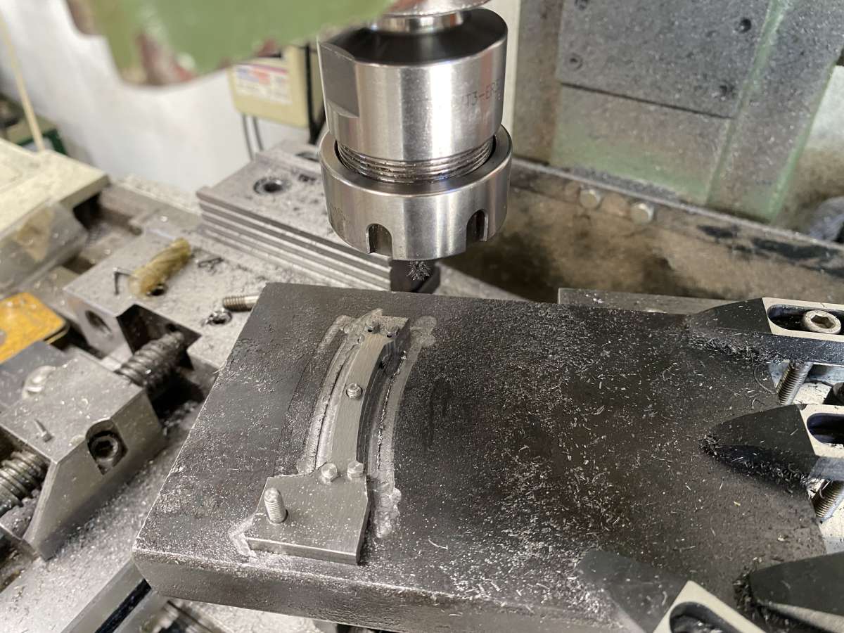

                                                #869359

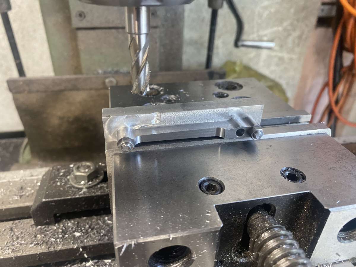

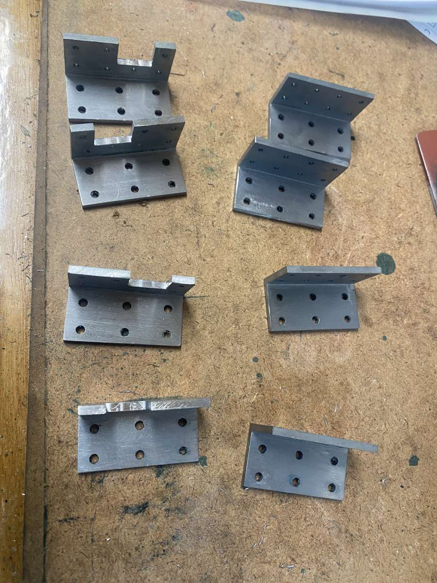

                                                Peter Hoerlein
                                                  @peterhoerlein37724

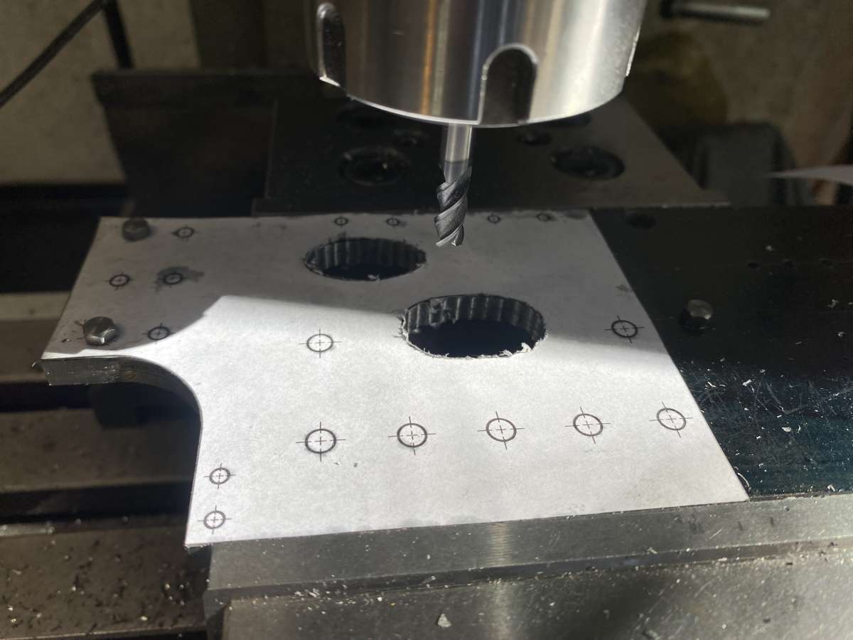

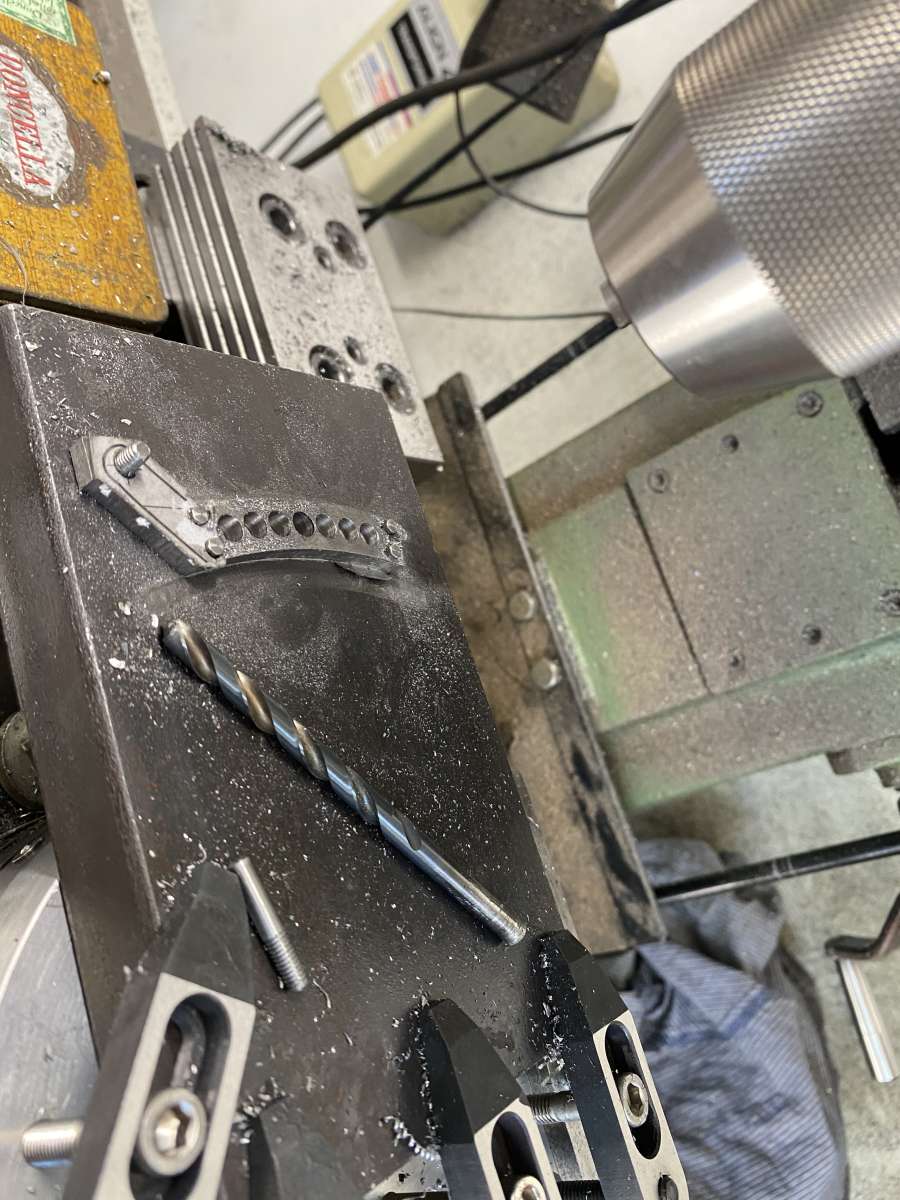

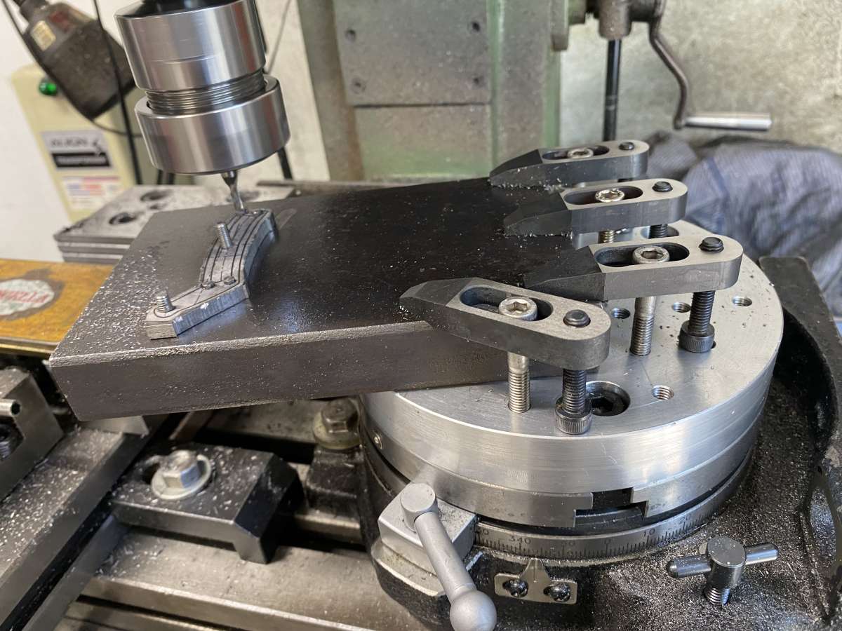

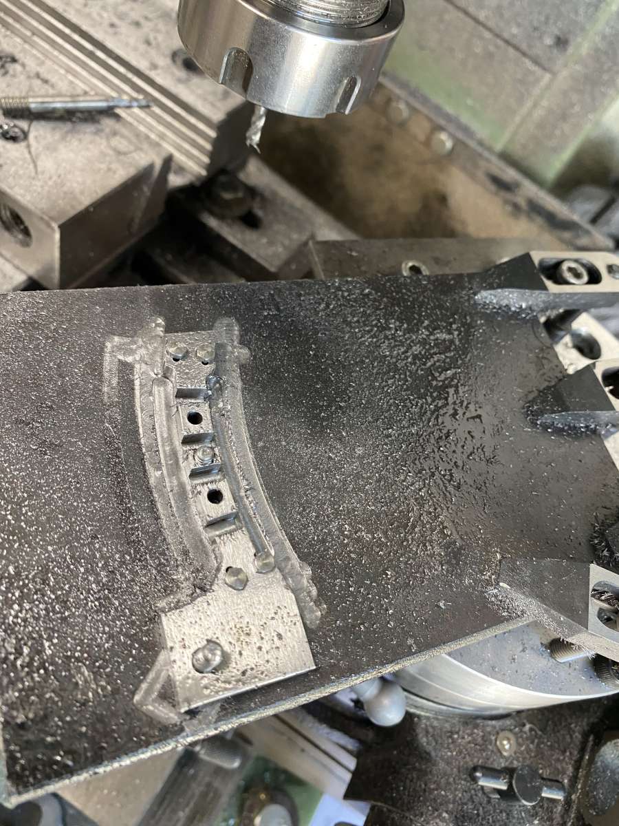

                                                  Made a start on the motion brackets.  The blanks were machined to the outside dimensions and the holes drilled using the DRO.  The cutout was chained drilled prior to machining
                                                  IMG_2482IMG_2478
                                                  An aluminium mounting plate was made to machine the outside profile including the curves on the rotary table.
                                                  IMG_2494
                                                  IMG_2495IMG_2492IMG_2497
                                                  Finally the brackets were put on the surface grinder to grind to an accurate thickness.
                                                  IMG_2499
                                                  The link brackets were machined in a similar way.
                                                  IMG_2508IMG_2507
                                                  An angle block was used in the vice to machine the inside angles.  The setup was a bit sketchy but worked ok
                                                  IMG_2509
                                                  It was a bit tricky to get the mounting holes in the correct place to ensure there would be enough threads on the 5BA bolts.
                                                  IMG_2506
                                                  The finished brackets
                                                  IMG_2510
