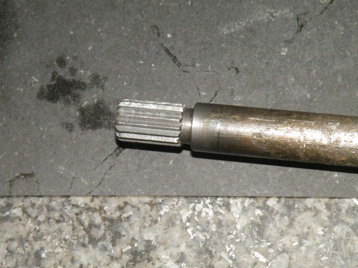

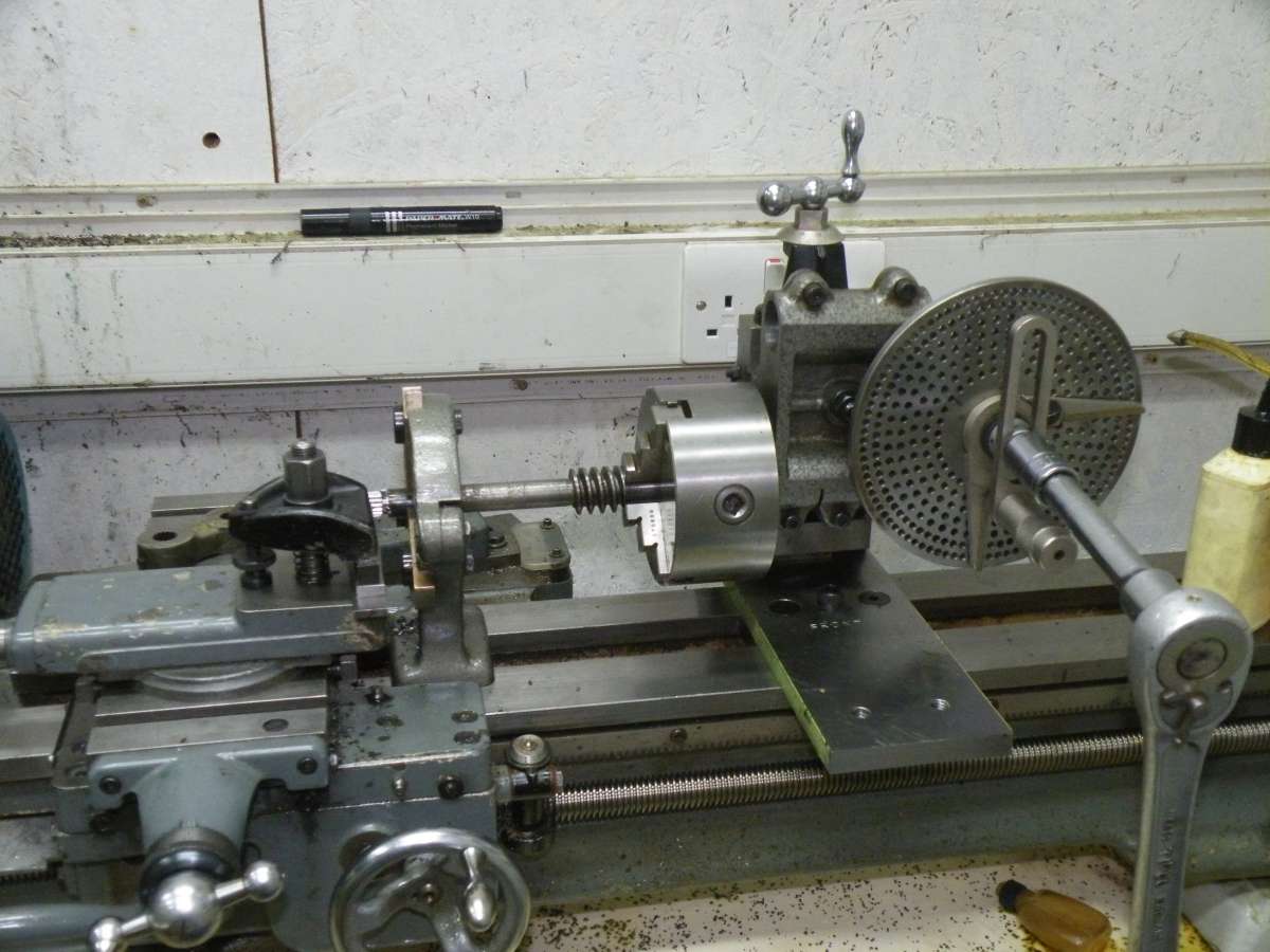

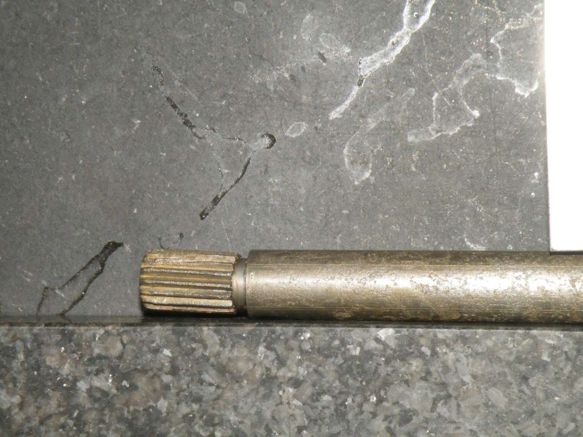

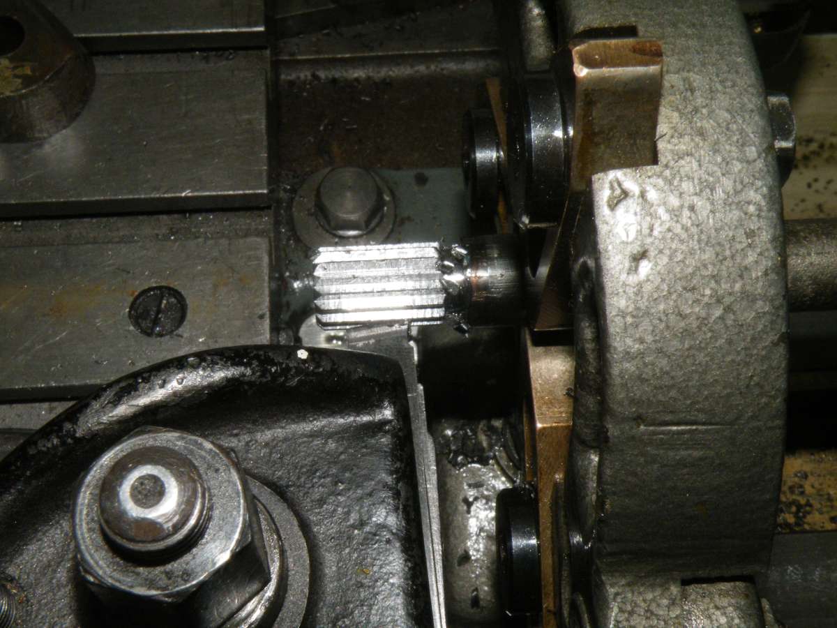

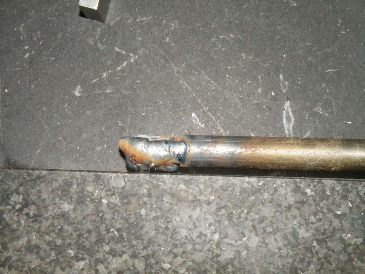

      I’ve just found the pictures of my fix for the first of the five splines I restored. No commentary, the pictures tell the story:-
      DSCF0789
      DSCF0791
      DSCF0793
      DSCF0798
      DSCF0797
      DSCF0802

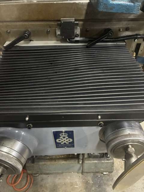

      Lex Davis
        @lexdavis38817

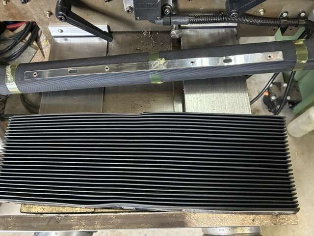

        My next job will be to fit these.
        Beaver 10
        #852868
        Andrew Skinner
          @andrewskinner94774
          Those look good. I used silicone baking mats from Amazon, which aren’t concertina’ed but are readily available and cheap.

            Just looked at my post above and the pictures seem to be missing. Trying again:-
            DSCF0789
            DSCF0791
            DSCF0793
            DSCF0798
            DSCF0797
            DSCF0802
            Hopefully that worked.

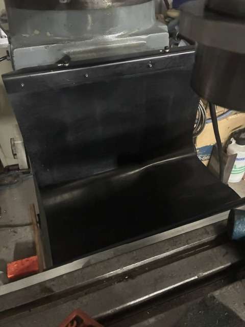

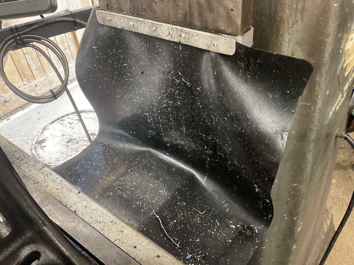

              Way cover fitted over the last couple of days.
              Beaver 10
              Beaver 13
              beaver 11

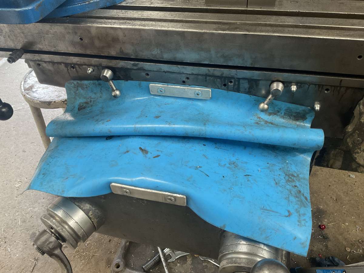

              #857848
              Andrew Skinner
                @andrewskinner94774
                They look nice. I used a couple of cheap silicone baking mats.
                #857889
                Lex Davis
                  @lexdavis38817
                  Can you post some pictures of them fitted on the machine?
                  #857994
                  Andrew Skinner
                    @andrewskinner94774
                    Nothing special. The bracket for the black cover grips the machine casting so it can be slid up and down.
                    I’d have preferred both to be black but these were available in the wife’s baking drawer. Just ordered some more in random colours and she doesn’t seem to have noticed.

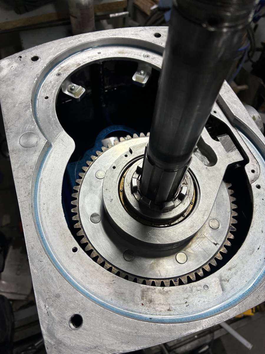

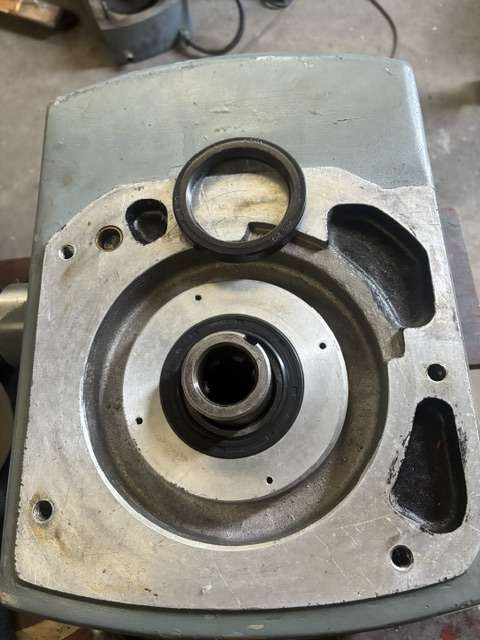

                        I have finally got around to replacing the oil v=seal in the Head Top Section, hopefully this will stop the oil leaking down into the spindle and being sprayed out everywhere when in use.
                        Beaver 14

                          While the top section of the head was in pieces I spent a lot of time reducing the spindle backlash from “quite a bit” down to just 1.5 degrees using a combination of bearings shims, spacer surface grinding and fitting oversized keys as required. The 1.5 degrees that is remaining is from the clearance between the spindle splines and the drive sleeve.
                          #861930

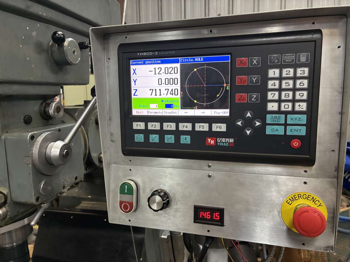

                            Lex Davis
                              @lexdavis38817

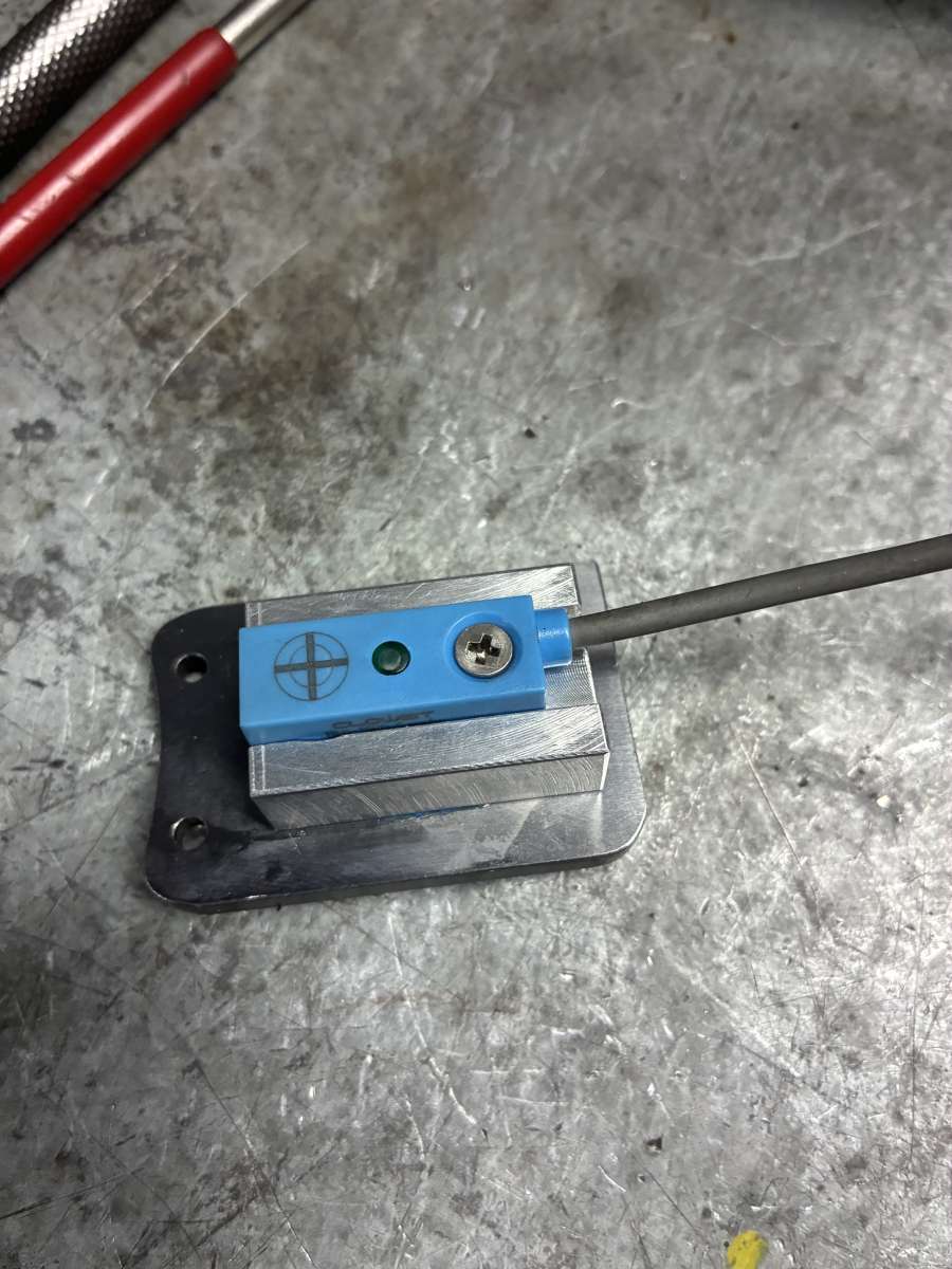

                              I finally got around to fitting a digital tachometer to the Beaver spindle, I knew this was going to take a fair bit of work but I had the head in pieces so I went ahead with it not really knowing if it was going to work. The first attempt involved an Inductive sensor reading directly off the teeth of the 63 tooth gear but that was not successful so I then tried a Hall sensor and 8 magnets on the face of the gear, this works absolutely perfectly.
                              Hall sensor and mounting plate.
                              Beaver 15
                              8 Magnets mounted on gear.
                              Beaver 16
                              Small Digital display (bottom of panel) showing RPM
                              Beaver 17
