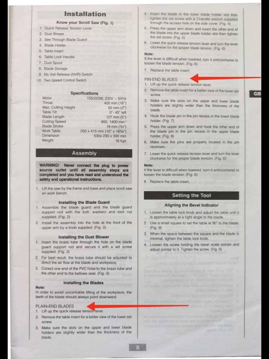

                  I would like to use pinless blades on this saw
                  … are the cheap adapters that are all-over ebay good enough?
                  … or do I need something better ?

                      Thanks for that, Dennis
                      … much appreciated.
                      I haven’t had time physically to check the saw, but I think the answer to my last question is probably RTFM
                      IMG_1896
