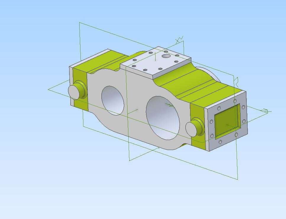

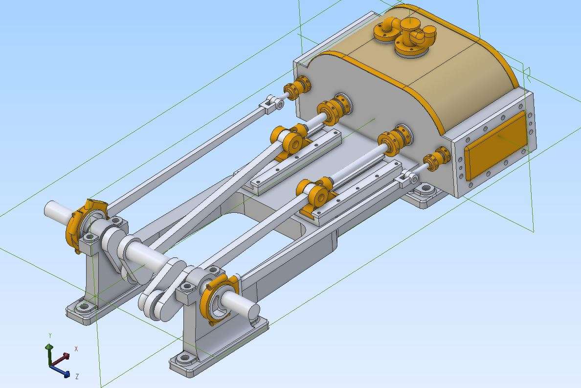

                                He is talking to me so at least one right person.
                                1/4 inch is no problem, just work to 1″ = 24mm.
                                You must be getting your castings from suppliers I don’t know of as most seem to be tight on dimensions with it being hard to get the imperial sizes out of the undersize castings, another reason for the 1″:24mm
                                Interested to see your Compound, I have drawn up a compound cylinder for the score that would only use the sole plate casting and maybe a flywheel from a No7 but not sure if I will make it as I have a more interesting compound on the ‘puter
                                compound score
