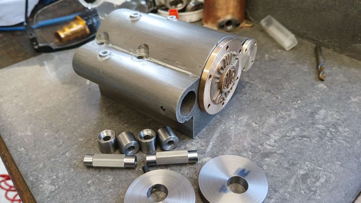

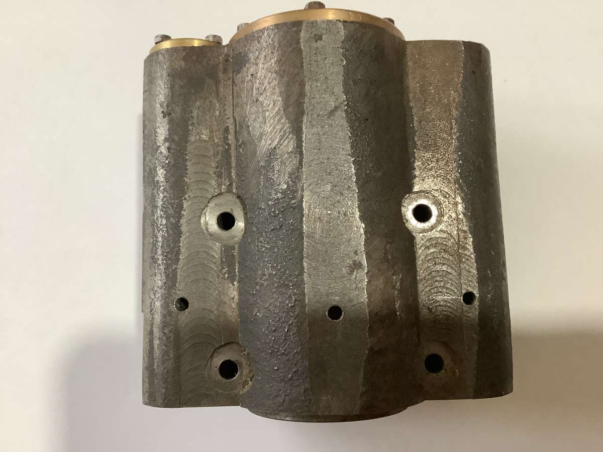

      I think most people would put up with a few minor cosmetic defects provided the part was usable and only needed a reasonable amount of clean up not completely machining all over. The main issues that are not wanted are unmachinable hard castings, excessive mould shift particularly on smaller castings, undersize castings and blow holes where they are not sorted with a bit of filler such as flywheel rims and cylinder bores.
      I think what got me into building from scratch was having to create parts for engines where the castings were pants, that group of small ones was from quite early in my building journey but I actually enjoyed the research as to what the parts should look like, designing them at a scale to suit the engine and then making them.
      I’m sure some engines get started and then put under the bench when a builder looses heart due to problems. This engine I’m working on at the moment is 2nd or 3rd hand. Originally I was asked to tidy up the cylinder casting and machine the flywheels as the owner could not fit them on their lathe. You can see in the past someone gas tried to get a few flat surfaces so it could be held in the 4-jaw for boring. There is some quite bad shrinkage particularly on teh top right.
      IMG_4737
      Some might be happy to leave it with the wonky cast surface which was 2.5mm low in places but thats not for me so it was machined all over
      20260621_093613
      The bore still has more pock marks than the earlier mentioned spotty teens, the long 3/16″ for the valve steams have wanderd and the pockets for the valve seats are not concentric to those holes, taper, wrong depth and wrong diameter no matter what depth you measure them at. The 4 holes with counterbores are all off too.
      Depending on what that casting might have cost if it is going to need so much work externally then there is a good argument for starting with a solid block. Not only can the exterior be made to look half decent you won’t have voids to spoil the bore of deflect the drill when doing the long deep holes. It will also be cheaper based on todays costs for solid and what I would likely pay for a casting and that does not include pattern work.
      You will be pleased to know I have worked my magic on it and did a temporary lash up to check there was life in it.

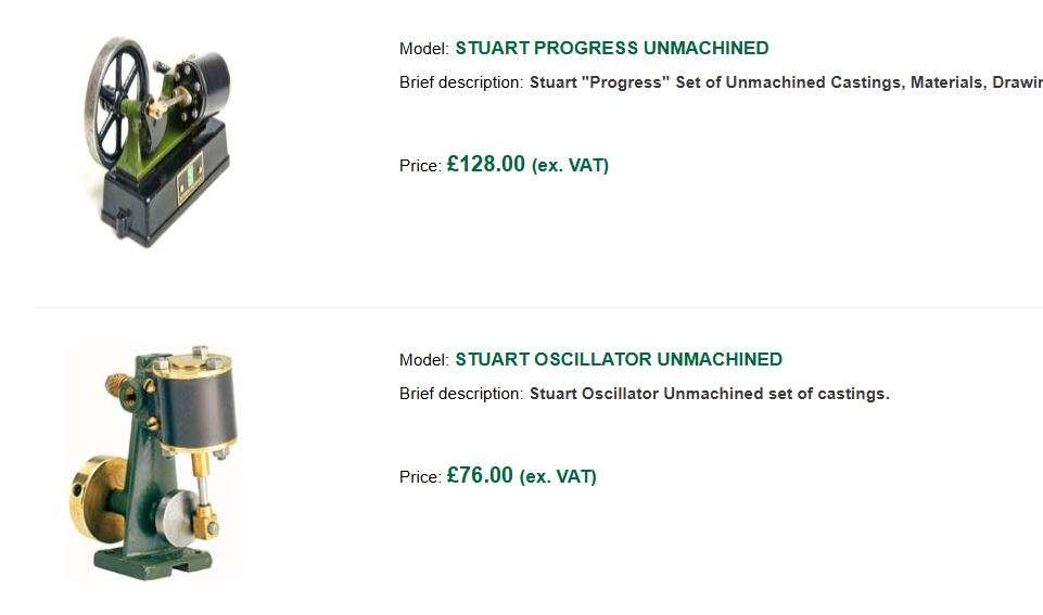

              #857617
                On paulmichael1084 Said:
                @ja quality is definitley more important than cost. 100%.
                I’m not interested in competing in a race to the bottom.
                I do still feel there is a maximum price point someone would spend on a first casting kit, yes there are a few who may pay a premium but you still need to get them to buy your engine over a similar offering from an established supplier
                You mentioned my engine with the horizontal flywheel. I would put this somewhere between a Stuart single cylinder oscillator and the Progress oscillator if looking a similar kits.
                competition
                So a reasonable retail price might be £120, the only thing you don’t get with the stuarts is a tin of  paint, otherwise they are quite inclusive. Allowing for a reasonable markup that will put your costs per kit at £60 and give you a similar gross profit.
                Out of that will come design costs, making prototypes to prove the castings and design, Web site and web shopping. Someone to make up the kits and cut all the barstock, storage of same, someone to process orders and get them in the post, advertising and promotion which could be giving a set for review.
                As the castings are going to make up the largest part of your costs it would be worth getting some CAD designs finalised for the patterns, you can then send the images and weight of the castings to a few foundries and see what it is likely to cost for say 5, 10, 50 & 100. No doubt using match boards would get the casting cost down but you would have to pay someone with casting knowledge to do that as it includes gates & runners not just the basic pattern for the parts.
                If the sums add up then you can start pricing the materials, etc and then looking into the overheads to see what you may end up with for your efforts.
                You would also need to decide what level of beginner you are aiming at. One who has just got a lathe and wants to start off with a kit. Or more likely someone who has had a lathe and possibly mill for a while, built a couple of simple barstock engines and a few tools and is now looking to try a casting kit, they are likely to need a less inclusive kit than a raw beginner and may not want to pay for things they have already aquired along the way.

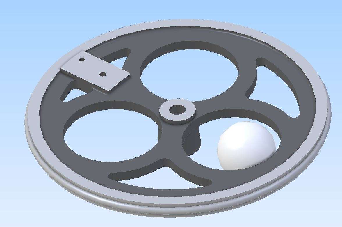

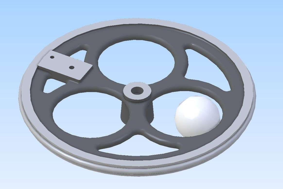

                              #858096
                                I have considered laser cut for the flywheel but worry that it won’t give the effect of cast spokes without much fettling or maching. Thoughts anyone?
                                Straight from the laser cutters it won’t give the effect of a casting and will look like someone has just milled it out of a piece of plate. It will help a beginner who can’t machine the triangular cutouts due to no rotary table but they could just drill 3 large and two small holes which many are happy to do with other barstock designs but they look just that -something made from barstock.
                                laser flywheel
                                With the aid of a rotary table and a round over bit a builder could get it looking a bit less angular. A lot of filing would also give a similar look.
                                rounded flywheel
                                But if a builder is going to do the rounding then they may as well do the holes as well. Might even be easier to start with a square plate so you could have some fixings in the corners to hold the metal to the rotary table . Also easier to supply a piece of square material.
                                At the end of the day it will come down to what you want to supply and to whom. Is it a beginners first casting kit that is different to the traditional subject matter and a step up from bearstock designs. Or is it going to be just a barstock and hardware kit where you ar ejust saving them the job of sourcing items from various suppliers? The latter can be found on ebay for things like the Elmers designs or the likes of Noggin End who do a few materials kits to go with published designs
