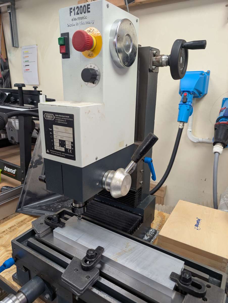

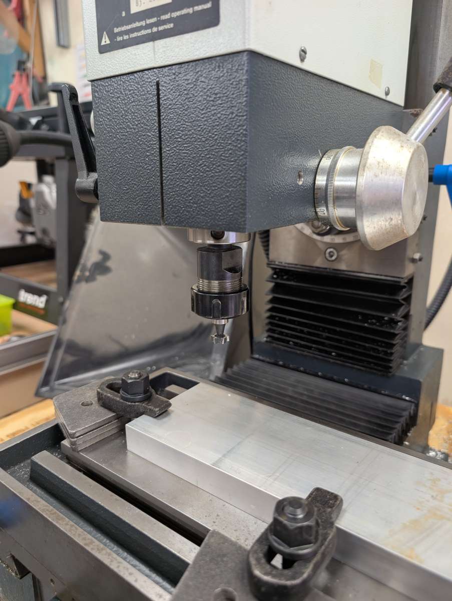

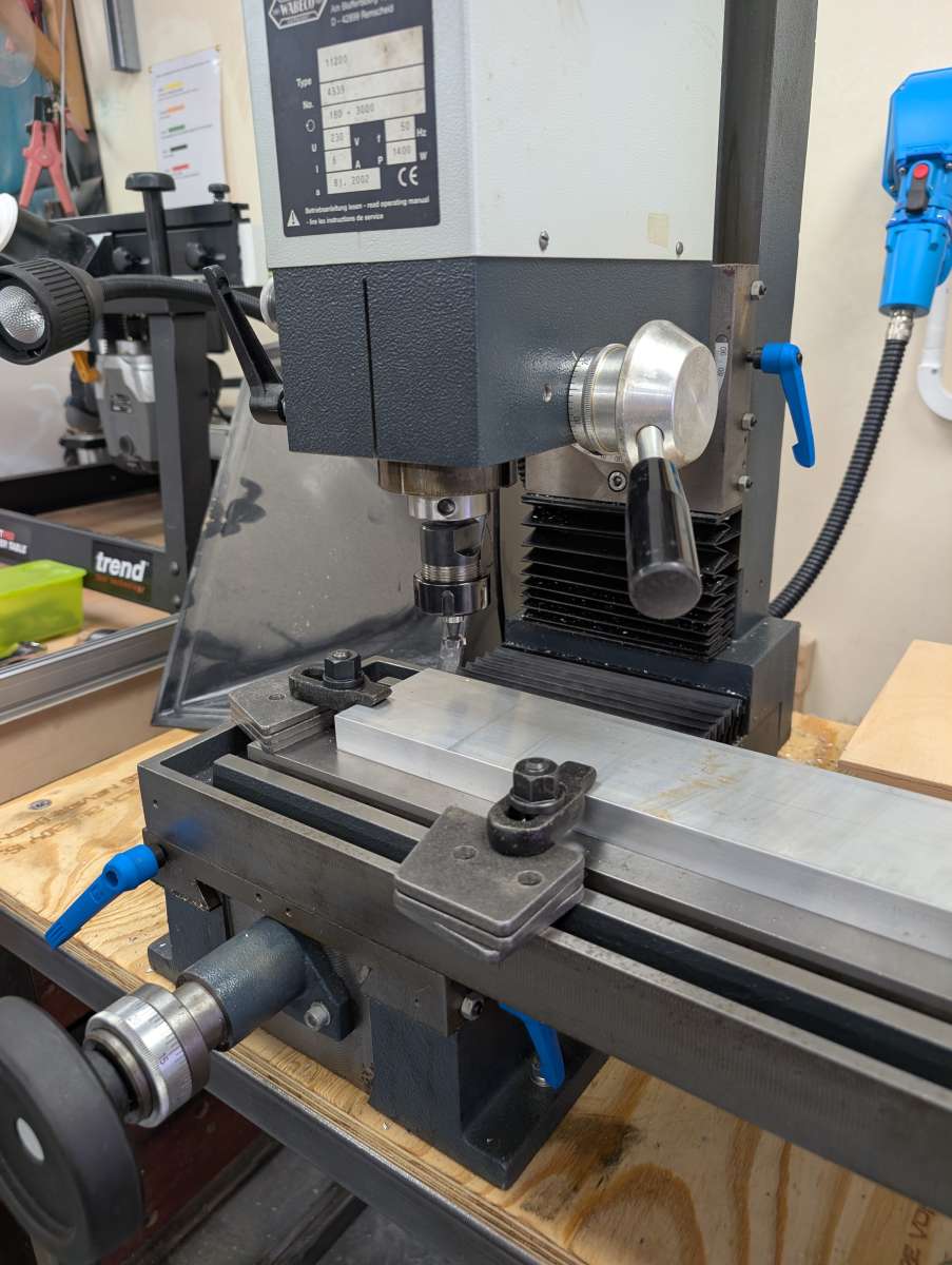

      I have recently aquired a Wabeaco F1200 mini mill, which is rapidly becoming my new obsession. Yesterday I encountered a scenario where I wanted to mill a low profile billet directly on the bed, but the head would not go low enough. The only way I could see to do it would be to extend the….. quill? or is it the spindle? Anyway the spinny bit thay holds the tool, to extend that down as if I were drilling, then lock it down and then mill by moving the table in the traditional manner.
      However I have never seen this done, and wasn’t sure if it was a REALLY bad idea or not. I read the manual several times, but no mention is made of this style setup\technique.
      I’ve attached some pics and I would very much appreciate comments.
      To those who want to know how this story ends I lifted the billet up on paralells to lift it upPXL_20260724_113313701PXL_20260724_113248237PXL_20260724_113322726

        Quill. Perfectly fine to do what you did. I tend to work by setting the work in a vice or clamping to the table then bring the quill down to just touch the surface and lock it. Then set the Z dro to zero and use the Z feedscrew to put on the cut. Best to minimise the amount of quill feed for maximum rigidity.

          I would lift the plate to be machined on to, let us say, 1″ high steel blocks. just as you have done. The clamping pieces look like Myford parts, just like what I would use. I would make sure that the clamping end was lower the the supported end (your fine photos do not make this clear). Obviously lock all the slides you are not using prior to machining. Machining a “T” slot is a brutal introduction to milling. It took me years to pluck up the courage to cut one in steel. Only a visit to a Myford’s open day convinced me that I could and I then did so without any difficulty.

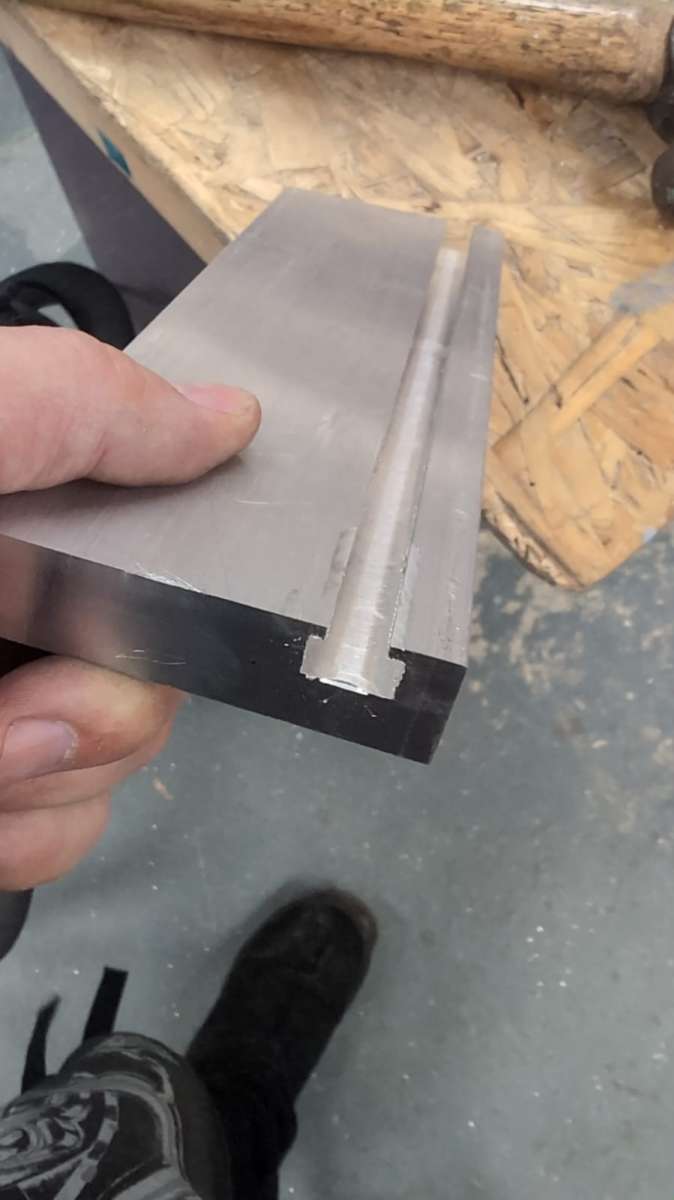

            1. @ja cutting a slot in steel would have been preferable. I didn’t have a proper Ali cutter  so used one for steel which kept getting fouled up!
              Anyway got thereIMG-20260724-WA0009 eventually and it did the job

              No despair at all, if your not sure it would be foolish to not ask. Depending on the tool diameter, depth of cut and feed, it may not be a real issue. As a general practice, it would still be better to have the milling heads spindle retracted and locked while making your Z axis elevation changes by lowering the whole head for a few reasons. And cutting tee slots would in my opinion be definitely one where I’d do so. You already have a fair amount of collet chuck and tool length below the spindle bearings. And secondly, doing it that way moves the head down on the column which also helps with increased rigidity. The trade off I suppose is the head obstructs seeing the cut a bit. For parts like your doing, the common 1″,2″,3″ or 25, 50, 75 mm blocks are a handy and reasonably priced accessory for raising any part for clearance etc.
              Unless there’s good reason for using the spindles Z axis such as a protruding feature on the part or caused by the part clamping. I keep my spindle retracted and locked and make any Z axis moves using my BP clones knee. Drilling, tapping, boring, reaming are about the only time I make use of the spindles Z axis movement. You also did a good job of moving the tee slot bolts as close to the part as possible. 👍

                Many years ago I was told by an experienced machinist that the quill should be firmly locked in place for milling operations so that’s what I’ve always done on my Warco VMC. Only my personal opinion but I think the OP did the right thing by raising the workpiece.

                  Alway preferable to have the quill retracted where ever possible as it is a more rigid setup. Plus if the tram and parallelism between head and quill are not what they should be you can end up with things not being quite where they should . I won’t say I don’t do it but generally only for light cuts not anything heavy like a tee slot.
                  You also look to be using a Woodruff cutter to form a tee slot which is not ideal as the narrow shank is not straight and can rub. It also limits the depth of the tee slot that can be cut and results in what you have there with very little material at the top of the slot, which will easily distort under the typical loads put on a tee nut.
                  Also usual practice is to run a straight sided cutter through first that is a bit deeper then the bottom of the tee which helps with clearance of swarf and less for the tool to rub against.

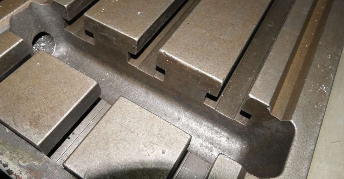

                    Sorry Jason but I disagree with your last paragraph, the usual practice is to cut a slot a few thou less than the finished depth and when the T slot cutter is used it cleans the bottom of the slot up. If you look at comm T slots they have no witness mark at the bottom of the slot.

                      On bernard towers Said:
                      ……If you look at comm T slots they have no witness mark at the bottom of the slot.
                      Here is a picture of the T-slots on my Bridgeport vertical mill:
                      T-Slots
                      Clearly as per JasonB; my Adock & Shipley horizontal mill is the same. In contrast my commercial, but not industrial, CNC mill does not have the central relief.
                      I also vote for not milling with the quill extended. I use the quill for drilling, reaming, tapping (hand and power) and boring. At all other times the quill is locked.

                          With the less than rigid hobby machines anything that will reduce the loading helps so not having the cutter clearing up the bottom is one of those. You can always go back and take a second slightly deeper pass if you want a smooth bottom.
                          As the OP was cutting aluminium the deeper central pass also means that if you run a stud through the tee nut and into the table it does not chew up the surface a loose nut slides on so easier to place your nuts.

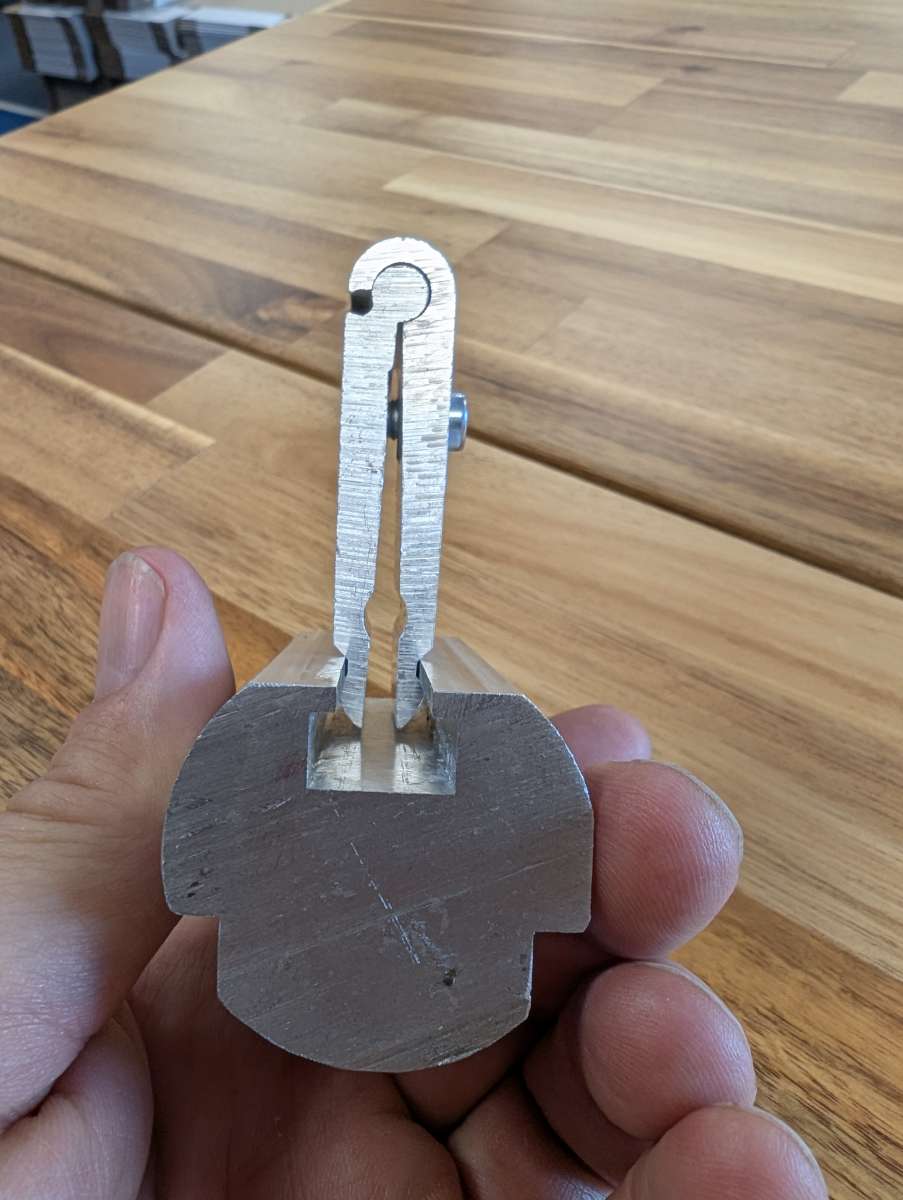

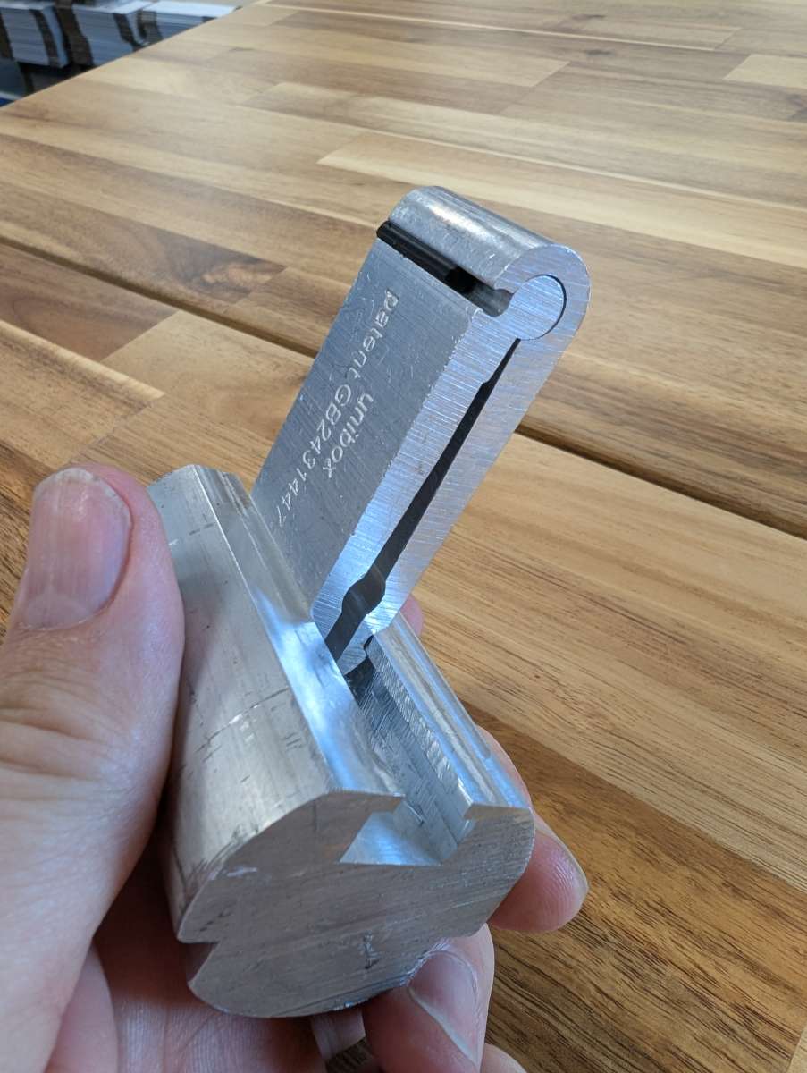

                                The slot I cut is actualy a test peice to test a proposed ali extrusion and clamp method, pic of a trail run attached. It is indeed a woodruff cutter as that was recomended. What is the alternative?
                                I did mill a vertical slot deeper than my first pass with the woodruff, then cleaned it up with a second pass. The depth to the too of the slot is 2.5mm from the top of the peice because that is how the potential extrusion is designed.PXL_20260723_161651180PXL_20260723_161647205

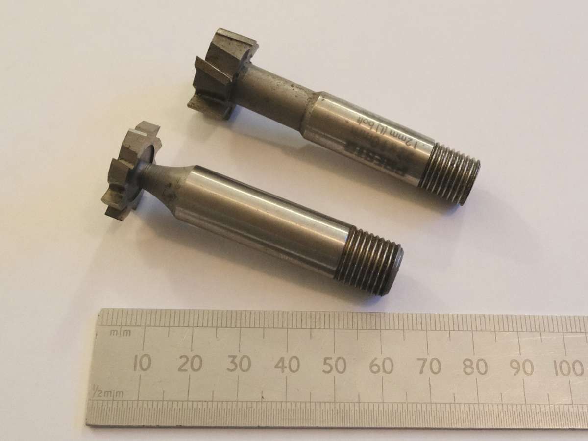

                                  I tee slot cutter is probably a better option. As I said earlier the reduced diameter part above the cutter is parallel and often more substantial than that of a similar size woodruff cutter, making for a more rigid cutter. There are no doubt some subtle differences in the geometry of the teeth too with a tee slot cutter cuttng on the top and bottom not just the side like a woodruff..

                                    Woodruff and T-slot cutters:
                                    Cutters
                                    Woodruff cutter at the bottom, T-slot cutter on the top. The Woodruff cutter shank needs to clear a round shaft, hence the curved relief on the shank. A T-slot cutter only needs a small amount of parallel clearance so the relief on the shaft only needs to be small and parallel. The T-slot cutter will be much more rigid. Note that the T-slot cutter is much wider than the Woodruff cutter. Woodruff key widths are on a par with square and tapered keys and tend to be narrower than the depth of a T-slot.
                                    I chose the metric side of the rule in case anyone had an attack of the vapours seeing imperial measurements.

                                      Working with minimal quill extension is best practice and will become second nature with practice.
                                      However in general it’s not a good idea to run things will adjustable movement and locks butted up against the mechanical end stops. It’s possible for things to slide back under the influence of forces and jam up against the end stops. Particularly worrisome if the axis in question doesn’t have proper stops. Just coming up to the end of travel with enough solidity to notice on the hand control. Unsticking that sort of issue can be fraught.
                                      Leaving a touch of quill movement, 1/2 inch or 10 mm will be fine, so position is held only by the locks has no serious effect on rigidity and gives you a chance to spot trouble if things do slide before anything serious happens.
                                      If things do slide against the locks you are either overloading or there are mechanical issues with the lock.
