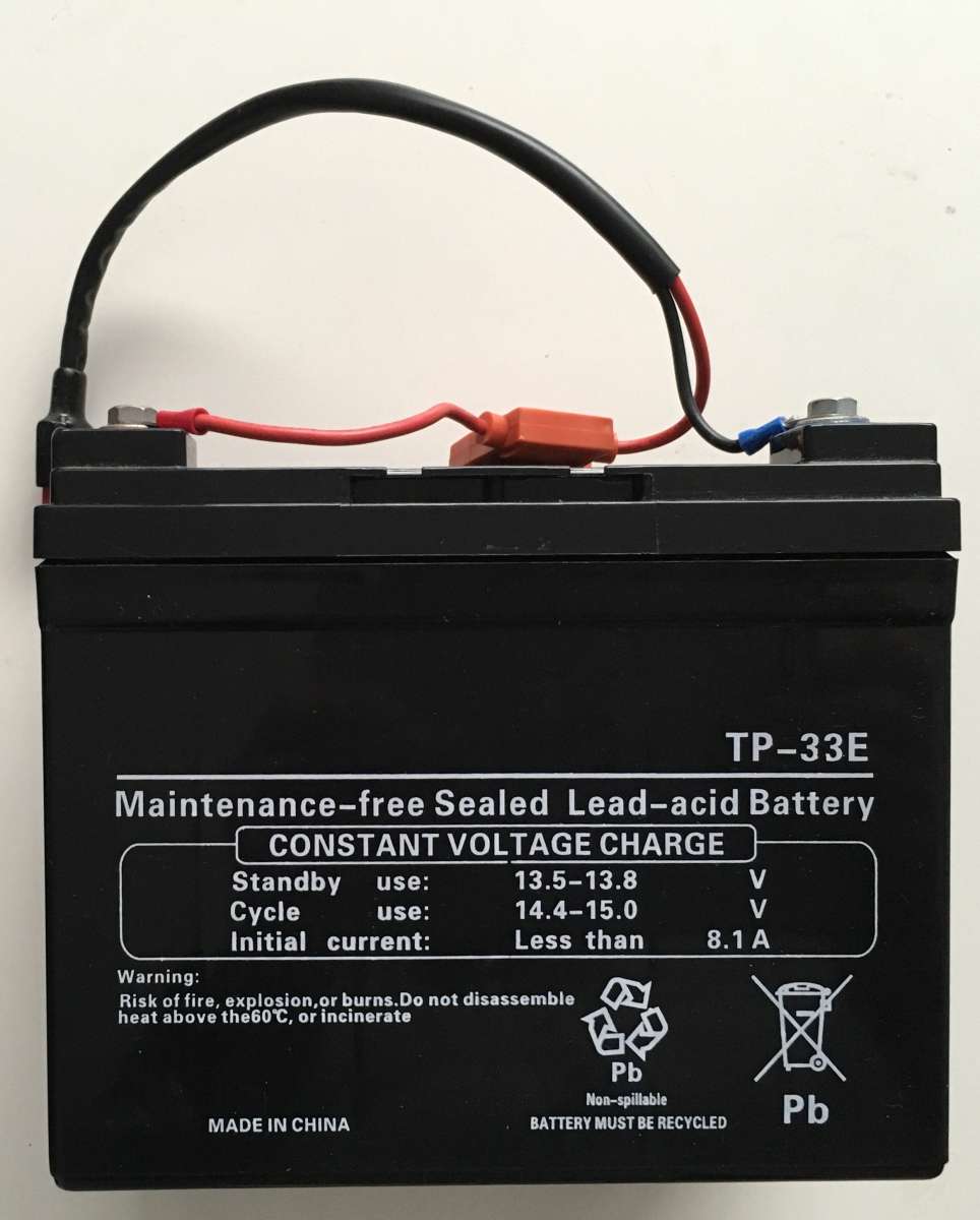

      I’ve had this for several years now … purchased second-hand, together with an ‘intelligent’ trickle charger.
      IMG_0388
      It’s nominally a Golf-Cart battery, but has served me as a general power supply for testing stuff.
      Quite suddenly, it is now failing to charge above 13.9v and that falls to about 12.4v if left disconnected overnight.
      Am I correct in assuming that I now have a useful paperweight, not a useful battery ?

        No, it’s just not as good as it used to be

          IIRC I’ve twice seen parsimonious friends try to revive / restore this kind of sealed lead-acid battery (i.e. “swill out deposits surmised to be shorting the bottom of the plates in one cell, and replace the acid”) – neither were successful.
          The internal shape of the casing usually prevents satisfactory draining of contaminated electrolyte, and (if IIRC) the plates in these batteries are very fine and once eroded are never quite the same again/likely to start disintegrating if exposed.

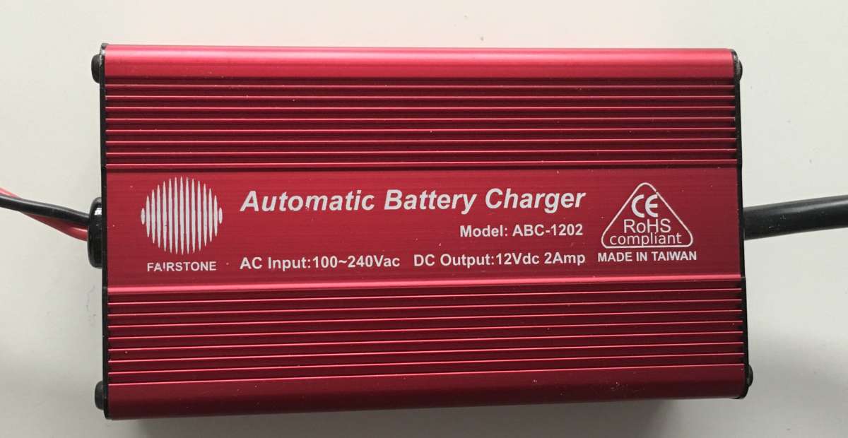

            In practical terms though, the real problem is that the dedicated charger keeps trying [and therefore gets hot] instead of settling-down to ‘trickle mode”
            IMG_1524
            Edit: The stated DC Output voltage of the charger is obviously “nominal” … else it wouldn’t actually charge a so-called 12v Battery !

              These batteries can range from the very good to not very ! Not too expensive and very handy, as Michael has said. I have one that came off a childs toy car, neglected for years in the garden, then recharged and works fine – and it’s 20 years old ! I have others that were bought new, good ones (yuarsa ) and failed in 4 years.
              Pot luck ?  Just buy another one. Noel.

                          It’s not even good a as a paper weight. The acid fumes will damage the paper. They will often continue to deteriorate and can split and leak even more.
                          Its not clear exactly clear what type it is but sealed lead acids generally use a gelled electrolyte. They are not recoverable.
                          Take it to your local scrap merchant and get some cash for it.

                            Thanks, Robert … That puts a whole new layer of ambiguity on the word “Sealed”
                            …i shall heed your advice !
                            Now an open question … especially in view of Noel’s observations: Can anyone recommend [or alternatively warn-against] any particular make of 12v battery with roughly this specification ?

                                    My ‘Automatic’ charger isn’t particularly clever … it just does one thing rather well
                                    With the LED showing Amber, it is recharging the battery … when the LED turns Green it has reverted to trickle-charging.
