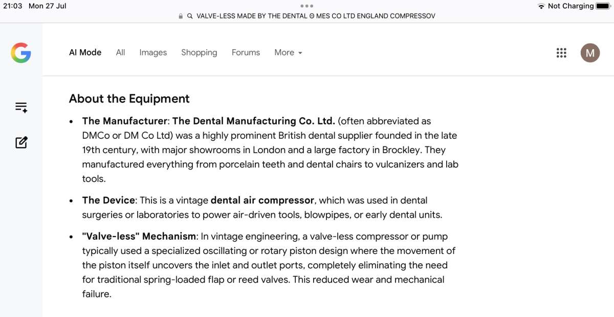

        Google’s AI overview [in lens] does a pretty good job of analysing the image, and offers to help further.

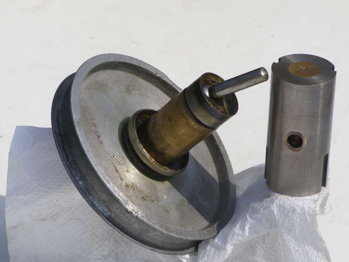

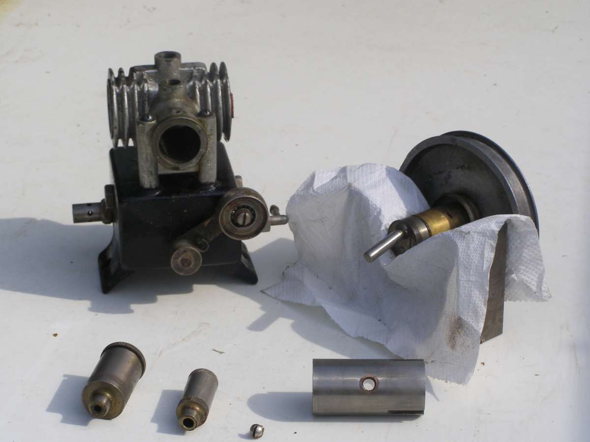

              I found the “oil screw” does lock the journal in place. The better lighting showed the thread extending down into the brass.
              Tried to remove the pulley from the shaft, but started to damage it. Eventually, a large mallet and soft drift pushed the pulley, crankshaft and journal out as one assembly, allowing the piston to slide out of the end.
              This revealed the four ports in the double-ended cylinder’s wall are rectangular so must have been cast in, despite being only about 5/16″ square, if that.
              So that’s how it works…  I realised.
              I’m going to pose it as a puzzle.
              How do you think the shaft drives the piston?
              It’s beautifully simple but not intuitive. I can see what happens but cannot really conceive the geometry, and have not encounted the mechanism elsewhere, physically or in text-books:
              1) The piston and crankshaft axes are mutually perpendicular but co-planar, their housing being a Tee-piece.
              2) The double-ended piston both reciprocates and oscillates about its axis by about 20-30º per revolution.
              3) The piston is a plain cast-iron bar with two pairs of keyway-like channels as ports.
              4) It has a plain, fixed, bronze bearing-bush lining a central hole, across its diameter. There are no slots, cam abutments, etc. This bearing cannot revolve or otherwise move within the piston.
              5) The crankpin is a plain pin projecting forwards, overhung mode, from the end face of the shaft, 1/4″ from the axis to give the 1/2″ stroke. It is a close sliding fit in the piston bush, and its length is nearly the piston diameter .
              What is the critical detail I have omitted….?

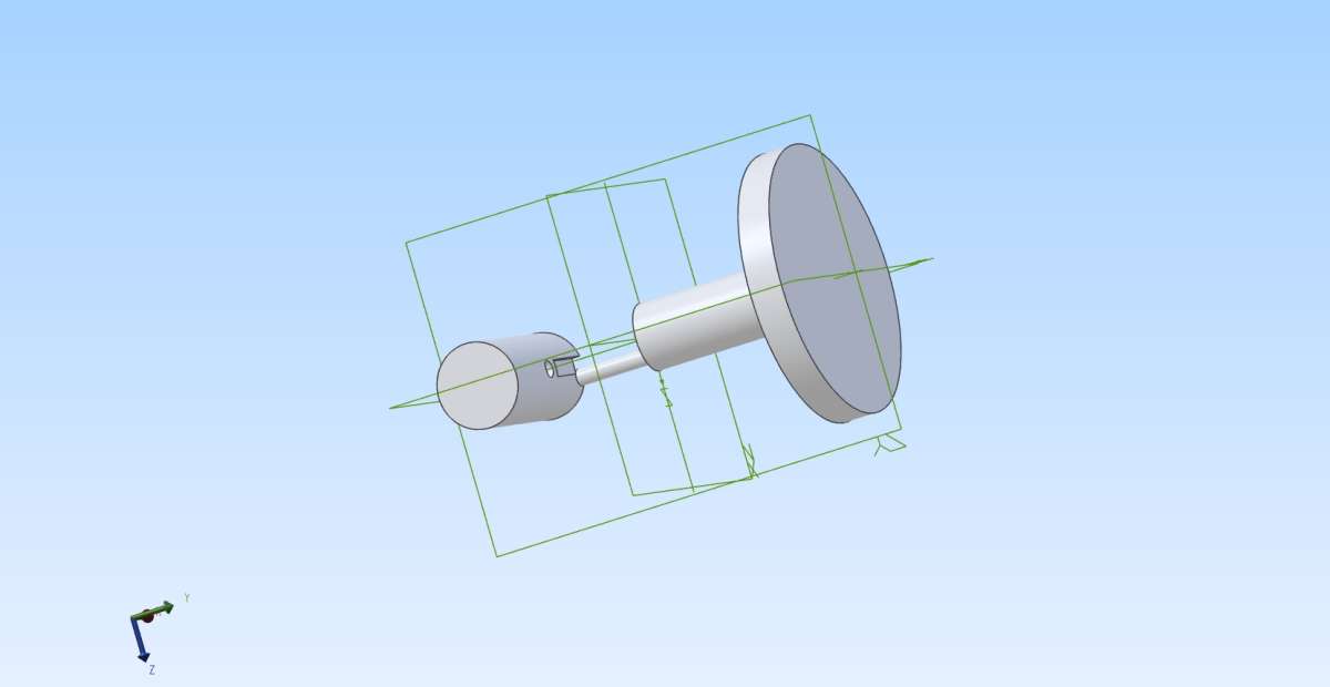

              However, I did try to sketch (artistic meaning) simplified versions of the two parts in Alibre to give a better idea here. Not very well though. It was harder than I thought it would be.
              I’ve represented only one of the four air channels, and it should be either 90º or about 135º round the axis.
              Not properly to scale.
              Again with the secret omitted, although this view would not show it anyway.
              Compressor Crankshaft

                The secret is that the crank-pin is ball-jointed, a bit like a centre-finder, so can partially rotate the piston while reciprocating it. The motion also obviates any sliding parts in the drive other than small reciprocation of the pin within the piston bush. Herewith the complete machine in bits, and close-up of the crank within its journal, and piston with its central crank-pin bush and the air channels.

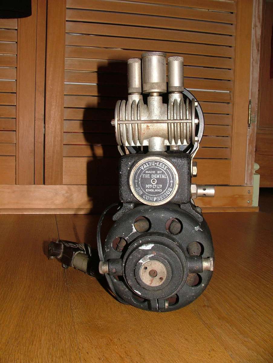

                              Looks like a match for the Valve-Less Air Compressor made by The Dental Mfg Co Ltd, apparently originally supplied with a Bakelite pulley.
                              https://www.hobby-machinist.com/threads/bakelite-pulley-disaster-ideas-wanted.10225/
                              Andrew.
                              2003_1109pet-comp0002

                                      That’s the thing!
                                      Simply a slightly different layout, mine having a single inlet rather than two.
                                      Thankyou very much Andrew!

                                      I have tried finding how to find things by Google Lens, but to no avail. Every attempt ended in wanting me to “sign in” to something I don’t have – including Google itself, let alone an “account” with it.
                                      #858116
                                      Andrew Entwistle
                                        @andrewentwistle
                                        Hi Nigel, in Google Chrome browser I just right clicked the first image you uploaded and selected the ‘Search this image with Google Lens’ option, cropping it tightly. The first result was the hobbymachinist page. Cropping to remove all but the engine from the search was the key.
