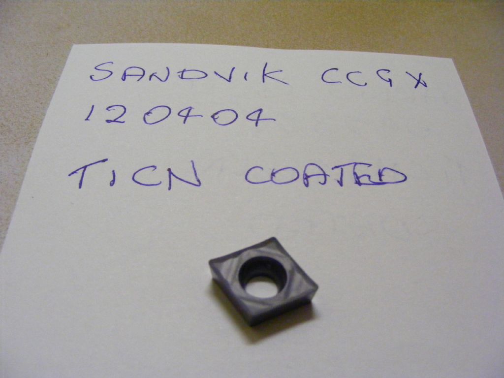

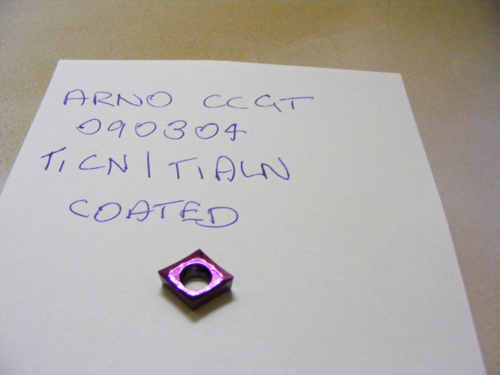

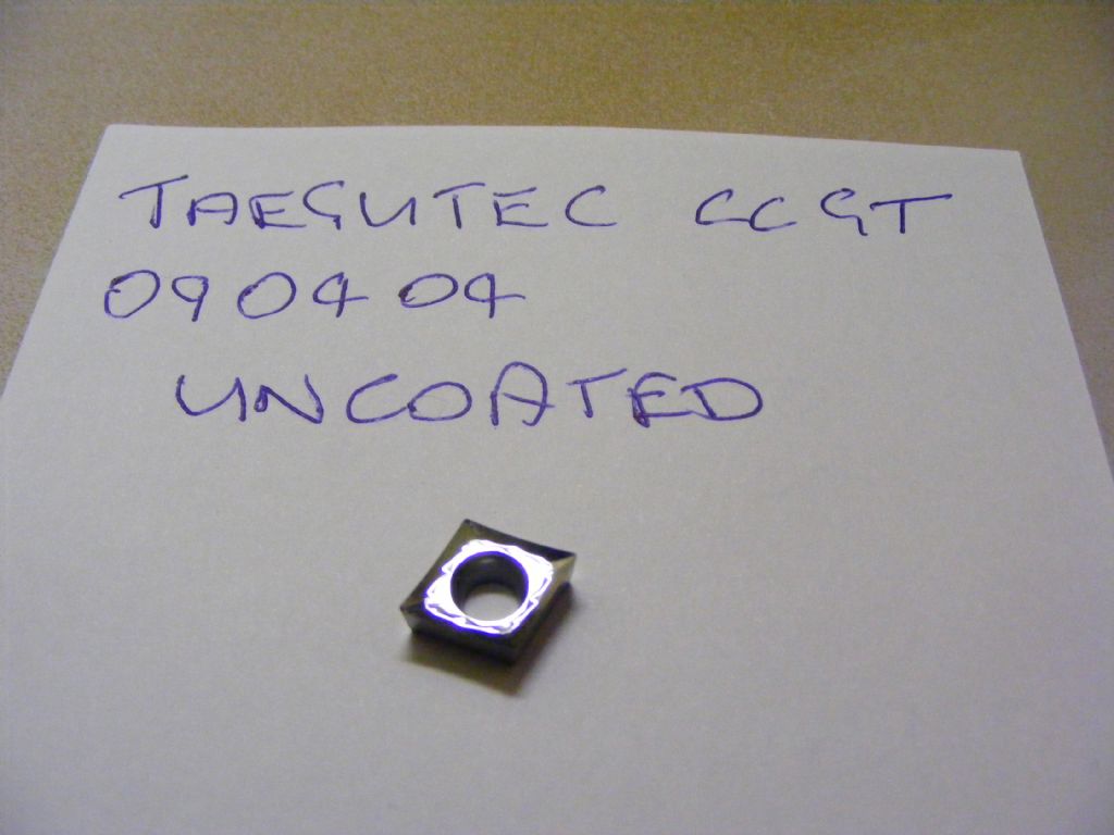

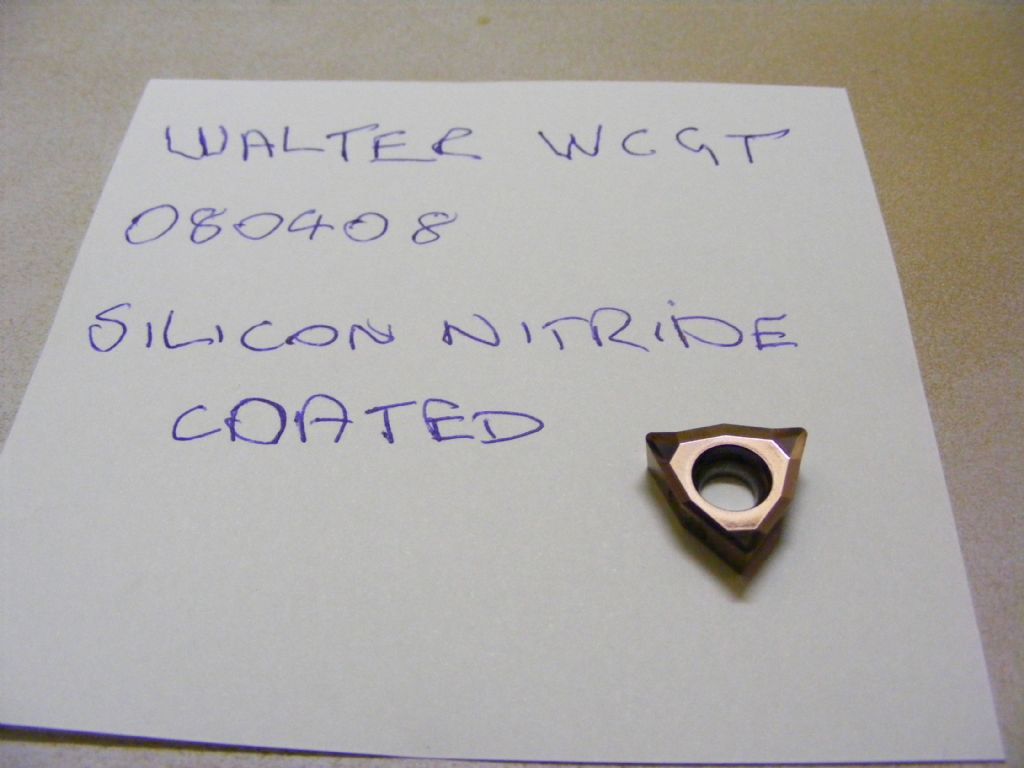

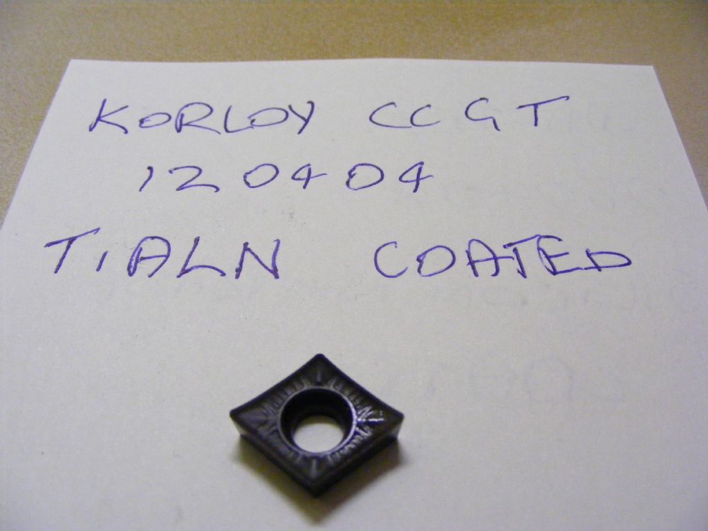

            Taegutec CCGTKorloy CCGTSandvik CCGXArno CCGTWalter WCGT
            #233680
            Raymond Anderson
              @raymondanderson34407
              Here are some pics I think a lot of folks thing that the **GT inserts are all shiny silver. These are some CCGT a WCGT and a CCGX note the various coatings.
