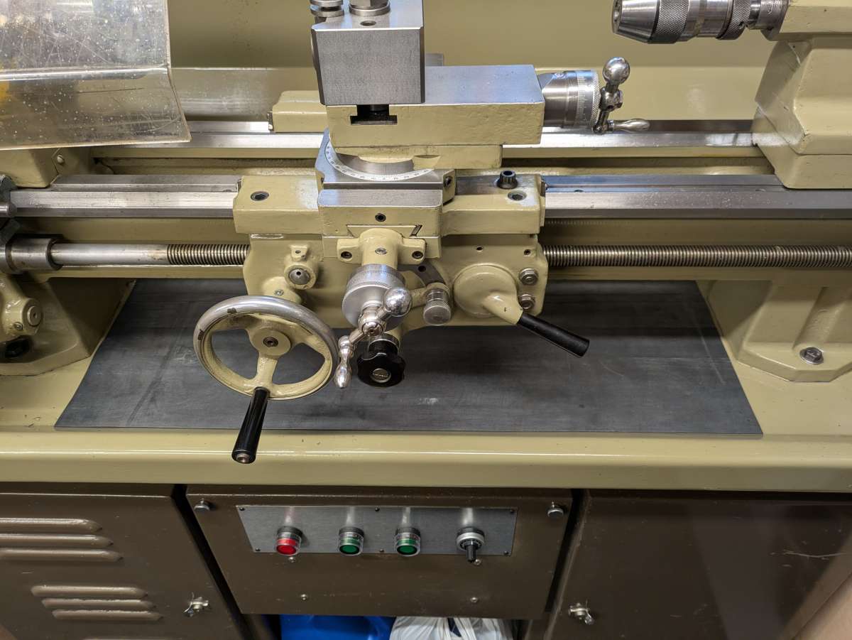

                      But anyway, here’s my “tip”. It’s one of those things that is so simple you’ll wonder why you didn’t think of it earlier! It took me 20+ years realise. 😂 It not something I see other people doing either so I’m probably not alone.
                      What is it? Well, it’s just a mat. I cut a piece of rubber (leftover from a rubber roof) to fit in the bottom of my lathes coolant tray. It protects the paint from damage caused by dropped items and also it collects a large amount of swarf! The mat can then be removed along with the swarf, folded and poured into the bin for easy cleanup. It seems so obvious now huh?
                      No doubt you’ve all been doing this for years. 🤥

                        What a good idea, I’ve always used an old baking tray discarded from the domestic department.
                        I think that’s about to change!
                        Andy

                          Plus one for Andy’s comment ! I too use a baking tray but like the rubber mat ideated it could be cut to go either side of the headstock mounting points

                            I was using a small tray too, but I found myself knocking it over and spilling the swarf everywhere quite often. So far, this is working better for me. 🙂

                              I tried this with some of that ribbed rubber flooring. It didn’t react well to oil, swelled and wrinkled (sounds like me on a bad day). Must be different rubber, I’m now on the lookout for some roofing rubber offcut.

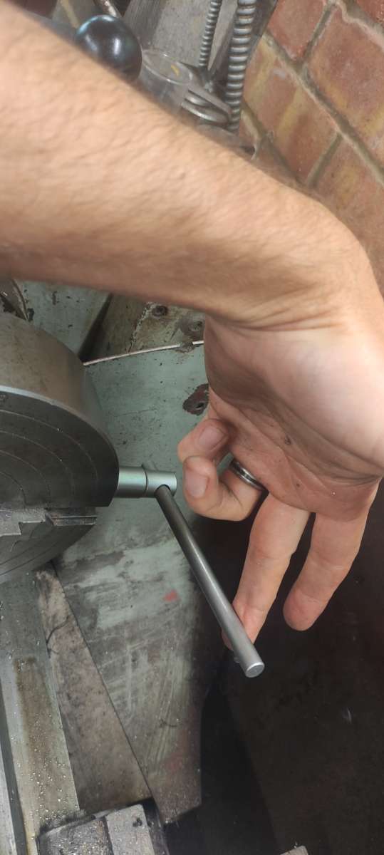

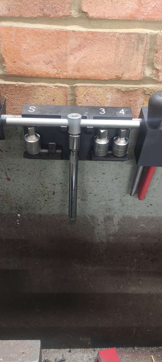

                                Got a bunch of chuck keys lying about the place? Keep picking up the wrong one or forgetting where you put it down?
                                A set of sump plug socket bits is pretty cheap and includes a wide range of metric and imperial square drives,as well as hex (and others). You can pick out the ones that match your various chucks and then buy a T-handle and extension to create an adaptable all-in-one key set. I’ve pictured mine, complete with heads for the camlock spindle plus 3-jaw & 4-jaw, on a custom backsplash hanger but it could easily be kept in a cutout tray kept on the headstock or in a drawer if you don’t have a 3D printer.
                                1784017916563
                                As well as reducing the number of things to put down somewhere, the sliding handle and swap-in shaft length can allow for adjusting jaws in positions that would otherwise be awkward or impossible:

                                      I appreciate the concern, and to be honest did expect this reply when I reviewed the photos before posting; in this case I simply went to the shop to take some photos for this top tip without turning anything on or cutting any metal and was too lazy to redo the ‘photo-shoot’ when I noticed the prominent ring in the shot.

                                            With regard to the sump plug wrenches, it would be easy to modify the next-size-up to a smaller size if an exact fit was not available.
                                            Perhaps colour coding each wrench and a dot of paint on the chuck would be useful if you had more than one of each type of chuck.
