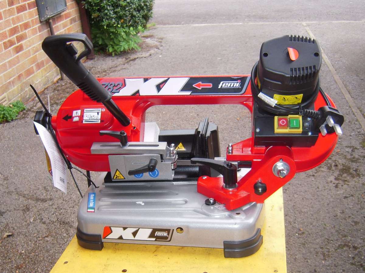

                JA
                  @ja
                  My old band saw was a flimsy, badly designed, Warco that, other than the motor, was given to the council.
                  It was replaced by something far better:
                  DSCN8648a

                      #834307
                        I’ve got a Femi the same model as JA, very happy with it and you can cut bigger than it is supposed to with a bit of jiggling about. No time needed to fettle it just plug in and play.

                                    @ja
                                    My Femi clearly states that it is made in Italy (2020) as in the photo.
                                    Before I bought it I considered a Rapido saw (they use to sit in the corner of a college workshop or tool room, running night and day, and being looked after by the labourer) but the thought of reconditioning a truly clapped out, three phase, tool frightened me.
                                    Perhaps a subject for the magazine?
                                    JA

                                      #835124
                                      Peter Simpson 3
                                        @petersimpson3
                                        Ja What are the overall dimensions of the 782 XL ? Peter
