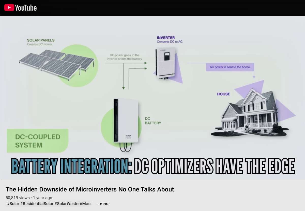

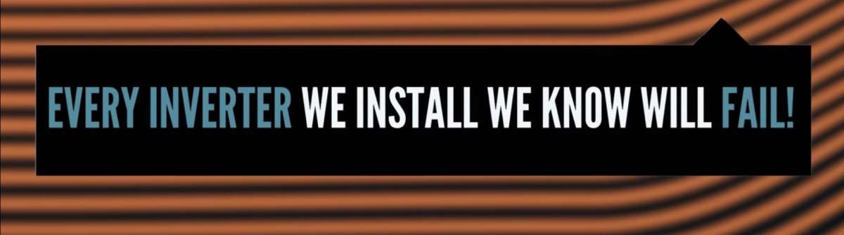

      This is an interesting video on the topic.
      https://youtu.be/oiBw6USlm8U
      IMG_9496
      IMG_9495

            You can’t trust Google AI but it’s a good starting point for further investigation. It says this about inverters. As I want modest battery storage and the ability to run from it during short power cuts it seems I’ll probably require a Hybrid Invertor?
            There are three main types of solar inverters used in residential and commercial PV systems:
            string inverters, microinverters, and hybrid inverters. These devices convert direct current (DC) electricity generated by solar panels into alternating current (AC) electricity used by homes and the grid.
            1. String Inverters (Centralized)
            These are the most common and cost-effective type, often used for unshaded, simple roofs.
            How they work: Several panels are connected in a series (“string”), and one central inverter converts the DC power for the entire array.
            Pros: Lower upfront cost, reliable technology, easier maintenance (one central unit).
            Cons: If one panel is shaded, the entire string’s output can drop to that panel’s level.
            Best for: Simple, unshaded, south-facing roofs with consistent sun.
            2. Microinverters
            These are small, individual inverters installed directly behind each panel.
            How they work: DC-to-AC conversion happens at the panel level. If one panel is shaded, it does not affect the others.
            Pros: Higher efficiency in shaded conditions, panel-level monitoring, high reliability (20–25 year lifespan).
            Cons: Higher initial cost than string inverters, harder to replace because they are on the roof.
            Best for: Complex roof layouts, partial shade, or for maximizing energy yield.
            3. Hybrid Inverters (Battery-Ready)
            These combine a solar inverter and a battery inverter into a single unit.
            How they work: They manage power flow from solar panels to the home, grid, or to a battery for storage.
            Pros: Streamlined setup, future-proof for adding batteries, can provide power during blackouts.
            Cons: Higher initial cost.
            Best for: Homeowners planning to add battery storage now or in the future.
            Alternative: Power Optimizers
            Similar to microinverters, these are placed on each panel but do not fully convert DC to AC. Instead, they “condition” the DC power, enhancing the performance of a central string inverter. They offer panel-level monitoring and improved performance in partial shade at a cost between string inverters and microinverters.
            Key Inverter Technologies
            MPPT (Maximum Power Point Tracking): A critical feature in modern inverters that ensures panels operate at their maximum efficiency, increasing energy yield by up to 30%.
            Single-Phase vs. Three-Phase: Residential homes typically use single-phase, while larger properties or commercial sites often require three-phase inverters.
            How to Choose
            Simple, unshaded roof: String inverter (most affordable).
            Shaded, complex roof: Microinverters or power optimizers (higher yield).
            Adding a battery: Hybrid inverter (most efficient).

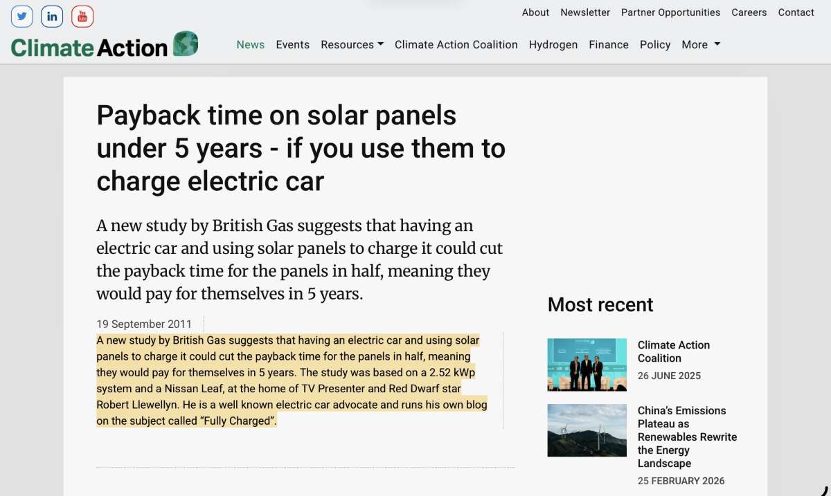

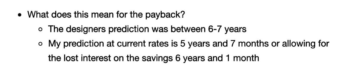

                                Just one one example. Quite surprising how the costs have come down in the last few years.
                                https://blog.lboro.ac.uk/sustainability/2026/02/03/solar-panels-are-they-worth-it/
                                IMG_9574
                                As we’ve just bought our first EV it looks like it could be even quicker for us?
                                IMG_9575

                                          From the above article.
                                          “My first experience of the likely costs was a discussion with a previous colleague who had solar panels installed over 10 years ago at a cost of around £20K.”
                                          I would have liked to seen a better explanation as to where £20k went on a colleagues installation.  Specifically when that was, 2016?.  Around 13-14 years ago I paid less than a third of that for a 4kW installation.  Was it a difficult installation?
                                          A proper breakdown of installation costs would have been helpful.  While there is no doubt that hardware prices have dropped, what about labour costs?   The price of scaffolding hire and erection hasn’t got any cheaper.
