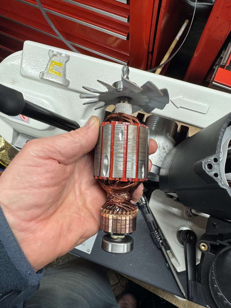

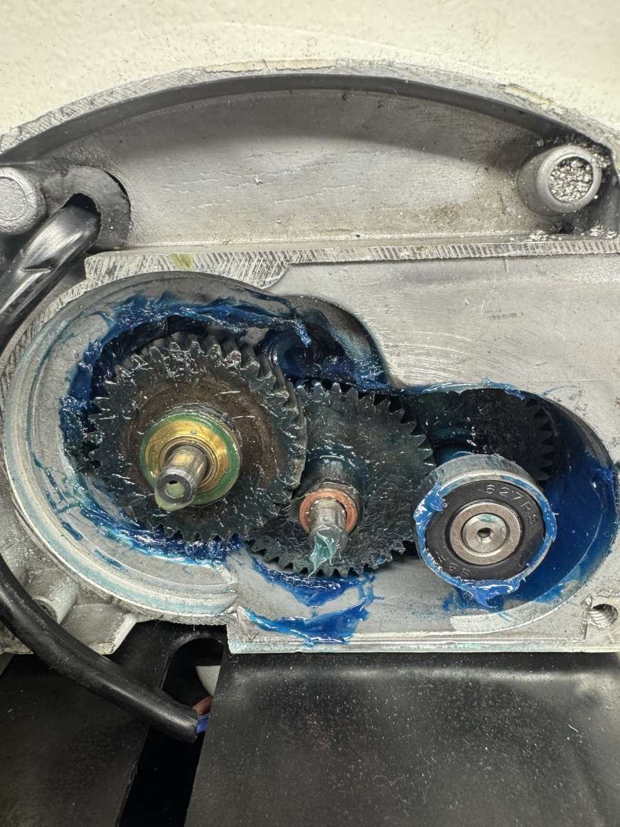

            #850772

              #850773

                I assume all the band saws we are considering have universal (commutator) motors. My quite old Femi certainly does. The main noise, therefore, most likely comes from the armature fan. This is present both for cooling the windings but also to present a rising load characteristic with increasing speed in order to limit the maximum speed on light load.
                On my Femi, a slotted end cover limits the fan airflow. With this removed, the noise is greatly increased, so it is presumably there to manage the noise level. Do the Far East saws have anything similar?

                Adam Harris
                  @adamharris13683
                  Hi Malcolm, spot on! I have removed the motor and the noise only drops by 2-3dB so the gearbox is not the culprit. It is a regular commutator motor, bearings appear smooth so I also suspect the fan as it cannot really be anything else. So I have flattened the vanes somewhat in the hope of reducing noise but have yet to get it back in between the pair of sprung carbon brushes! I am looking for some long steel shim strips gone missing and will revert. Many thanks

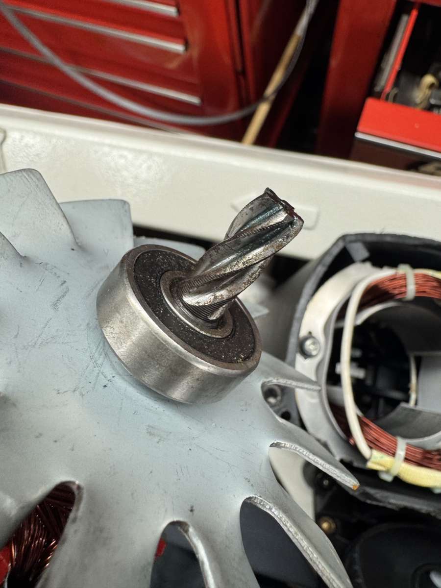

                    Adam Harris
                      @adamharris13683
                      A decent length of shim steel works well with carbon brushes. Anyway, I flattened the vanes to 50% of their angle and got a 2dB improvement, then flattened them further until hardly any angle and got a further 2dB improvement at max speed and no further improvement at min speed. Still decent airflow. So now I am at 90 dB min speed and 94dB max speed. Quite a noticeable improvement and better harmonics to my ears. If I put a sound canopy over the slotted end cover where the air intake occurs, leaving a gap of 5-10mm I do get a further 2dB reduction both at min and at max speed so I think that is worth doing as a future project . However I think the fan design is the real issue and  I will look for a better designed and smaller fan, maybe try to buy the Femi fan as a Femi spares part, or maybe the whole motor if cheap enough and can be fitted to my gearbox! I attach a photo of the innards for any who are interested. IMG_0201Very many thanks Malcolm and Jason for your contributions.

                      Adam Harris
                        @adamharris13683

                        #850789
                        Adam Harris
                          @adamharris13683
                          IMG_0202

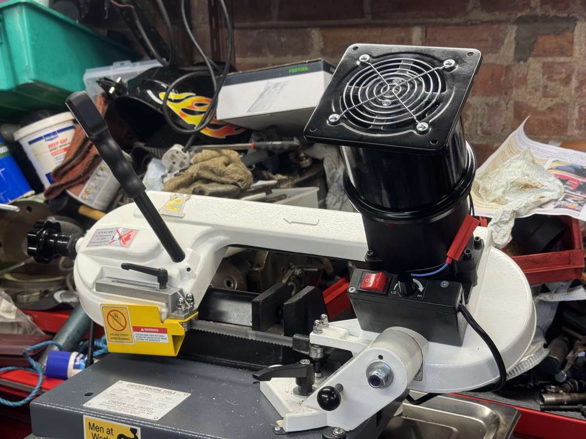

                                              Adam Harris
                                                @adamharris13683
                                                Latest progress on reducing excessive fan noise on the generic BS-85 (Chester 85M in my case)  – I have removed the fan completely and get 86dB at slow speed and 90dB at high speed which is ok I suppose but the motor does heat up fairly quickly. So now I have put a very cheap Ali Express 4″ 110v air extractor fan (advertised disingenously as an extra powerful one) over the top of the motor blowing down into the motor which makes no extra noise and produces a rather feeble airflow through the motor which is a bit better than no airflow at all.
                                                #856221
                                                Adam Harris
                                                  @adamharris13683
                                                  IMG_0576
                                                  #856222
                                                  Adam Harris
