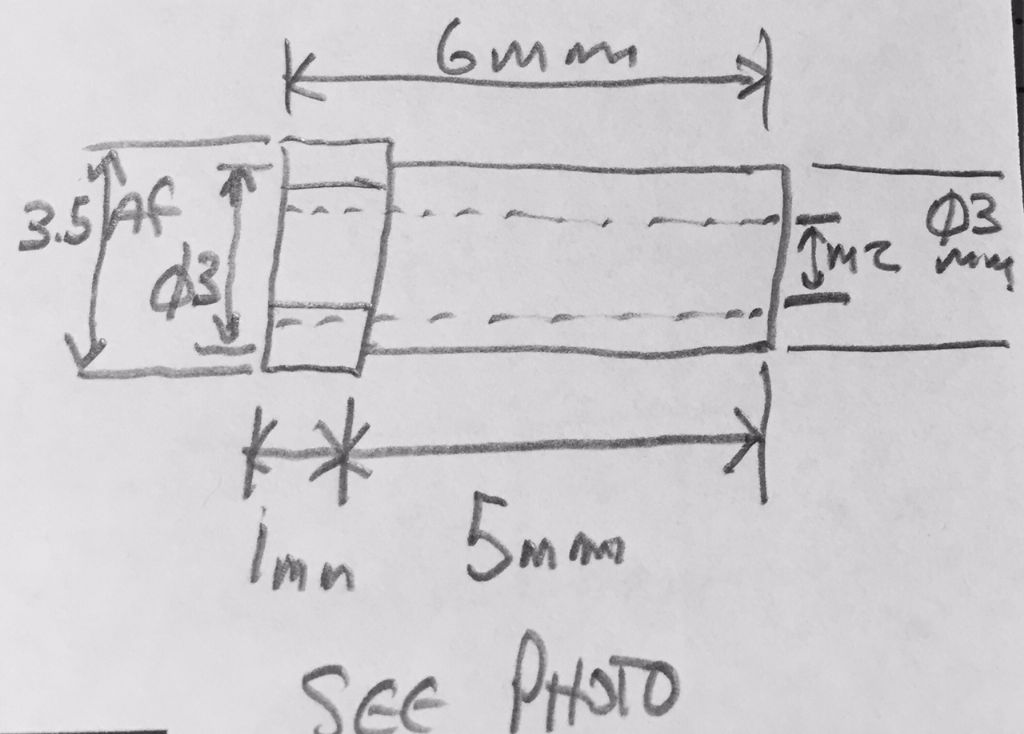

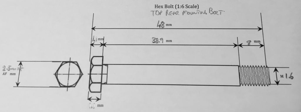

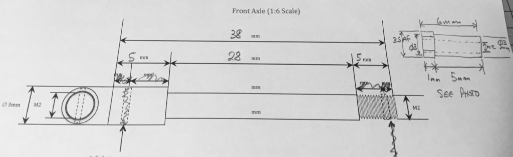

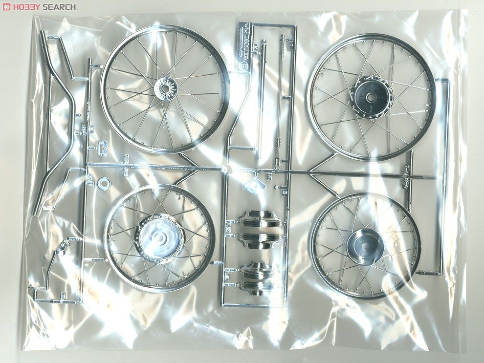

      I build 1/6 scale motorcycles which are quite detailed. I use the plastic model as a base and then add additional detail such as tiny bolts, scale wiring and other such detail. I have reached the limits of the hobby as I do it now so I would like, to take it to the next level and make my own more detailed parts. For example a plastic moulded chain – looks like – well – a plastic moulded chain. I have tracked down real roller chain with a pitch of 3.2mm so it's prefect for 1/6 scale bikes – the problem now is that I need to make my own sprockets that will be scale replicas of the real bike

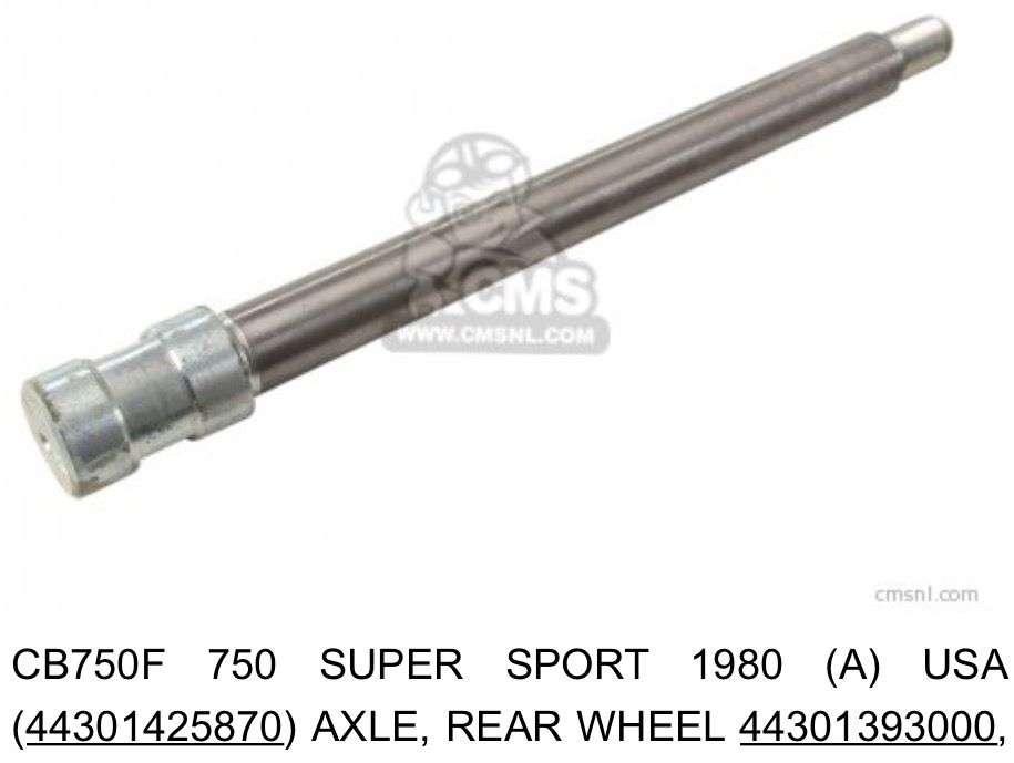

      Another challenge is engine mounting bolts and axles. In the kit they are represented by a shaft with threads on both ends and M2 nuts. However the real bold uses flanged bolts which clearly only have a nut on one end. A rear axle will have a M2.5 castle nut so I need to make these parts myself to achieve the level of detail that I am looking for
      Some of the things I would like to make
      Below are some parts I would like to make – An engine mounting bolt
      Top rear engine mount
      An axle for the front wheel plus the axle nut
      1/6 front axle drawing
      Front axle nut

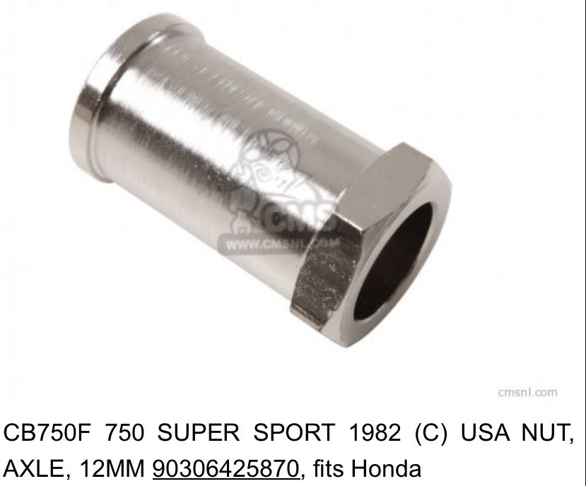

      Below are the real parts
      Full size front axle
      Front axle
      So for my hobby it's quite small for most parts. BUT…

          But some of the parts can be quite big. One of the problems are with wire rims, which in plastic are just terrible so I would like to turn my own rims and make a jig to make the spokes etc. The rims are typically 17" to 21" which translates to a rim with a diameter of roughly 86mm. Below are the rim halves from a 1/6 scale Yamaha Yz250 Motocross bike
          Therefore I need a lathe that can handle this size of turning as the minimum starting point
          Furthermore I would like to make some of the tools in the project books that I have. I might even be tempted later on to build some working engines with my son who is 10 years old at the moment. Therefore I think I am looking for a lathe that is a bit bigger than a Proxxon PD400 but not bigger than a WARCO GH1330 GEAR HEAD LATHE

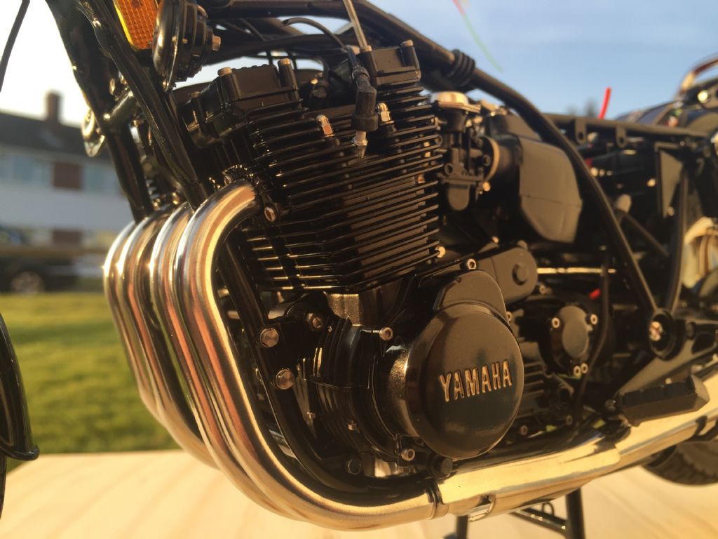

                                      To give you an idea this is what I build
                                      Yamaha XS1100
                                      The chrome that you see by the way is painted on with an airbrush

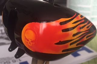

                                              Hello Clive no offence taken and you are of course quite right. I know from my own modelling experience of airbrushing . I have ten airbrushes in my cupboard and the one I use the most is the first Badger 200IL I bought nearly 37 years ago. It fits like a glove and does 90% of my airbrushing. I have the top of the range Badger double action airbrush that I have never actually used. The chrome finish is only possible with a Holbein airbrush that has a very fine needle and mists on the chrome to achieve this high shine finish. I have an Iwata airbrush that I used once and uuugh it didn't work for me but many other modellers achieve spectacular results with the same model. So I mostly use my trusyed Badger
                                              It's the skill of the operator that produces the results and the tools/Machines help
                                              Below is a model bike tank custom sprayed with my Badger 200 single action airbrush
