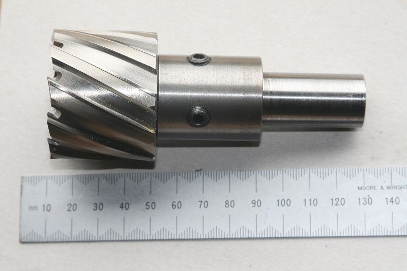

                                            #279057
                                            Spurry
                                              @spurry
                                              Rotabroach adapter 20mm
                                              Just found an old picture I had taken last year. Fits a 20mm R8 collet.
                                              Pete
