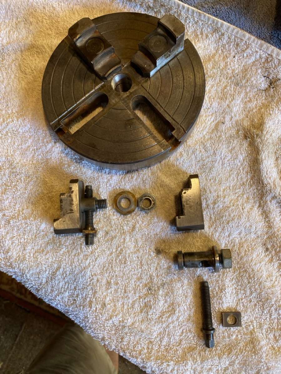

      I haven’t seen a chuck like this before and I believe it to be a ToolMakers apprentice piece as it has no markings, lacks a bit on dimensional accuracy but could still be useful.
      I picked it up for 1 euro, so hardly anything lost!

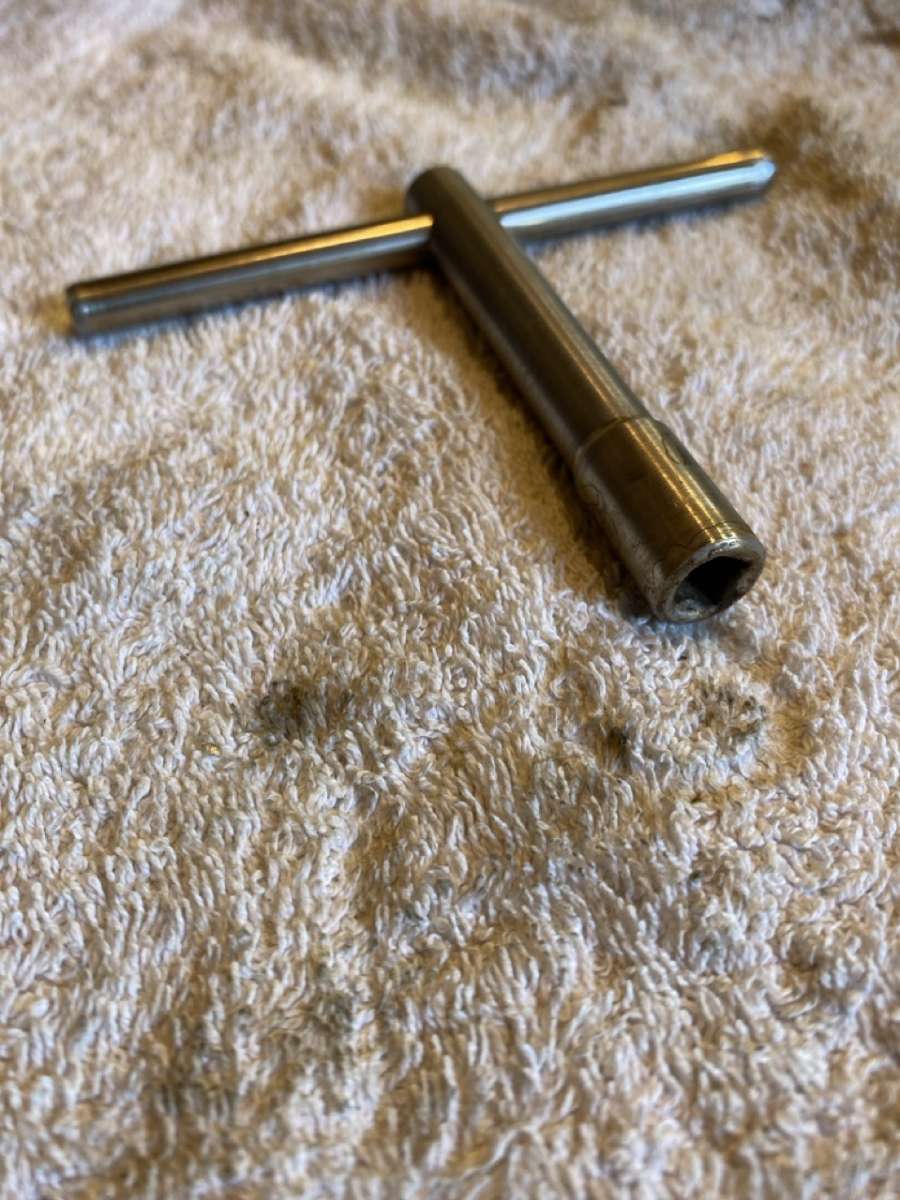

      First thing I needed was a 6mm square female ended chuck key and after a few searches drew a blank, so I silver soldered a 1/4″ socket onto the end of a piece of bar and away we went. – well, 1/4″ approx 6mm and OK for my needs.
      Next the mounting thread was 14mm x 2.0mm and my little wood lathe is 3/4″ x 16tpi UNF. Using my new (to me) ELS, I made a dummy male plug 3/4″ x 16 to suit the lathe and got it to fit existing chuck and faceplate. Back to the chuck, mounted that on my Boxford and screwcut to fit the dummy plug.

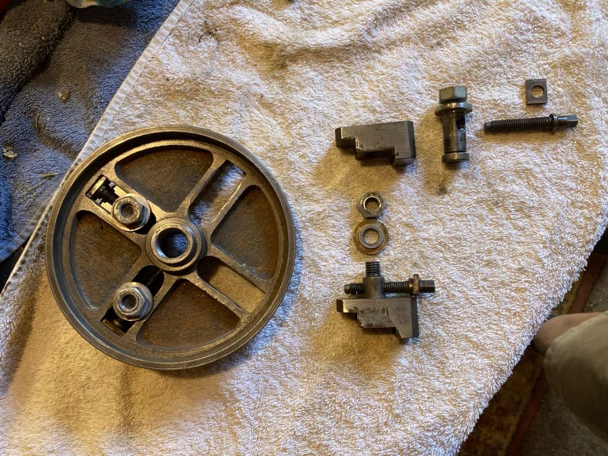

      The feature of this chuck is that by slackening the nuts on the back of the chuck, the jaw(s) can be rotated from inside to outside jaws – that’s a neat time saving feature. manufacturing oddities are that the screws that move the jaws in/out are Right hand threads, so you “undo” them to move the jaws in and that the radial alignment of the jaw relies on them sliding in a 1mm deep slot.

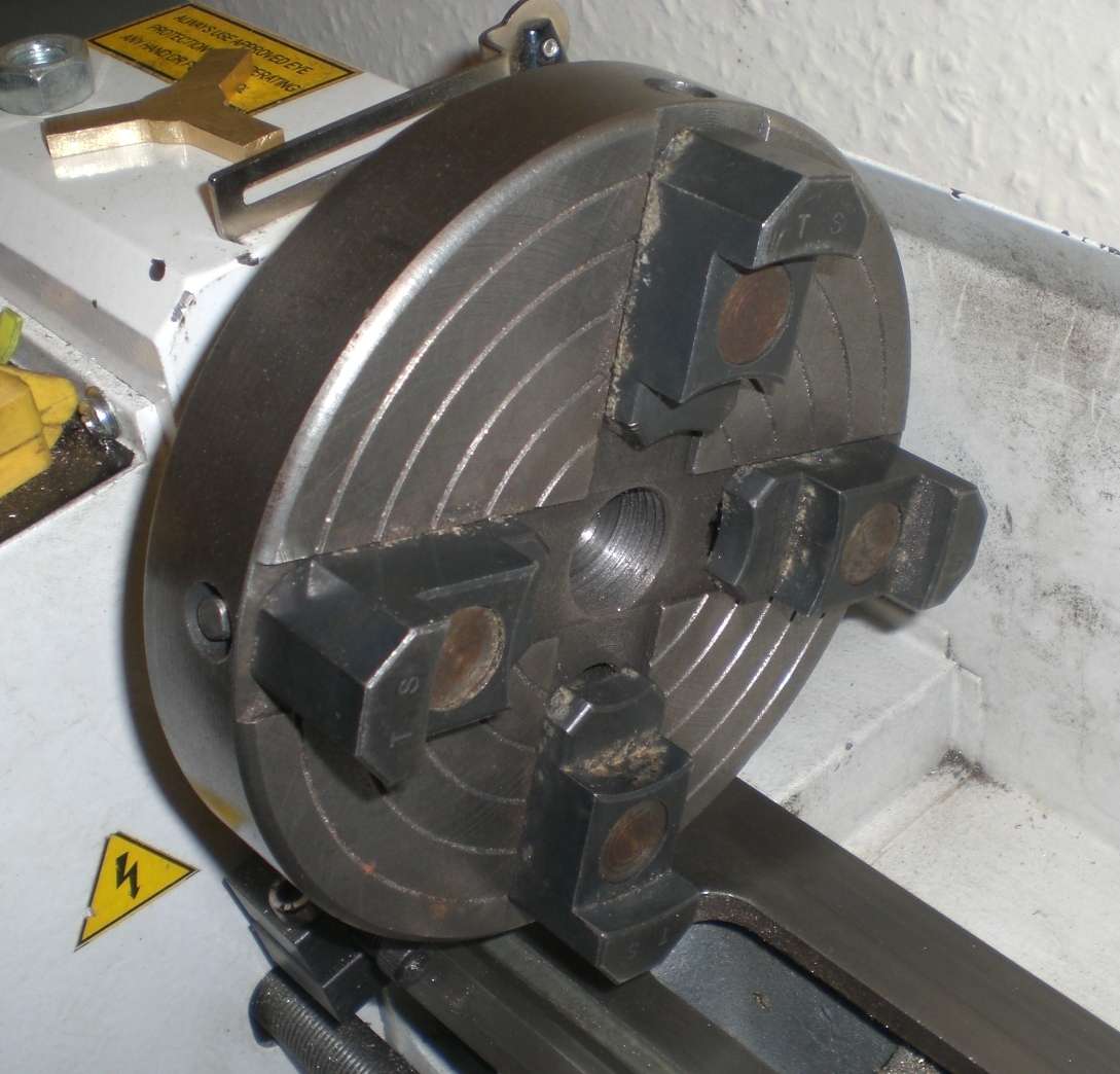

                  Hi Speedy, I have one just like it, and I’ve  seen plenty of them around, and have seen old adverts for them, so no, i don’t think the one you have shown is an apprentice piece,
