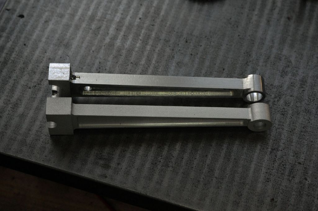

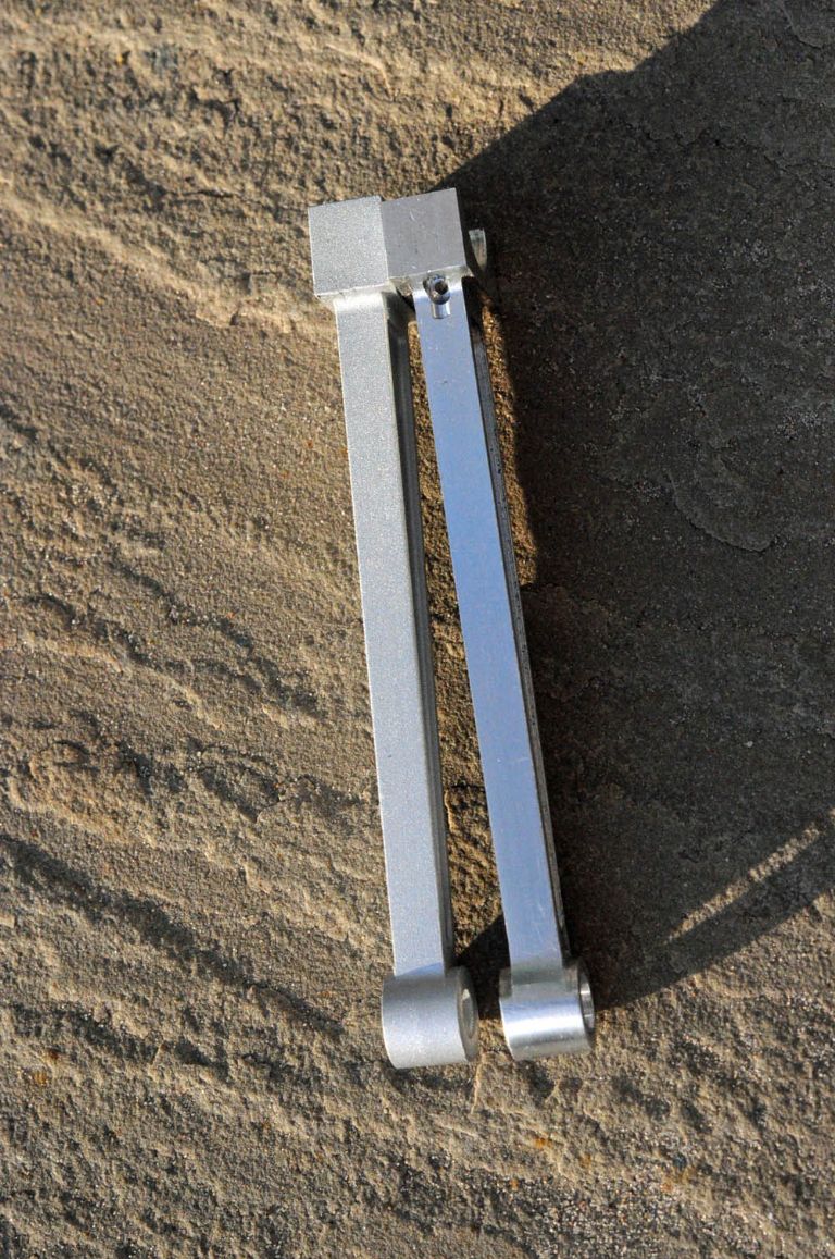

      I like the effect that sandblasting gives to the finish of aluminium engine bodies and components so I thought I would have a go with one of the £12 accessories available for my Karcher pressure washer. These are the results using kiln dried sand from Wickes
      2 similar components (both failures for various reasons). I've shown 2 different lighting conditions which I hope capture the effect. I was rather pleased with the result for very little outlay.
      Rod

            Does it leave a rough surface? Ramon uses glass beads which are not as aggressive. I'm in two minds to blast the crankcase for the Midget I'm making at the moment or whether to give it a nice bit of colour. I've got a Lidl Parkside blaster that I have tried briefly on CI.

                  Vic, are you using it for cleaning purposes or for applying a finish like this on the crankcases to replicate a die cast finish?

                      Jason, I use it for all kinds of things. Biggest project was a Target Crossbow, blasted before Anodising. I particularly like the finish it gives on tools though. After blasting I clean it off and add a coat of Microcrystalline Wax.

                          This is a messy method. The con rod was held down on the patio with a welly clad foot for blasting and there is wet sand everywhere but the garden can cope with that. As for the texture, I can just feel that the surface is not silky smooth but is more uniform than the machining marks left from the milling.
                          I've been doing some really crap welding with a basic Parkside buzz box that I was given (I will not show this, it is too embarrassing blush). The blaster made a decent job of cleaning off the fuming and much of the discoloration, thereby emphasising all the slag inclusions. I guess one could try a different medium but I'm not really up for spreading £50 of wet garnets over the garden.
                          I have no other requirement for a noisy compressor so this system will do for me.
                          Cheers,
                          Rod
