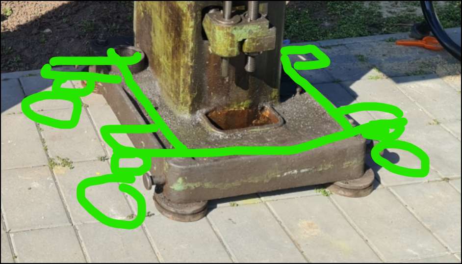

      I kept postponing to build a crane but it is more an more difficult without. Two machines are outside my garage and I can’t bring them in. And on the milling machine that it is inside I can’t replace heavy accessories without inviting a friend. Or two in some cases. I wanted to buy one since the crane is not the most interesting project on my list. But I didn’t find nothing suitable within an acceptable budget. Since I went on a shopping spree recently I want a cheap solution 🙂
      I’m oscillating between a gantry crane and a … let’s call it a cube crane like this:
      The frame will be large enough to be pushed around the mill. Then I could lift it with two chain blocks. It will have four swivel wheels to allow it to move in narrow spaces.  And when not in use it will take little space since it will just sit around an unused machine.
      The main problem is that I’m restricted to a maximum height of 220cm. It has to pass through the garage door. Because of this I don’t have enough room above the machine to put a block chain, like in the right picture. Fortunately the lifting points are at the bottom of the mill. I think it would be enough to use two block chains on each side.
      I’m thinking to make the vertical beams long enough to almost touch the ground. For safety reason. If one wheel fails the frame will not roll over. This is the best design that crossed my mind.

            Your cube crane will need diagonal bracing on each side to stop it becoming a “mechanism”. This will obviously restrict access to the load.
            As Howard says a trolley and castors allows movement. As for lift, simple sheerlegs with or without a block and tackle. A friend used them when moving big lathes. OK, head room may be a minor problem in the workshop but the machine can be slid off the trolly.

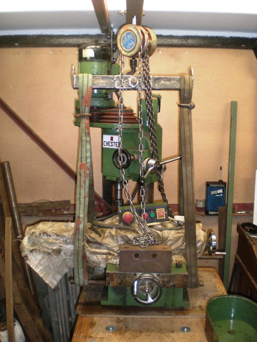

            peak4
              @peak4

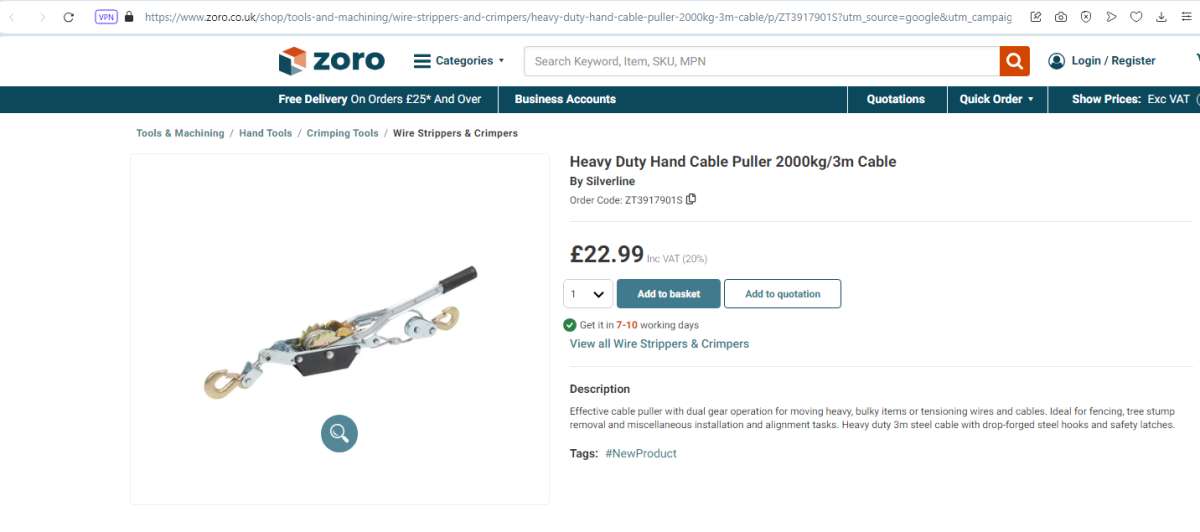

              These can pull and release under control; bear in mind they are often sold as a puller, rather than a hoist, so safe working loads might need to be considered. They also come complete with the pulley to go at the top.
              I use to use them for recovering rally cars, normally just to stabilise the stranded vehicle, with the Landrover mounted winch for extraction.
              image_2024-03-05_171751250
              Alternatively, add some load bearing removable cross bars just above ground level
              Your chain hoist can then go on a supplementary (folding?) frame above the cart.
              Lift up the machine, lower onto the cross bars and lash down.
              Lower crane part, wheel into workshop and raise the crane again.

                Sonic Escape showed a trailer-winch, not a puller as you do.
                I am not sure if trailer-winches are recommended as part of a crane, though I have done it on scaffolding sheer-legs to erect my own machine-tools. I do not know their typical SWL; but they are fitted with a ratchet. In my use I interposed a pulley to halve the load on the winch… and on me.
                Really, unless your workshop has the headroom for a heavy-duty overhead crane, moving something like a milling-machine is better done using rollers. It’s as well to remember that although mobile straddle-cranes like that are used, e.g. in boatyards, they need very heavy-duty castors indeed to be at all maneouverable with a load as heavy as a milling-machine on them.
                The puller is NOT a lifter, and should not be used as such, but it can be used in conjunction with rollers or sheet-steel skid-plates.

                  Yes, I don’t want to build a “mechanism” 🙂 That was a simplified diagram.
                  I liked the idea to have a removable frame on top! The celling is 275cm high. And the milling machine is about 164cm. But then I remembered the band saw, it is taller …
                  But there might be a simpler way! Afterall it is enough to lift the mill only a few cm. Everything is flat here. So first I can connect each bottom lifting point of the mill to the corresponding top corner of the frame with chains. Then I can use something like this 3t lever chain hoist to lift one corner of the mill. Only a few cm. Then I tension again the chain from that corner. And then I remove the hoist and move it to the next corner. I’m not in a hurry.
                  The castors part is indeed the weak point. I already bought 4 without thinking too much. They suppose to hold 260kg. And I guess this is static load not a dangling machine. And if I add also the weight of the frame this doesn’t look good. Now I’m thinking maybe to by 2 more.
                  The rollers are super strong but I’m afraid it would be difficult to turn the frame with the mill hanging in the middle.

                    As noted the ‘come-along’ as the Americans call them cannot be safely let down although they will lift. I have had two for many years and when letting out the rope they will suddenly let-go, in fact this feature is what I use to pull out the rope to set up for a pull. I mostly use it for tree stump removal – horizontal pull.

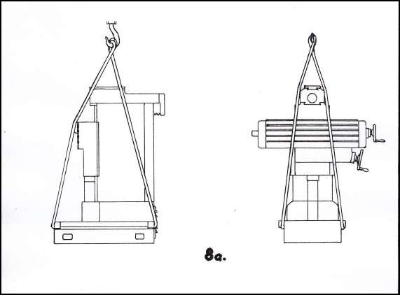

                              On pieter Said:
                              Under no circumstances should a load be lifted from below the center of gravity, it will topple over.
                              I am a certified Engineer.
                              I do it all the time. I’m a certified forklift operator.
                              Apart from that the TOS version of this machine shows exactly this in the handbook:
                              FN25lift

                                      peak4
                                        @peak4
                                        To expand on Pete’s point, have a look at my photos on This Topic
                                        It works well and can be moved from machine to machine.
                                        Re my previous comment on a wire rope puller. The one I use can most certainly be used for lowering a load under control one full notch at a time on the ratchet; it’s inherent in its design and covered in the instructions; it also claims to be rated for lifting, albeit under US regulations not UK.
                                        Bill

                                        Nicholas Farr
                                          @nicholasfarr14254
                                          Hi, well you don’t always have a choice about not lifting from below the centre of gravity.
                                          Lifting Bar 1a
                                          It’s just a matter of knowing how to safely sling / rig what you need to lift, and yes, I’ve had proper training for this, by Lloyds British. I’ve even had training on wheeled mobile crane operations.
