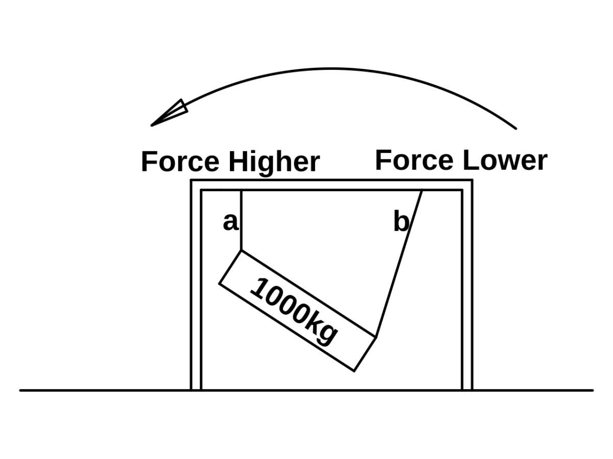

          One chain block for the two back lifting points and the other block for the front. For some reason the chain blocks manufacturer disagrees with my plan …
          Helps I think to ask ‘what could possibly go wrong?’ when the instructions advise against something.  Understanding risks helps avoid them, and guides those who might need to tackle a tricky job.   Relying on luck isn’t smart, whilst preparing for the worst can avoid much unpleasantness.   For example, a common cause of crush accidents is people instinctively reacting to a heavy toppling object by trying to push it back.   Thinking ahead suggests it’s much better to jump out of the way because broken things are almost always far less trouble than broken people.
          A couple of issues come to mind with doing a lift with two hoists.
          • The object may hit something or overbalance by rolling on the axis between two lifting points.  (Sonic may have allowed for that risk: he mentions having two back lifting points and one at the front, which should stop rotation.)
          • When one hoist lifts higher than the other, the weight of the object isn’t shared equally between them.
            • Therefore either hoist has to be capable of supporting the full load on its own.   Lifting a 1000kg object with two 750kg hoists is dangerous because one of them might be overloaded by an operator error or mechanical fault that causes an imbalance.
            • Even if both hoists are strong enough, the load transferred to the structure is also unbalanced, so it might be overloaded or topple.  In the diagram, a tilted 1000kg object puts more strain on chain a, and less on chain b, and the unbalance causes the whole frame to want to turn counter-clockwise.  Whether the structure topples or not depends on where the centre of gravity ends up.
          unbalanced
          If the mass of the structure, plus the structure’s material and the joint types are known, strength and stability can both be predicted.  More usually, a crane is designed to lift a given mass safely, with the engineer calculating materials and form as necessary to do the job.  A proper design would consider everything, for example my diagram ignores foot pressure, column buckling, strut bending and assumes a perfect ground.
          That said, I’m not against Sonic’s practical approach because I detect he’s doing enough risk management to avoid injury in the event his crane breaks, and he’s acknowledged the comments.   I have less confidence in certain others who puts stuff like this on the internet as a done deal, especially those who can’t cope with criticism!

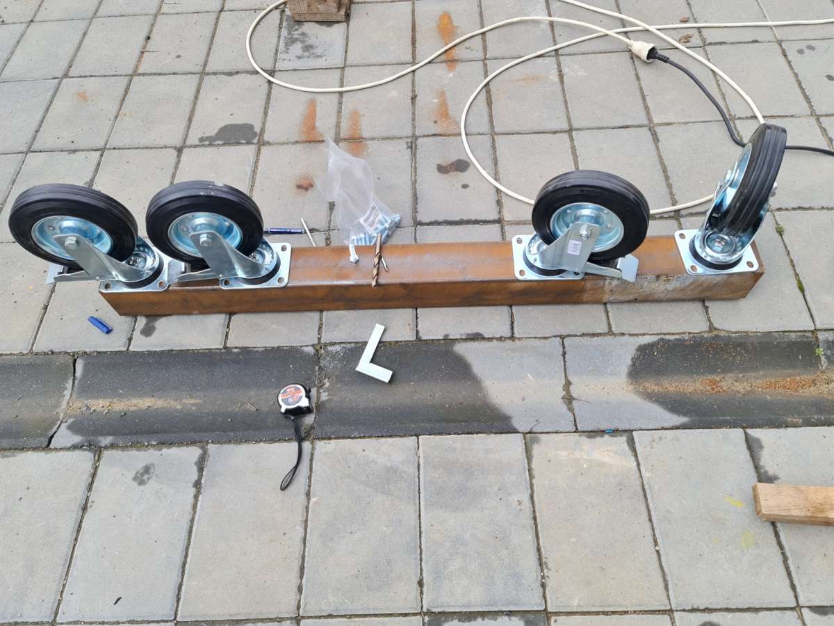

                I thought I’d mention those castors are very unlikely to evenly spread the load unless on a dead flat surface. Like a chair on a wonky floor, trolleys like to rest on 3 wheels. The castor wheels will give some squidge to help divide the load but if any individual wheel can’t take 1/3 or 1/2 the load it could be liable to collapse under load.
                If the current plan is to just raise the machine onto rollers though then its a simple fix to just rest the crane on wooden beams to bypass the castors. Small commercial gantry cranes often have screw jacks built in to do the same.

                        Hi JasonB, that’s a good idea about bolting box sections on, and landing the machine on to them for moving, but I think he would have to take two of his casters out of the middle sections on each side, and then move the other ones to the central position, as I think they may prevent the casters swivelling, though he may have enough room to move the two of them to the middle.
                        casters 20240316-102624

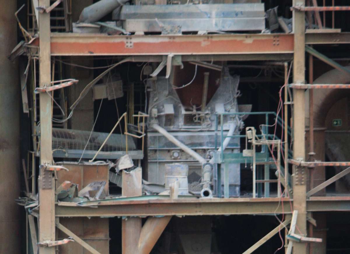

                                    Nick has misunderstood the point.  I’m saying that, if circumstances permit it, a structural configuration that doesn’t need a weld at all is a better choice than one that requires the weld to be in good order.    Whilst it’s true that well-made welds can be as strong as the metal they join, we also know that welding isn’t always done well, and that it’s difficult to test without special equipment.
                                    Nick admits that welds do have to be structurally sound.   Unfortunately Sonic’s photos, skill-level and inability to test welds mean that’s doubtful in this case.   That being so, replacing the crane’s top with a door lintel design, is a simple safety improvement, and I suggest there’s no good reason for not doing it.   Given a straight choice between a strong configuration and a weak one, a structural engineer will go strong.
                                    Joints in steel frame buildings are a different problem: and, Nick’s advice they are OK is misplaced, because they do collapse:
                                    https://www.labc.co.uk/sites/default/files/content/ilford-steel-frame-building-collapse.jpg
                                    Ditto misunderstanding with the dual lift problem.  A safe dual lift requires requires two coordinated operators who understand what they’re doing.     The chain lift manufacturer’s instructions tell ordinary customers not to do dual lifts because it’s unlikely ordinary customers understand dynamics.  Here’s an example of the professionals getting it wrong!
                                    https://youtu.be/8_nTLIuk6Hk
                                    Saying stuff is OK if done properly isn’t good enough, because it assumes ‘done properly’ is sorted, when there’s a chance, it isn’t.  The ‘if’ cannot be ignored, and assumptions are always dangerous.    Better, I think, to engage brain and establish clearly what ‘doing it properly’ requires.   Identify the risks, and mitigate them.   If a structure can break due a faulty weld, is there a way of not relying on the weld by using a different geometry?  In Sonic’s case, the answer is yes.
                                    Structural Engineering is ‘quite interesting’.   I recommend the book ‘Why Buildings Fall Down‘ as a non-mathematical insight.

                                        I have to take issue with the sketch used by S.O.D several posts back. He shows a length of bar hanging below a table from two cords, one longer than the other. No problem so far, but if I read it right, this is supposed to create a moment tending to rotate the table to the left.
                                        It is a long time since I did my Physics A level, but what I see is a force down each of the cords, both pulling the table-top downwards. Each force is in line, exactly, with the cord, isn’t it? And the result is to pull the left table-leg downwards and the right table-leg downwards. These forces might be different but I don’t see how the overturning will be effected.
                                        Can someone put me, or him, right, please?

                                              Last week I lifted the milling machine about 10cm and I tried to move it. No chance! There is too much friction from the 8 rubber castors. Also I felt that the hanging machine acts like those seismic dampers in tall building and it is opposing the movement.
                                              But I found another way to move it. I can lift only the front of the mill. And then I push it from the back with a lever. I can move it up to 50cm. Then I lower it down, move the frame 50cm and repeat. It is slow but very easy and safe. In the garage I’ll add a metal plate under the lever to don’t crack the floor tiles.
                                              If the plan to move the machine on wheels failed, the lifting of heavy items from the workbench works very well. The frame can slide over the workbench as planned. Here I’m lifting a ~100kg rotary table.
                                              It is very easy to lower it into a wheelbarrow and move it into the new shed. There I mounted the second chain block to unload the wheelbarrow.

                                                Looks like you need to change the wheels for the hard plastic type. You can get these up to a 700Kg load capacity each. Not sure how 8 wheels react to each other when loaded. Maybe 4 would be better. The rubber wheels will all have a flat on the bottom when heavily loaded. Will be almost impossible to move.  The frame looks good though.
