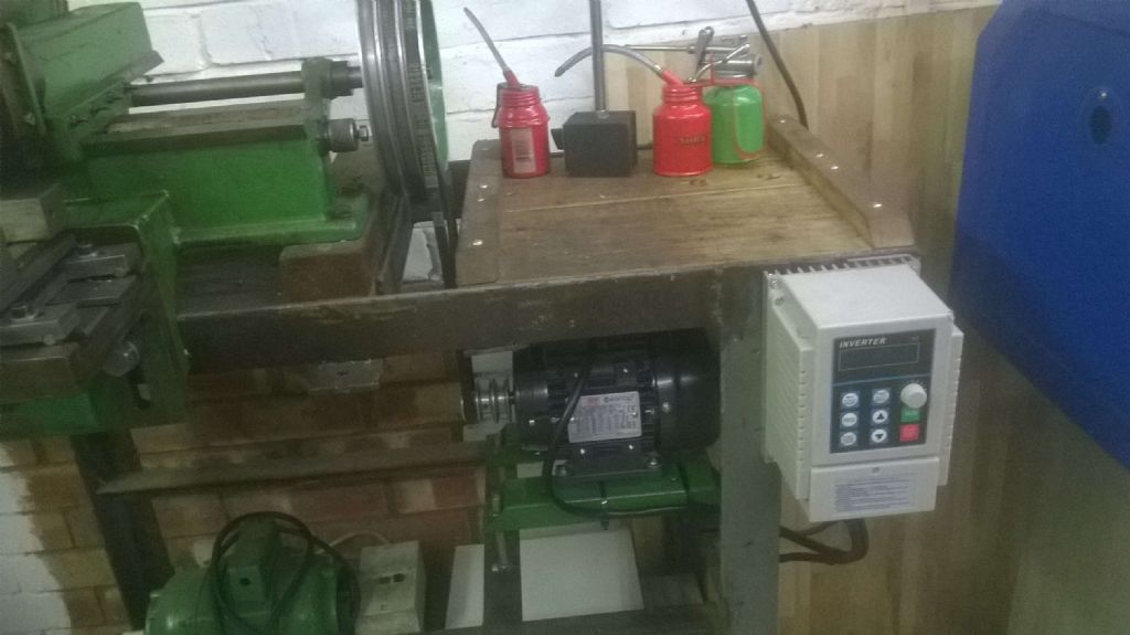

                Not just today, but spread over a couple of days – as the parts arrived.
                I have long considered that the ram speed on my Perfecto shaper was too fast, despite using the lowest ratio combination of pulleys available. A recent small windfall has enabled me to purchase a 0.3HP 3-phase motor at a considerable discount along with a VFD at a similar knock-down price. Add a length of 4-core cable and a few hours work and, hey presto! – a completely controllable shaper. Unfortunately, the original belt used was, I found, the wrong section for the pulleys, so a new one is on order. That should be here in a couple of days. In the meantime, the temporary set-up is working and the VFD has been programmed with the appropriate settings.
                Shaper re-motored

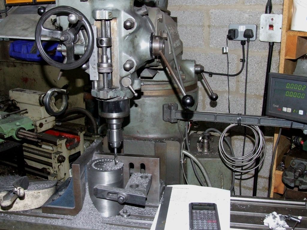

                  Spent part of the day roughing out the LP cylinder liners. The extruded cast iron was turned 0.1" over on OD and 0.1" over on length. It seemed a shame to machine away the central slug so I chain drilled from both sides to remove it. A simple spreadsheet allowed me to select a drill size that would give about a 2 thou or so overlap between holes. The drilling in progress:
                  After drilling from both sides a couple of sharp taps with a hammer and the core broke away. The two LP liners roughed out, OD is just over 4":
                  In total 104 8.4mm holes and 3" deep. Thank gawd for the bolt hole function on the DRO and power down feed on the quill. I chose a conservative 3 thou per rev at 800rpm. Each hole took just over a minute. I did try the 6 thou per rev feed but it seemed a bit much driving an ~8mm drill with no pilot hole. In addition, by repute, the quill power feed on the Bridgeport is a weak area, so no point in pushing it. Next job, tomorrow, is 60 holes for the HP liners.
                  I also coughed up the money for having rubber tyres vulcanised on one set of wheels for my traction engine. I hope to collect them in the next couple of weeks.
                  Andrew

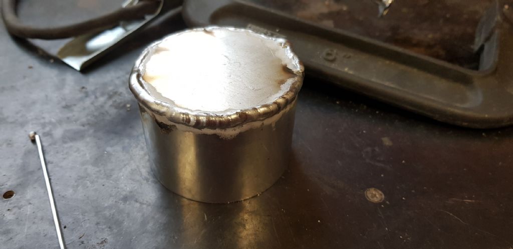

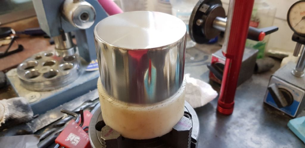

                    While wondering what to do with an old suspension part from my Son's golf, i remembered i needed a better cutting oil pot. The one i have keeps falling over, so started to make a better one with a tube down the centre to stop spills if it gets knocked over. Also to get my hand in attempting to alloy weld. I did use too much filler rod,
                    Steve.

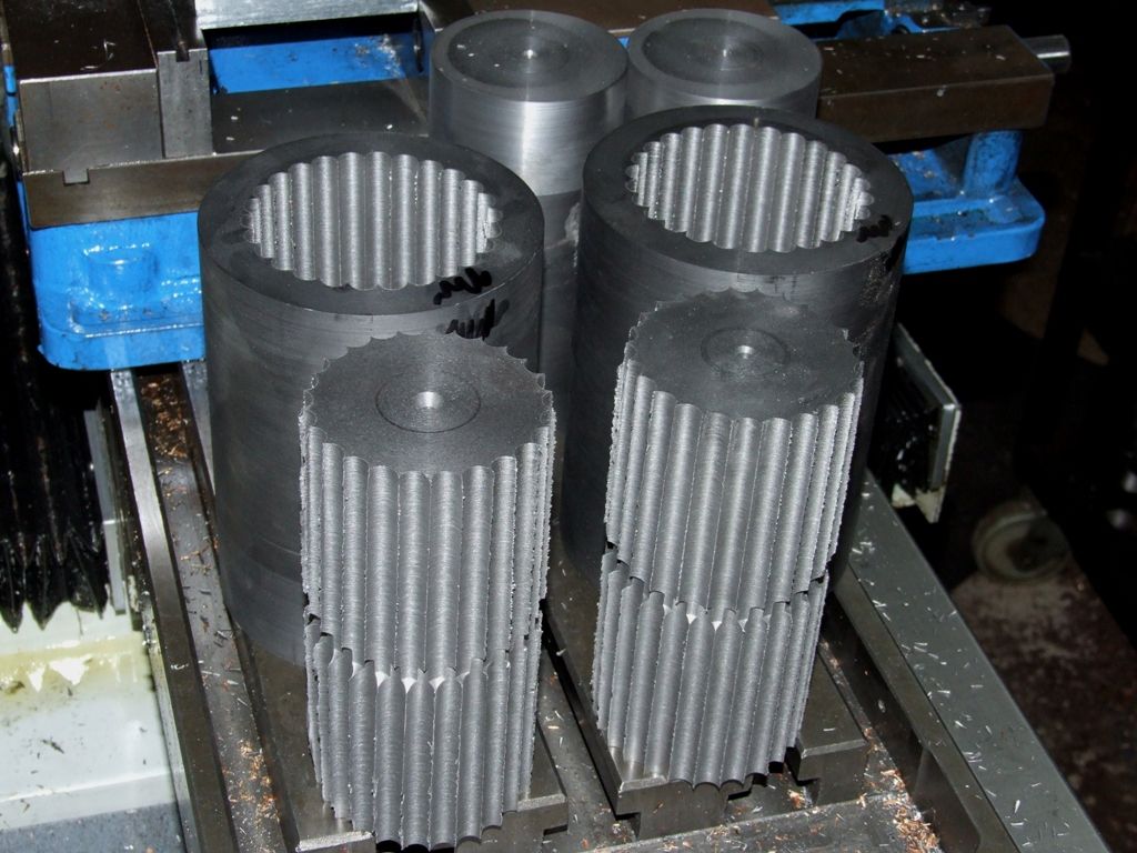

                      Job done:
                      Followed by a clear up of the lathe, mill and floor. It's amazing how much swarf was created. sad
                      Andrew

                        Wow, extreme chain drilling! yes
                        #492784
                          Andrew, any reason you chose the BP over the Tormach which could have been left to it rather than having to move to each co-ordinate with the DRO or was there not enough head room? It's a shame you could not have got the HP from the waste slug out of the LP

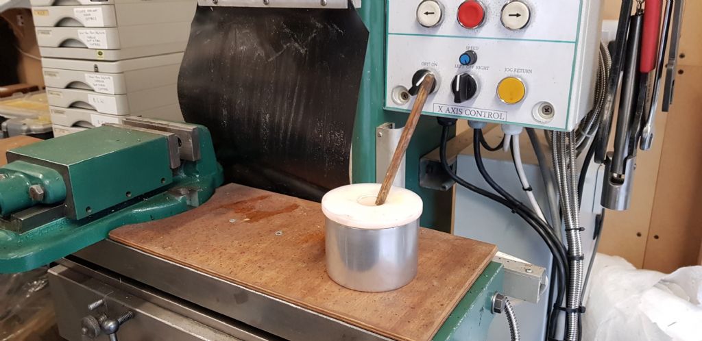

                            Finished the cutting oil pot. Cost, £1.50 for the piece of Delrin.
                            Steve.

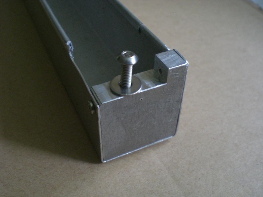

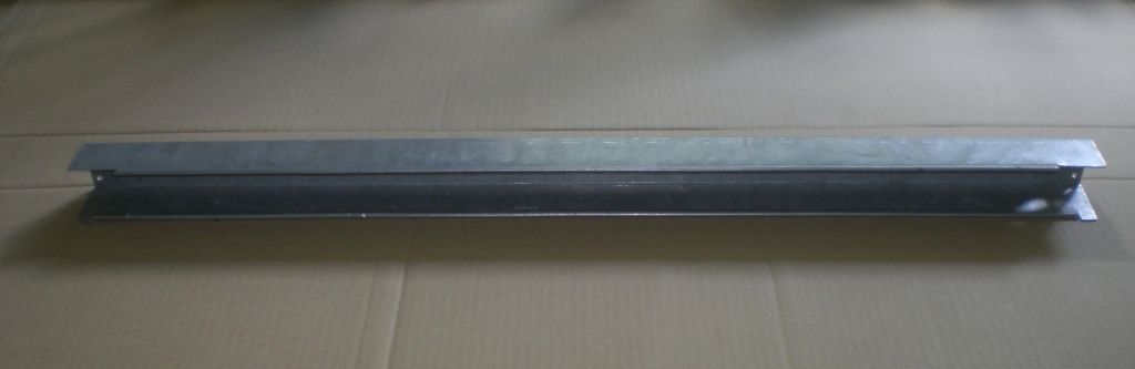

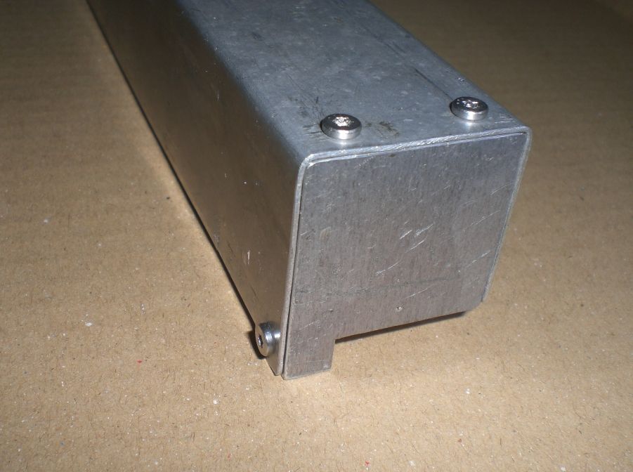

                              Hi, today I finished and fitted a protection cover for the X axis encoder scale on my Warco Major milling machine. After folding a piece of used aluminium with my recently made sheet metal V block and T blade Sheet Metal Bending V block and blade
                              Two ends were made from 10mm ally plate and some low profile S/S screws from old computer hard drives were used to fix them in place.
                              This morning, holes for fixing the cover were drilled and tapped 4mm for two S/S button head screws.
                              Although it's not a showroom job, but then my machine isn't in a showroom, it will stop the encoder getting showered with swarf and cutting oil.
                              Regards Nick.

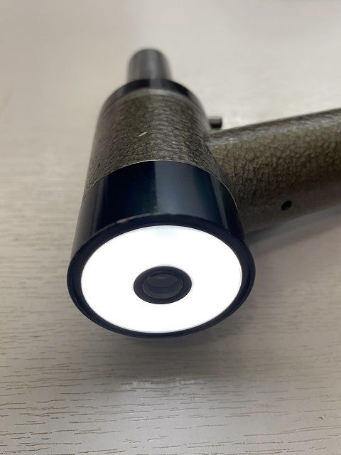

                                Fitted LED bulbs and transformer to a Isoma Centering Scope in bought on Ebay couple of days ago.
                                Works very well, just need to test on the mill now.

                                  Is that the £20 buy ? if so that's a real bargain.

                                    I played fair. He had offers accepted so I offered £50 he countered £60. So I snapped his arm off

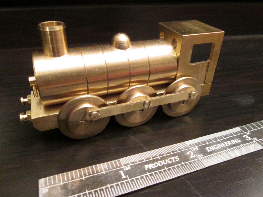

                                        More-or-less finished a little BRIO-gauge loco for the grandkids. The big depth of flange is to help it cope with the curve radius on the Lidl set they have. It still needs a tender. The coupling rods work well – the pins are 2,5 mm dia. under the heads with an 8BA thread. I had to pivot each wheel independently on the end of each axle – I couln't think of a way of quartering accurately bilaterally – so each side-set of 3 wheels rotates together, but independently of t'other side.
                                        Oh, the angle at the bottom of the buffer-beam is to stop it grounding on the next flat rail at the bottom of the slope from the bridge… laugh

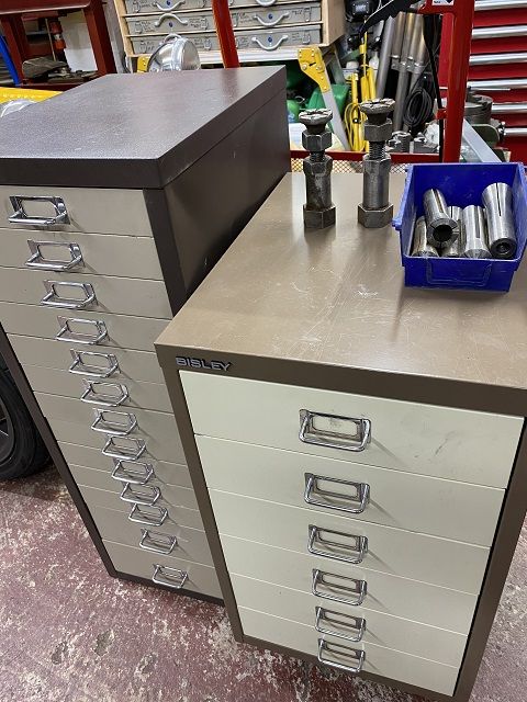

                                          Took load of bits from loft to local car boot.
                                          Cam away with these.
                                          Knocked the cabinets down from £10 each to £15 for the pair.
                                          Knocked machinists jacks and collets from £12 t £5
                                          Cabinets are immaculate. Not sure where they are going as already have a few in workshop but will squeeze them in somewhere.

                                            Those are the cheapest cabinets ever Colin. Great buy. I bought a couple of the tall ones last year and they cost me £50 each. Always room somewhere for another cabinet. The only problem is as soon as you put it in place it is full up. regards

                                              They Obviously did not know the value of them. I’m glad to say
