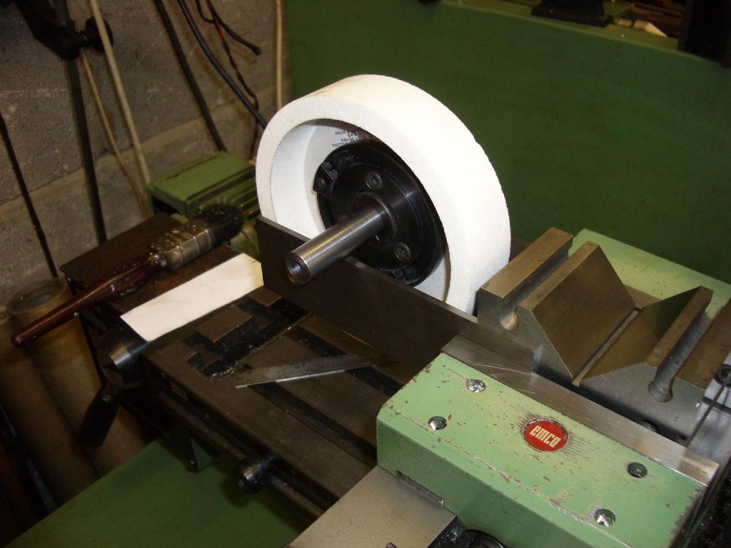

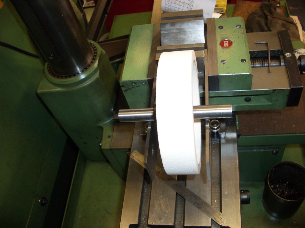

      John Hinckley this is how i balanced the wheel for my Christen drill grinder an impromptu method but it worked well providing you make sure the thin parallels are level to mother earth. Regarding the finish — have you checked the spindle bearings ? Had a similar problem and it was the bearing causing the problem

        JohnF
        I haven't checked the spindle bearings as the machine is a brand new (well a few months old) one from Warco. It is, however, called a "simple surface grinder" Whether the "simple" bit applies to the grinder or the surface is unclear! Possibly the operator?
        I have a couple of thin parallels – actually two halves of a cheap, redundant digital caliper as a result of reading a readers tip in MEW a couple of issues ago – so I might try those as well.

          Thanks for that. It's pretty much confirmed the direction I'm going on this one. Tried the knife
          edge wheels described in my post with the CAD screenshot. That didn't work
          either, I'm going to try a pair of 6mmØ silver steel rods fixed to the top of the fixture
          and add three levelling screws for good measure. Failing that, I'm resigned to
          ordering some new material for the "scrap bin",
          Hi John
          I think for the roller type of balancing cradles to work effectively the rollers need to be
          large ,if you look in the lathe's web site at the Jones and Shipman page the balancing
          cradle shown has rollers nearly 6 inch in diameter ,it all starts to get a bit big for hobby use.
          Some useful articles have appeared in MEW long in the past .
          An article Keith Johnson in MEW 180, Balancing grinding wheels , although written for balancing
          wheels for the Quorn grinder the balancing cradle that he has designed would be useful
          for balancing wheels.Uses round bars for the cradle.
          Also worth reading
          An article written by Michel Christiaens in MEW 139 Grinding wheel selection ,safety and
          dressing.
          Very little ever seems to appear in Mew in connection with grinding in general and
          grinding machines,i think it is a much neglected aspect of this hobby.
          Having said that Alan Jackson's small surface grinding machine made from a Dore Westbury milling machine has made a refreshing change.

            Thanks for the further links. I'll have a look at those later. I had hoped that the device would be compact and bijou, so 6inch wheels don't really fit in with that philosophy.

              Nice Mill you have there JohnF…

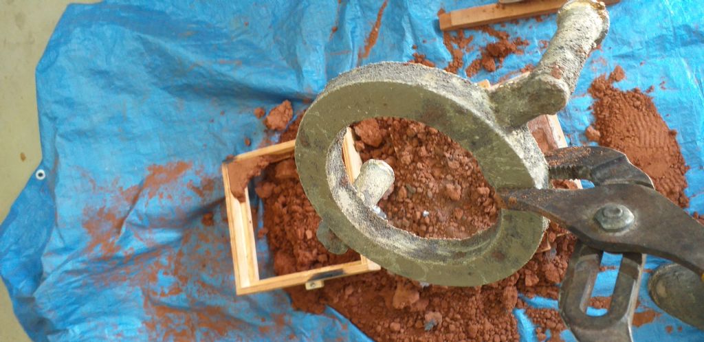

                Inspired by the excellent casting articles by Luker and Gerald Martyn today I cast the front smokebox ring for my Black5. And I'm still buzzin. Thanks guys.

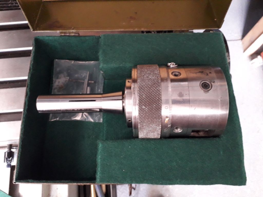

                  I dropped on a Newall boring and facing head recently, it came with a steel case that probably wasn't originally with it. It had some woodwook inside but it didn't fit very well so I've added more and re-awoke my inner feminine side to fit a nice green baize lining, I just need to remember how the head works now as I haven't used one since I was in my teens as an apprentice on the jig borers…

                    Looks the same at the one I use on Newal 2436 jig borer they were made by OMT [Optical Measuring Tools] part of the Newal group. The one i used was unfortunately not the best tool in the shop, eventually went over to Wohlhaupta and Kaiser boring heads however we were looking for tenths not thous !

                      Thanks Joe I bought it new in 1984 always been very please with it and its a very versatile machine — great for small parts but surprising what its capable of as well.

                                Hi John. Interesting, this one is made by CWC Lacey, Maidenhead, England. It seems in very good condition and now I have a 7/8 R8 sleeve for it I can give it a try. If I can't get on with it I can move it on as it didn't hurt the wallet!
                                As you say, may not be much good for tenths, and I certainly don't need that accuracy, but just having the facing facility will be handy.

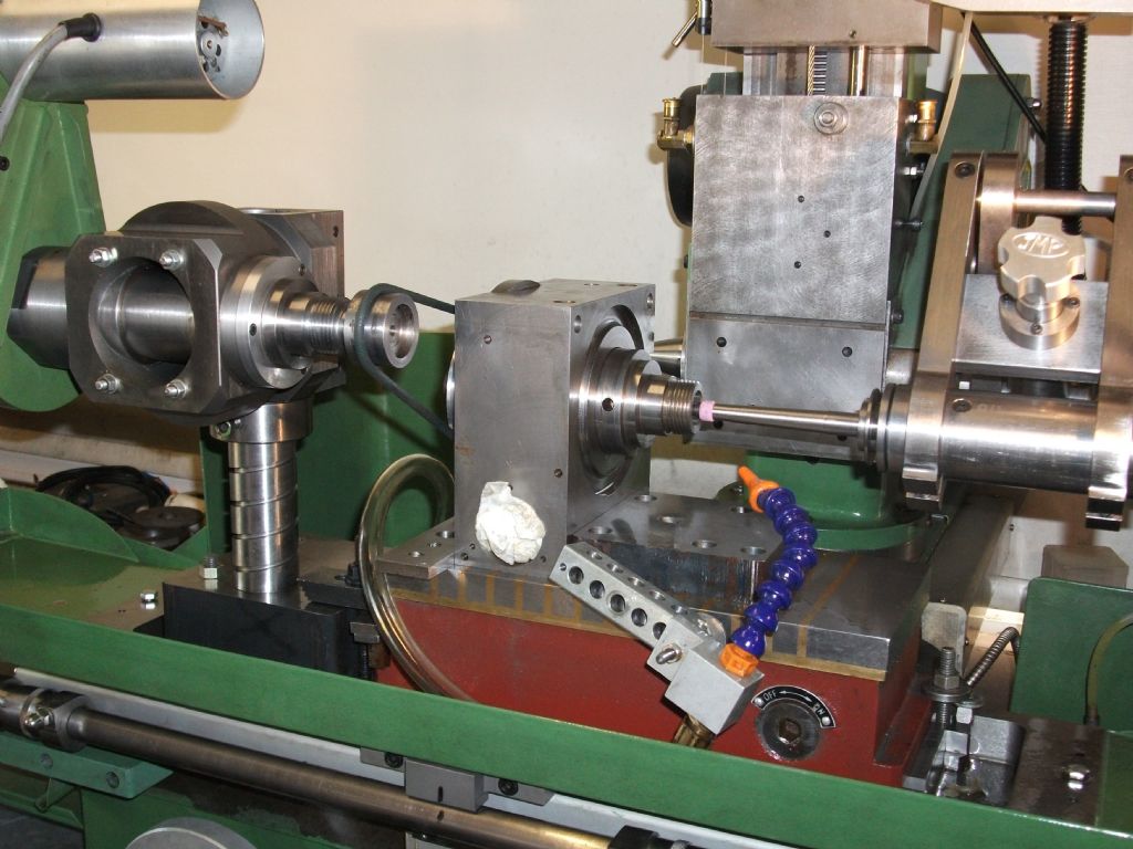

                                        My 4 axis rotary table 2 morse taper i have never been happy with ever
                                        since i made it a long time ago it runs true enough close to the nose
                                        but was obviously off further in as the run out increased away from
                                        the nose.As i have had the table apart for some modifications to adjust
                                        the step count i have taken the opportunity to regrind the morse taper.
                                        Seen here in the photo using the cylindrical grinder the rotary table is
                                        mounted on the magnetic chuck and set over to the required angle.At the
                                        back of the table there is a thread to push out the morse taper arbor
                                        and this provided a fixing for a temporary pulley to drive .The grinding
                                        work head provides the drive via a heat joined belt.
                                        The first attempt was not too successful as the grinding spindle was
                                        too long and thin so i made a new thicker spindle tapered like a
                                        morse taper and set the grinding head at an angle so the spindle
                                        entered with some clearance.
                                        As with any grinding job the setting up can take quite a long time in
                                        comparison to the actual grinding.
                                        The end result shows zero runout at the nose and about 2 tenths
                                        at the end of the test bar about 5 1/2 inches out ,happy with that.
                                        Reading up on the current practice on grinding spindle arbors they
                                        seem to be made these days from tungsten carbide ,they seem to
                                        be listed as POA which i guess means they are not cheap.
                                        It's a different world out there ,doubt it much it would fit anyway
                                        with my home made kit.
                                        Still have another one to do later in the week .

                                              John, could you explain your setup in more detail please? Interested as to how that setup works.
                                              How did you set over the job on the magnetic chuck to the MT angle, bearing in mind the relationship to the sliding axis? How DOES the sliding axis work? Does the mag-chuck slide, or the grinding head, ie, what moves to make the abrasive wheel move in and out of the job? Can't see from the photo – is that a commercial grinder or a shop built one ( the whole machine, not just the grinding head) Maybe some more photos of the whole thing from different angles.
                                              Looks interesting!
                                              Joe
                                                Looks interesting!

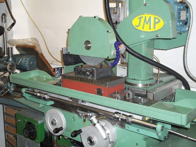

                                                Hi Joe
                                                It is easier to explain if you view the 1st photo ,the machine is a home
                                                built fabricated machine and initially was styled using the basic dimensions
                                                of a Myford MG 12 grinder but at about 2/3ds size.From this the table
                                                moves left/right and the grinding head fore and aft just the same as a normal
                                                cylindrical grinder.The protruding shaft housing just above and behind the
                                                tail stock is the shaft used for surface grinding,for this the the head and
                                                tail stocks are removed along with the swiveling sub table the head swivels
                                                round 90 deg and then the machine can be used as a surface grinder
                                                as seen in the 2nd photo.In front of the table there are 2 micrometer
                                                adjustments for the stop bar,the machine has a 2 axis dro the table has a
                                                5 um scale the crossfeed a 1um scale, to set the angle for the morse taper
                                                a true running test bar was mounted on the nose of the rotary table and the
                                                table traverse set to 5.125 inch at this length a difference of .128 inch is
                                                correct for a 2 morse taper half angle.Setting the rotary table on the mag
                                                chuck and using a dti and the dro to check and set this measurement.
                                                As the grinding head height can be set anywhere is is a simple matter
                                                to align using centres in the spindle and the work.

                                                  The internal grinding spindle assembly mounts to the surface grinding
                                                  spindle housing with 4 bolts and a clamp and is driven from the spindle.
                                                  The 3rd photo here shows the workhead at the far end of the table here
                                                  also having the 2 morse taper being ground in situ.The internal grinding
                                                  spindle swings up as you can see by the shape of the mounting bracket.
                                                  For sizes above 10mm i use bore gauges as these are relatively long
                                                  and would foul a fixed spindle ,the mechanism has a quick release and
                                                  uses spring pressure to hold providing a constant force for a repeatable
                                                  repositioning. The work head mounts on a column similar to a Quorn
                                                  grinding machine but much larger and is made in such a way that the relative
                                                  centerline relative to the table has eight different positions.As the head can
                                                  swing 360 deg and can point up of down by about 30 deg with
                                                  work mounted it is possible to get an out of bounds setup ,to some extent
                                                  having this arrangement makes this less likely.
