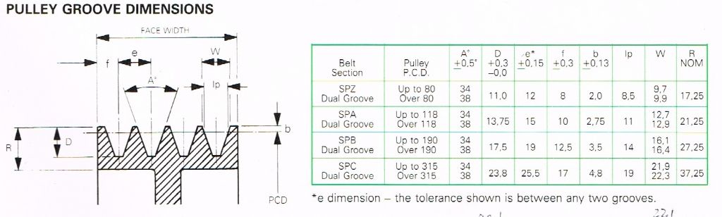

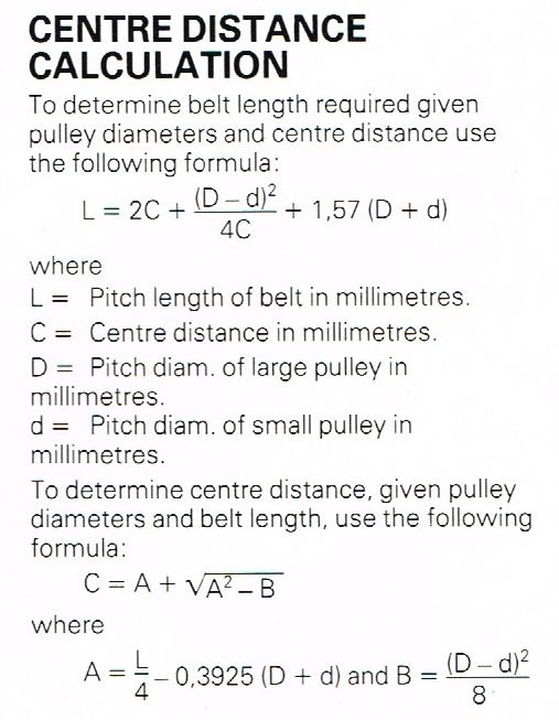

                      Nicholas Farr
                        @nicholasfarr14254
                        Hi John and Ian, the info below may be helpful.
                        Regards Nick.

                            Do you mean that different manufacturers measure and state the length be different methods? Mentioned in this thread have been references to inner, outer, and centre lengths (of the belt section). Each would obviously all give different results.
                            I only ever seen belt lengths specified by the pitch (which might not be dead centre) so surely if a manufacturer says a belt is 36" and it measures differently then surely that is a product quality problem?
                            The real difficulty here is when does not know the pitch diameters of the pulley or even the belt section type. The best option is then to use old belts and test for best/correct fit in the groove followed by the belt cutting and measuring technique mentioned earlier. In practice one could probably get away with using a length of electric cable that drops half way down the grooves and measuring that.
