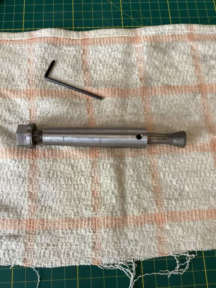

      I find I need one a 2.1 collet for something on my Pultra P type & it has to be one of the very few collets missing in my collet box so as I have about 20 emergency collets I decided to make one, yes I could use 5/64 as I have a full set of imperial but where is the fun in that & anyway it’s something I haven’t done it will be a learning experience.
      I have already put a 2mm drill through the collet & then a 2.1mm end mill & checked it with a 2.1 pin gauge so happy so far, next comes how to hold it in the rotary table to cut the three slots, my thoughts are to make an extra long MT2 arbor to fit into the centre of the rotary table with a M10X1.5 thread into the small end of MT2 arbor & on the other end a M10X1 thread to screw the collet into with a hole in the side to thread a dog point grub screw into to sit in the slot of collet to stop collet turning, but before I start making the MT2 arbor I thought I would ask on here if anyone has any better thoughts.

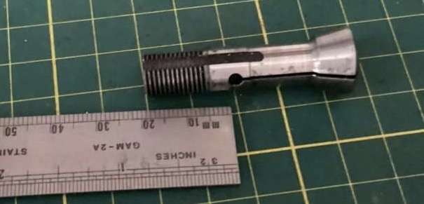

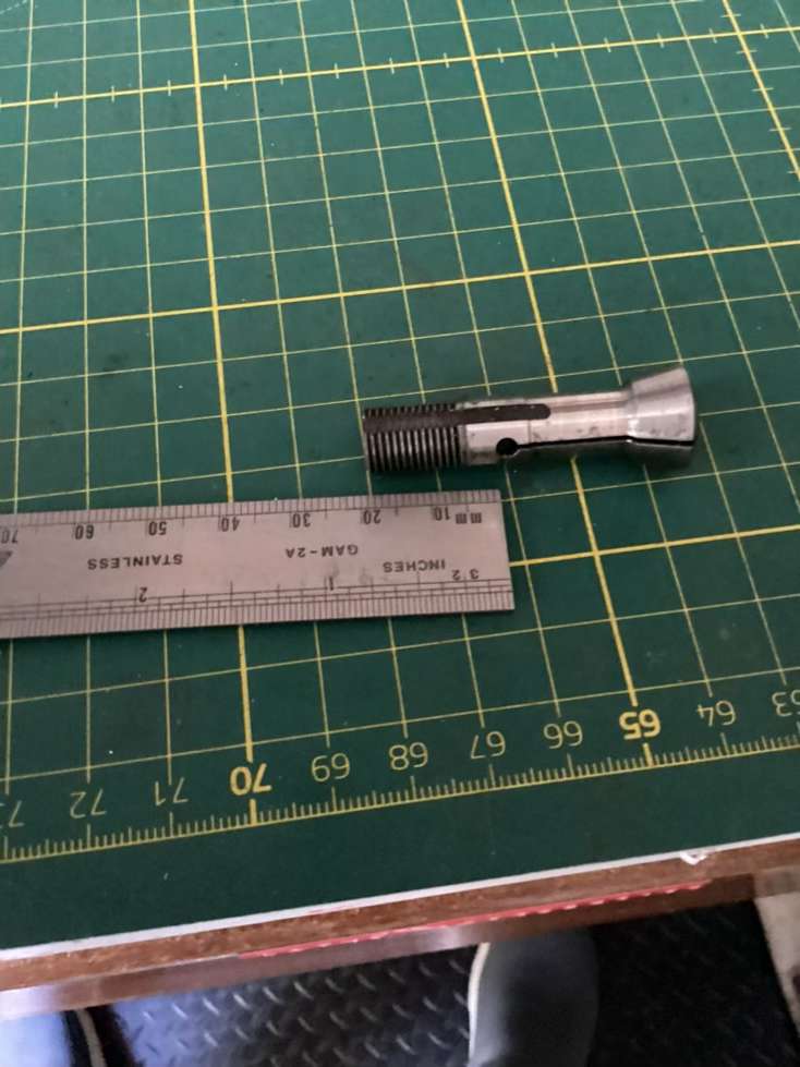

          The collet is for a Pultra 10mm lathe IMG_5055the reason for cutting in the rotary table is to cut the three slots @ 120 degrees & it has a small hole at the end of the slot & I want it to fit into the MT2 arbor to then fit into the rotary table for cutting.

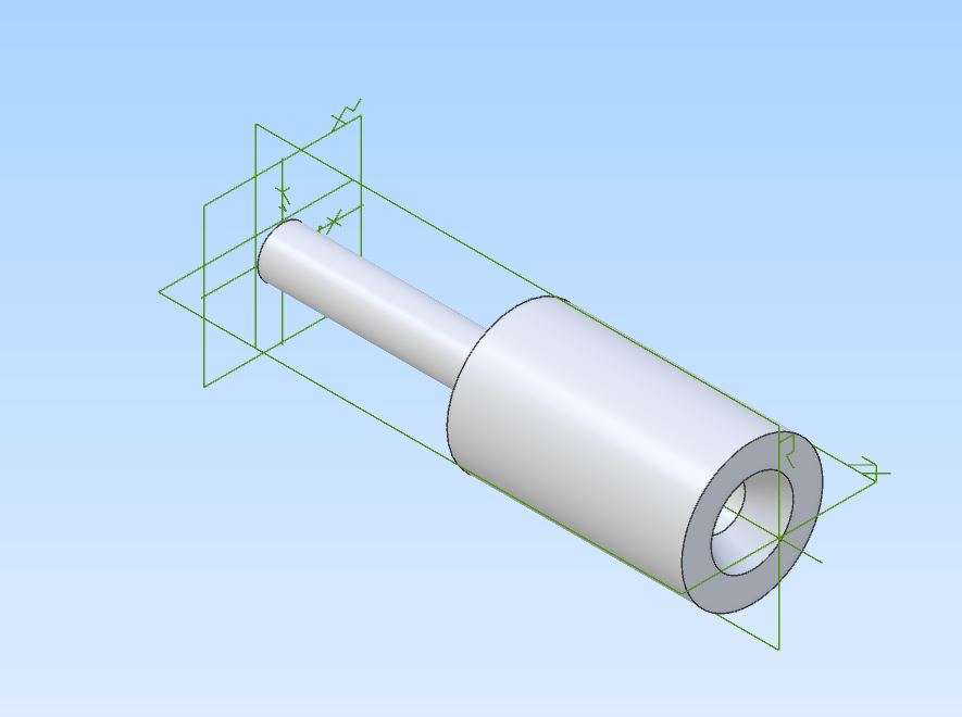

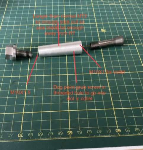

            This picture may help to give an idea of my thinking, the MT2 arbor is for Illustration purposes as it’s the one I use to centre RT on mill quillIMG_5058-compressedIMG_5057-compressed
            #856993
              Should work. I would add a sacrificial ctr plug so you can use some tailstock support too.
              It will need quite a small diameter saw to go all the way through to the 2.1mm bore yet avoid cutting into the far side of the cross holes and your arbor.

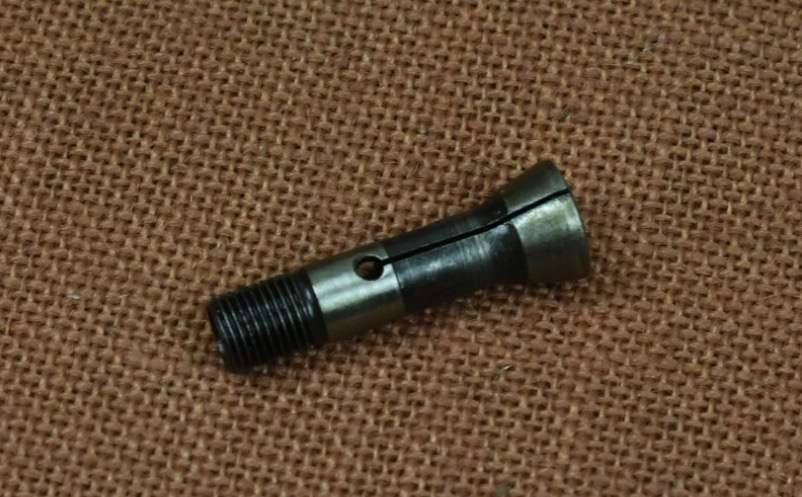

                                  Mmmm … He has already provided a useful photo
                                  #857100
                                    Here’s a cropped version of Dell’s useful photo

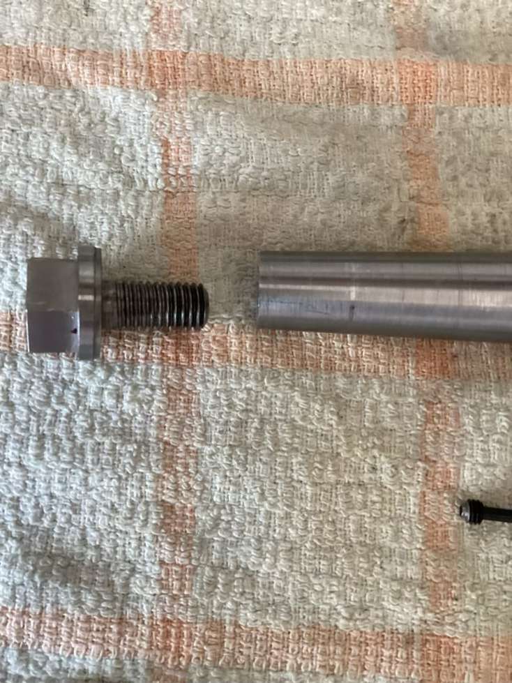

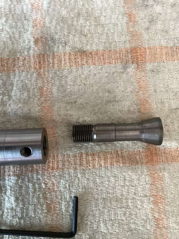

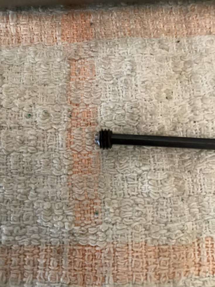

                                      But I decided to go with my original plan, I can’t support the end of the collet with a tailstock because not enough room & anyway turning a support to fit tailstock with a 2.1 end would not give me any support I don’t think, so machinist Jack under collet will help & an angle plate behind should be enough as the 0.8mm slitting saw will be coming in to the collet from the side, this is the process so far I have turned an extra long MT2 arbor with M10X1.5 in narrow end & M10X1 in larger end & drilled & tapped hole for grub screw & turned a dog point on the M5 grub screw.
                                      Dell
