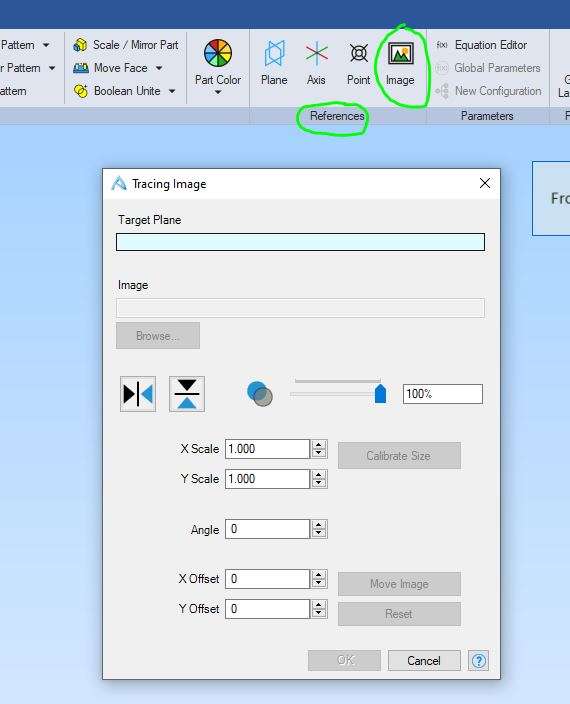

          #731291
          John Hinkley
            @johnhinkley26699
            To import a JPEG image into Alibre Atom, for example inserting a line drawing for tracing, (manually), from the “model” sheet, go to the trace image icon (two green mountains) in the toolbar which is between the “point” and “equation editor” icons in my version (V27).  Select the desired plane on which the image is to be placed, select the image and alter any other variables, if desired e.g. transparency, and click OK.  Voilà, one imported image.  As far as I know, there is no automatic line tracing facility available in Atom, though it might be available to Alibre Design users.
            trace icon
            Edit: Added partial screenshot.  Sorry about the image!
            #731300
              What John says, you don’t us ethe “import” via “file”
              Icon should be in references, mine is a bit different but you do have it somewhere.
              Email me the image and your waggons wheelbase and I’ll show what is needed to get it 1:1
              trace2

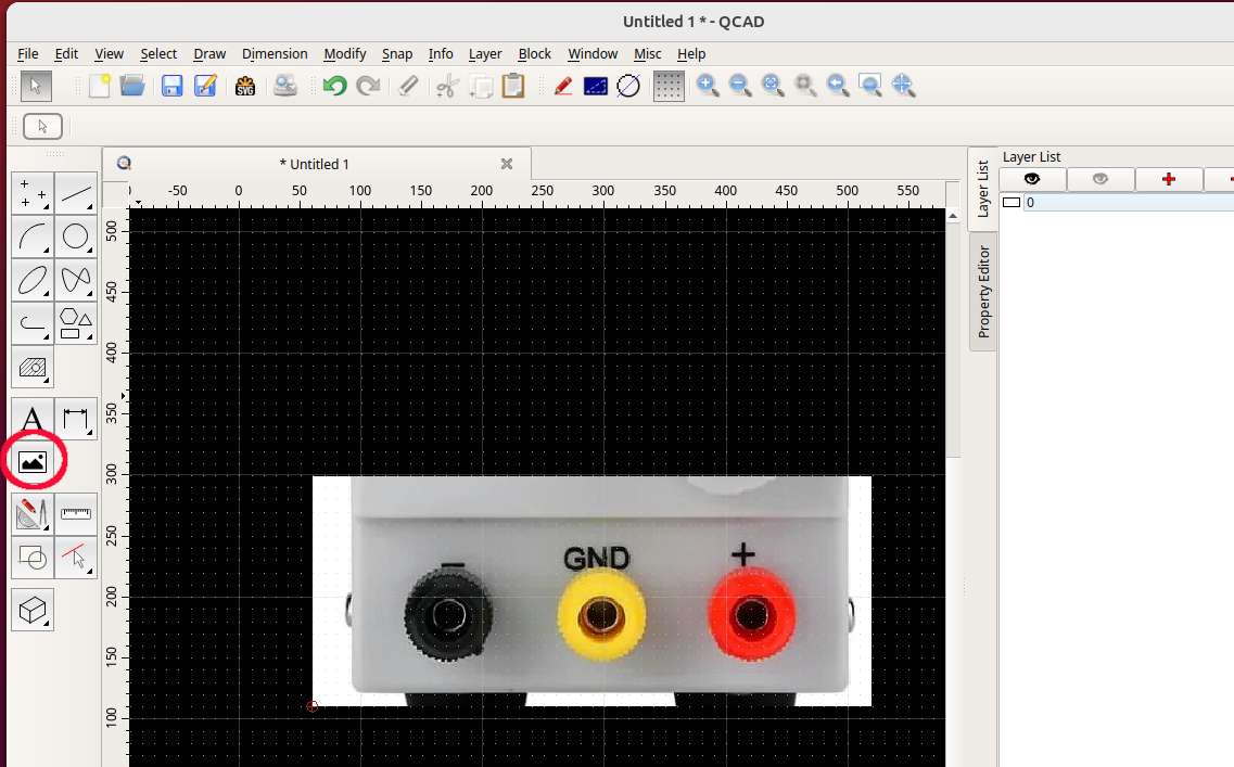

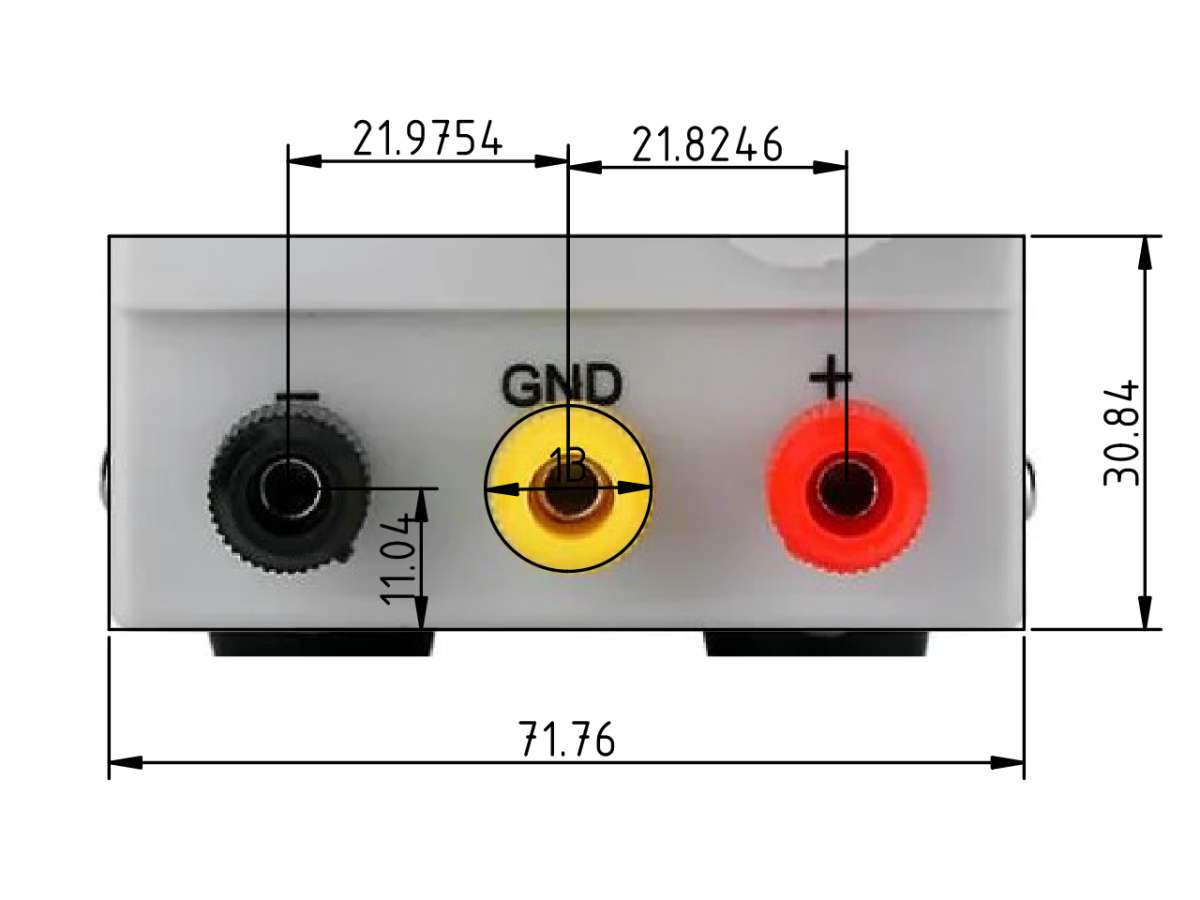

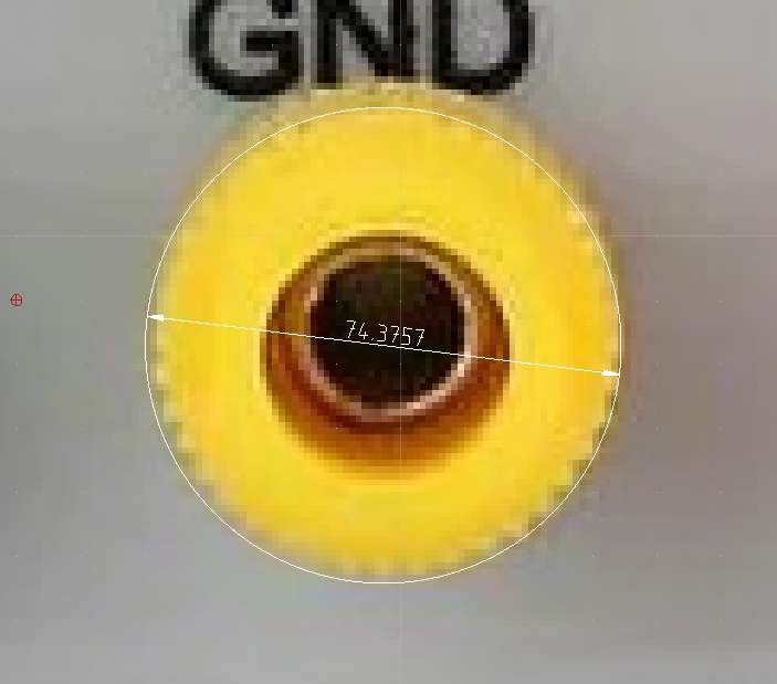

                  Nigel scores a A+ for highlighting potential problems when transferring a photograph into a scaled drawing!  It’s not easy.   CAD stands for Computer Assisted Design, not Computer Automatic Design.   Translating a 2D unscaled image into a scaled 2D engineering plan, and from their into a 3D model is a puzzle.  Depending on the clues, the puzzle ranges from easy to fiendishly difficult.  Whether done with paper and pencil or software, the human will have to think hard.
                  Take this example which happens to be a jpg end-shot of a small power-supply imported into QCAD.  (QCAD happens to put the import button on the main menu, highlighted in red.   Other CAD don’t.)
                  psuterminals
                  • Photographs have no notion of scale, and, although proportioned more-or-less correctly the image contains no dimensional information.   The power supply could be 300mm wide or 30mm wide.    As Nigel points out the dimensions are distorted by perspective and the angle of the shot.
                  • The photograph has a few flaws: it is cropped top and bottom, so the human will have to guess or look elsewhere to find out what the full end profile is, and the camera wasn’t quite square to the object, so the image is distorted slightly
                  • The photograph gives no information about the depth of the box, which the human will have to decide.   Similarly, it looks at if the top is lipped slightly, requiring more human intervention.
                  • There is no clue as to how the feet are held on, again requiring a human decision.
                  • Two screw-heads can be seen on the on the side, and there may be more hidden behind them.   They look like round-heads to me, but could be slot, phillips, torx or even rivets.   No idea what they are supporting inside the box, or how far from the end they are.  More work for the human.
                  The good news is the photograph does provide useful information from which a start can be made.   The terminals come in fairly standard sizes, could be 4mm, probably 6mm / ¼” :
                  bindingpost

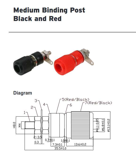

                  In Nigel’s Tractor, a wheel might be a good starting point, or anything else in the photo with a guessable size, like steps.
                  From my known terminal post I can make intelligent guesses, by assuming that the outer diameter of the post is 13mm, and deriving from that the spacing of the terminals, and the dimensions of the end.
                  measurepost
                  To establish the scale, drawing a circle over one of the terminals, suggests 13mm in the real world translated into 74.4mm when I inserted the bitmap into QCAD.  This means the scale error is about 5.7:1, which needs to be corrected before going further.  I reimported the photo and scaled it at 1:5.7 before starting again, resulting in this:
                  scaledpost
                  Although I could go directly from these dimensions into a 3D model, I’d stop and think first.  Bearing in mind the inaccuracies inherent in translating from photograph to an engineering drawing, is the width really 71.76mm, or is it a standard size, perhaps 2¾”?   Again the human has to engage brain.
                  In practice, though it may be possible to solve an image puzzle quickly by tracing and scaling, and immediately using the same sketch to produce a 3D model, I find it’s usually better to use the tracing as part of the preliminary design, which informs development of the 3D model as a second stage.   A big advantage of a 3D model is that, within limits, dimensions and positions can be changed later.   In my example, I might just eyeball placing the feet on the bottom of the box:  if it looks right, it probably is.

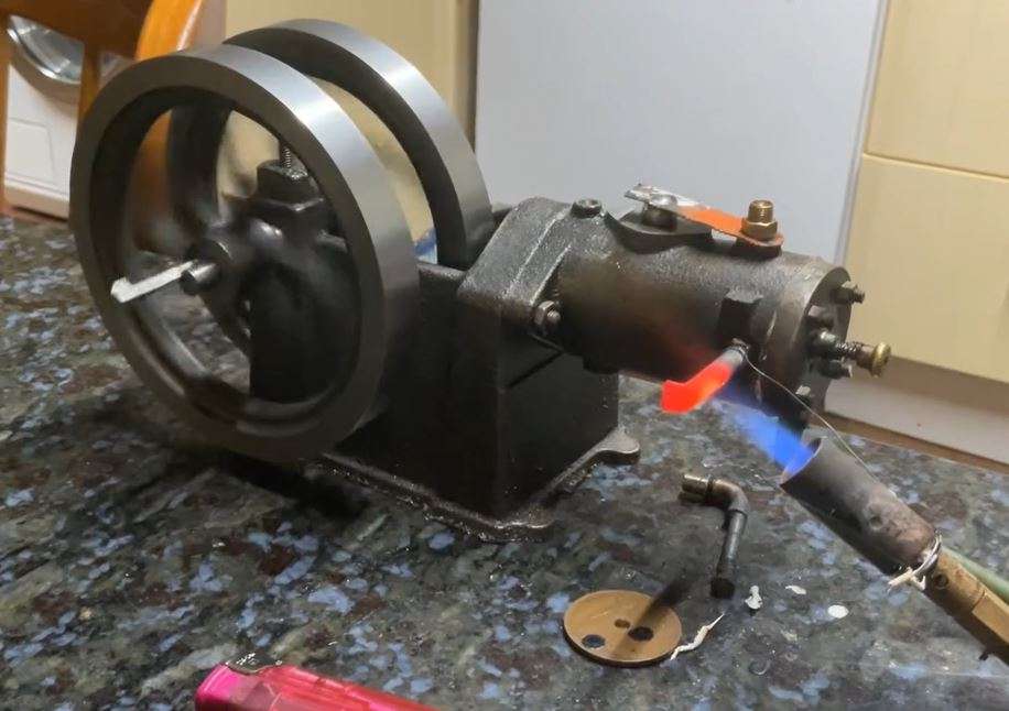

                    I have just experimented, using a photograph of some of my engine parts. While it is possible to draw on it as a form of manual tracing, the most the photograph can do is be a guide. Among the parts were the cylinders, and I could not centre a circle on them.
                    While placing lines along straight features on the crankshaft was very approximate indeed, with the dimensions as they show in the line tool being incorrect: both by the shaft being slightly oblique to the photo plane, and by the sheer difficulty of spotting the features’ boundaries accurately.
                    So while it could be useful in some applications, it’s a technique to be treated with considerable care – or suspicion.

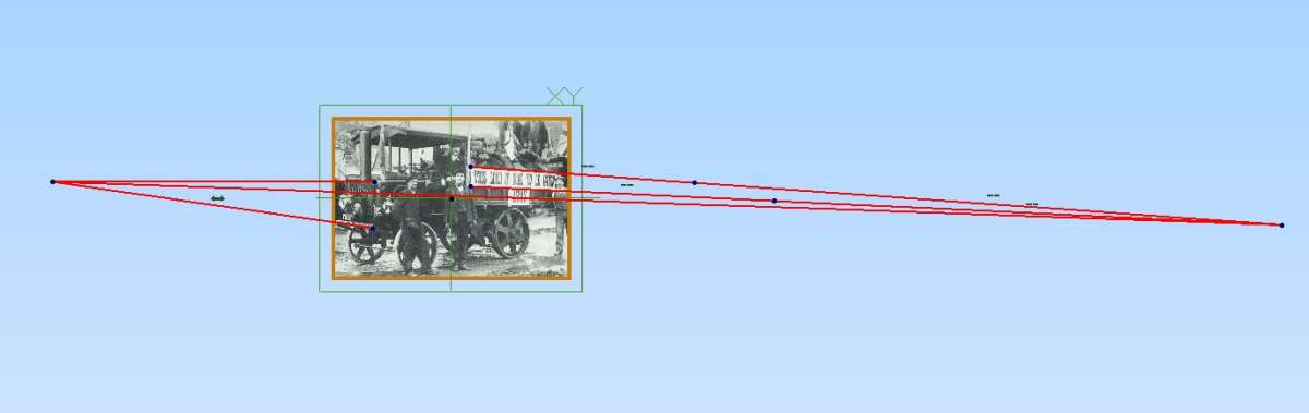

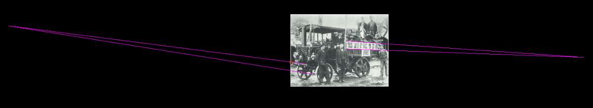

                      As my small contribution to ‘the knowledge’ … I have [to a first approximation] located the two vanishing points for the image that I grabbed for Nigel [*]
                      The method is hopefully self explanatory … and the resulting points are necessary and sufficient to define the perspective of the image.
                      Unfortunately, I have no idea whether Alibre Atom’s 3D view can be adjusted to match this.
                      Screenshot 2024-05-19 at 18.33.54
                      [*] The image was grabbed from the PDF that I linked earlier, and that source is hereby credited
                      #731506
                        Unfortunately you can’t adjust the image for prospective in Alibre but having the vanishing points does make it easier to proportion things from any known sizes. A good example here from picture to pattern and the casting below

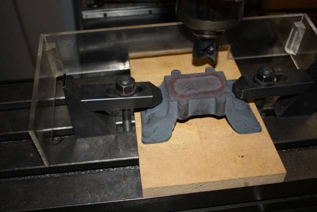

                        goulds casting

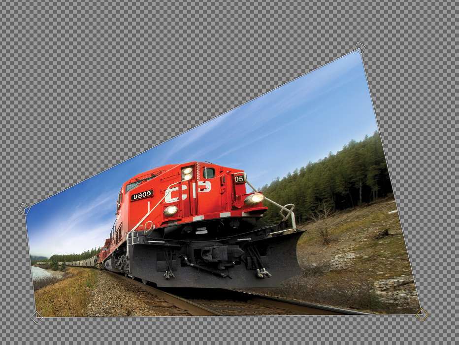

                                            Screenshot from 2024-05-20 10-40-00
                                            The problem with the manual approach is time taken.   Perfectly do-able with a single simple photograph, but soon becomes tedious when more than a few photos taken from different angles have to be analysed.   They are unlikely to share the same distortions.
                                            Computers offer a variety of time-saving tools, but none of them are automatic.  The user has to identify what the distortions are and know how to command the software to reduce them.  How useful depends on the degree and type of distortion.   In this example, not much, but it shows how gimp can transform an image simply by clicking and pulling with the mouse by eye until at least part of the image is straightened out.
                                            Though mild perspective and other distortions can be removed entirely, in this example only the front of the locomotive benefits, and maybe not worth the effort.  Worth a try if you already know how to drive gimp because the transform only takes a few seconds, potentially saving a lot of time when the image is traced and dimensioned later:
                                            278707-diesel_locomotives-freight_train
                                            After transforming with gimp’s perspective tool in a not very successful attempt to clean up the front:
                                            Screenshot from 2024-05-20 11-08-41

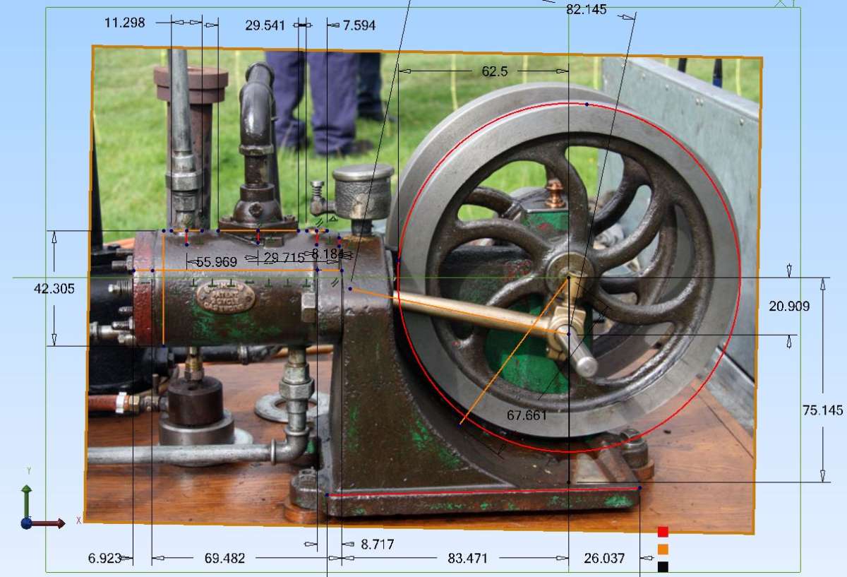

                                                #731713
                                                  It’s unlikely you will be able to find the perfect photo but if the user is willing to make the most of it then it is a useful tool.
                                                  Take this photo which is not square on as it’s taken from above and slightly to one side. I wanted to model it to suit an existing flywheel diameter so it was first scaled match the circle drawn at the size I wanted, yes the image is slightly oval but close enough. As the horizontal is less distorted than the vertical the image was set to match the horizontal width of the circle.
                                                  All subsequent lines were then actual model size or as close as the thickness of existing lines and edges would allow them to be. Apply a bit of common sense and workable sizes can then be used, rounding to 0.5mm increments was used as the sizes are mostly for patterns.
                                                  ideal trace
                                                  Workable 3D parts, patterns and assembly  can then be produced from those sizes
                                                  ideal parts

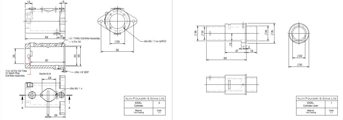

                                                  2D Drawings from those for machining
                                                  ideal drawings

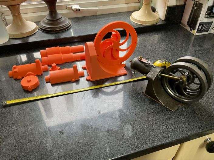

                                                  3D printed Patterns and castings follow. Note the second larger set of patterns that were simply created by scaling the original pattern files
                                                  2 ideals
                                                  And lastly a running engine. This is Graham Corry’s one I’ve not started mine yet.
                                                  ideal running
                                                  Not once in the production of those castings did I touch a piece of paper or a rule. All done with CAD, sent via email to be 3D printed then traditional casting and machining. So if the user is willing to grab new technology by the horns and fully embrace it then it can be used to good effect.

                                                    On Nigel Graham 2 Said:
                                                    […]  That height, judged from the people in the Gillingham photo, being as I would expect around the photographer’s eye-level in setting the camera. […]
                                                    Just an observation, if I may …
                                                    Although expressly a ‘first approximation’ my demonstration of locating the vanishing  points is significant in this respect: They are a long way beyond the edge of the photograph, so it is essential to have more “real estate” to work in.
                                                    Once located properly, the horizon within the photograph is on the straight line connecting the two vanishing points.
                                                    One of the nice things about optics is that [distortions/diffraction aside] the rays can be traced in either direction.
                                                    #731744
                                                      And the PC screen combined with zoom gives plenty of real estate that a drawing board or piece of paper lacks. Looks about chest height to me.
                                                      hindly horizon
