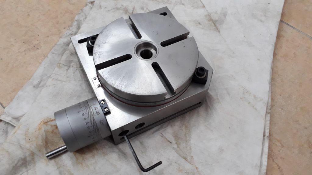

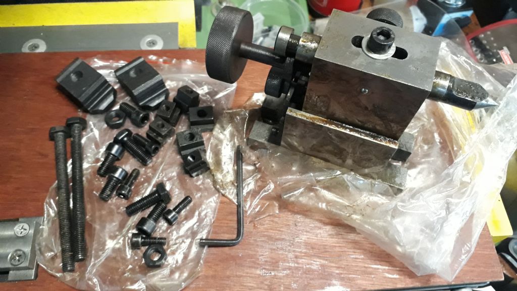

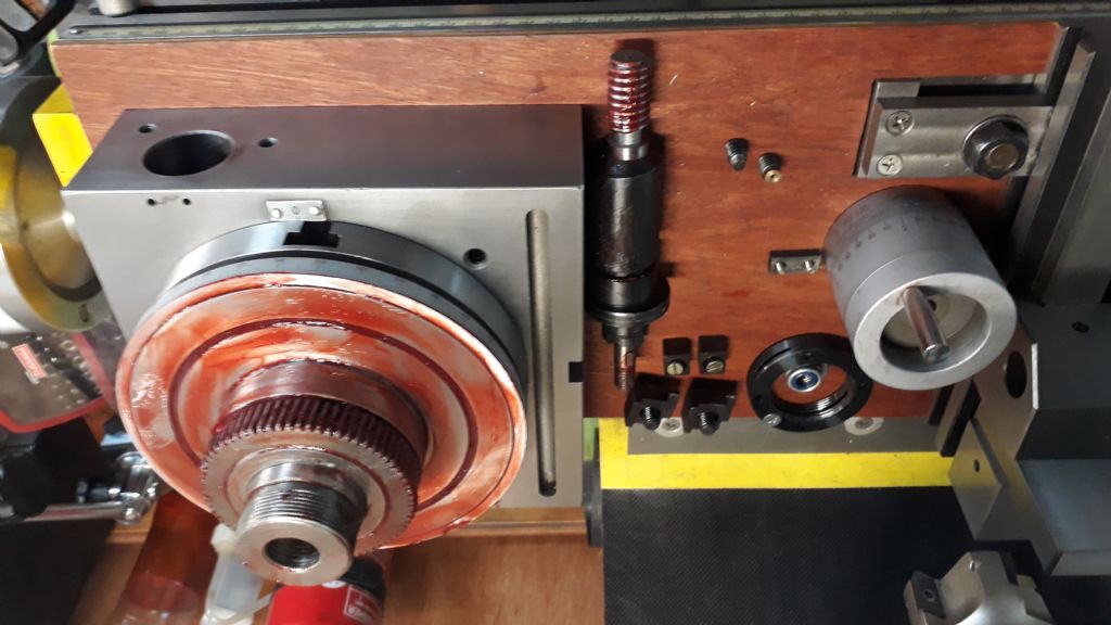

      ChrisB
        @chrisb35596
        Hi, I have been after a 6" rotary table for quite a while, looking at ebay for a good deal on an HV6 or similar but all the time I was out bid.
        Finally I managed to win an auction on a 6" rotary table and tailstock which were in a new never used condition. The table had some surface rust which went away with some scotchbrite, the tailstock was still in its plastic packaging and storage grease.
        I disassembled the table and cleaned it from the grease and re-lubricated it. Looks fine to me.
        The table has got no markings on it, no manufacture's data plate etc, and it's shape is not like any I have seen, such as a Vertex or Soba. It does not not even look like it's a casting – more like a machined block of steel (do not take my word for that)
        My guess is it's a Chinese import – anyone knows what type of rotary table is this and if it's any good? I paid £200 for the table and tailstock, the price of a new HV6.
        #440892
        Clive Brown 1
          @clivebrown1
          Looks like those sold by ArcEuroTrade? A good buy.

            Here is a 6 inch rotary table:
            ArcEuroTrade rotary table
            #440900
              In case you missed it the 0-360deg ring around the edge of the table also moves and can be set to zero but is a good fit which is why it looks like you did not remove it.
              As said above looks like the ones ARC sell which I think are made by Sieg or based on them.
              I've been using one for a while and they ar ea nice table.

                  At £200 for the table and tailstock that is a very good buy, it certainly looks to be the ArcEuro one and I have only heard good things about it.

                    I notice that ARC sell the set of dividing plates to fit your table.

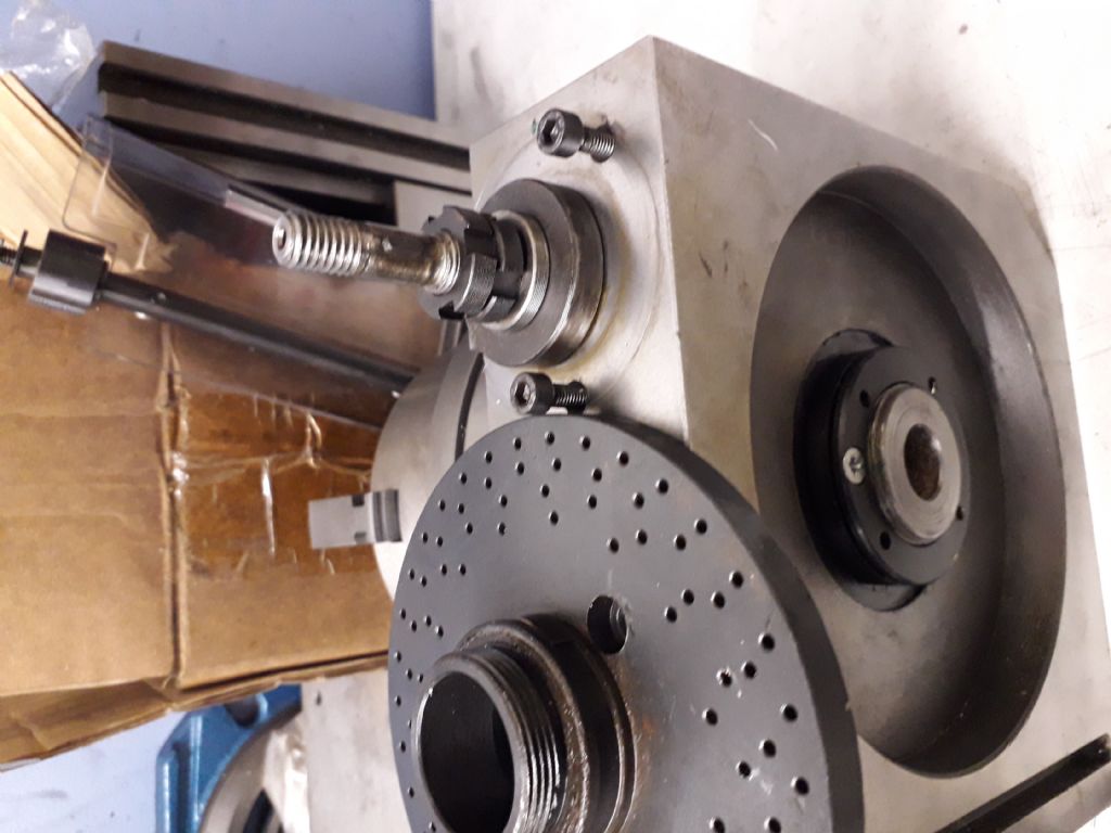

                        Yes, I'm missing the dividing plates. The one on the ARC site has a 1:72 gear ratio so if I count the teeth on the worm gear and it's 72, then the dividing plates should fit right?

                          You need to check the hole in the middle of the plate and the screw mounting holes, I'll measure mine tomorrow for you and dig out the instructions that list what divisions are possible.

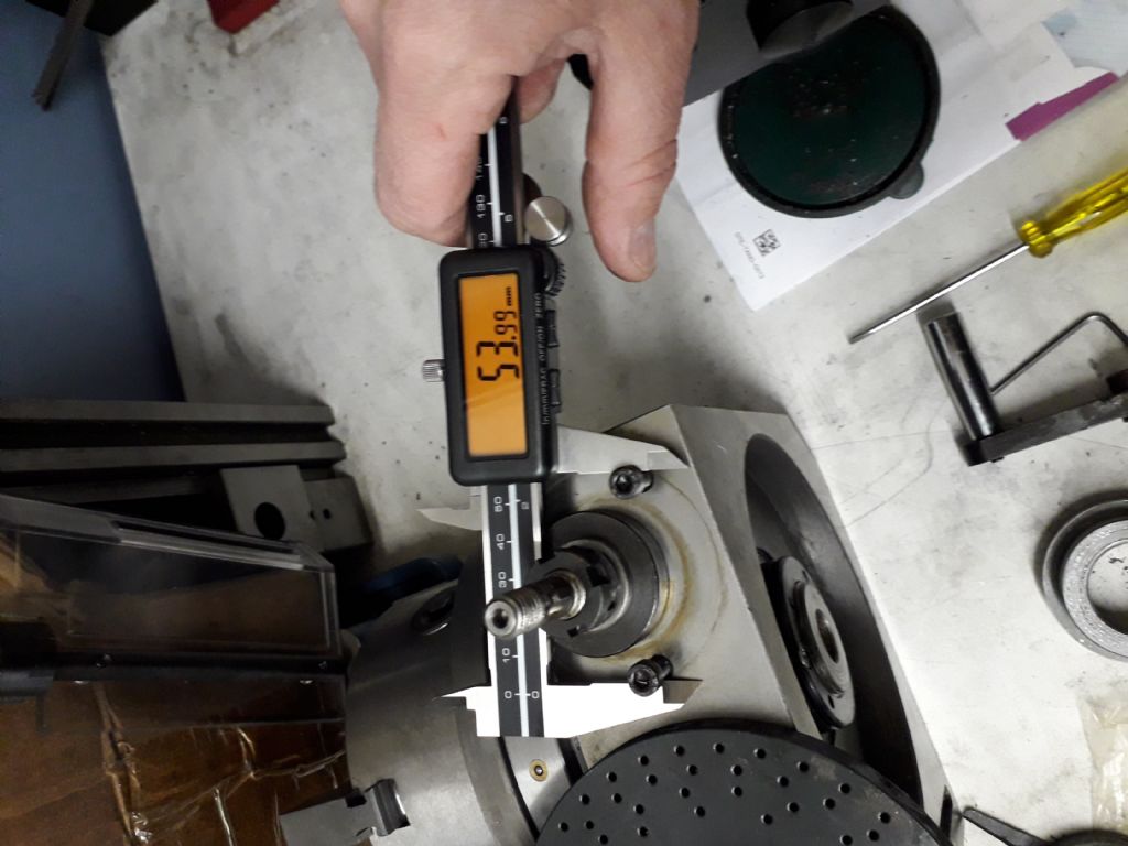

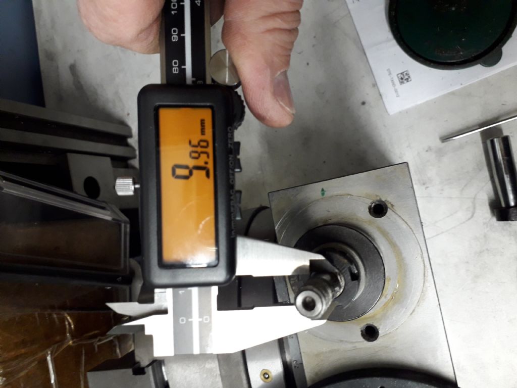

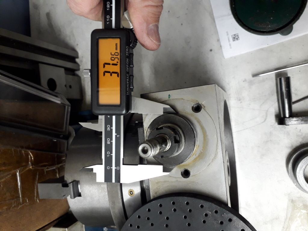

                                      Sizes that you need to match if you are going to use an ARC dividing plate etc are.
                                      approx 38mm spigot for plate to fit onto.
                                      approx 10mm shaft for handle to fit onto
                                      Approx 54mm over the two M5 fixings = 49mm ctrs

                                          Have you a chart giving the Turns and Holes for the various numbers of divisions with your Rotary Table?
                                          If the gear ratio is 72:1, then the chart should call for one turn of the handle for each of 72 divisions.
                                          If it is not 72:1, then whatever number of divisions that calls for one turn of the handle will be the gear ratio.
                                          As an example; a Vertex HV6, calls for 1 turn for 90 divisions, so has a 90:1 ratio.
                                          Otherwise, you will need to count how many turns of the handle are needed to rotate then table by a set number of degrees, such 90 degrees., and multiply by 4.
                                          22.5 turns for a quarter turn means 90:1. 18 turns would mean 72:1, and so on. To be absolutely certain, keep counting the turns until the Zero graduation returns to the datum point. Bit of a PITA, but necessary to find the ratio. The higher the ratio the greater then resolution.
                                          Mounting a set of division plates meant for a table with one ratio, onto one with a different ratio will mean that the chart supplied with the table will not apply, and a calculator or a spreadsheet will be needed, to arrive at the turns / holes for a given number of divisions. It can be done. When errors were evident in the Vertex HV6 chart, a spreadsheet brought to light other errors and omissions, so in the end it was time well spent.

                                            Far simpler way than Howard's is to look how many degrees on the handwheel, you are likely to find it is 5deg
                                            360/5 =72 Simples.

                                                Posted by JasonB on 10/12/2019 19:23:43:
                                                Thanks for that Jason. Measured my table and the dimensions are the same as those in your photos – so most probably it's the same as yours from Arc
