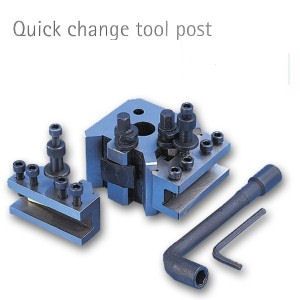

                                              @terryd72465
                                              Hi petro1head,
                                              As Phil said above you can buy a QCTP from any of the online suppliers such as RDG, Chronos, Warco (ad in the RH column on this page), Axminster Power Tools etc. etc. There are several good tool suppliers if you Google them.
                                              These suppliers also sell sets of pre ground HSS tools which gets you started without having to grind your own initially. you will need a small grinder (Machine Mart) and a diamond slipstone to touch the tools up and keep keep them sharp. There is a lot of information on the internet about lathe tool shapes and keeping them in good order, just do a bit of research there.
                                              Here are a couple of pictures, one of a 'Dickson' type toolpost but there are other types to consider. It may be worth visiting one of the suppliers on an 'open day' such as Chester (Google) or Warco, or visit a local Model Engineering club (see internet or Directory for a local one) where you can get hands on and advice. Also the one pictured has the capacity for two tool holders at the same time so you can swing a second tool into place easily, some only have capacity for one at a time which means changing the holder more often and is less convenient in my opinion but others may disagree.
                                              The second picture is of a centre height gauge from a George H Thomas design – his book is also very good and is usually available from local libraries (if not they will get it for you). It is called "The Model Engineers Manual" and makes a good read.
                                              Learning to use a lathe and exploit all it's possibilities is a long but rewarding journey.  It is the machine that made the industrial revolution and the world as we know it – enjoy the trip and welcome to our world wink 2

                                              Quick Change ToolPost (QCTP)
