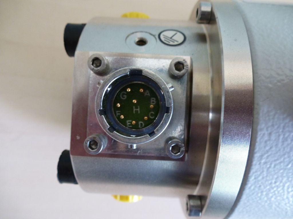

      I bought a Peiffer vacuum pump. The electrical connector is definitely non-standard and anything Peiffer is v expensive. The connector has 8 x 1mm pins – easy enough to make/get female shells for these. The question is would it be possible to mould a low temperature plastic around the fitted shells to make a removable connector? Issues are – reasonable strength and not sticking permanently to the pump. Voltages are modest. Connector is 15.1mm ID about 15mm deep with straight slots but not sanely spaced – nor are the pins, so not an easy drilling job.

        #188972
        Anonymous
          It would help to post a picture; there are some pretty weird and wonderful industrial connectors out there. Not many companies (with the exception of automotive) use custom connectors.
          Alternatively it shouldn't be that difficult to 3D print something that would work.

                    Roger Hart
                      @rogerhart88496
                      Here is a picture. Item is a turbomolecular pump which I don't want to mess up….
                      If there is a standard plug around I would be very grateful.
                      #189001
                      The Merry Miller
                        @themerrymiller
                        Roger,
                        Have a look at the range of 62GB connectors from Amphenol.
                        I used to use this series on military equipment in the '70s '80s and '90s.
                        Farnell do some of the range but there are also others who may do!
                        Len.P
                        #189002
                        Anonymous
                          Hmmmm, it looks like a variant of the circular MIL-DTL-38999 connectors. Unfortunately they come in hundreds, if not thousands, of variations according to pin count, pin layout, locking mechanism, material, EMC filters, keyway and so on, ad infinitum! Some of the larger electronics distributors (Farnell/Mouser/Digikey) stock some such connectors, but you're more likely to have to go to a specialist distributor. However, it would be worth having a browse on a manufacturer website, like Amphenol, to compare sizes and so on.

                          #189004
                          Les Jones 1
                            @lesjones1
                            Hi Roger,
                            Have a look at the connector on page 100 of this data sheet I found this connector on Farnell's website. Their order code is 2344399 It is expensive – £15.99 + VAT.
                            Les.
                            #189049
                            Roger Hart
                              @rogerhart88496
                              Thank you all for the help and thanks especially to Les – I reckon you nailed it. After a close look with an eyeglass I found a part number on the connector but I would never have found it without your help.
