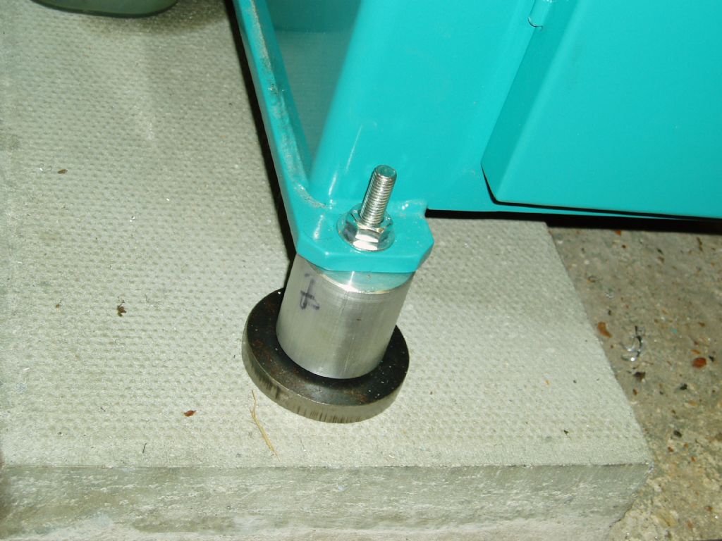

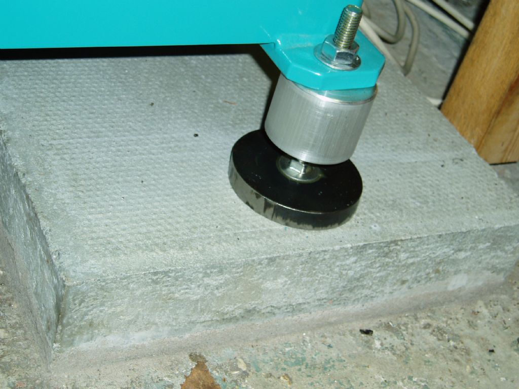

                      Adrian 2
                        @adrian2
                        004.jpg005.jpgI too am tall and also went down the paving slab route plus spacer/feet. I used inverted coach bolts settled in depressions in steel discs. All free standing on bedded slabs. One bolt/spacer is adjustable for levelling/stability. It works a treat and my lathe is at a very comfortable height. Level the slabs carefully.
                        Adrian.
